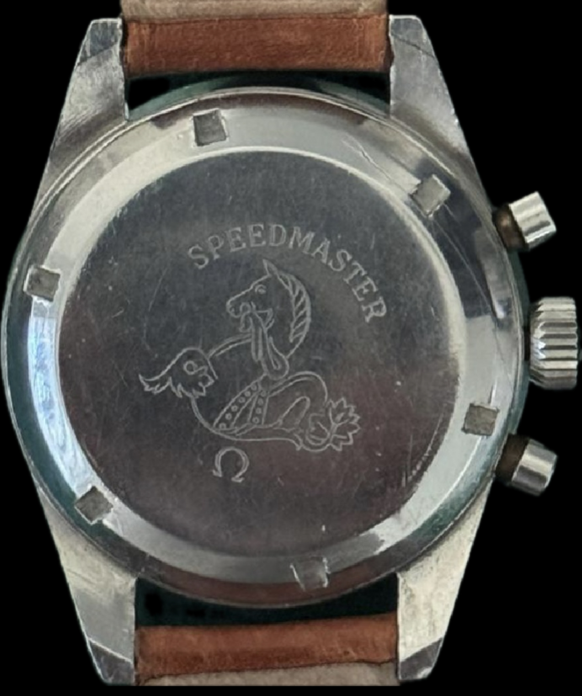

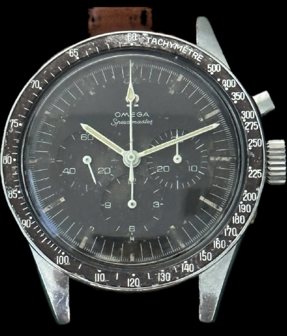

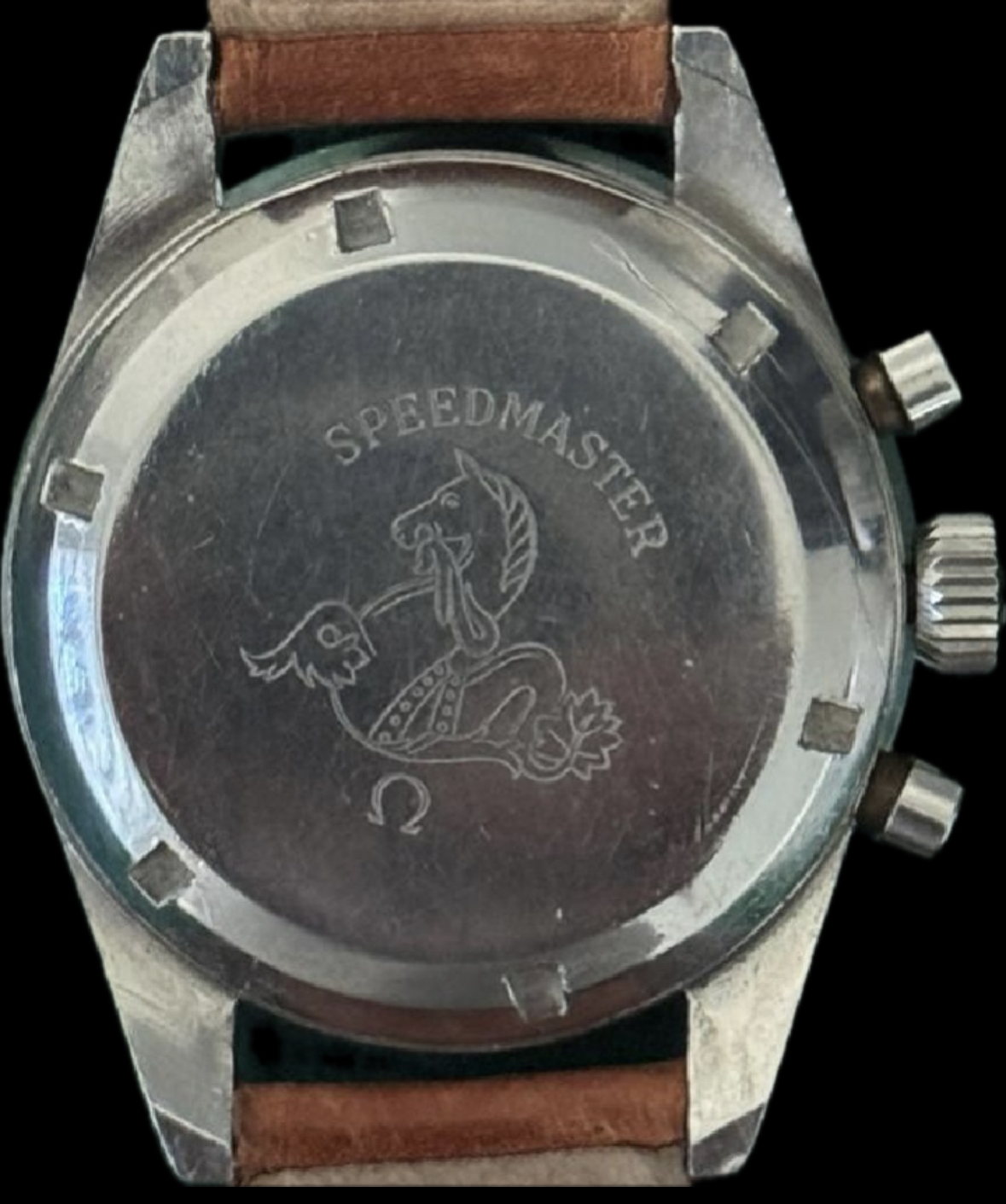

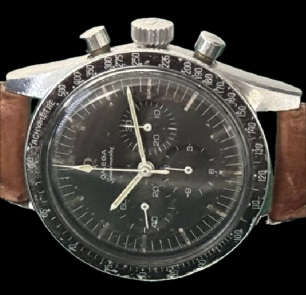

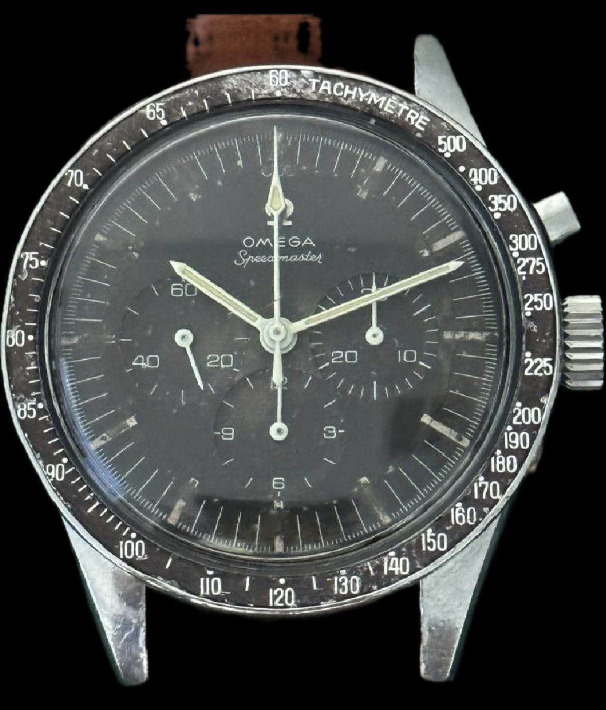

Here some photos. Not sure what my dear cousin did to get them to look like this, but the watch isn’t missing a lug. I guess there’s no photo of the case back, but it is stamped 105.003-65 The hands may have been replaced late in its life he thinks. The crown is original with the flat foot logo. The watch was always serviced at a small shop in his town. From the looks of the screws, the watch guy was a gorilla.

I’m going to go slightly against the grain here and say 22,52xxxx is slightly too early for a -65. As far as I remember 22,82xxxx is the earliest serial range for a -65.
There are 3 possibilities here for me;
1. You have an unusual but legitimate outlier.
2. The movement no is actually 22,8xxxxx (I can be certain on my phone)
3. The caseback was replaced.

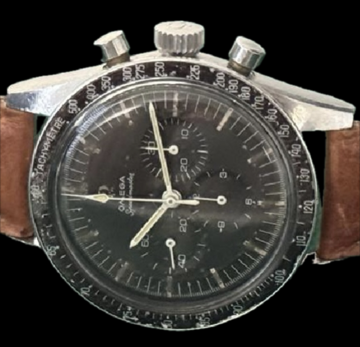

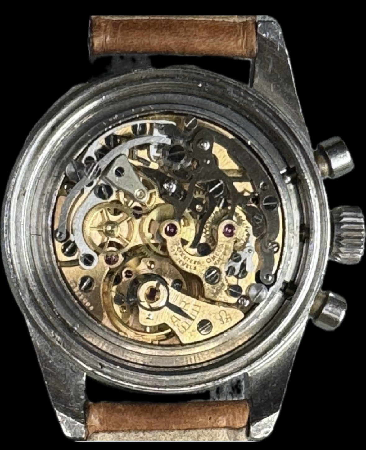

Here some photos. Not sure what my dear cousin did to get them to look like this, but the watch isn’t missing a lug. The hands may have been replaced late in its life he thinks. The watch was always serviced at a small shop in his town. From the looks of the screws, the watch guy was a gorilla.
That’s why I asked. Everywhere I looked, the 105.003 range started at 228xxxxx. Any signs that the rest of the watch might be earlier?
10,804
16,814
Hmm. It seems I misread the serial on the original post. 2252 does sound too early for a -65 it is true. Are we sure it actually says that? I mean as David notes above 2282 might look v similar, omega serial stamps are notoriously hard to read. The lugs aren't -64 lugs so my money is not on a caseback swap, but a serial mis read. Or perhaps yes a movement swap.
13,555
23,503
Good point, it does seem to have the lug facets seen on -65 cases.

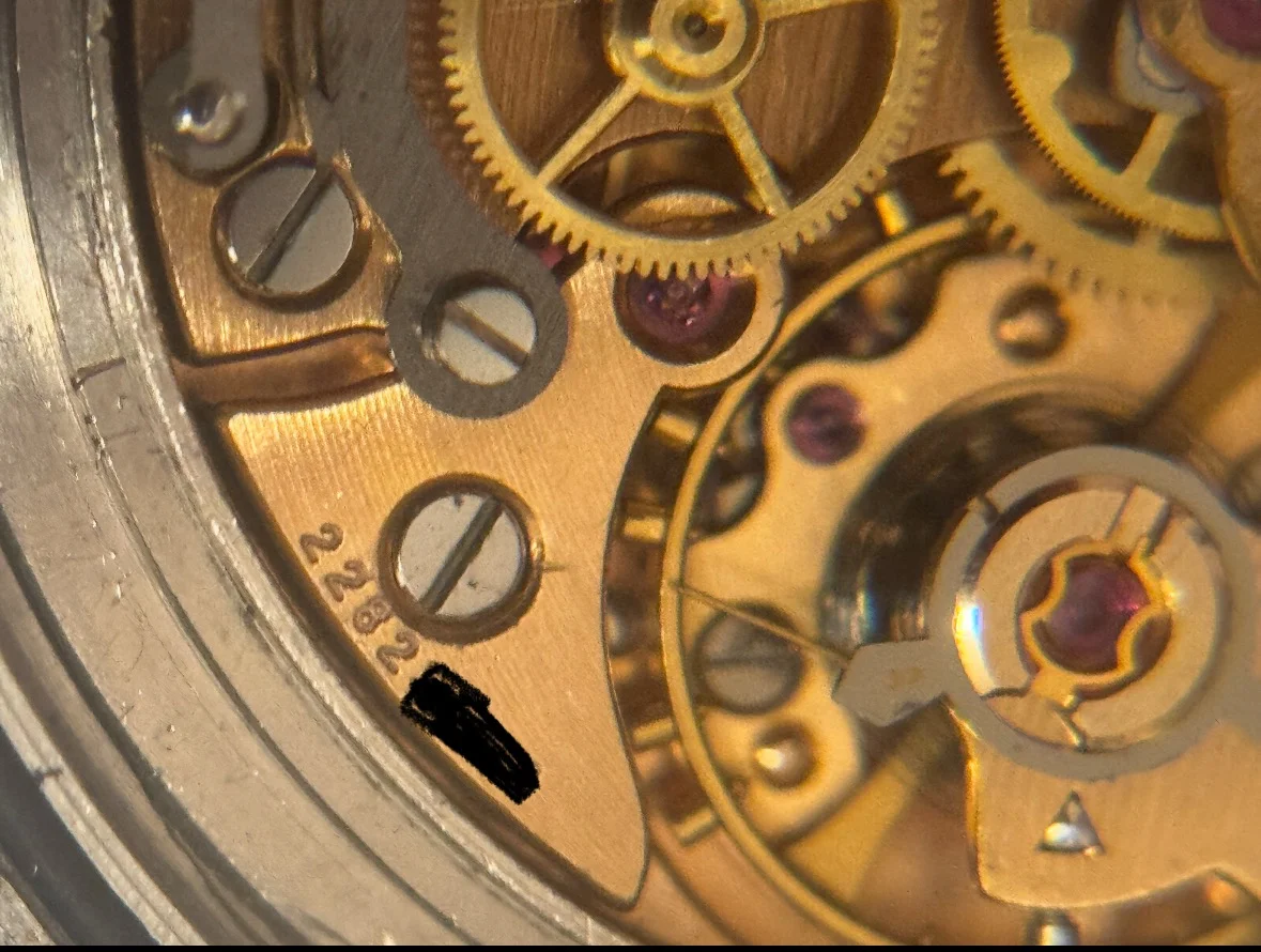

@Freedom7 is it definitely 22,52xxxx and not 22,82xxxx?

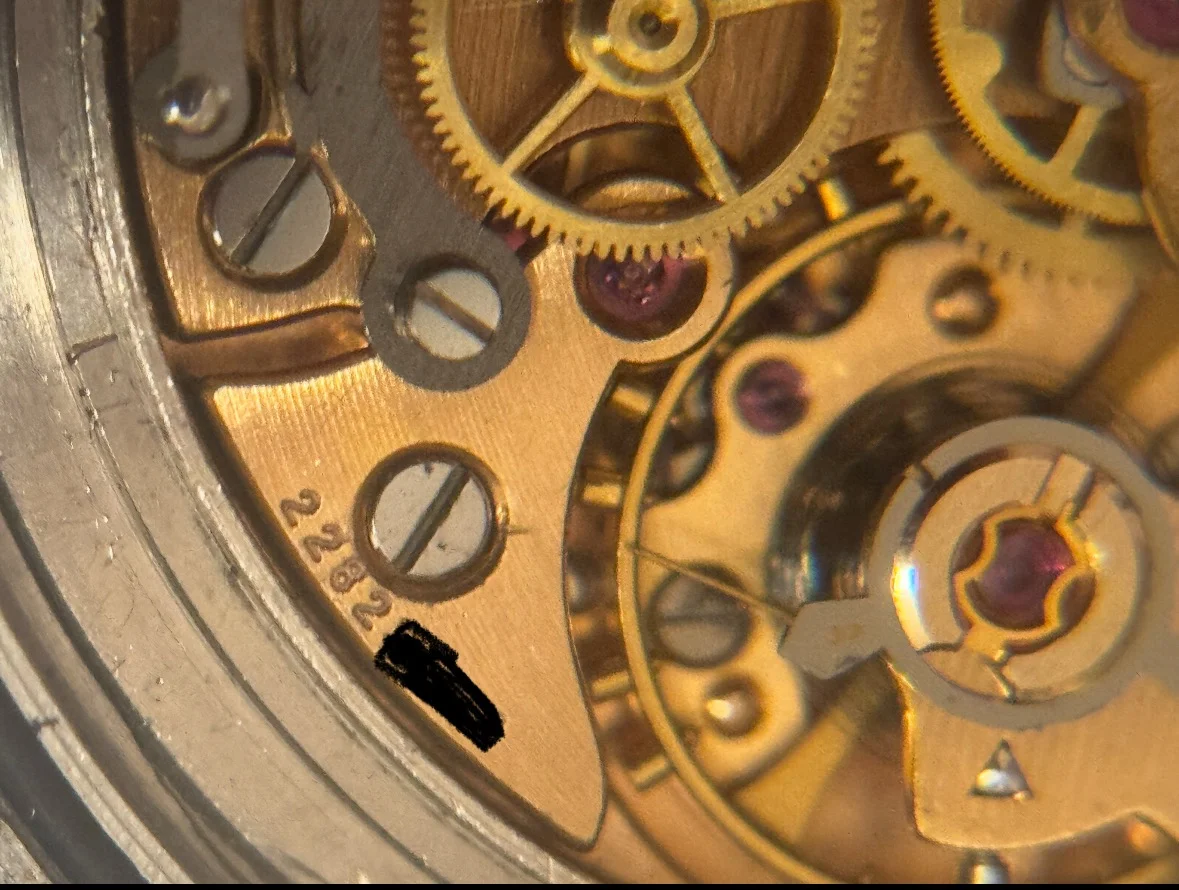

That’s an 8 mate. What’s the next digit? You don’t need to be so coy, even hiding the last one or 2 is enough if you must.
See my post above re early ‘66 serials. We should be able to date this watch pretty accurately with a couple more digits but as it stands it’s viable for a -65
64
11
I'm laughing. You're absolutely right I have no idea why I did that other than seeing others do it. 228250XX. I'd love to have a date on it if you could!

Run the serial through ilovemyspeedmaster.com
That is a better estimate
64
11
Thanks! That's a great resource! December 1965 came up. Geez, that must be a pretty early -65.
10,804
16,814
Indeed! Assuming you are reading the other digits correctly 😉
