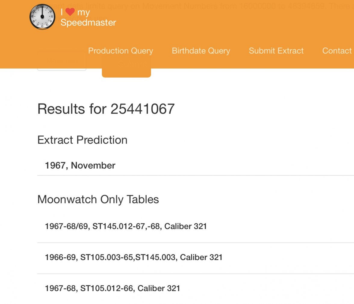

So, my 25441067 Ed is also a 145.003? ::psy::
I’d be interested in the email, obviously.
What date does your extract show for yours?

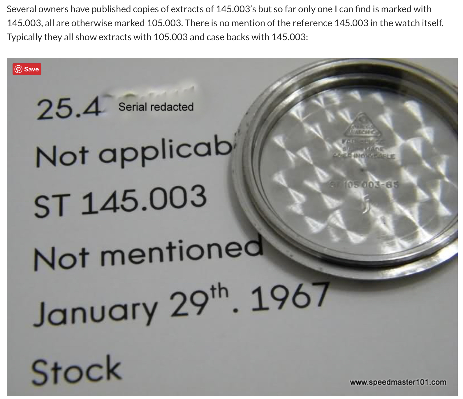

For posterity
Speedmaster101 extract:
Omega Forum thread extract
And everyone note: they are both for 105.003s, yet the lower serial number is produced eight months after the higher number.
Of course, maybe the answer is just in the fact that the second extract is from 2012?

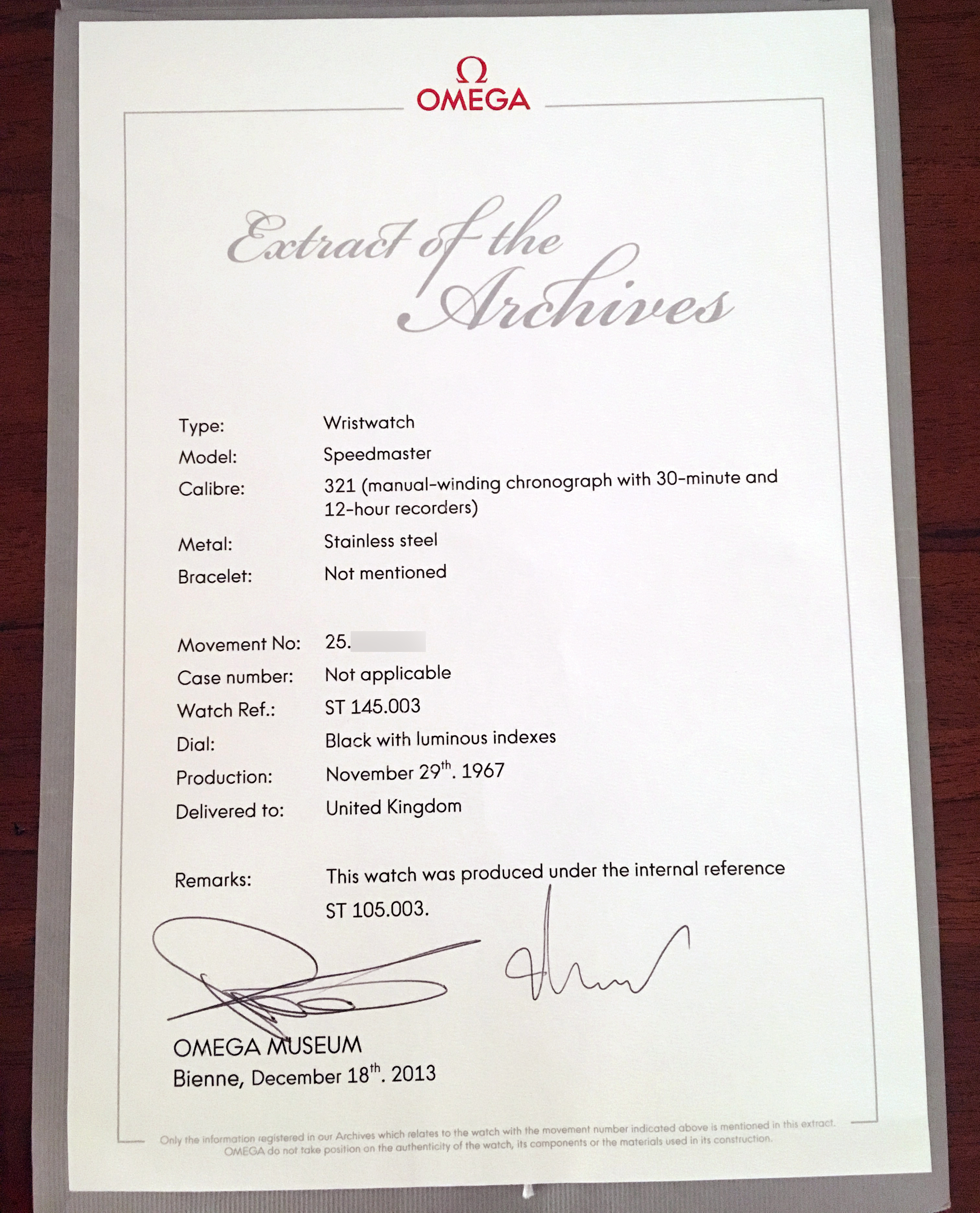

Is 4 years (well, 3.5) too long to go back on my email thread and share those images? 😁
1,664
2,132
Here is the extract from my watch.
2,519
17,845
Could you give us at least two more digits to your serial number?

254437XX

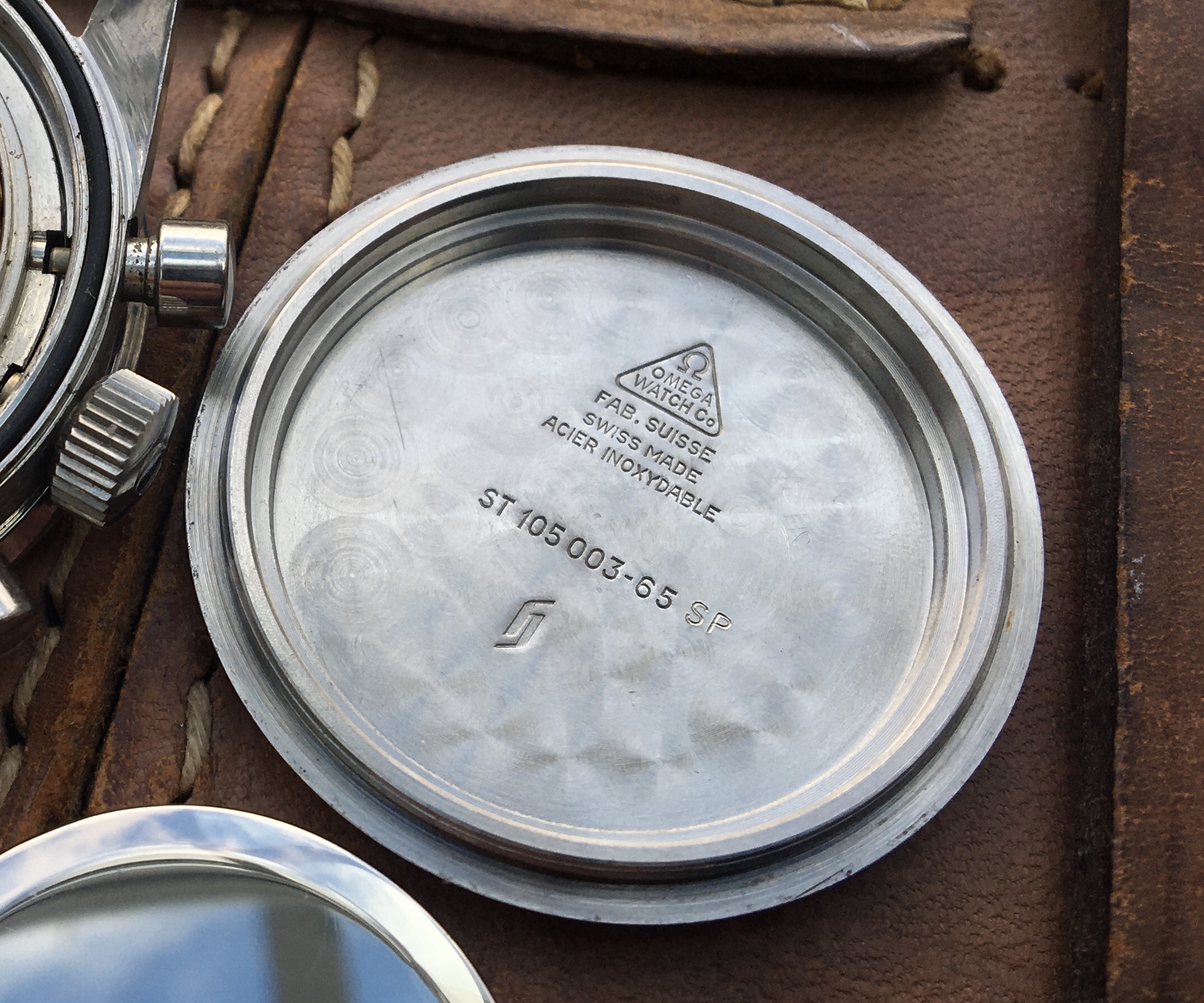

I don’t think Special pushers is correct. There are plenty of cases marked SP with no pushers. Special referring to water resistance makes sense though
I’ve said that many times, but the idea it refers to pushers persists...
I believe it simply means “special” and can refer to something different on the case, with the “something” being a variety of things.
18,328
27,697

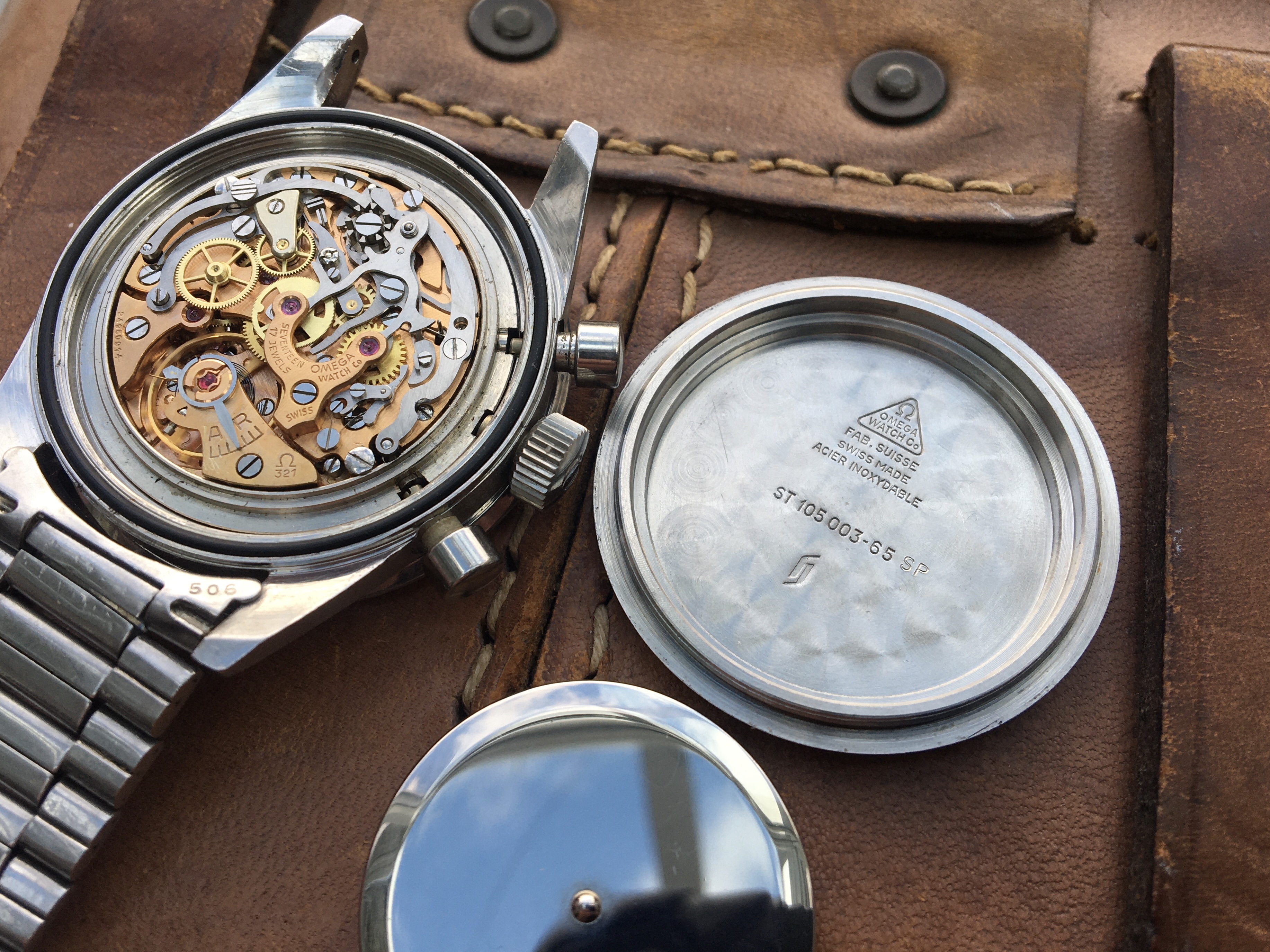

Here is what I am hoping.
145.003 10501-add9f0e56dafc9b0f47a3a7191f7acb2.jpg Credit to @SpikiSpikester for the above photo.
And @Spacefruit for this>
SP = speciale poussoirs
"Special pushers"
Upgraded for better water resistance
Also said special plounger for special water instead of pushers.

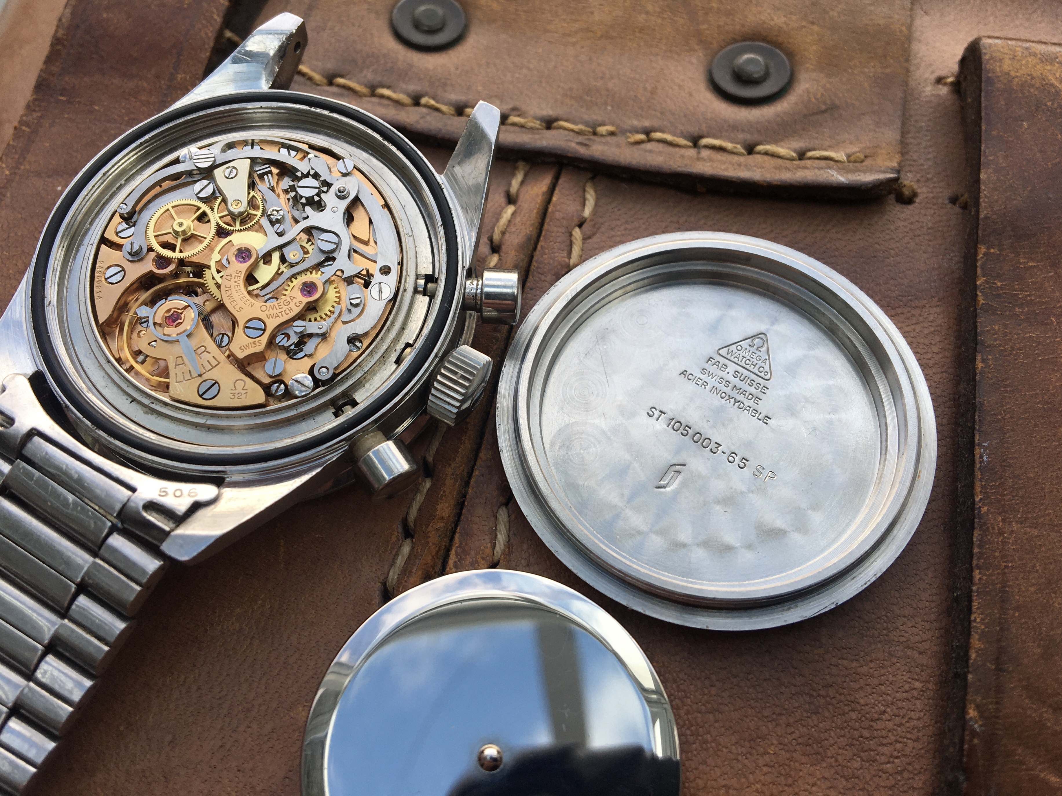

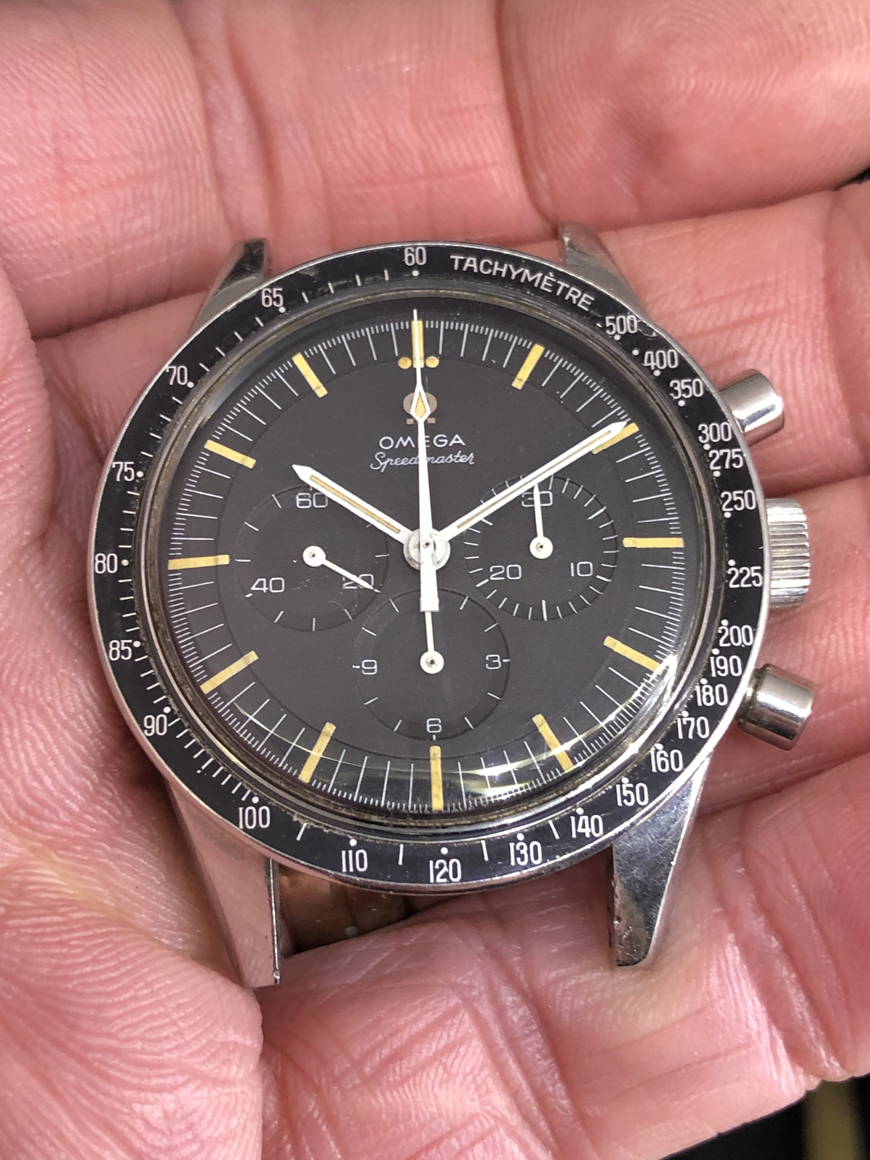

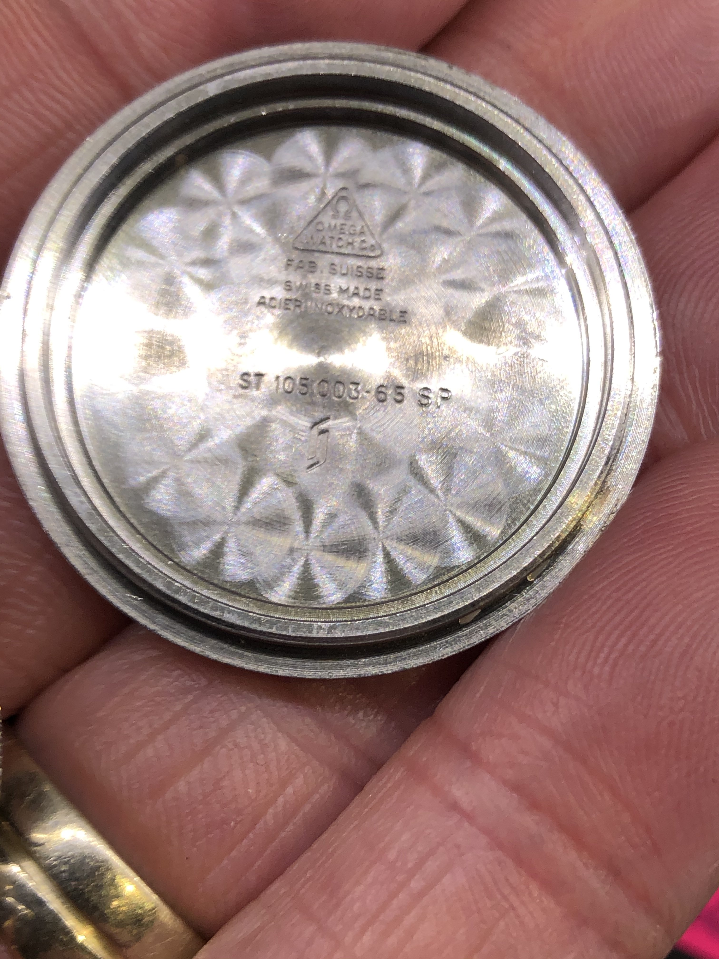

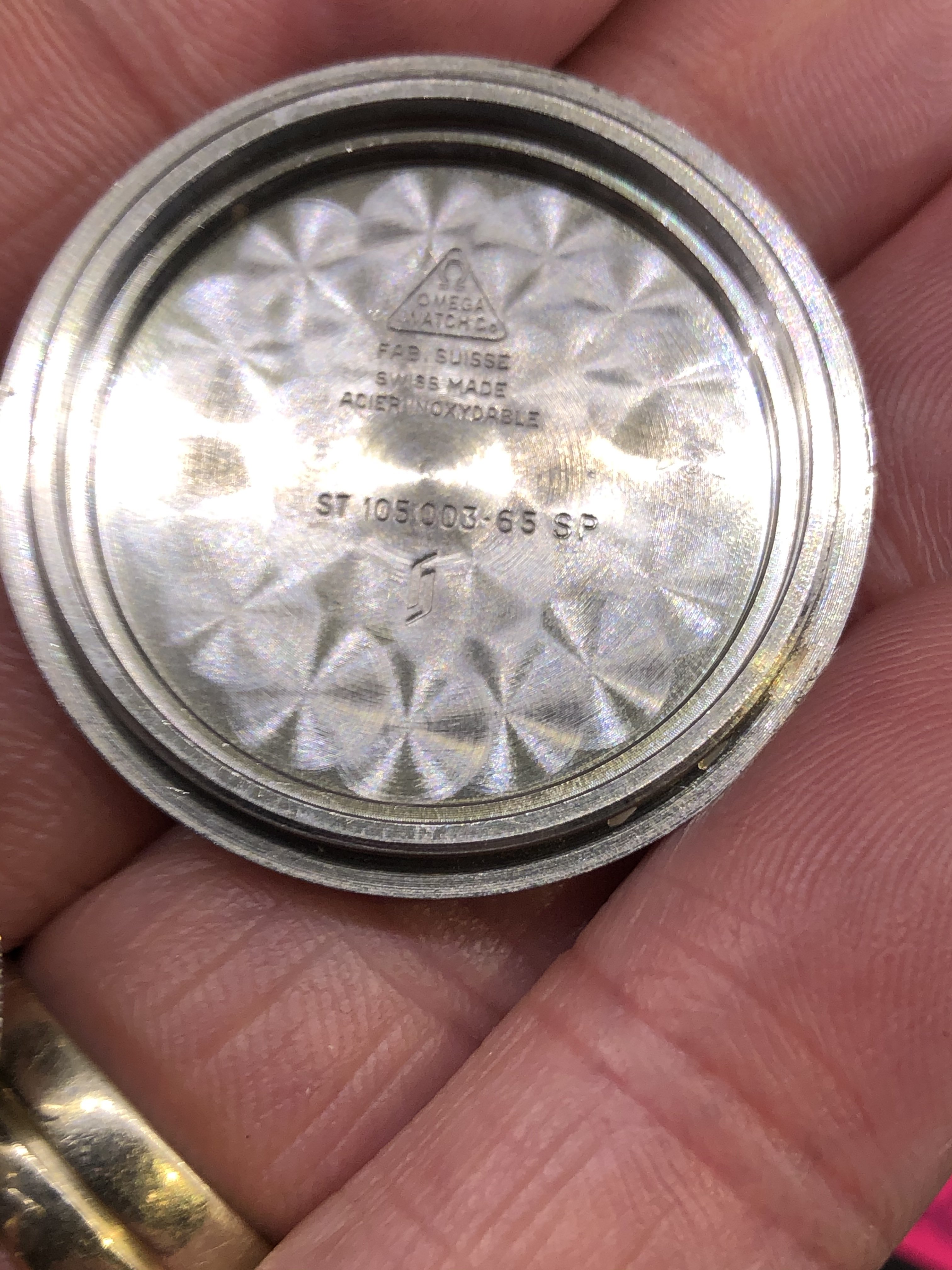

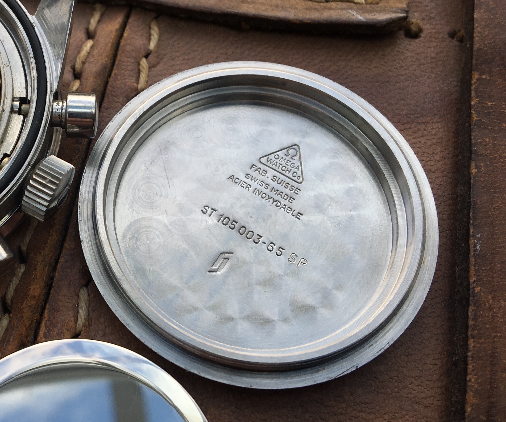

Another 105.003-65 SP here.
Exactly the same spec as my friends watch, pushers, crown and hands produced in 1967.
These are the only two I have ever seen.
Any more out there? Photos please.
Cheers, Michael

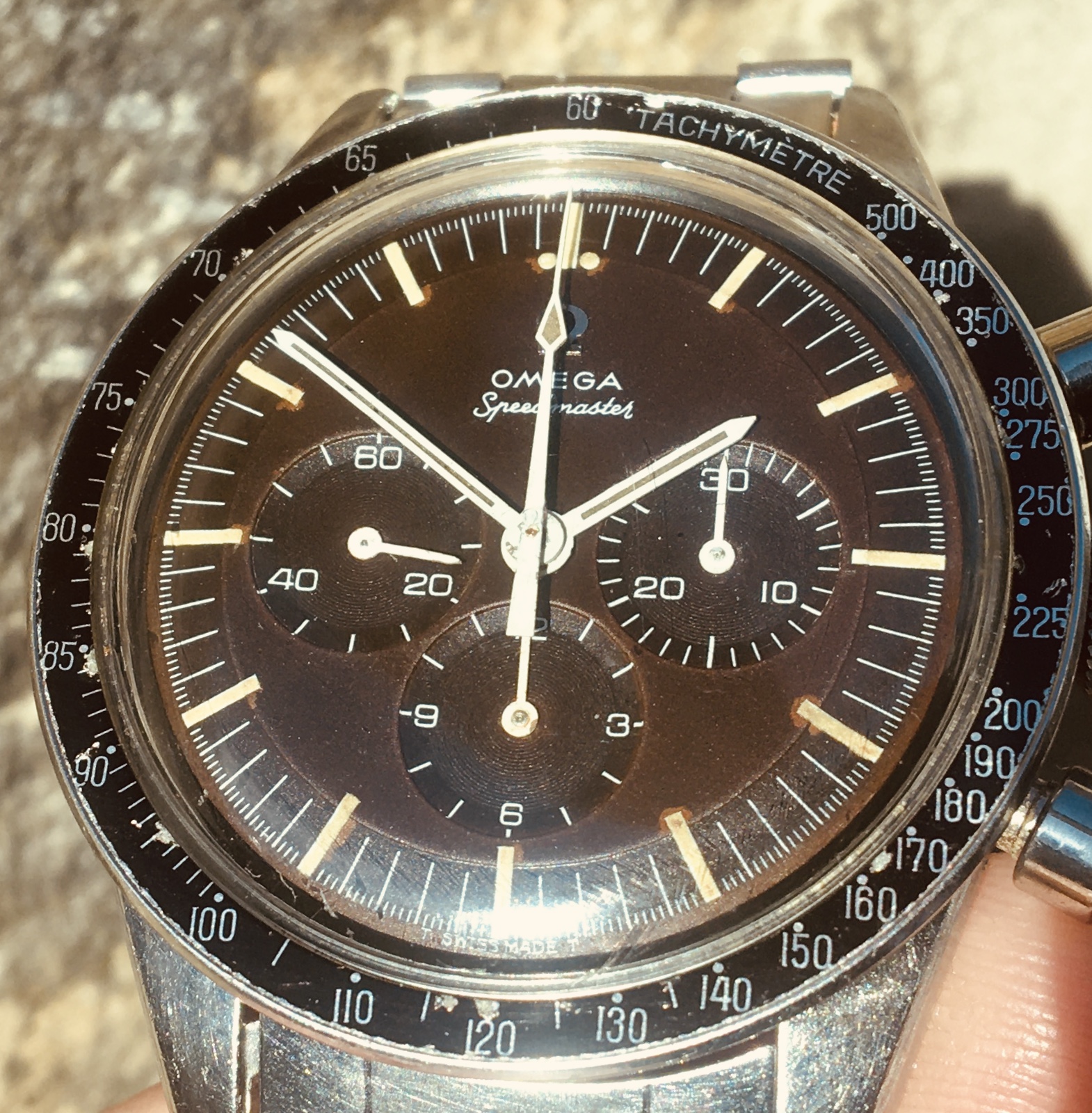

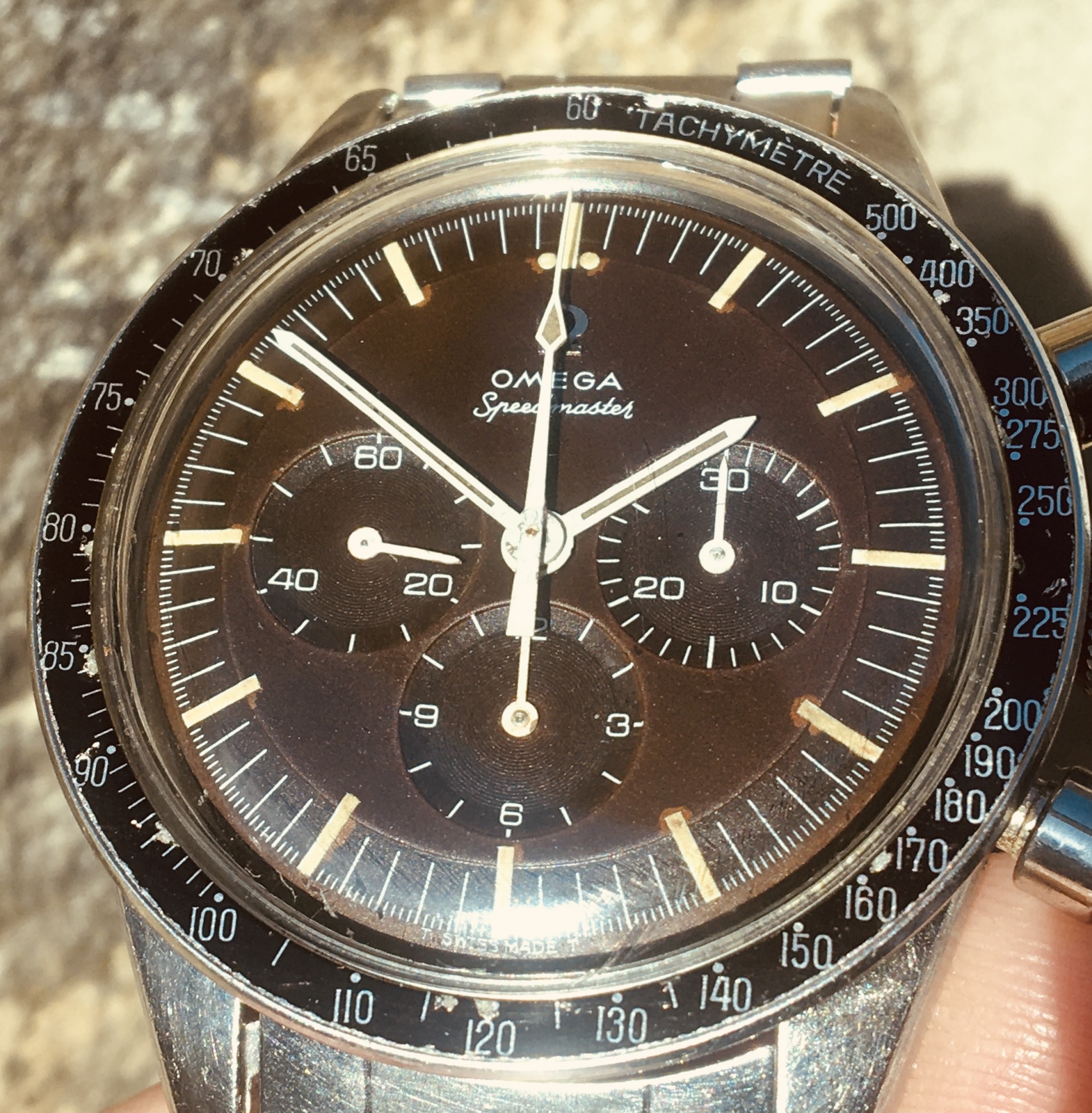

This dial 🥰 thanks again to this forum and the OP to teach us something new every week 👍

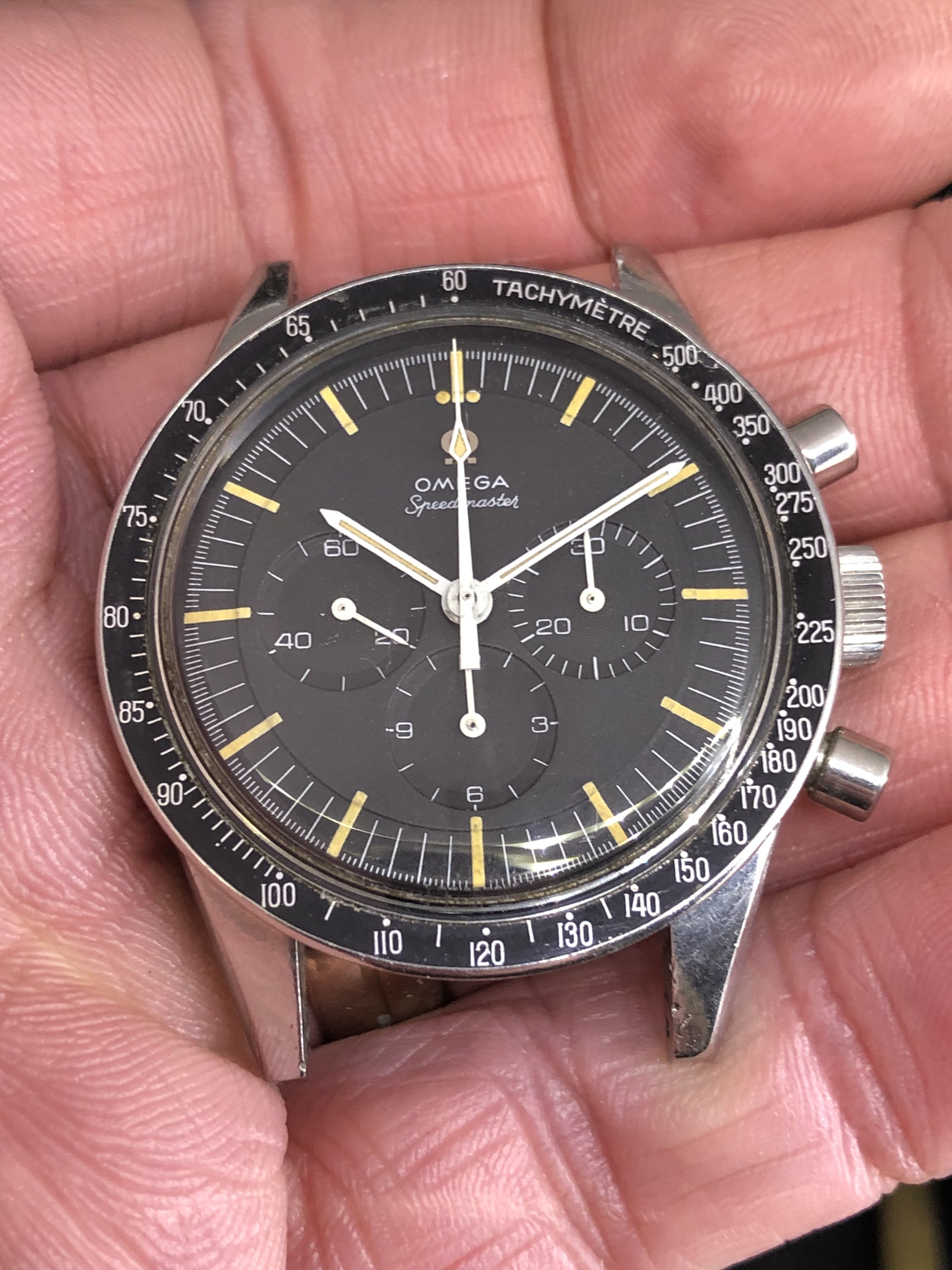

1,522
4,786
And here we have the 3rd Speedmaster 003-SP around 40 digits away from one of the others.
