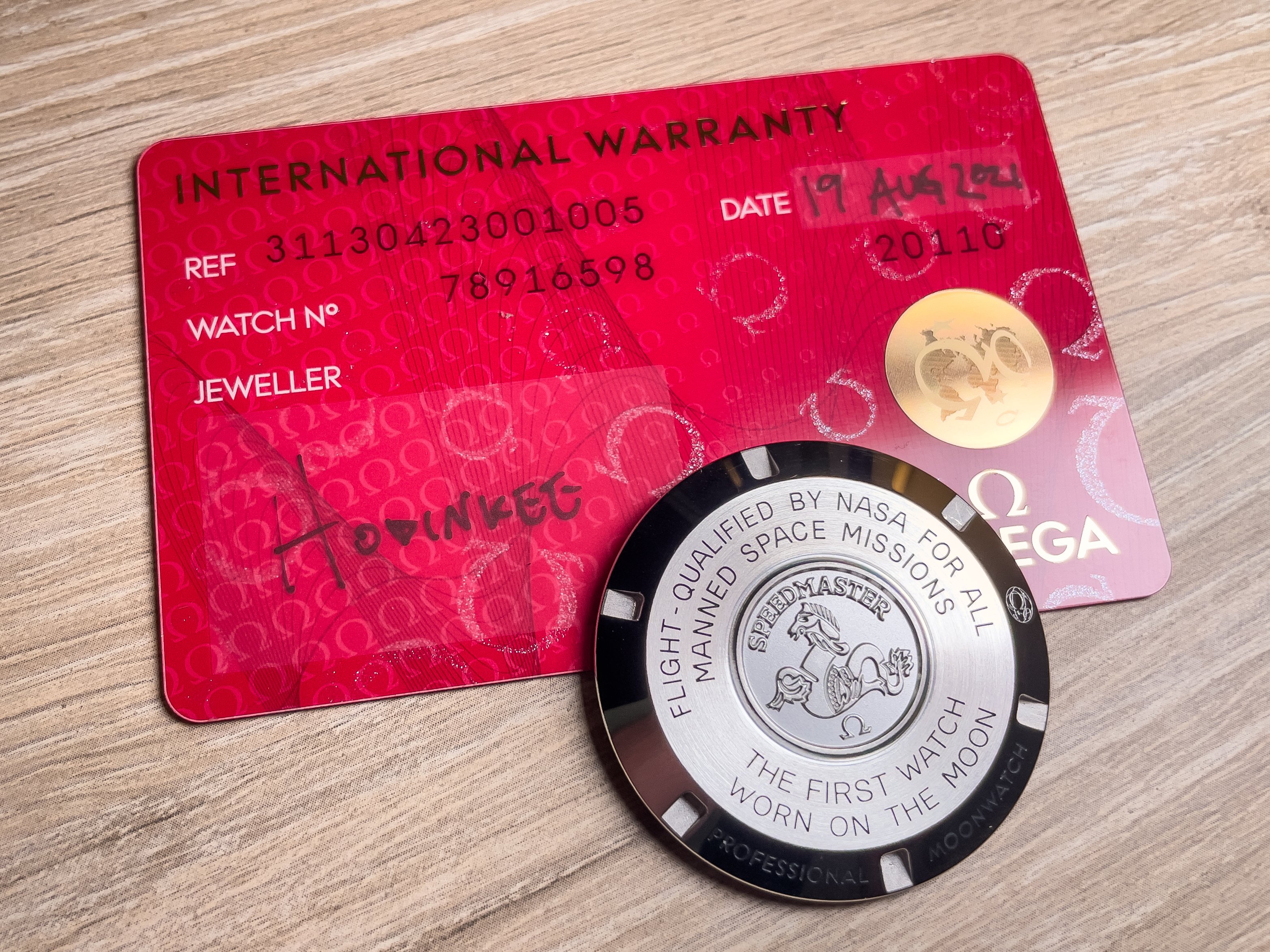

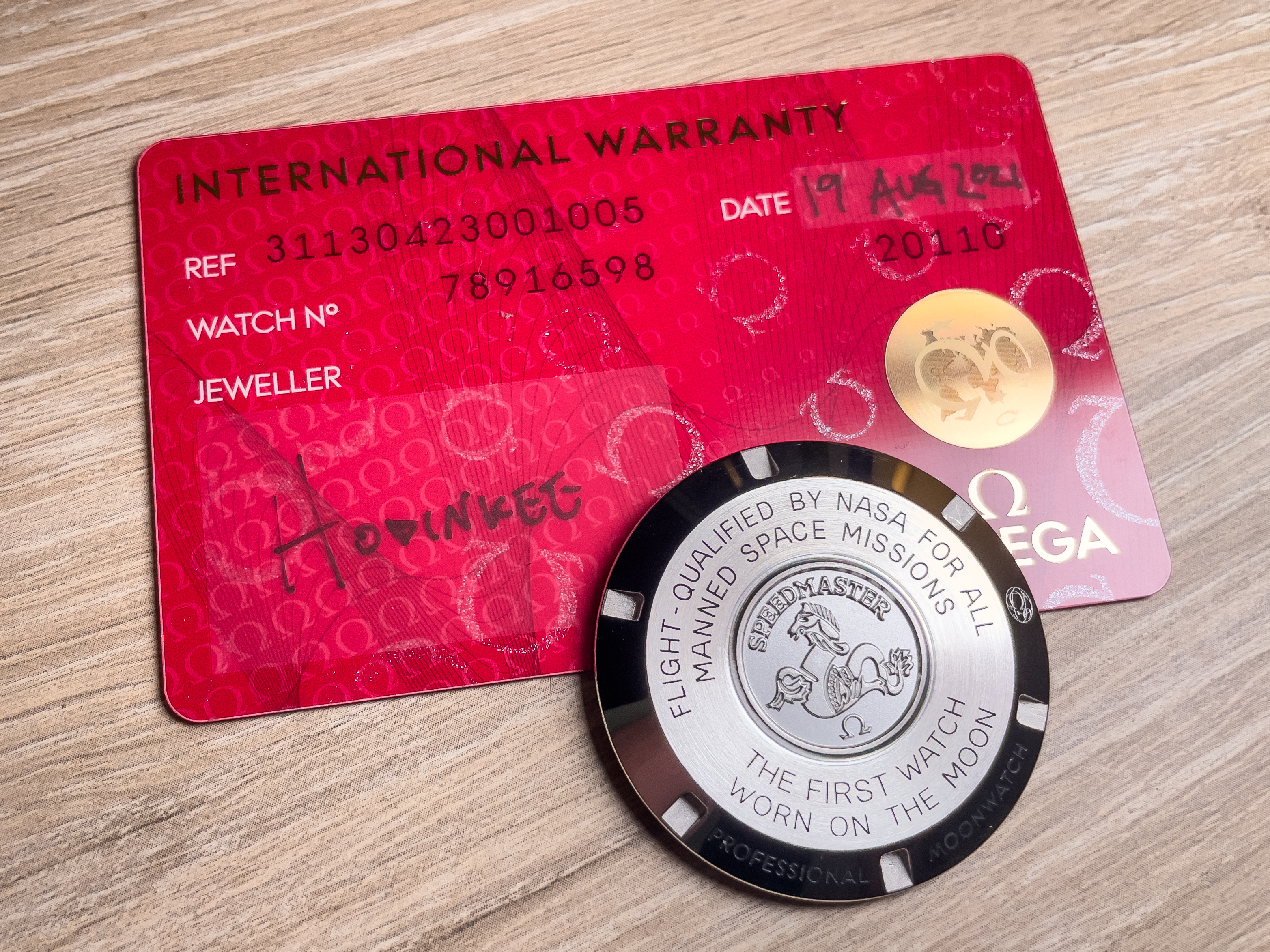

Is Hodinkee making false claims about being an AD?
Hodinkee is a legitimate and official AD. I recently bought a 1861 from them

Hodinkee is a legitimate and official AD. I recently bought a 1861 from them...
Curious, what's with the case-back?
6,609
26,784
I took the pic last week for another thread I had posted it in. I have a sapphire caseback on the watch, which is why the caseback is off to begin with. Instead of pulling my box/warranty card off the top shelf to take a new pic, I reused this one.
