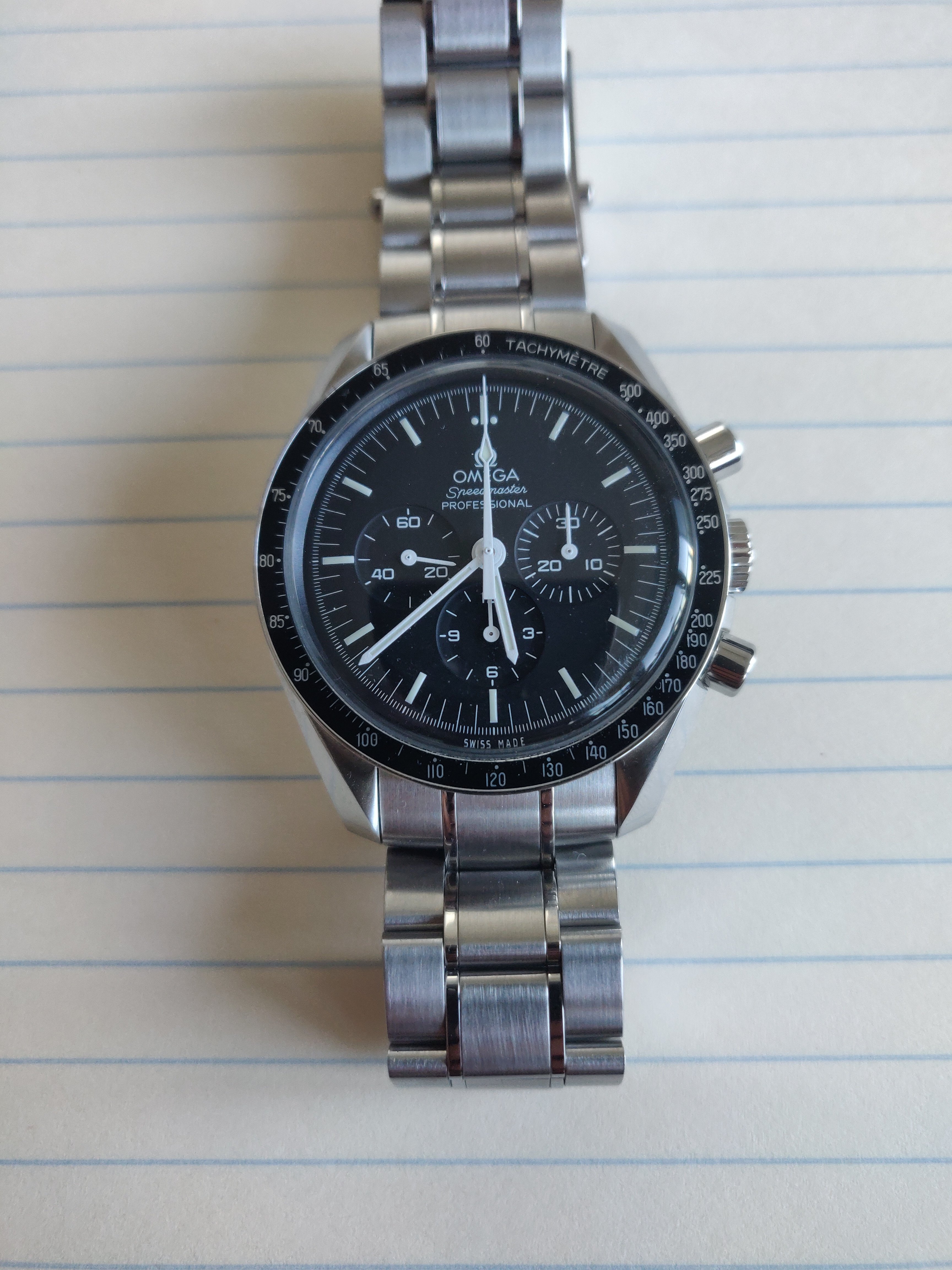

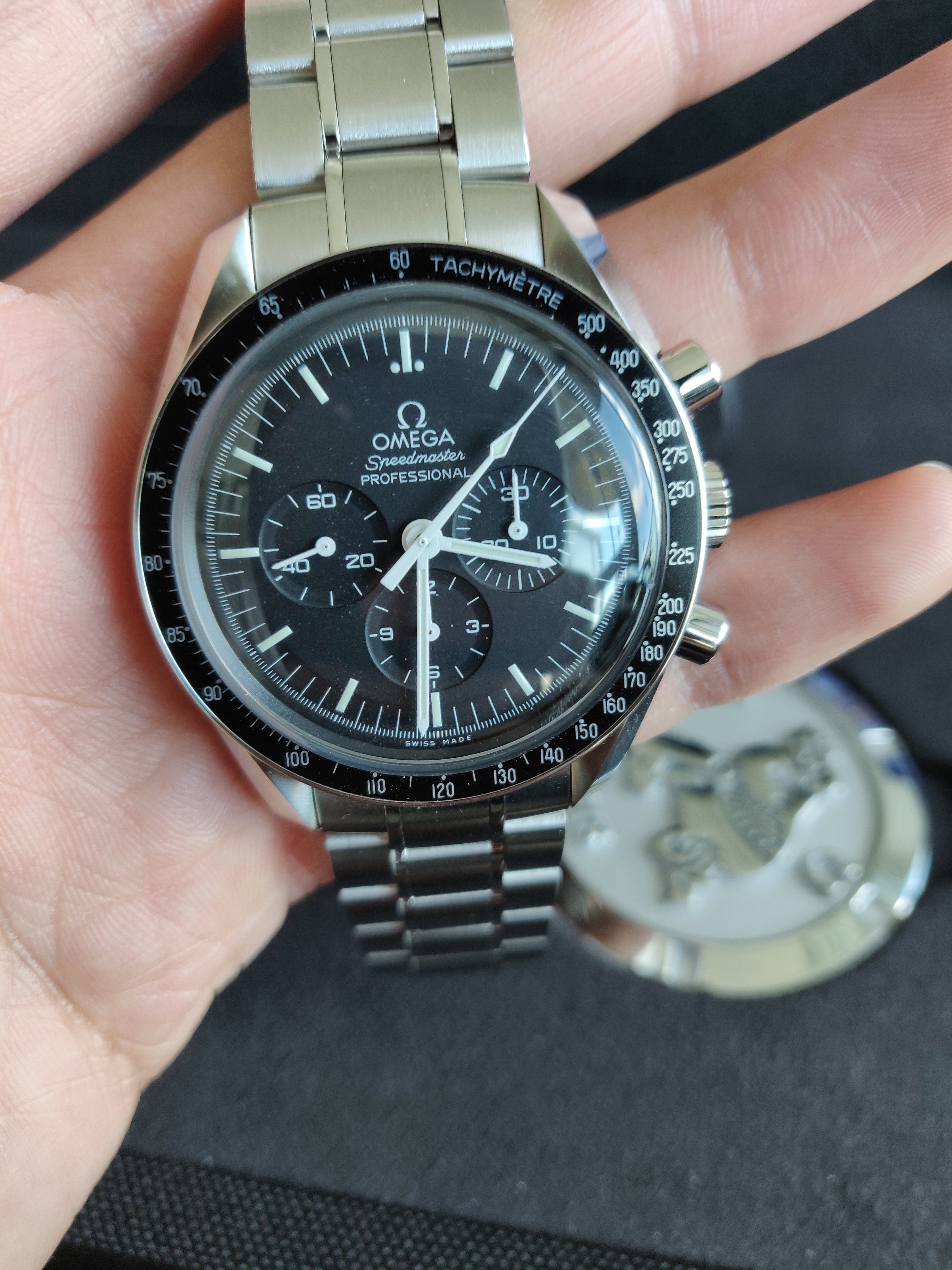

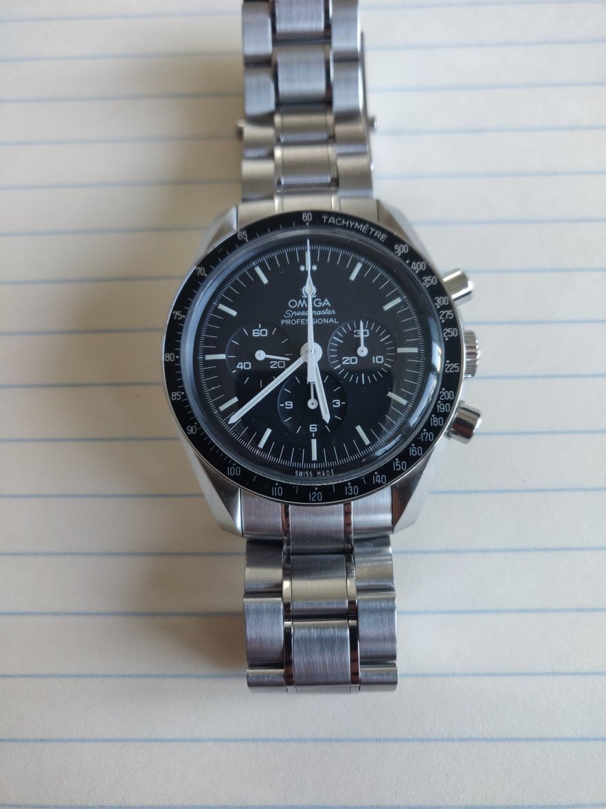

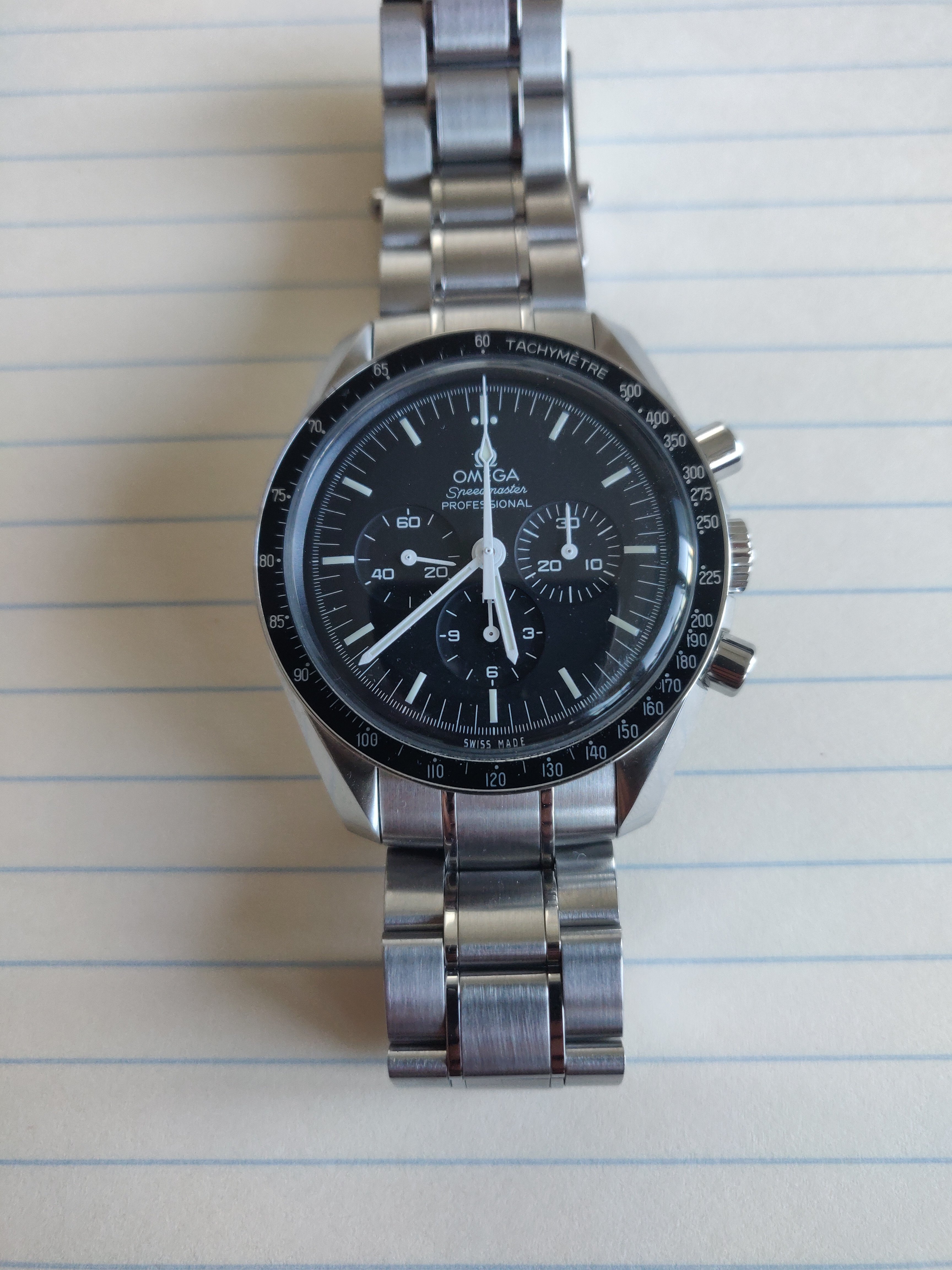

I recently purchasd the outgoing Speedmaster Professional (hesalite) with the 1861 from an AD (7-8 days ago) and I just noticed it has a DON bezel but everything else aligns with the 1861 (strap, dial, hands) .... but i have this sinking feeling if I was pushed a altered watch. it is absolutely mint (i took off all the plastic covers everything)... Due to the pandemic the transaction was done curbside ..however i have receipts , full box and papers.
Is there anyway there could have been a transitional model with such a bezel? (My guess is no)..
Just really puzzled .. have contacted omega as well.
Some pics for reference..

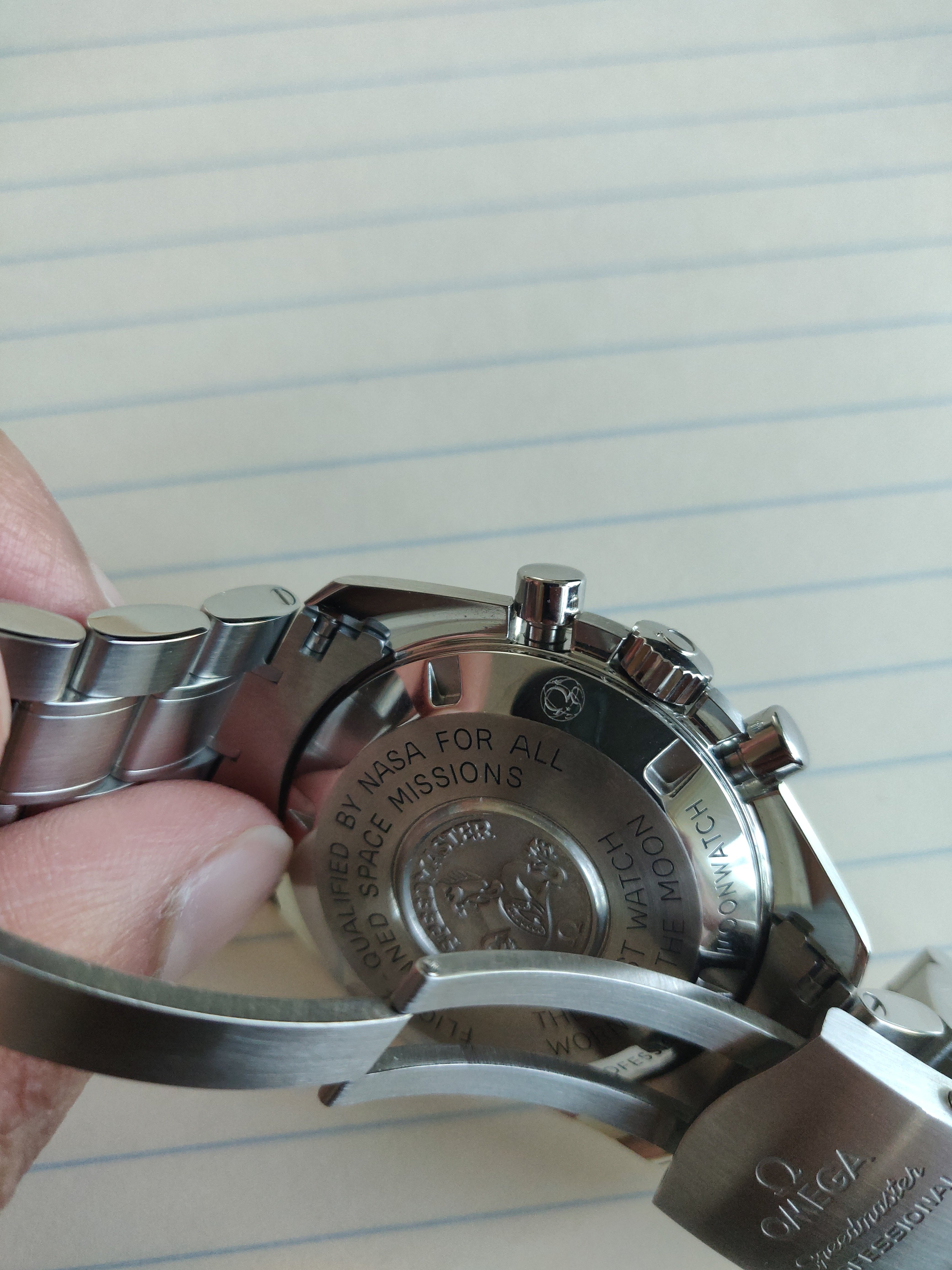

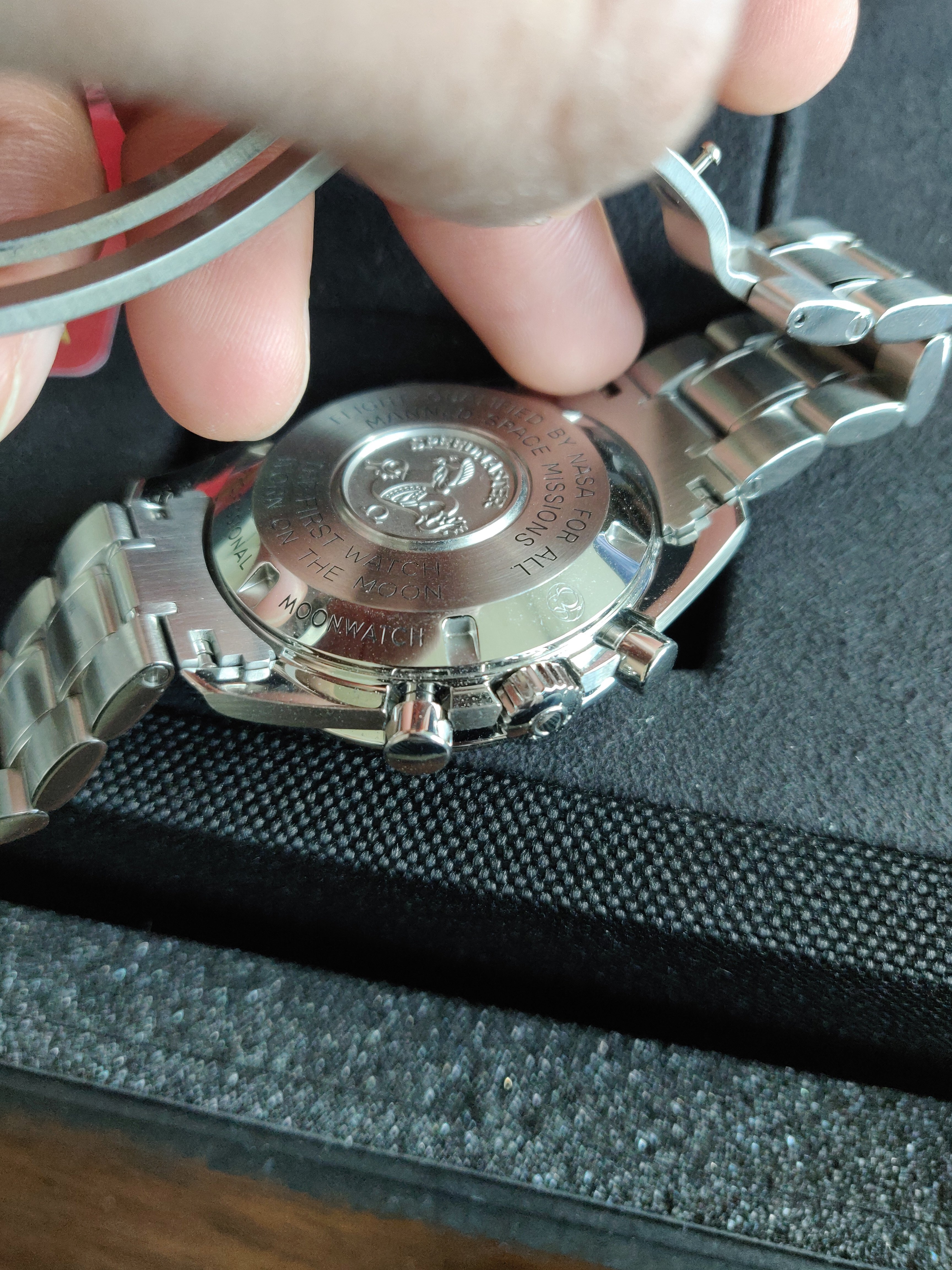

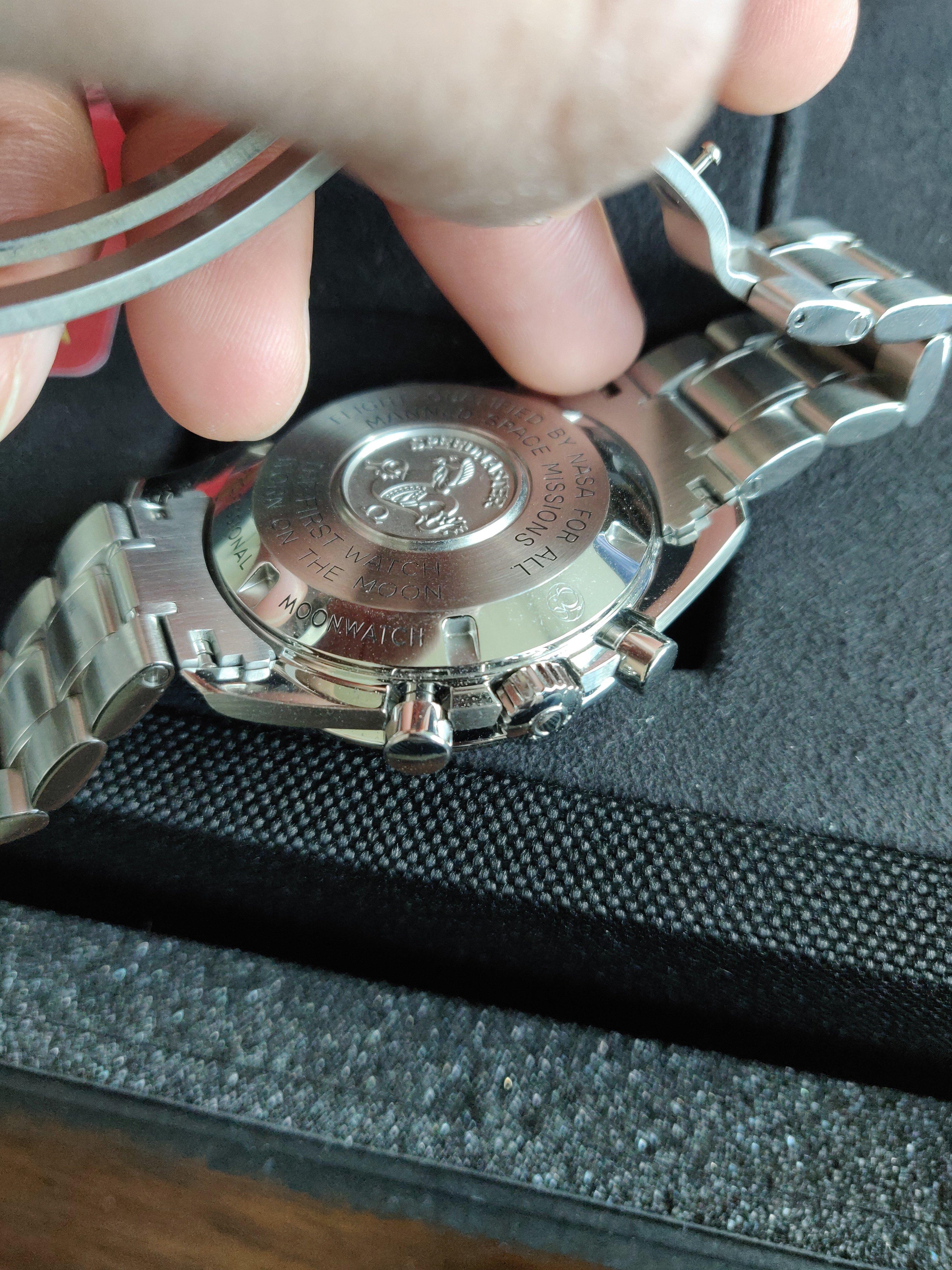

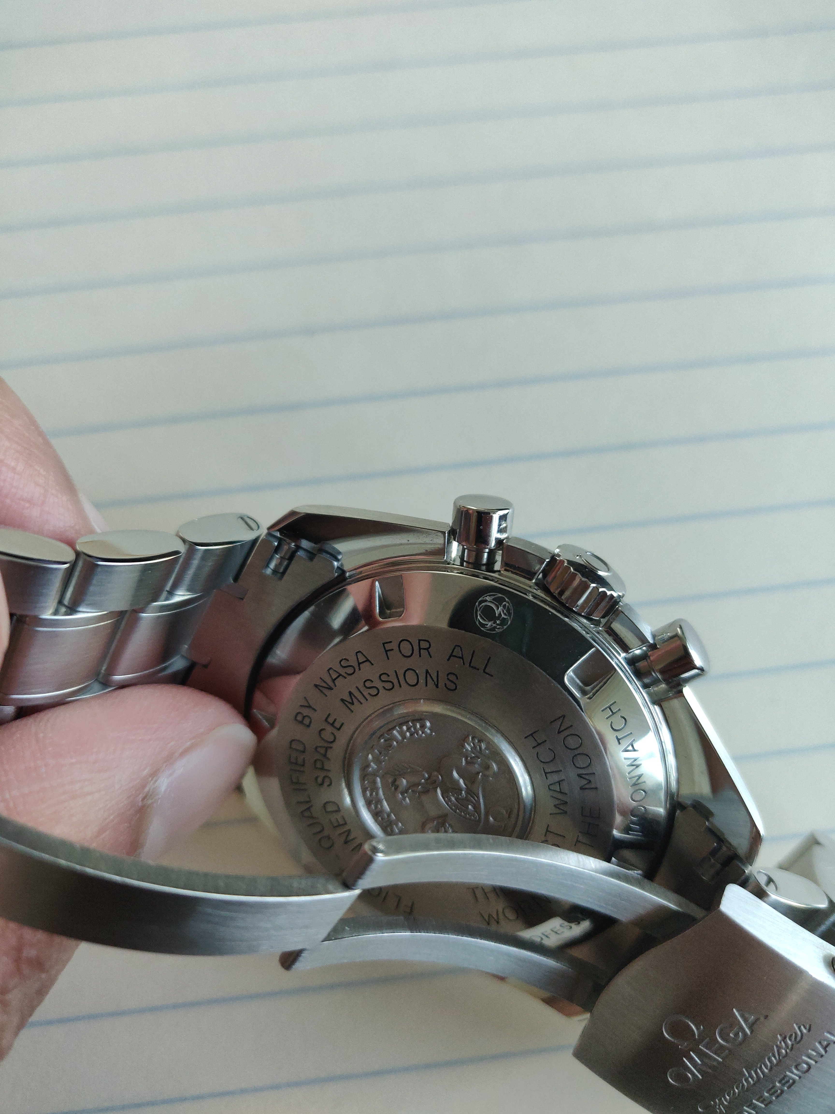

Can we see the caseback?

I have some doubts about that bezel.
Can you explain? AD can slip a watch with a fake/ swapped bezel just like that?
Bezel is the same as the 3861.. how it's on a brand new 1861 is beyond me...

I'm wondering if OP got the 3861 at a hefty discount
Wrong case, wrong bracelet, wrong dial for 3861.
I doubt retailer changed bezel, could be honest mistake from factory. It happens. We've all seen vintage watches with quirks, and we conclude something was changed over the years, but perhaps the true answer was it came from the factory that way for whatever reason. Like OP's watch. Occam's Razor.

How does something like this pass QC at Omega.. don't get me wrong I'll be happy to own this if it's genuine omega mistake .
And then how does AD have the time and intent to find a new bezel and install it and risk getting caught cheating a customer?

I received the serial number via PM, and have confirmed that it is for a 31130423001005.
Strange one for sure.

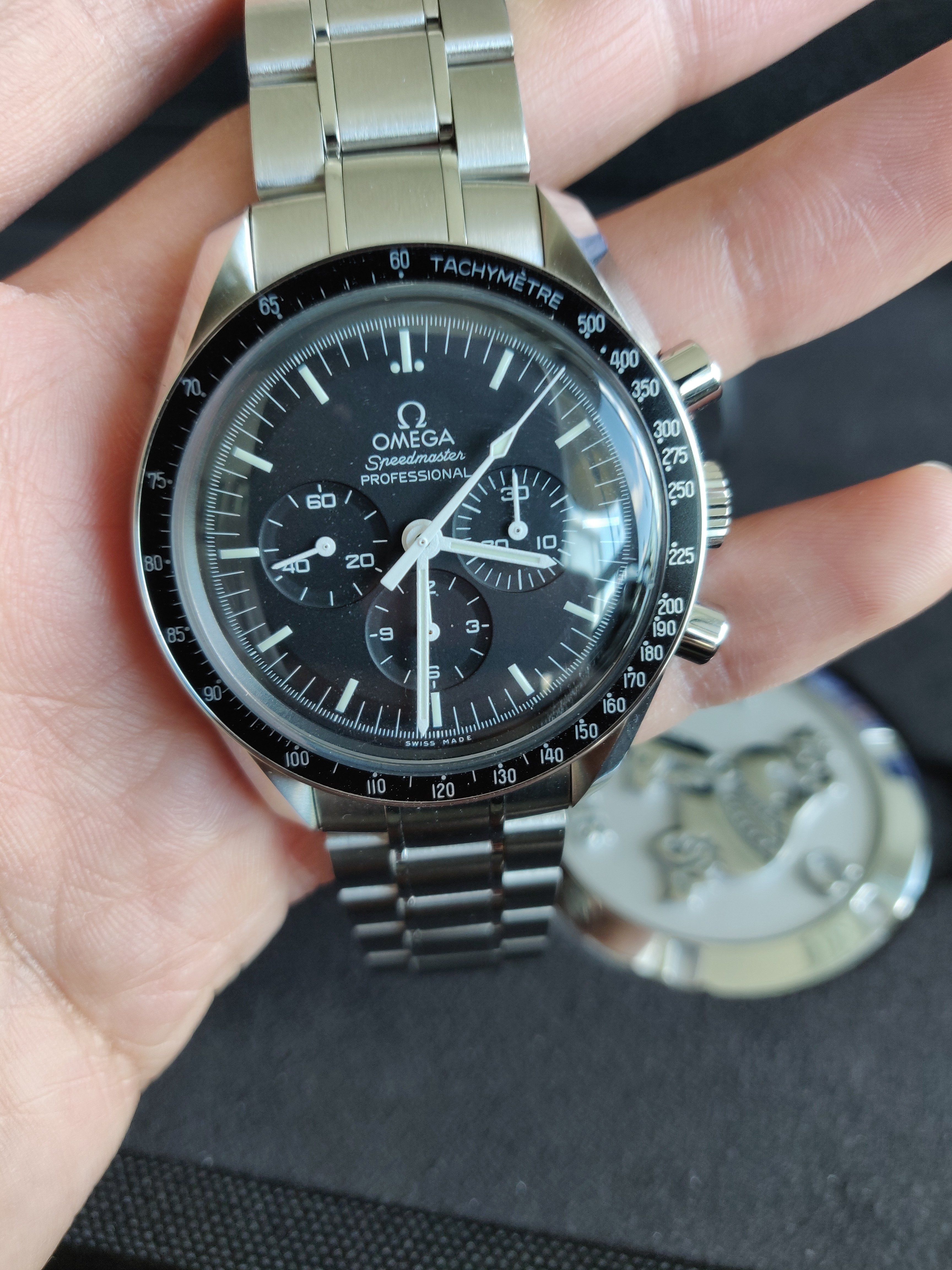

Can there be any tell tale sign of the bezel being swapped? ...I looked very closely it indeed looks like the 3861 bezel.

No real sign if the swap is done properly. My guess here is that the bezel may have been damaged, and someone ordered a replacement, but ordered the wrong thing.
