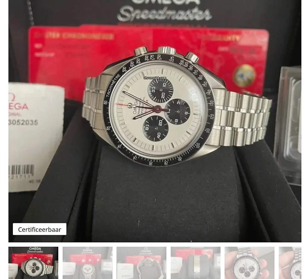

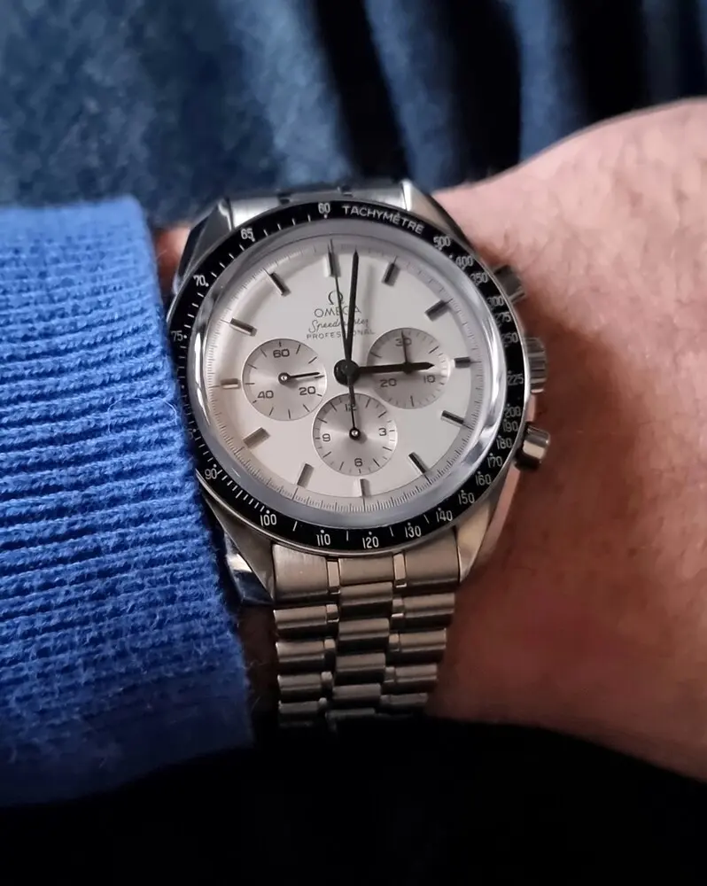

Here are two modded 3861 Speedmasters
You can view those photos with context at this link,
The answer is yes, but it won’t necessarily look good as you can clearly see the dials edge in both of those mods.

I don't know much about the 3861 models, but are both of those examples the sapphire crystal versions (e.g. from the polished links)? Possibly a mod could see better results if it has the hesalite with black tension ring to blend out some of the edge?
The bottom line is the dial was made for the 1861 and will fit the 1861 and 1863 the way it should, but will not fit the 3861 the way it should.
The second one is clearly a sapphire model as you can see the “milky ring”. Given the 11k price tag associated with the first one, and the polished/brushed bracelet, it’s reasonable to assume it is also the sapphire version. A black tension ring will only mask the issue and make it harder to see at a glance, but it will still be there. IMHO, this mod doesn’t look great as the parts aren’t entirely compatible. They may “fit” but they don’t fit well together.
