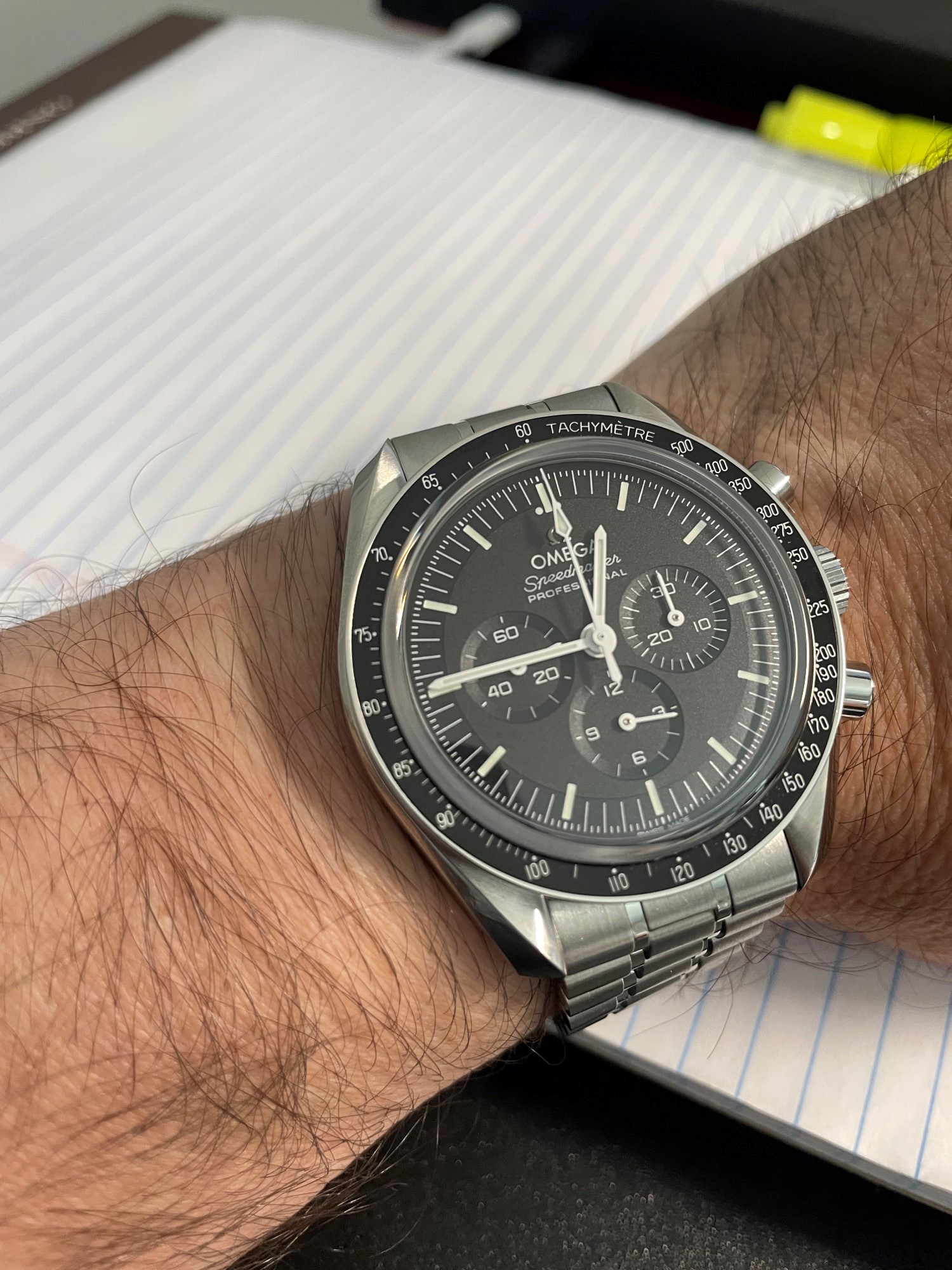

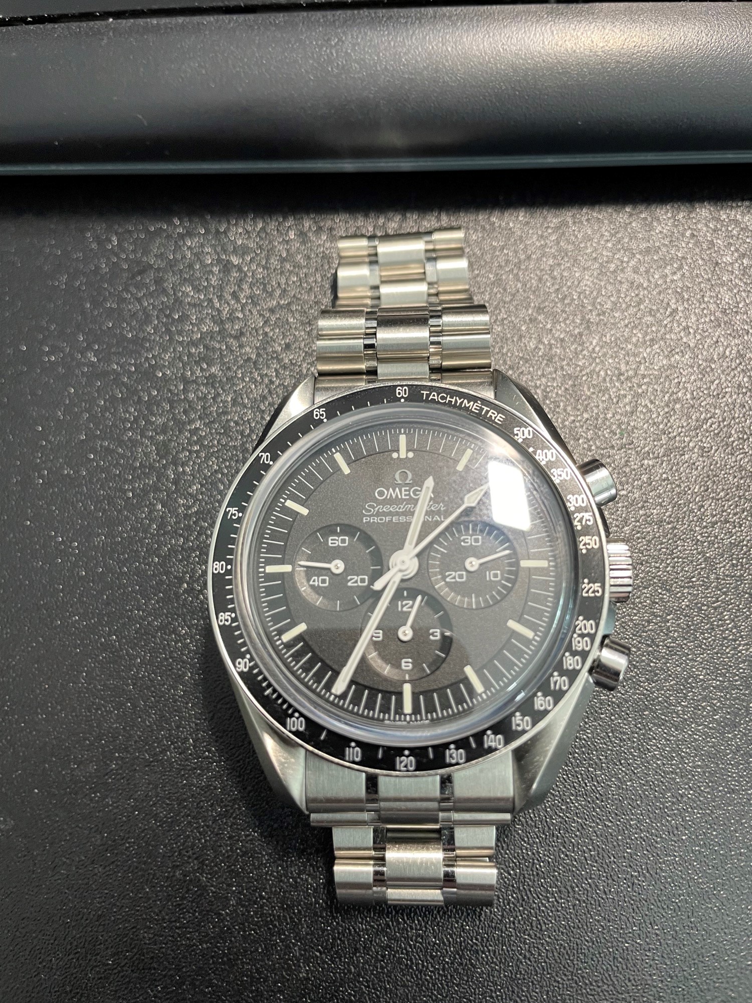

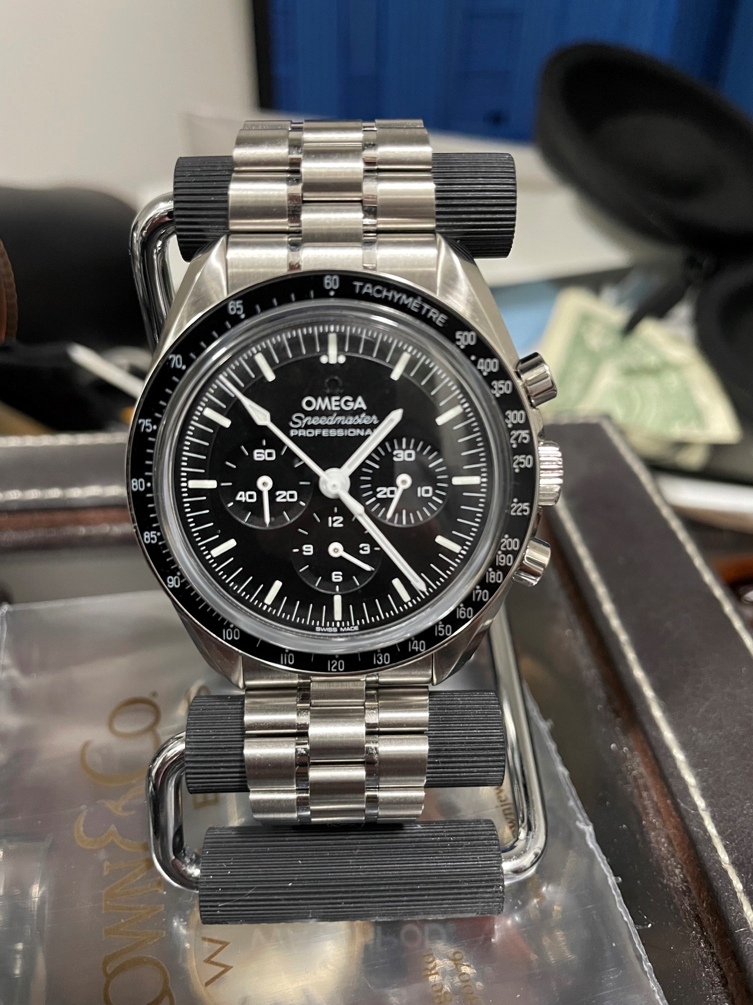

im not sure if i understand your question or issue on the watch correctly. may i ask if the long center seconds hand and the short minute hand of the right (3 o'clock) chrono subdial reset perfectly align to 12? thanks.
140
208

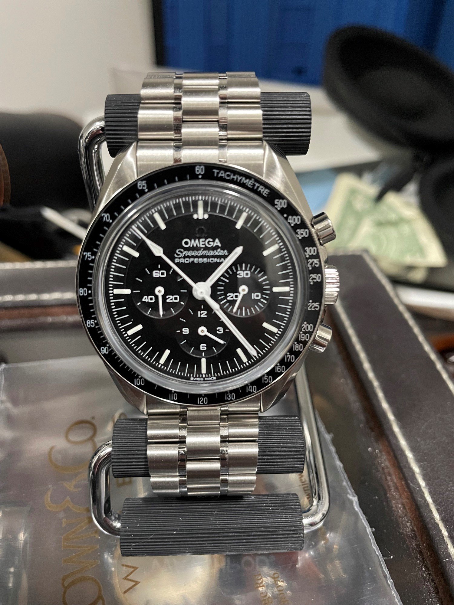

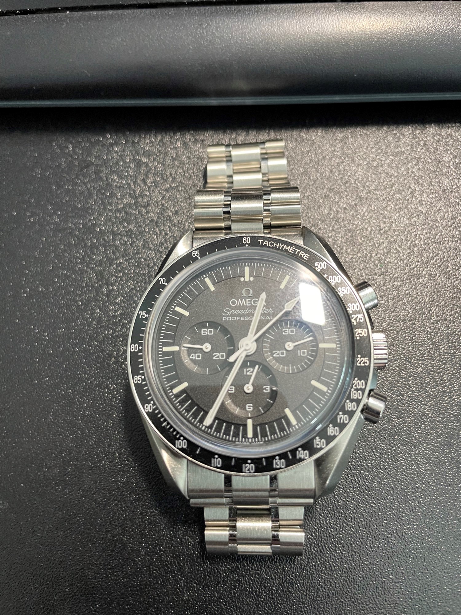

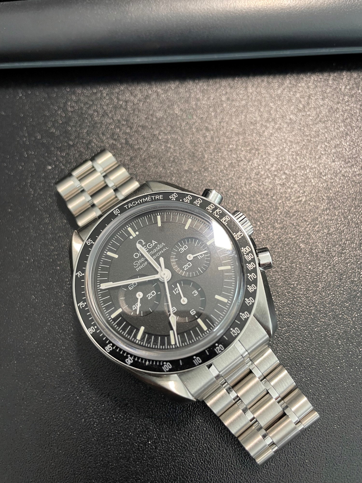

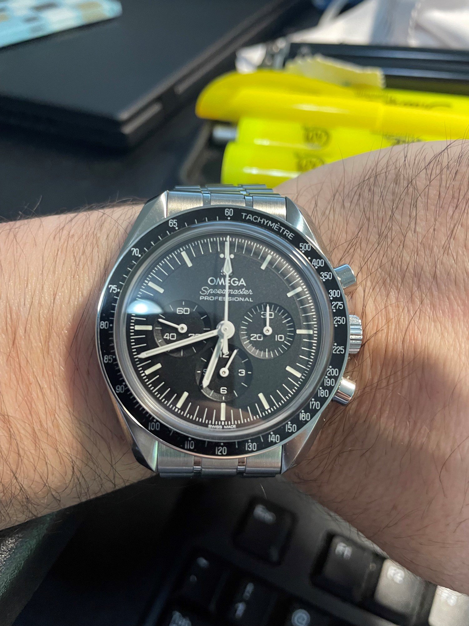

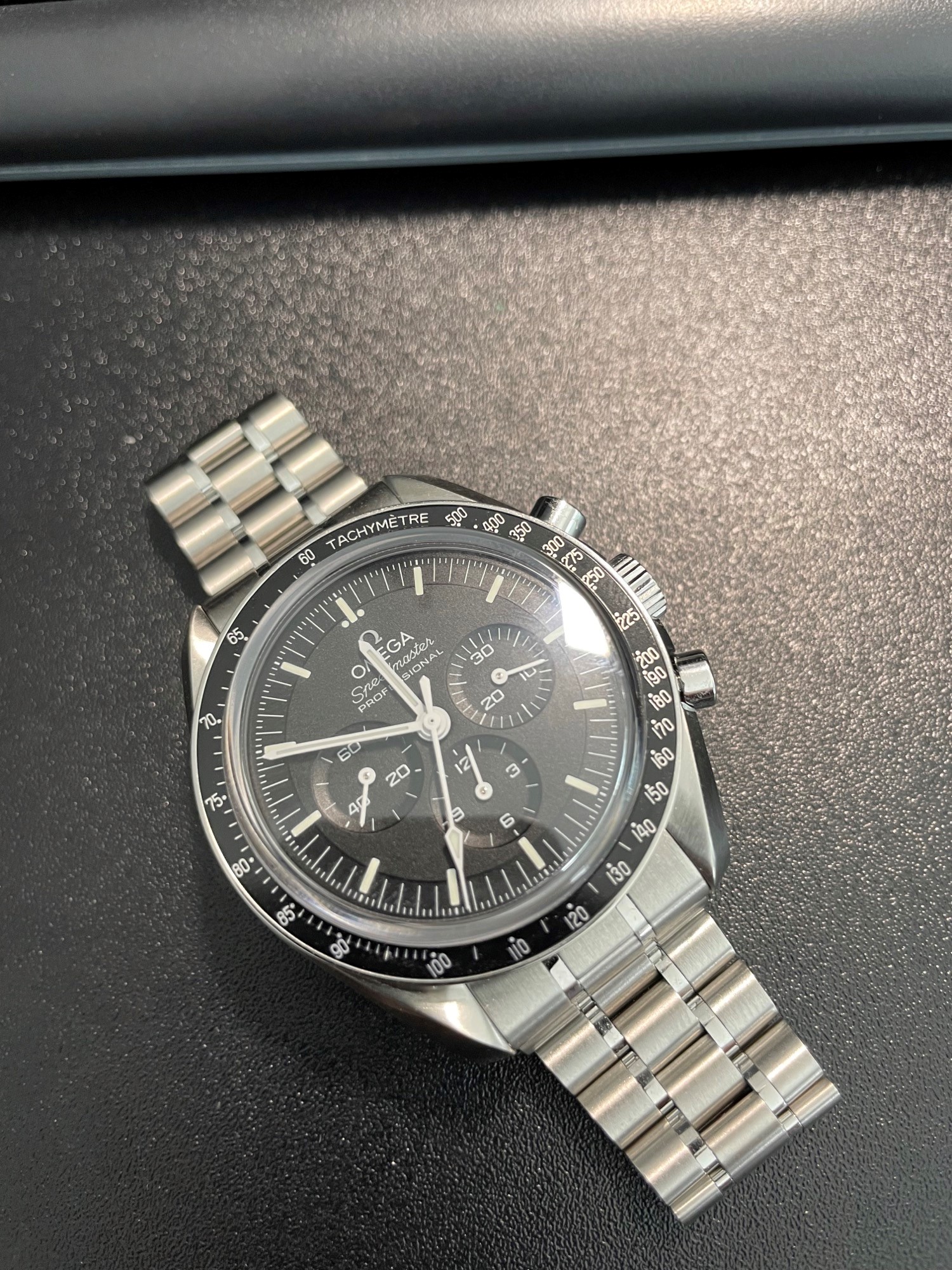

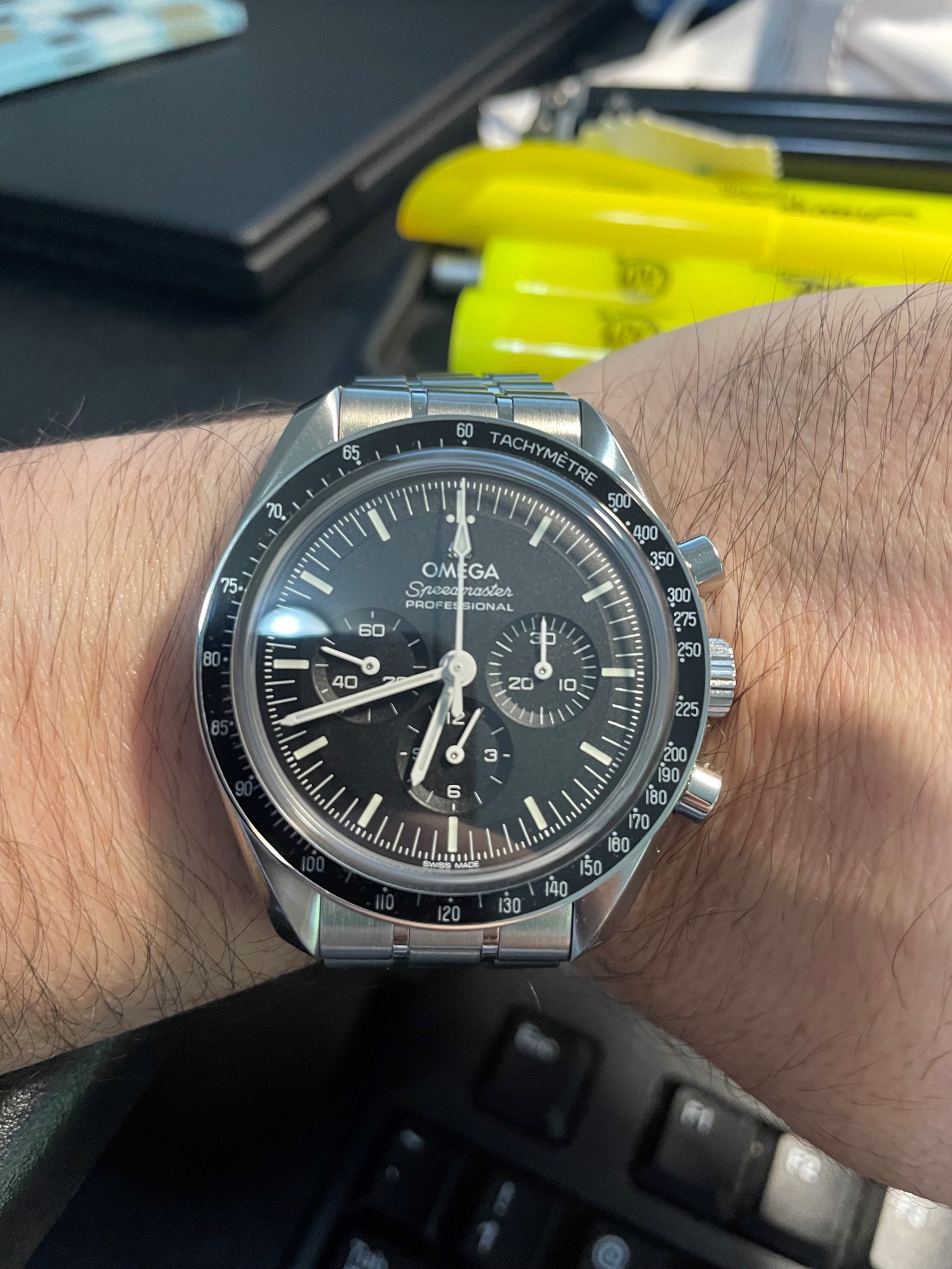

@Screwbacks
It's two different watches. The chronograph seconds hand and chronograph minute timer sub-dial work correctly in both and reset perfectly to 12. It is the chronograph hour timer (6:00 sub-dial) that is not functioning correctly for either.
For the first picture, the chronograph has been reset. As you can see, the hour sub-dial did not reset. It took 3-4 pushes to get it to reset all the way to zero. And then, as is shown in the second picture, the chronograph hour sub-dial would run independently even if the chronograph wasn't engaged. The watch was about one day old. That watch immediately went back.
For the third, fourth, and fifth pictures -- that is the replacement watch. The running of the hour sub-dial for this one bore no real relation to the amount of elapsed time. For example, in the third picture, the chronograph sub-dial is just about to the one-hour mark, while the chronograph has only been engaged six minutes. And then to top it off, engaging the chronograph intermittently causes the entire movement to seize.
