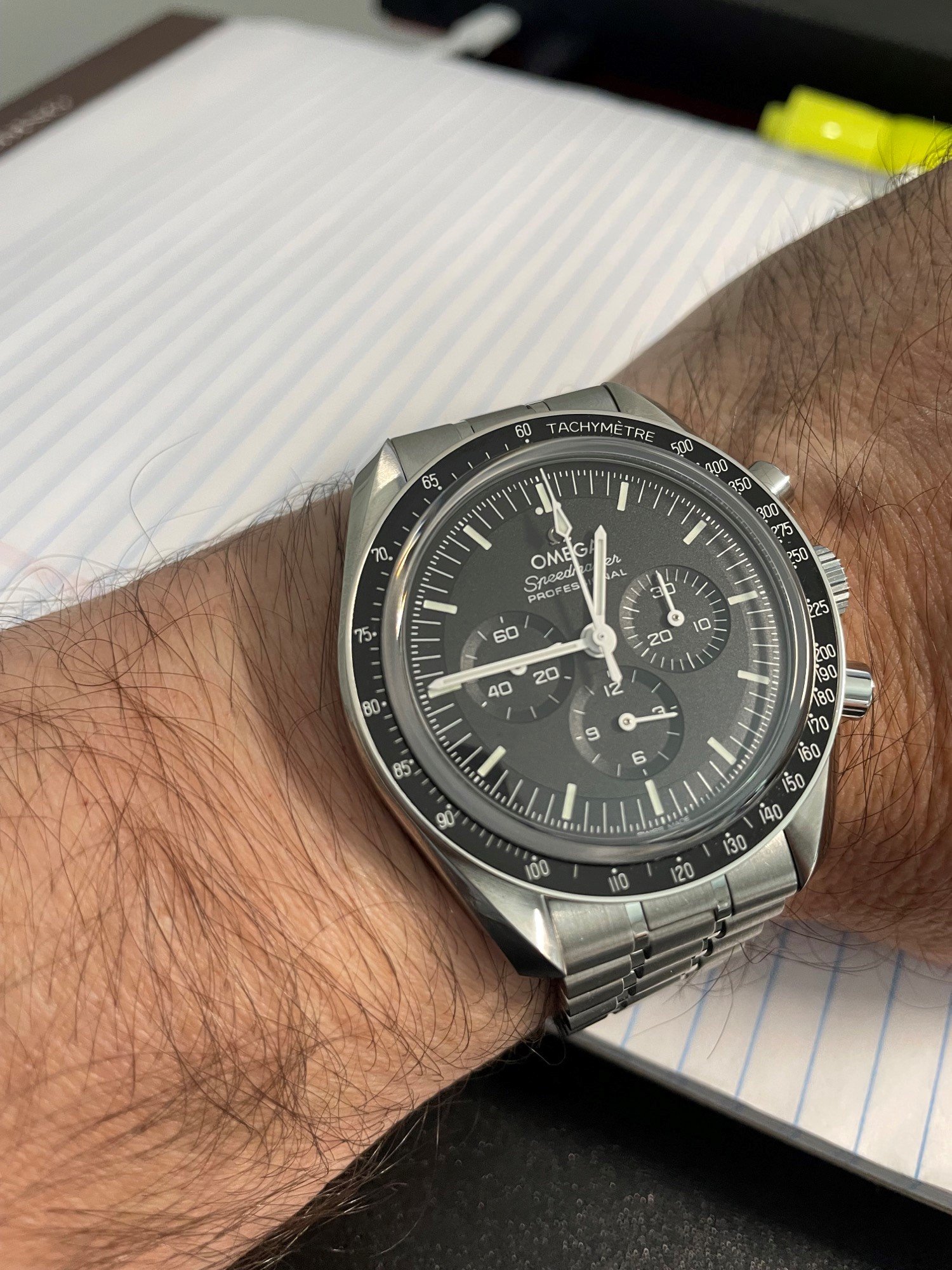

I ordered from a well regarded online AD, watch shows up, I take it to the OB in town to get it sized, start wearing it, and the hour sub-dial is a hot mess from the very first day. It doesn’t reset to zero unless I really jam on the chrono reset button (which is not a definitely not something you want), and then when it does reset, it runs independently of the chronograph being engaged (also not something you want). You can see the issues in these photos.

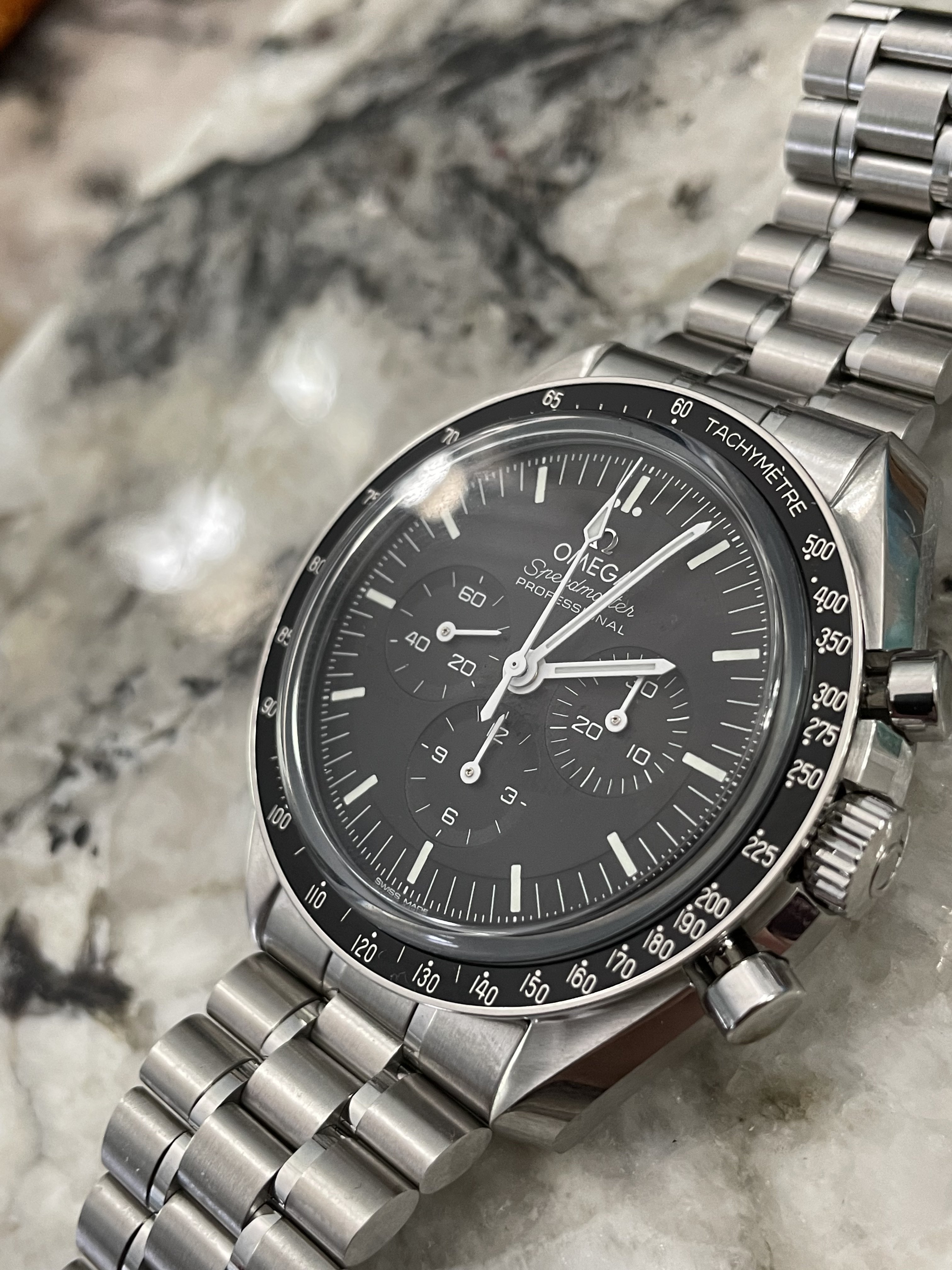

Because I’m a bit OCD (not being facetious, I actually have OCD), I notice on the replacement that the hour sub-dial doesn’t reset all the way perfectly to zero. Instead it’s probably 4-5 minutes off. I start looking online, at this forum, and elsewhere, and see this is really common with Speedies, older and brand new. As I ponder this, on day 3 of ownership, I hit the 3861 jackpot, and engaging the chrono - on a full wind or 3-4 hours after a full wind (and, I own several manual wind watches; I know what a full wind is, which for the 3861 was about 50-60 turns for me) causes the movement to seize for about 10-15 seconds. I then realize I have the 3861 “issue,” and at that point the hour sub-dial just starts going crazy. Take a look at these photos, The first one is at 6 minutes, not 36 minutes.
The next one is 9 minutes, not 39 minutes.

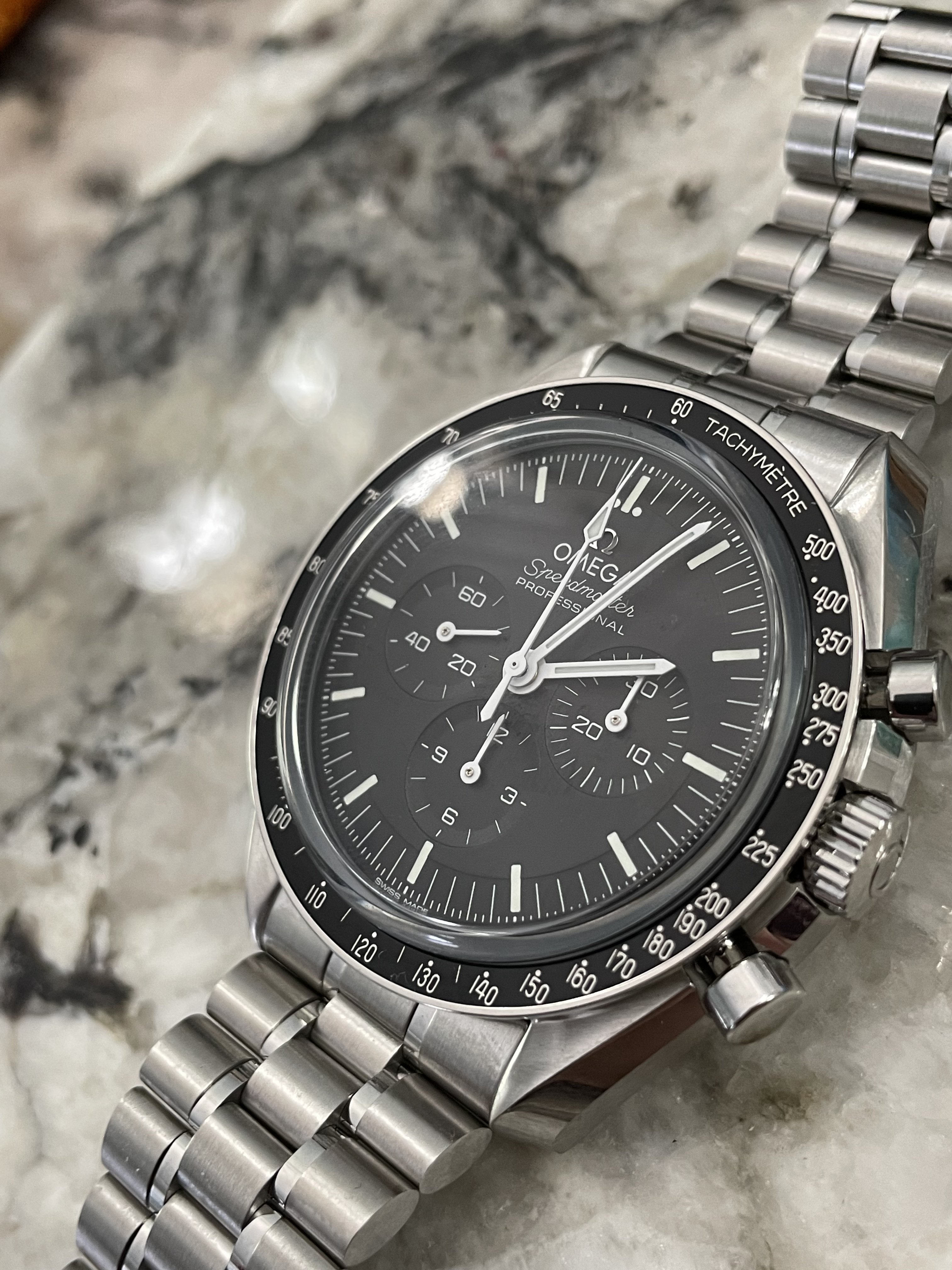

The one I after, I will let you guess, is that 3 hours and 47 minutes, or 4 hours and 17 minutes? Not sure I even know.
