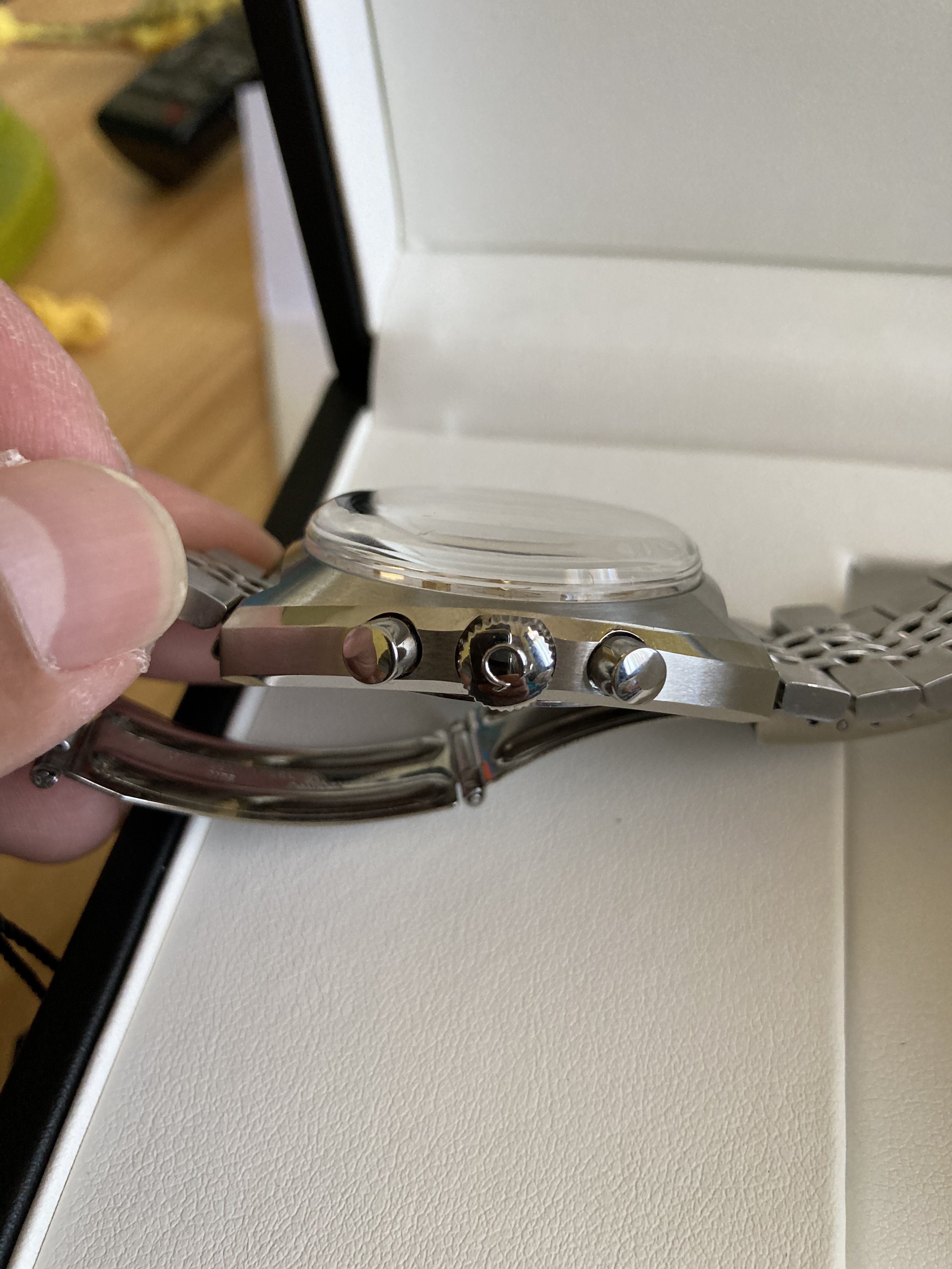

Besides that, your watch looks good. I think that crown is not original to this reference, though. And that bracelet, but this has already been mentioned.
The same dial has been for sale on ebay lately and the hands are available from Omega -> depending on what's inside it can be a whole put together pile of parts or an all correct watch with a bogus seller listing. We'll know more when you'll show more. 👍

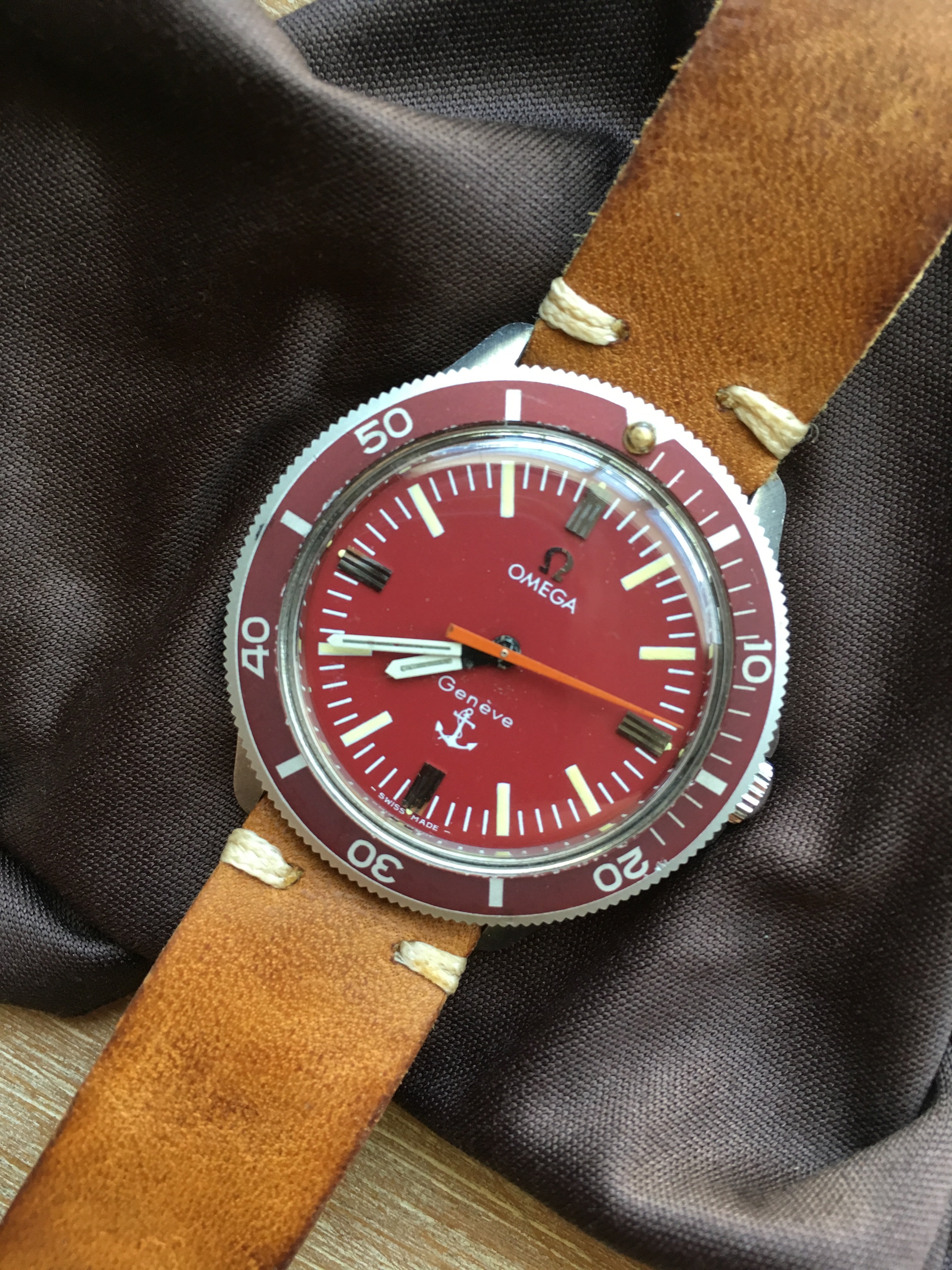

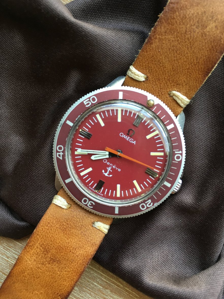

Side note... as crazy as this fiasco has been, it's been fun reading and investigating(thanks to all you guys)... the fun sometimes in watch collecting is the "hunt". Here's a watch I searched for a looong time but eventual sold early this year for someone else to enjoy 😀.

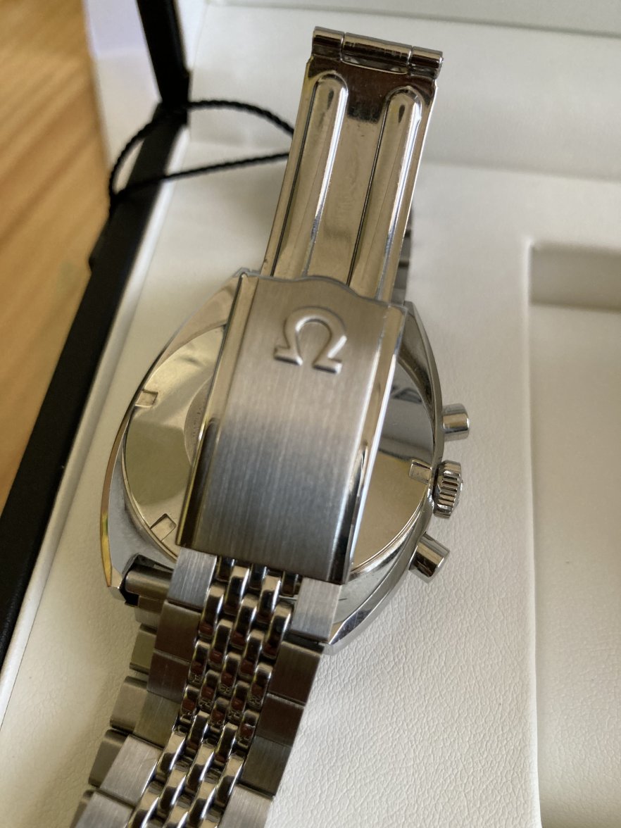

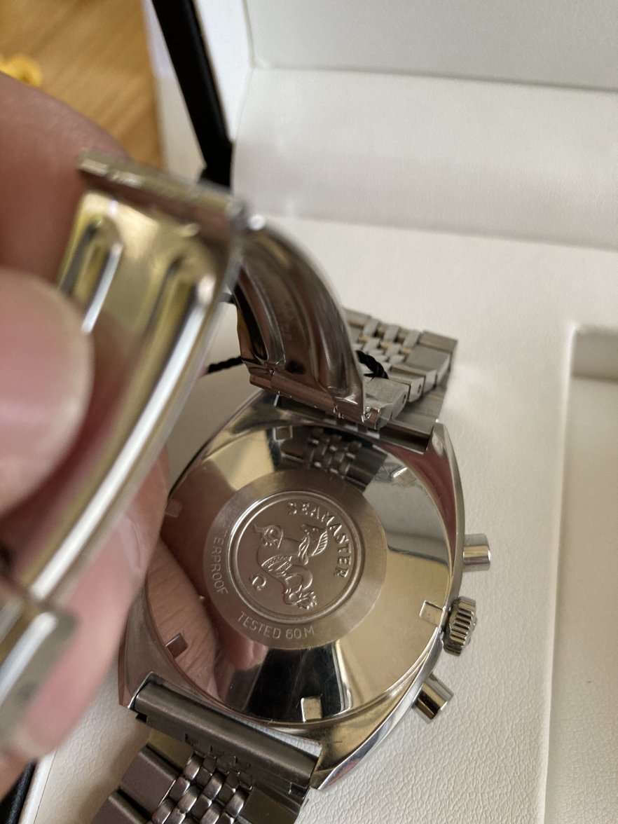

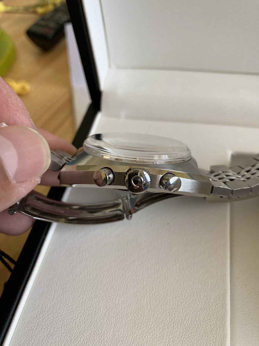

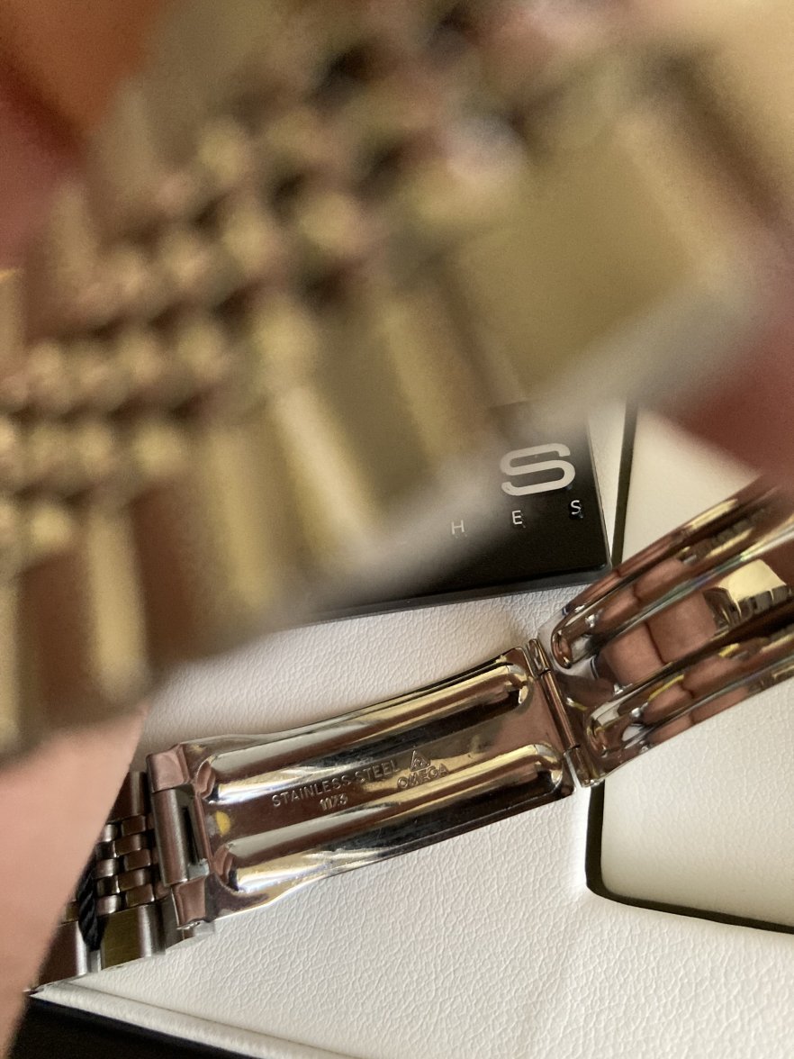

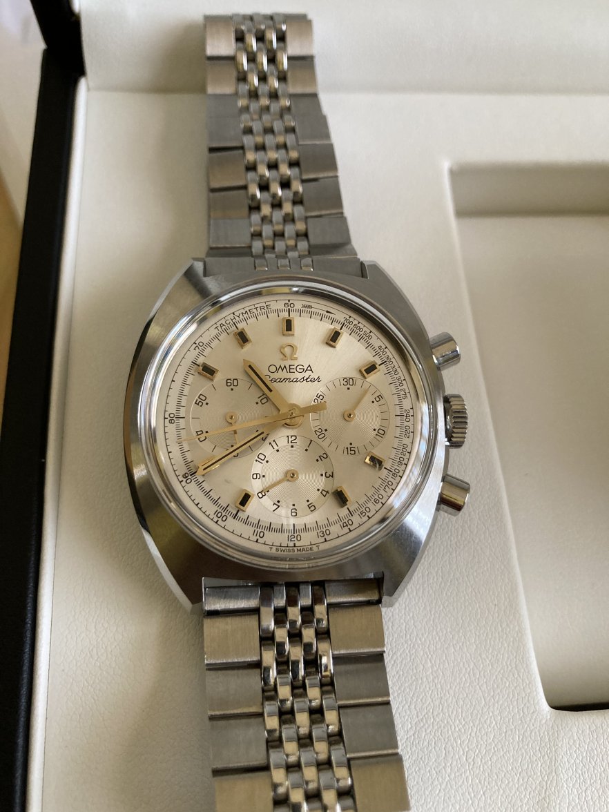

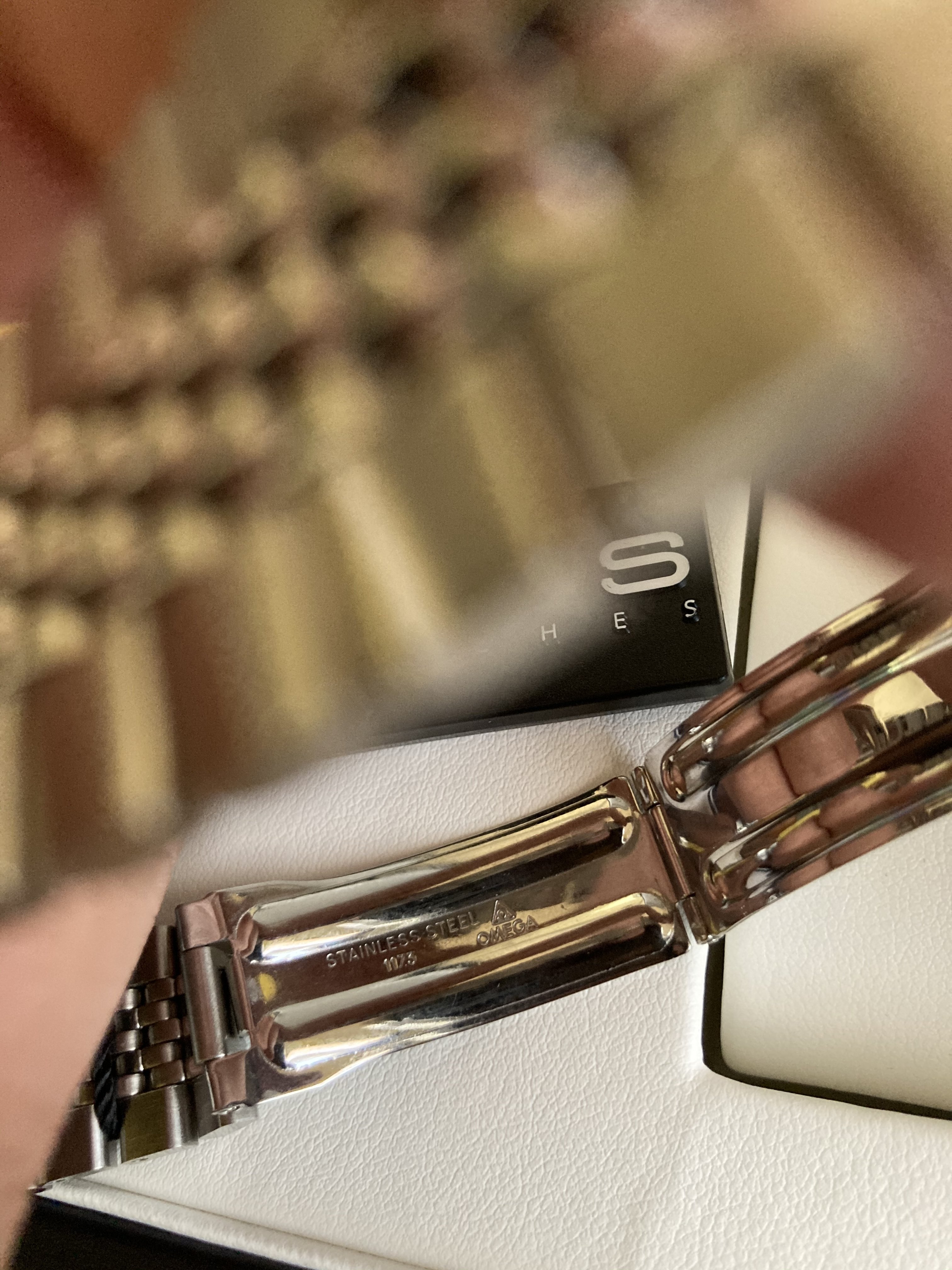

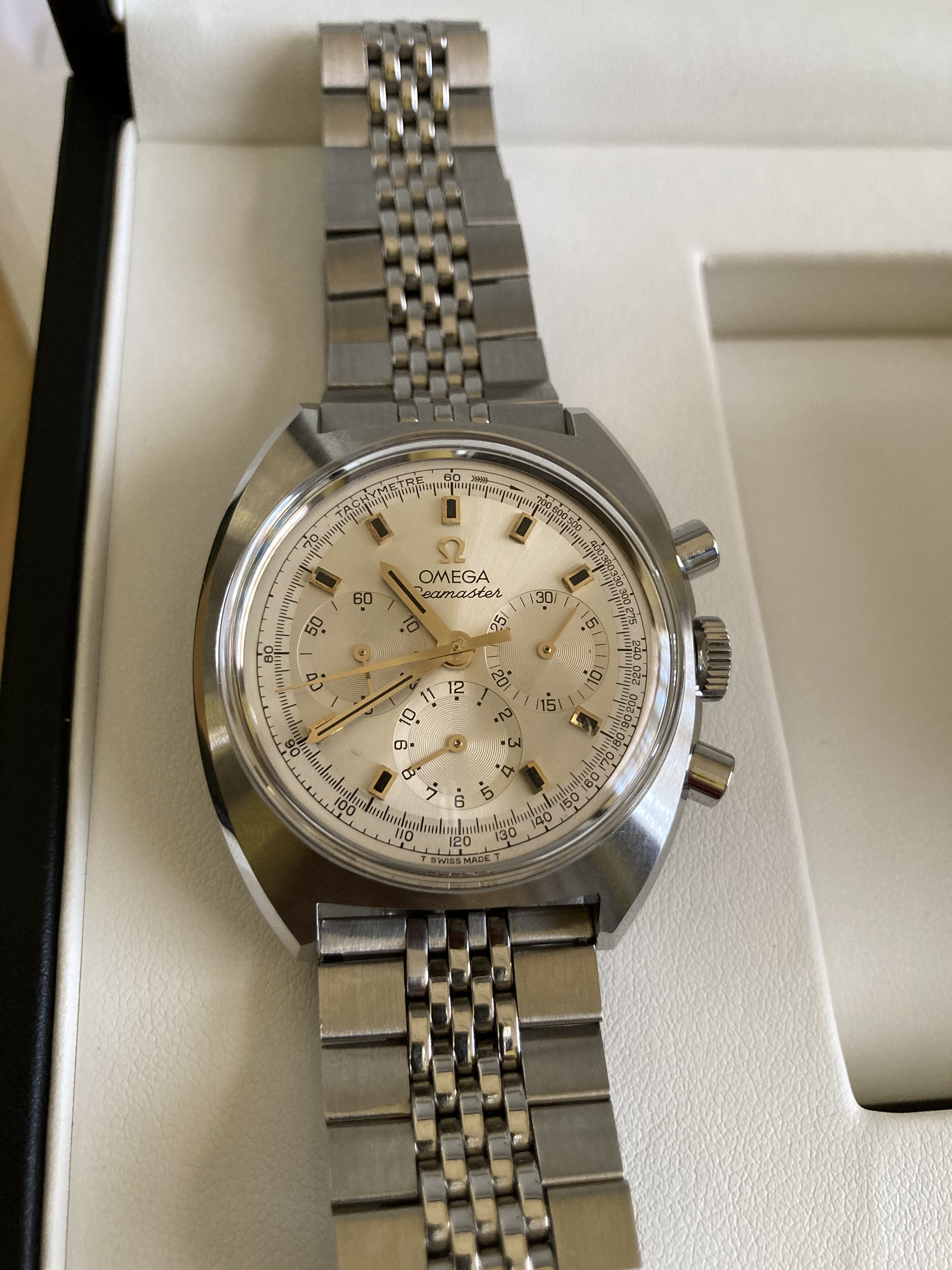

It arrived! Lemme know whut u think. Heading to Omega AD right now to look it over as well.
24,836
55,255
The case is in incredible condition. Can you confirm that the hands and dial furniture are gold? Or is it the lighting?

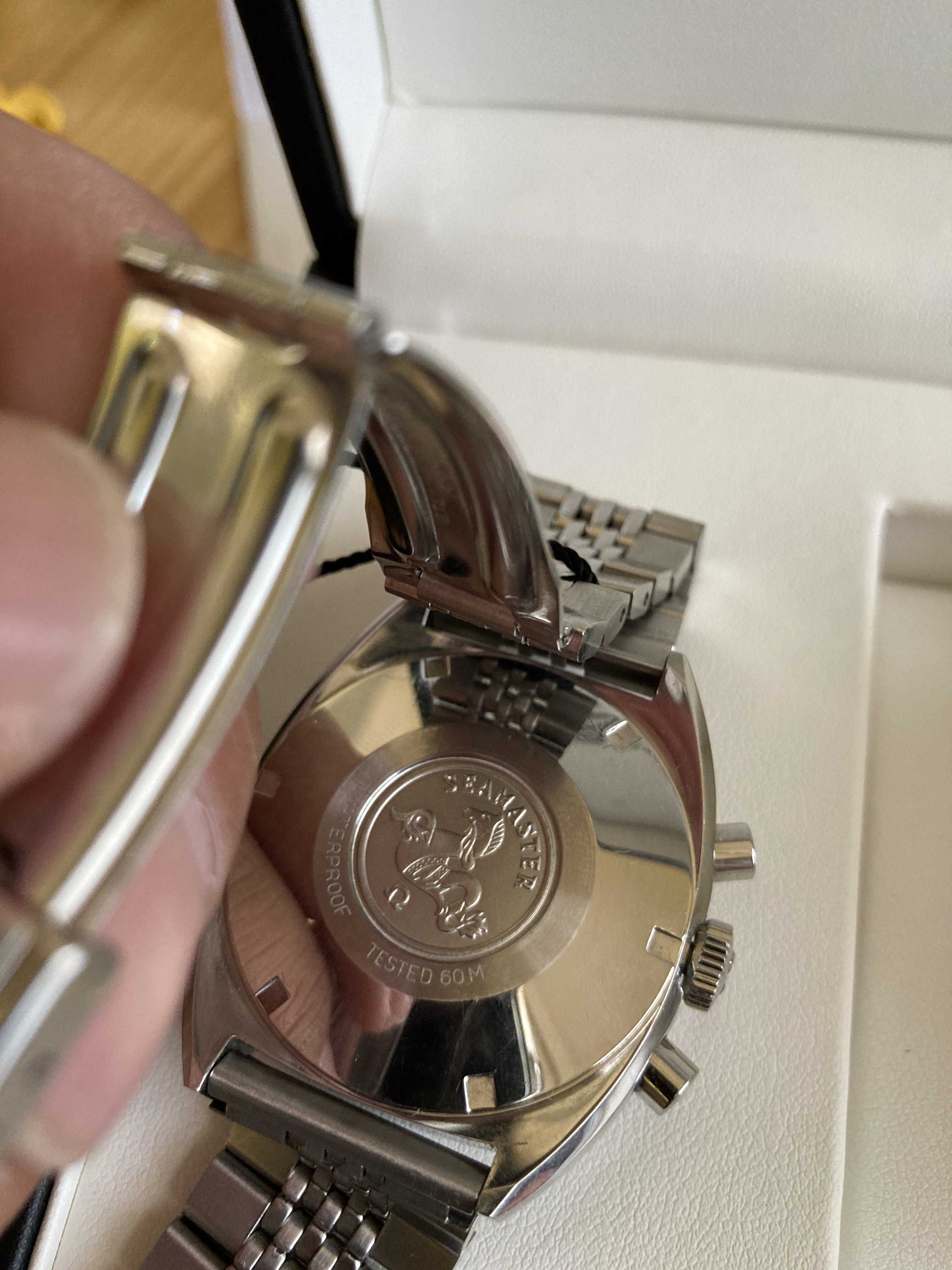

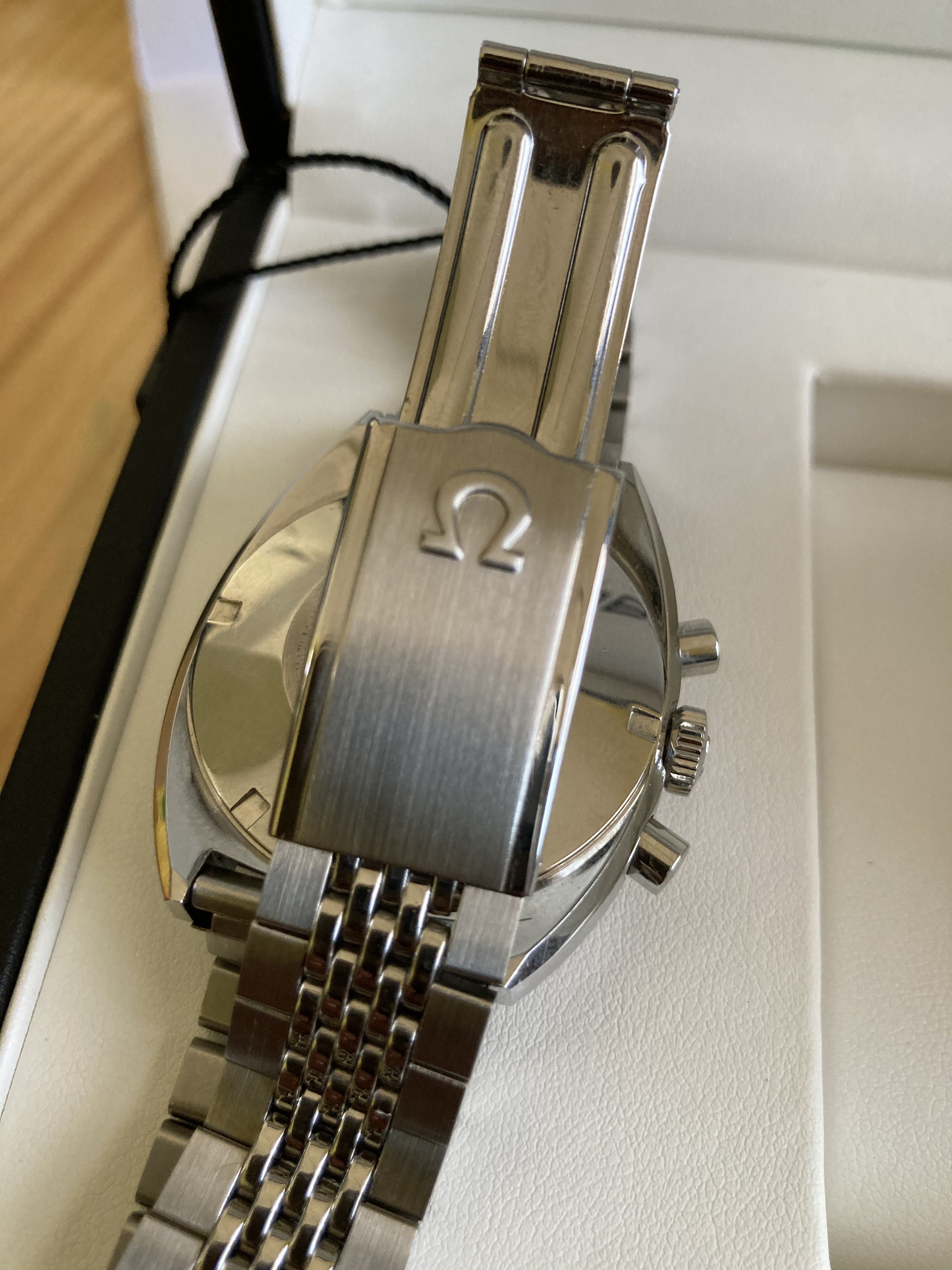

Two things:
A 1175 bracelet looks different
On the caseback of my -016s there is no "Waterproof Tested 60 m" engraved!
Btw: Matching braclet for these watches is a 1116 with 548 endlinks
24,836
55,255
Two things:
Good eye, I didn't even look at the clasp. That bracelet is a put-together, which puts things in a different light. Somebody is putting parts together for sure.

My vote goes to a pile of service and vintage parts put together... everything looks put together.
