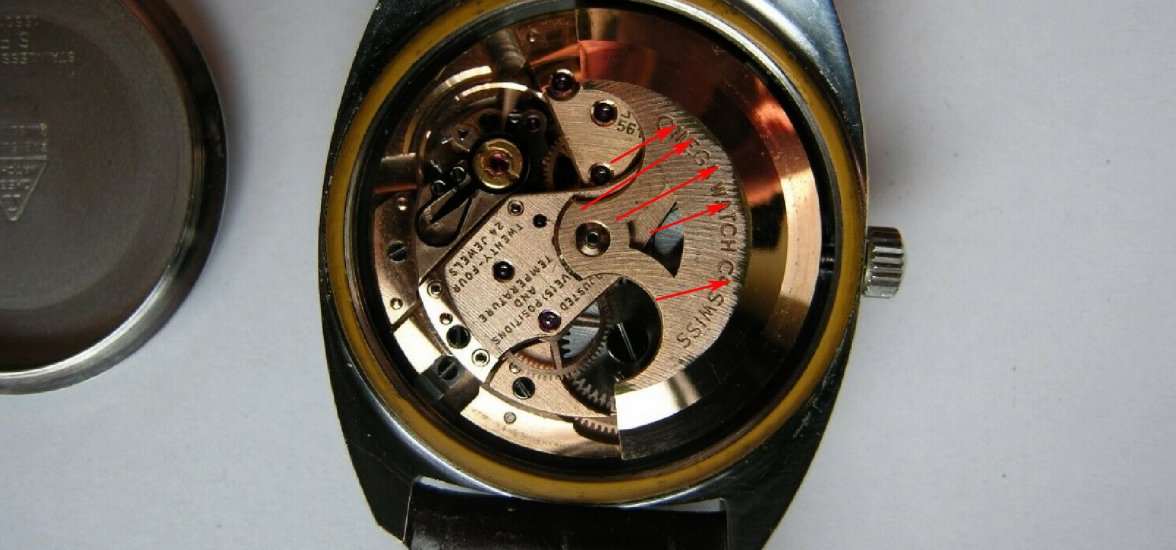

I recently bought a beautiful 1966 Constellation 168.017 Cal. 561, which I really like.
I just now discovered something in the photos of the movement which is worrisome.
I wanted to ask if the marks above the "Omega Watch Co." are a cause for concern.
It looks to me like some kind of scraping must have taken place.
Is this a cause for alarm regarding future problems with the movement?
Would this be reason enough to return it?
I would love to be able to keep it, but I could return it for a refund, if warranted.
I was wondering if someone knowledgable here might enlighten me and let me know if the watch has a problem, or if it's not serious.
Many thanks in advance for your expertise!

Looks like there was or is rotor rub. If the watch hasn't been serviced, that will be corrected with the service. If you know that it has been, then it's likely a past problem.

Thanks for the quick reply.
Unfortunately no mention by the seller of a known service for this watch.
In terms of the rub, there seems to be no indication on the inside of the caseback of any rubbing there, as far as I can see (with my untrained eye).

Absolutely, those are the ones!
I just wondered if they should be cause for concern.

There are traces on the inside surface of the case back that the rotor has been rubbing. There is also evidence on the rotor itself that this has been happening. The usual cause for this is a worn rotor bearing gear. This is a common problem with older self-wind watches. It has been a while since I have placed an order for one of these bearing gears, so I don’t know what the supply is like, outside of Omega themselves. If you did return this watch for a refund in favour of buying another equivalent watch, there is a high probability the replacement will have a similar problem, or worse! Get accustomed to the idea that, if you are going to be buying antique and vintage watches, you should plan on having them serviced. You said that you bought the watch “recently”, and the seller said it had been serviced. I am unable to say whether it had been serviced or not. But from the stains on the rotor, I have my suspicions. A complete service should have included a new rotor bearing gear!

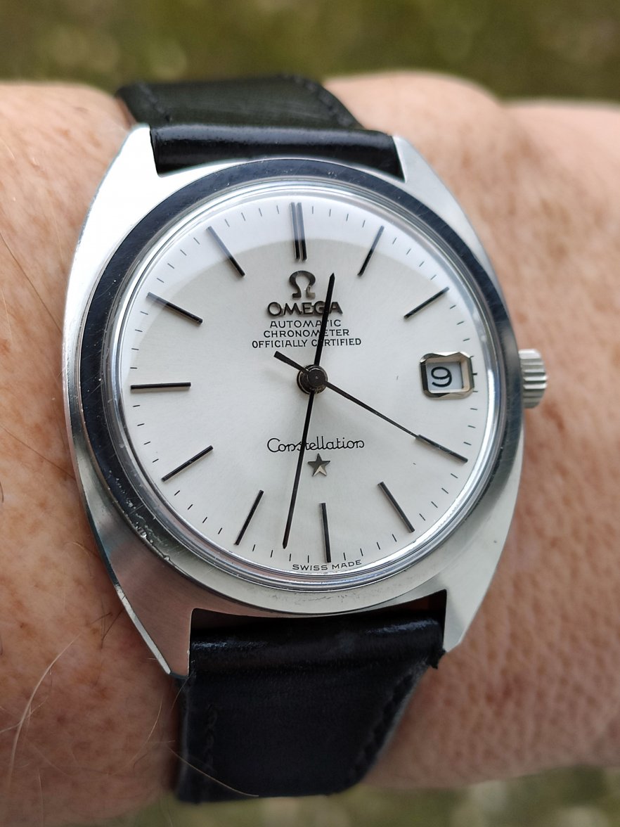

The dial is very nice, that's what attracted me to the watch.
I'm generally pretty fussy about condition, as a rule.
Of course, macro photos are merciless.
