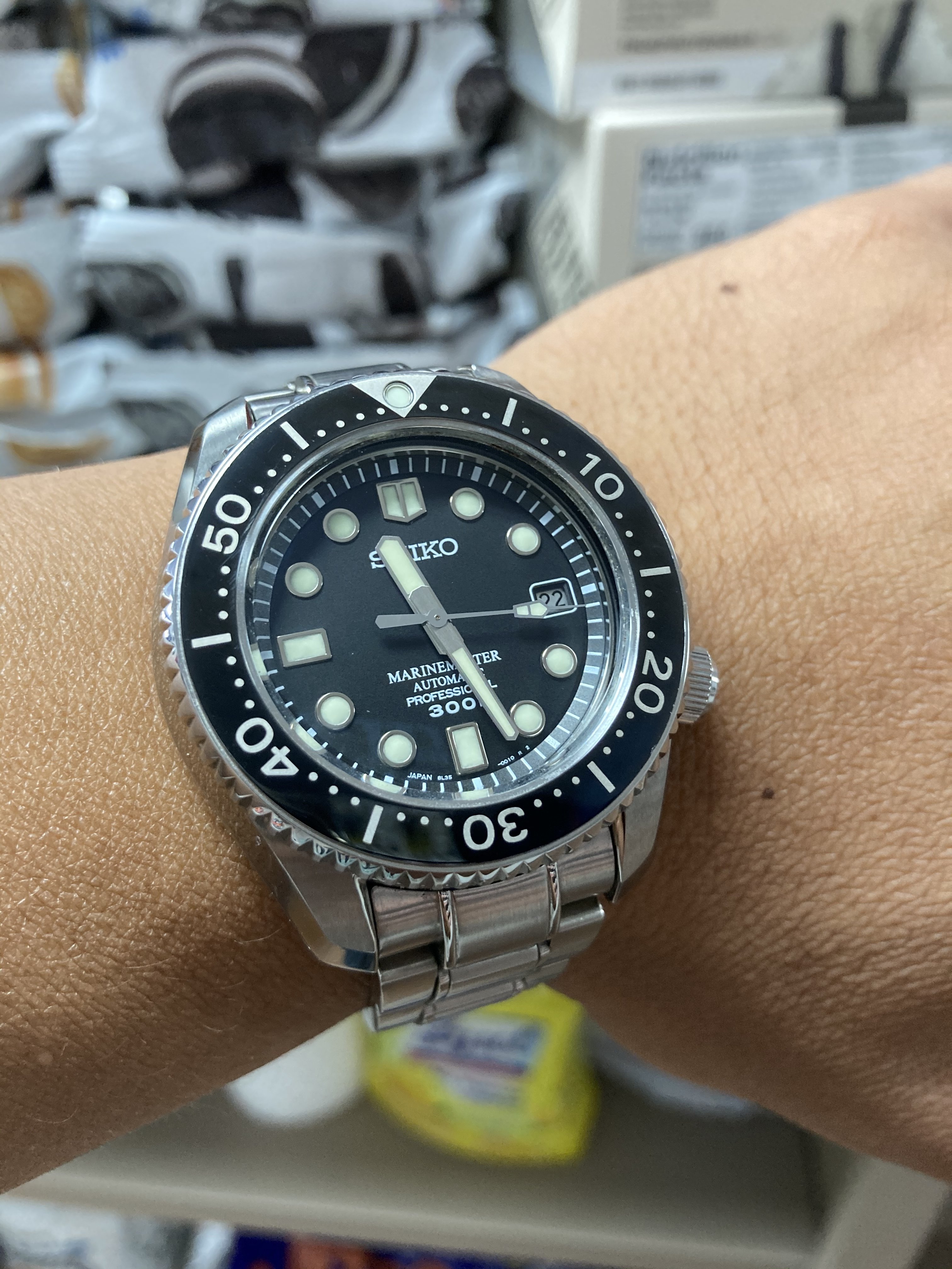

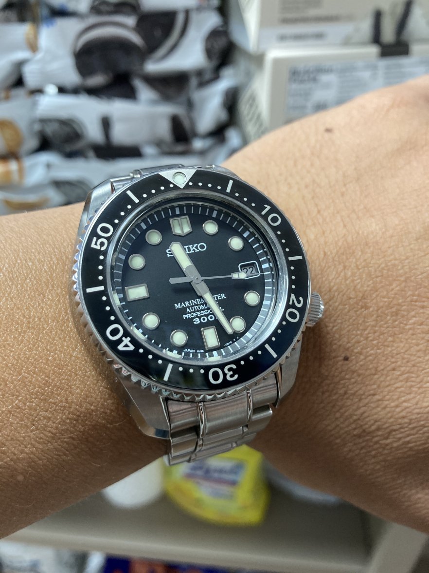

Oh here’s my “Grail” hehe. It’s not what you would think considering my other watches are Omegas and I’m on the Omega Forum lol. Here’s my Seiko Marine Master 300m (Sbdx017) which has been discontinued for a couple years. This watch is a tank and the fit and finish are amazing! Pretty hard watch to find and I was able to get a fair price as well 😀. Typically they compare this watch to the Seamaster and Submariner. If you ever have a chance, check out the specs on google. It’s an amazing watch!
Forget I asked.😗
Just kidding, everyone's grail is personal. Luckily Omega forums appreciates watches in general not only Omega. As I'm not a diver and don't have the wrist to wear a diver this is something out of my comfortzone, but congrats you found this.👍
