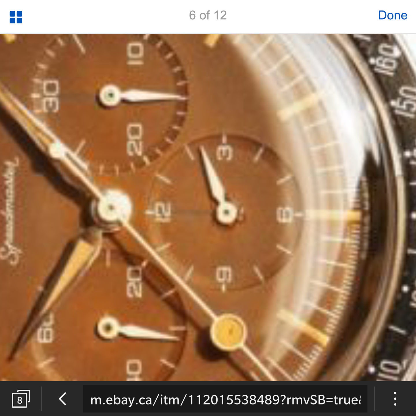

what's with the bubbling oil coming out of the subdial hr register...
Am sure that this is merely the residue that has run down from the dial and collected there.
I have noticed this phenomena when my girlfriend 'over' applies self tanning bronzer to herself. At the central parts at the palm of her hands I see a similar effect.
It should just rub off using a make-up remover wipe.📖

check out that brown dial. very high starting bid.
base 500 though 🙁

Out of interest what is the small symbol inside the Omega logo on the crown?

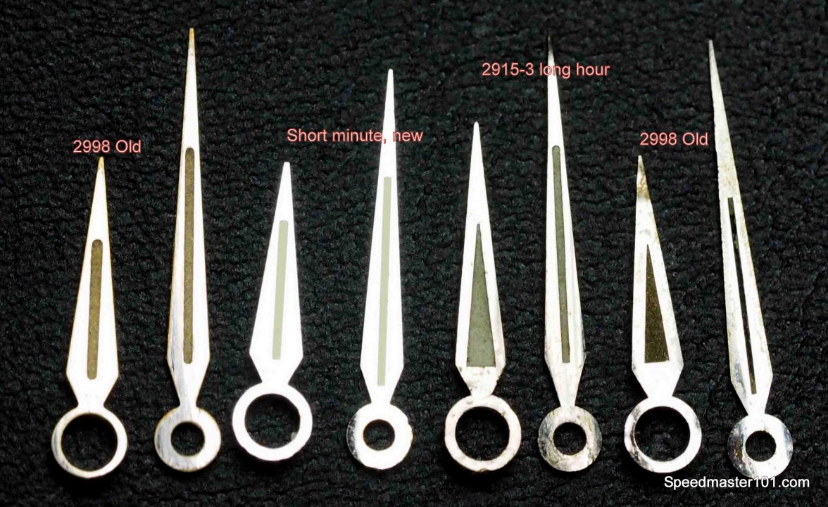

The hour hand looks long. Is that a 2915-3 hand?
I'm no expert, but I think they look like the type B2 hands or Alpha - Variant 2 from references 2998-1 to -4. But I could certainly be wrong.

@gemini4 regarding the lume - do you mean that the hour hand looks relumed or the whole thing? Just trying to get an education. The hour and minute hands look quite different with respect to clean edges around the lume plot - is that what you're getting at?

I think the minute, hour and lollipop chrono hands were relumed. Their lume is uniform and in much better condition than the dial plots. Of course, this photo appears to have a brown tint to it from the seller attempting to make the dial appear tropical. That will have bearing on the lume color as well, which seems off. Lollipop lume ends are generally more red, I believe. Lots of inconsistencies regarding this high priced watch.
18
23
Hmm… I think bezel is not original from the watch. Bezel should be "tachymetre base 1000" in black.
