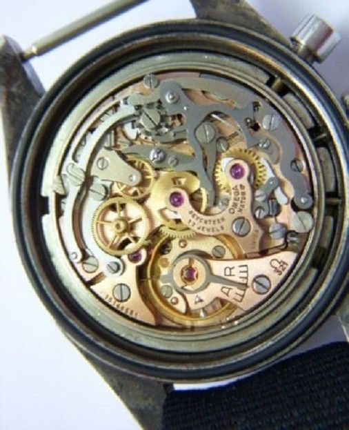

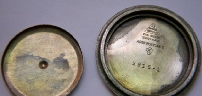

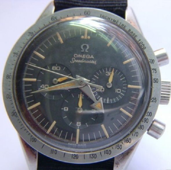

A 2915-1 surfaced on Chronotrader yesterday. I know less than nothing about these and wouldn't like to comment. No price is mentioned, just open to offers. No service history and it doesn't run. Just interested if anyone was prepared to comment on the authenticity. There would appear to be more than the occasional scam on Chronotrader these days.

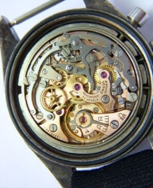

The movement number looks like it may start 15148xxx which MWO states "probably some", so movement could be correct.

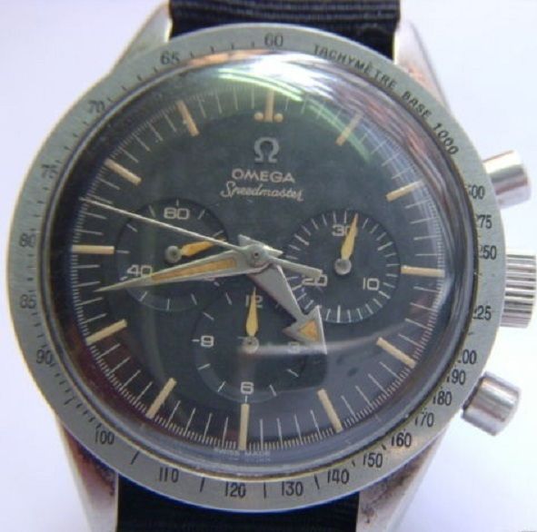

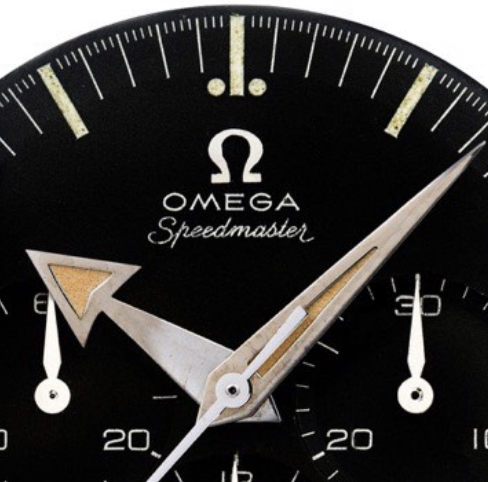

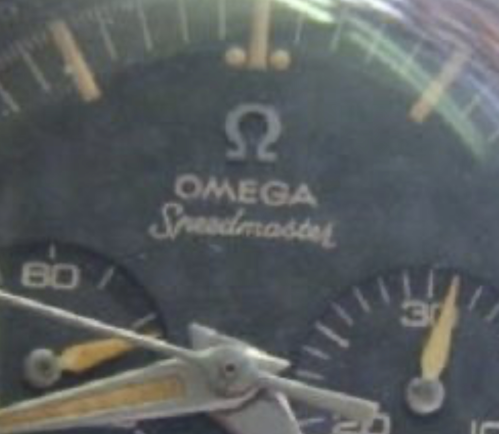

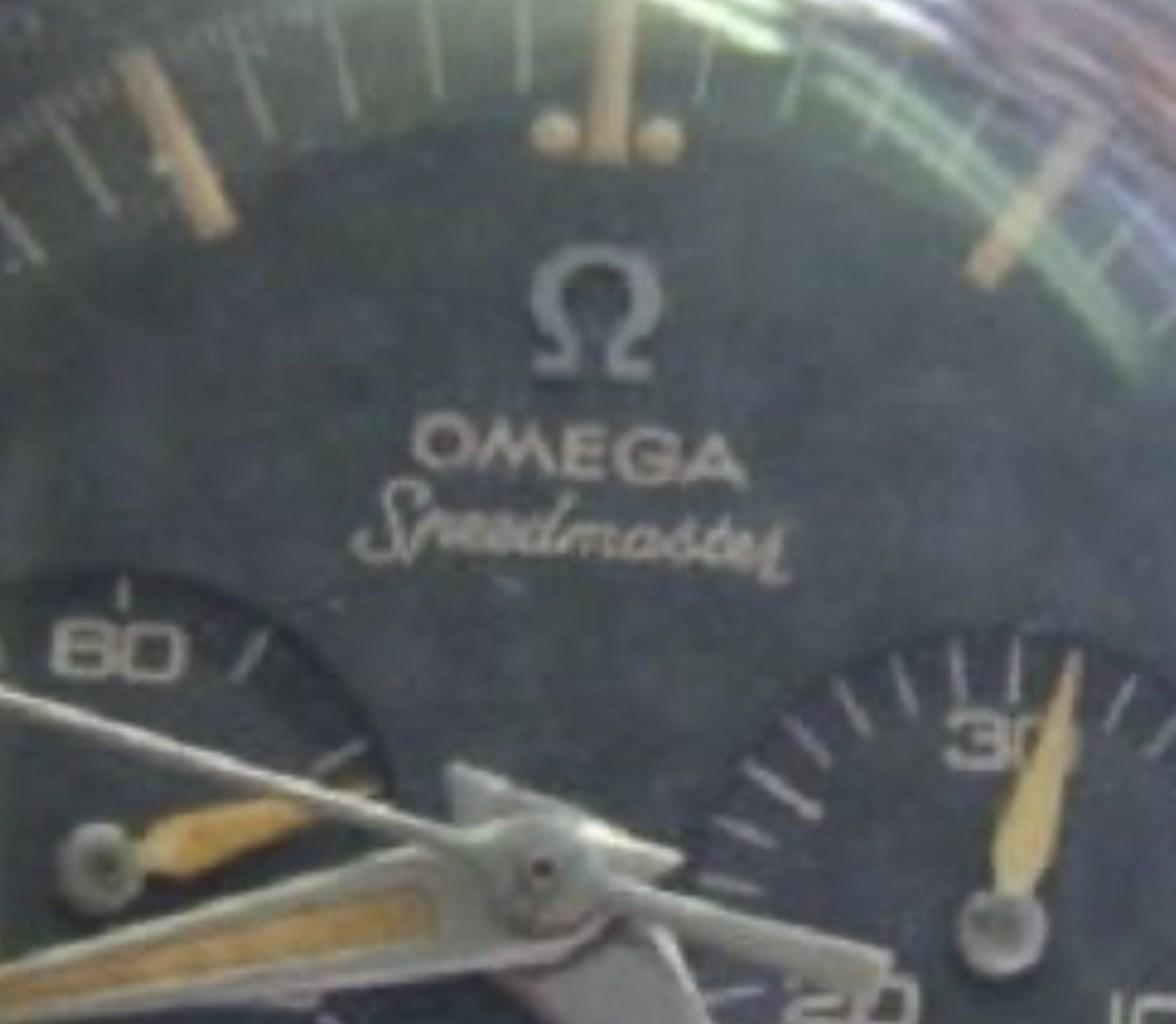

Is this lume on the sub hands? I like these small customizations done in the past (if leg铆t).

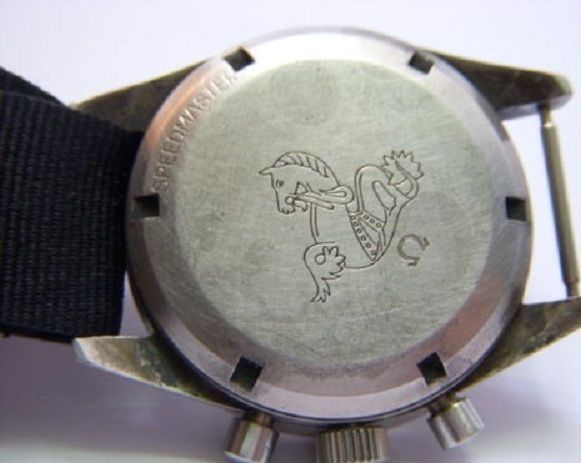

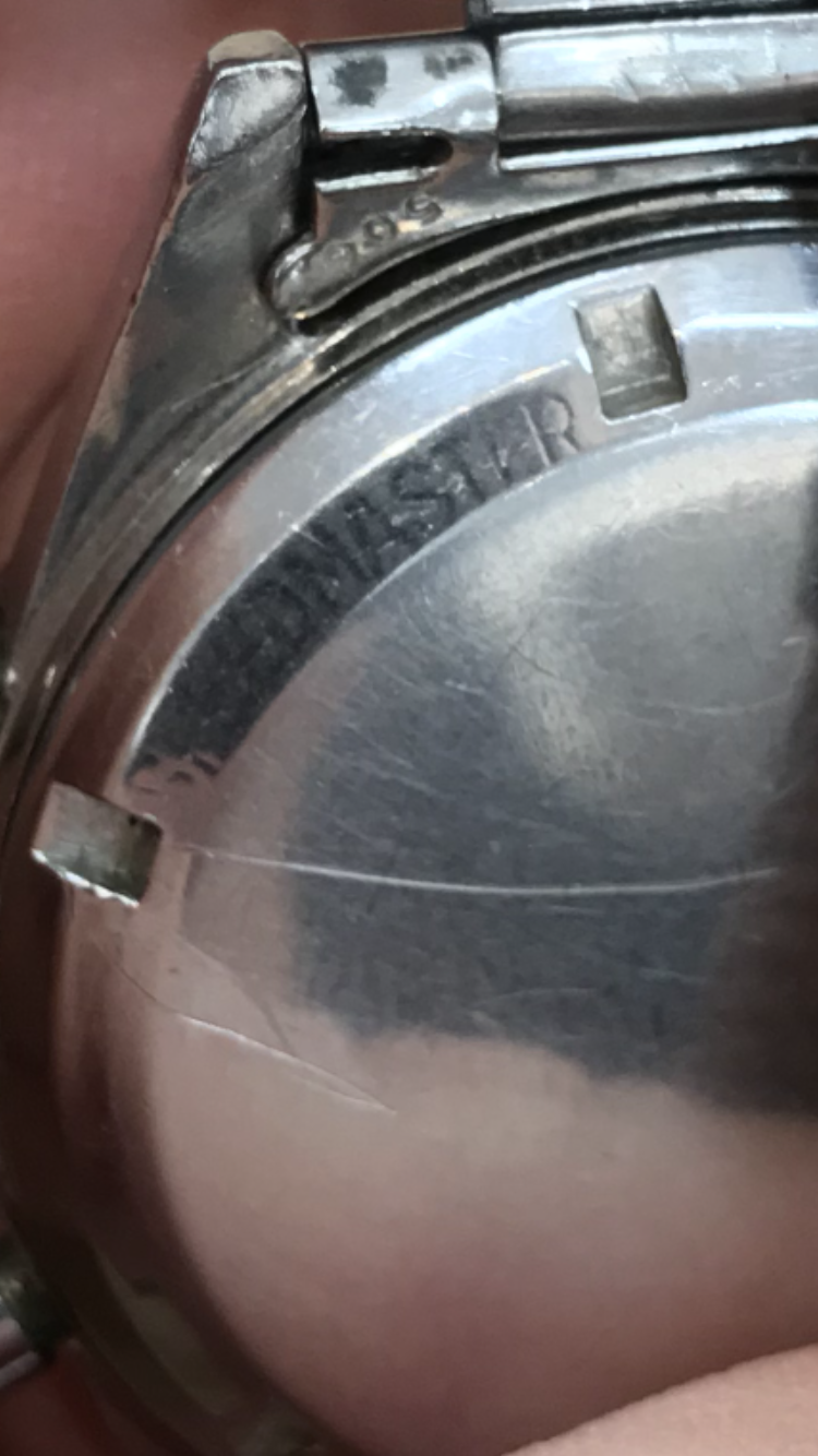

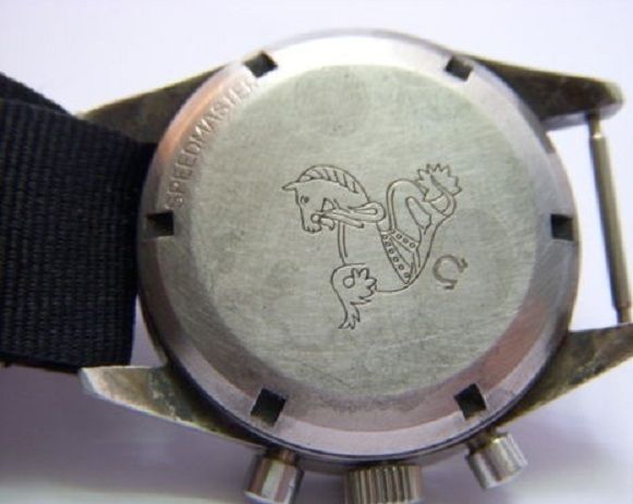

What wonders me most is the caseback and the "Speedmaster" text. Seems to big, allready touching the opening marks.
974
4,112
The same person sells a crater box for 300$ ?? 馃槙
He knows the correct collector name of the box and he doesn't know the real price?
Maybe it's a scam.

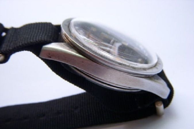

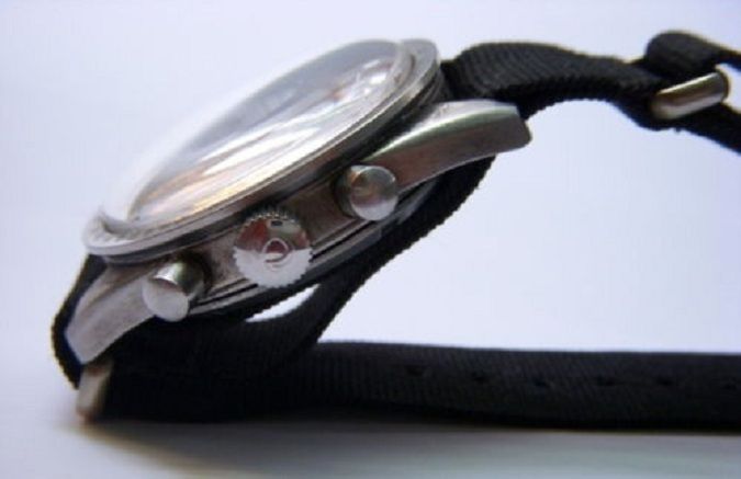

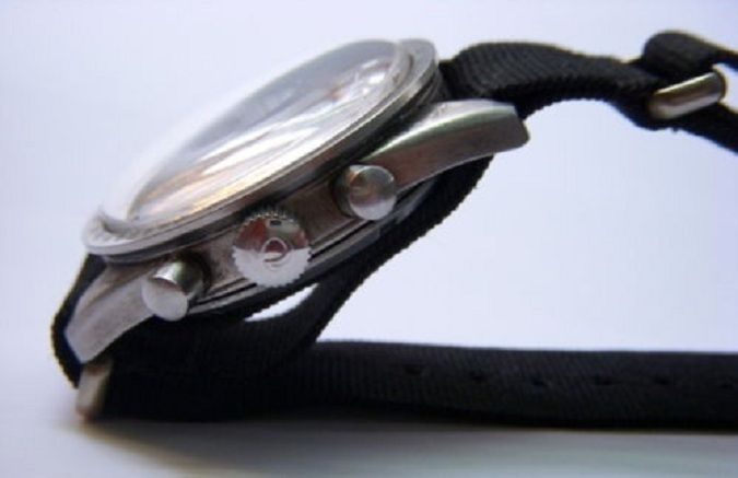

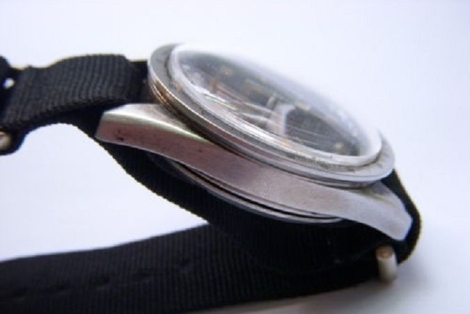

Has the 2915 also a modern bezel and pushers?
The crown I'm sure it's modern.
A seamonster Logo (also total off Center) on a 2915-1 caseback?!
As far as i鈥榤 aware of there should be none. ( Edit: Type A2 2915-1 caseback with Seahorse Logo according to MWO, thanks to @Dash1 for pointing it out!)

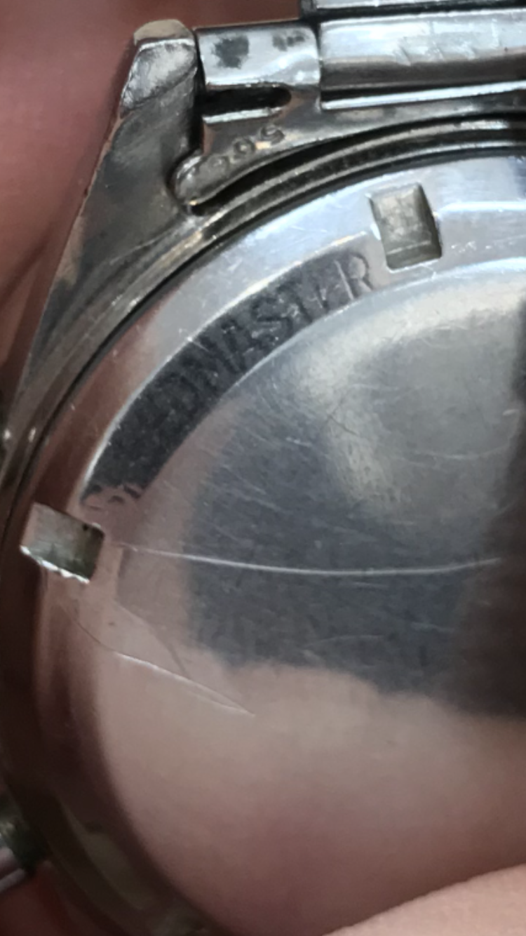

Re: Speedmaster Text, here鈥榮 a pic of a legit 2915-2 caseback , text is more centered between the caseback holes.
Cheers,
Max
Nothing checks out here. Kind regards. Achim
Unfortunately it鈥檚 a scam. Seller said he is based in Norway. Then when I proposed a face to face all went quit. Asking 2,500 usd for this one seemed a bit off

A seamonster Logo on a 2915-1 caseback?!
Cheers,
Max
A few do - see my avatar!
1,303
4,389
True! Also mentioned in MWO, haven鈥檛 checked my 2915-1 facts in a while.
But yours seem to be perfectly centered, unlike the fake shown above.

A few do - see my avatar![/QUOTE
I doubt that. Not on 2915-1. In this case I doubt the info in the book. Kind regards. Achim
2,086
2,899
I agree with you. At least I have seen a few over the years.
