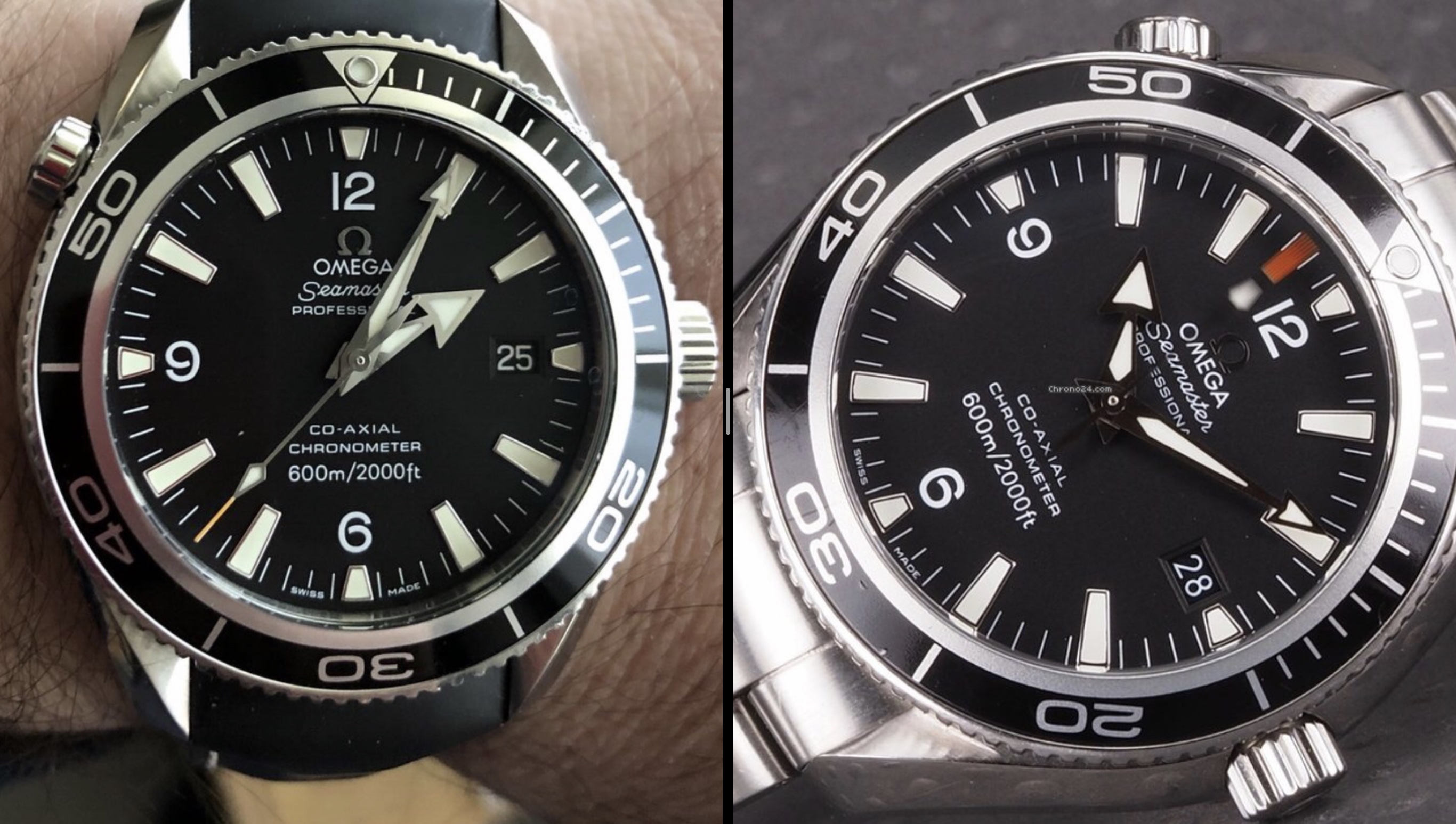

For those interested, I took the liberty of making a side-by-side shot of a (likely) 2500C and a 2500D. The watch on the left is the 2500 I’m looking at buying. Despite the seller and Omega saying it is a ‘D’, Archer and Rahul718 believe it to be a ‘C’. I don’t believe the seller is intentionally disengenous. Rather, like me, he is only going on what Omega told him.
Regardless, I’ve learned a great deal from opening up this thread. There is indeed a font change on the date aperature, as pointed out by Rahul (thank you, Sir).
On a separate note, this shit is complex. I fly advanced helicopters and work as a test pilot for a global simulator corporation. I came at watches with the same zeal and expectation of mastering a large knowledge base. However, I have come to accept I will always be a neophyte when it comes to watches. The ocean of information (even on a sub model of a specific brand) has horizons in every direction. This realization initially left me depressed but now I embrace my ignorance and every new nugget of information I gain. In the end, helicopters are ugly beasts whilst watches reside on the sublime side of beauty. I’m happy to remain blissfully unaware...
Drats, image size too big. I’ll try to shrink them down... standby please.

There, that’s better.
I noticed that the Omega symbol is subdued on the right watch. Is that an indicator of something? Just curious...
159
246
I think it’s just the way the light is reflected, or not in this case. Does the brain trust know of any other difference between the C and D without the removal of the case back?
