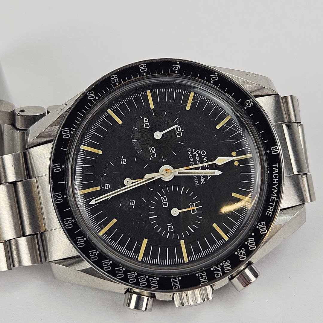

Hi OF,

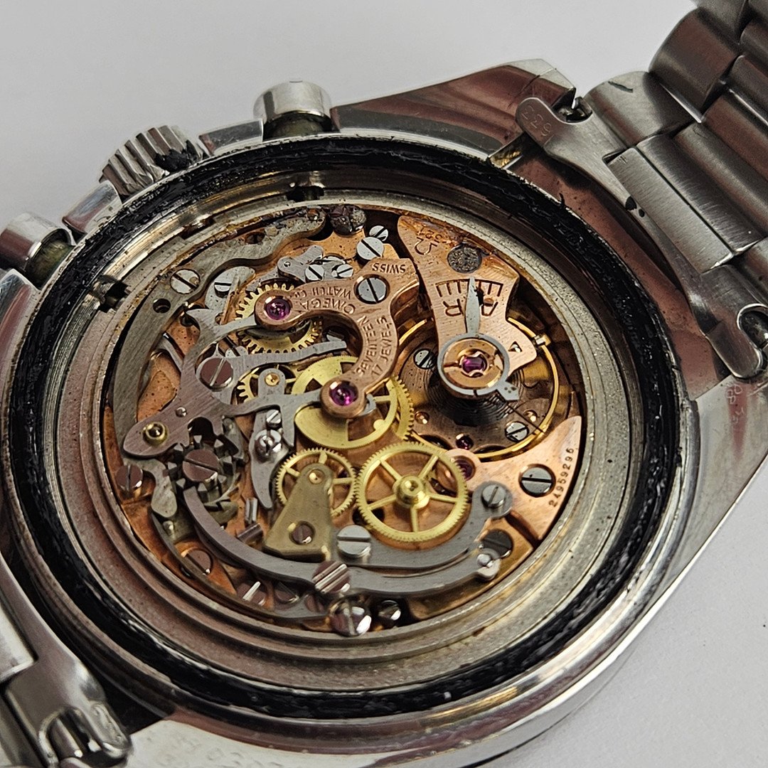

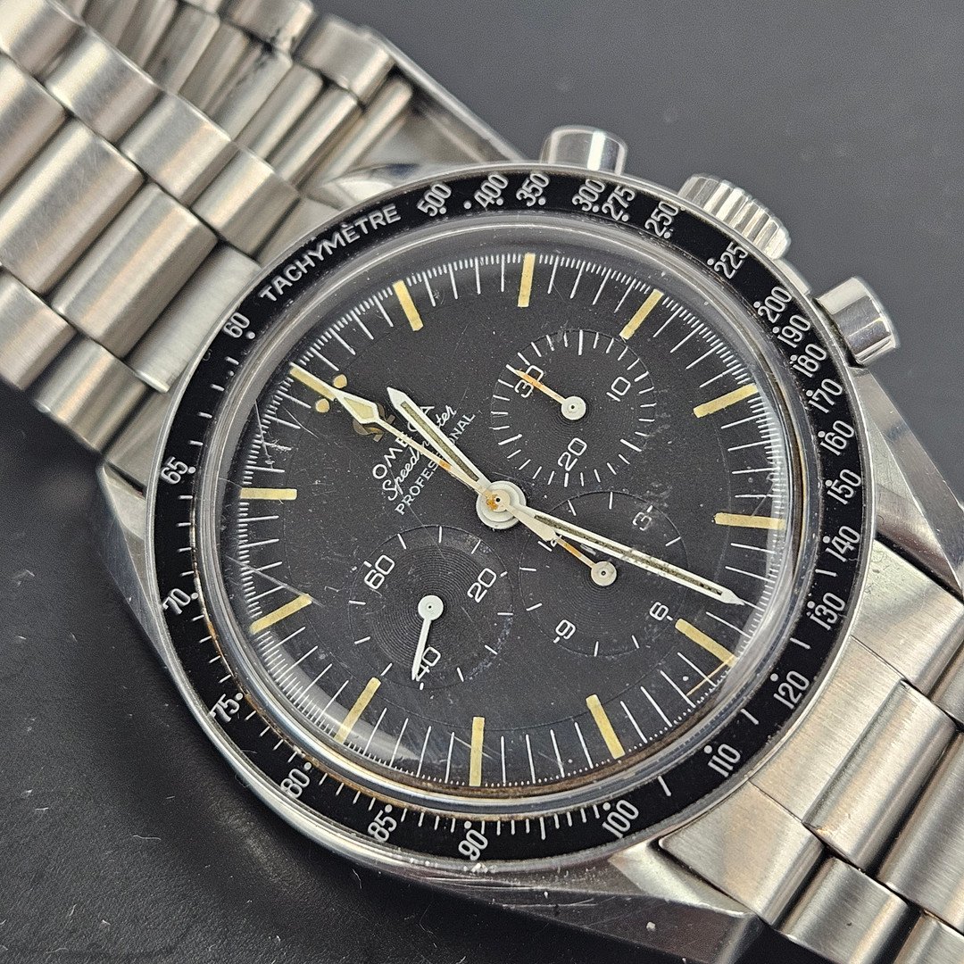

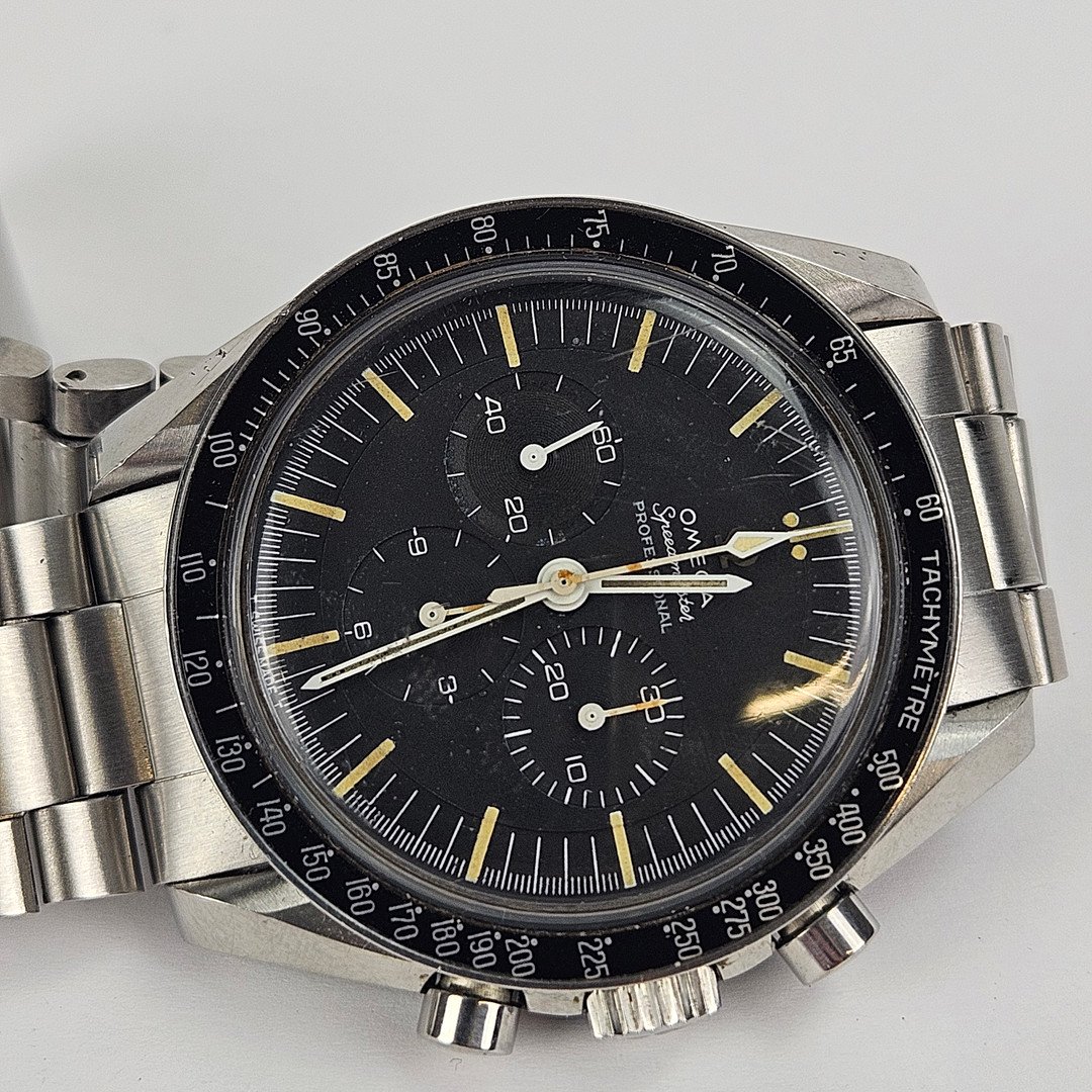

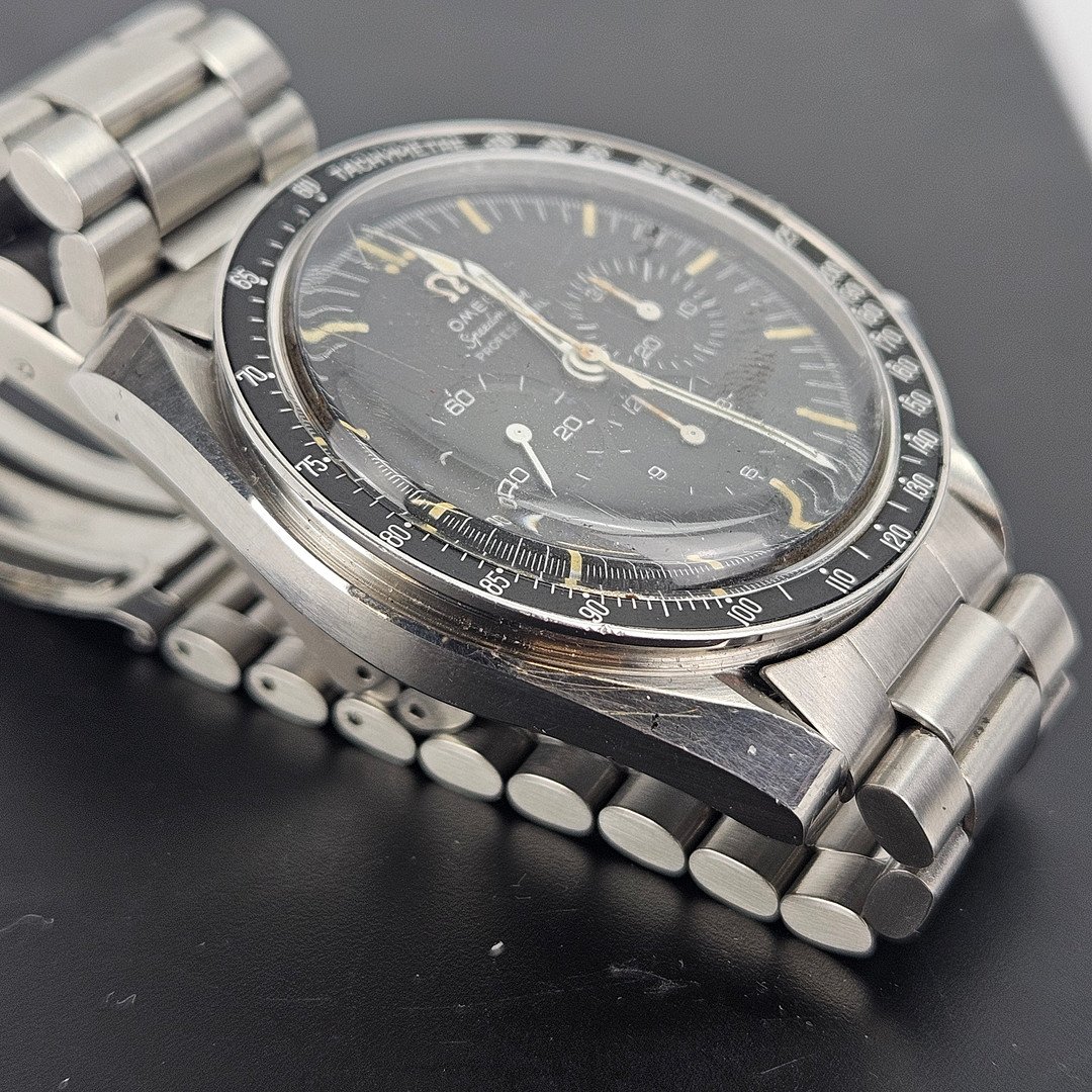

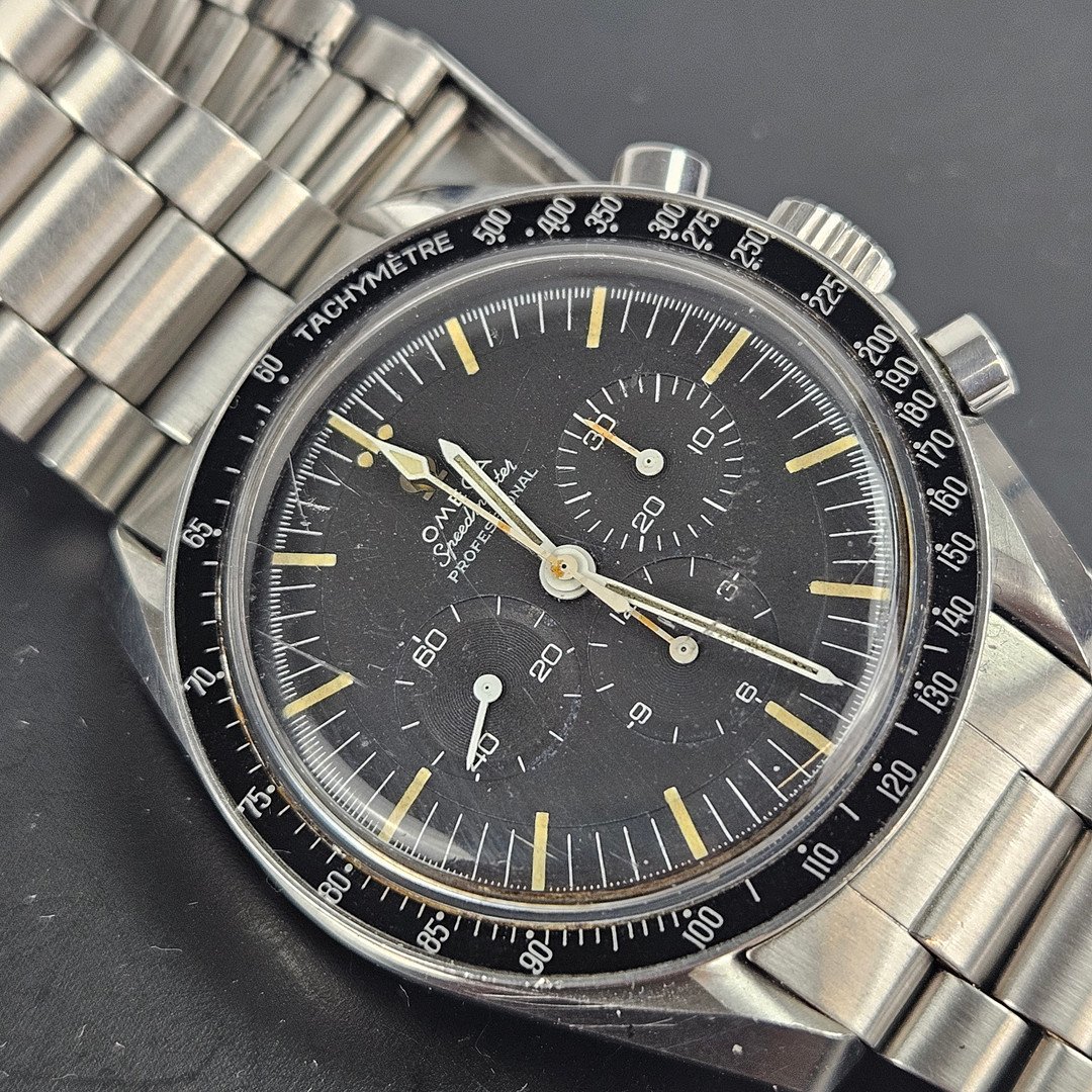

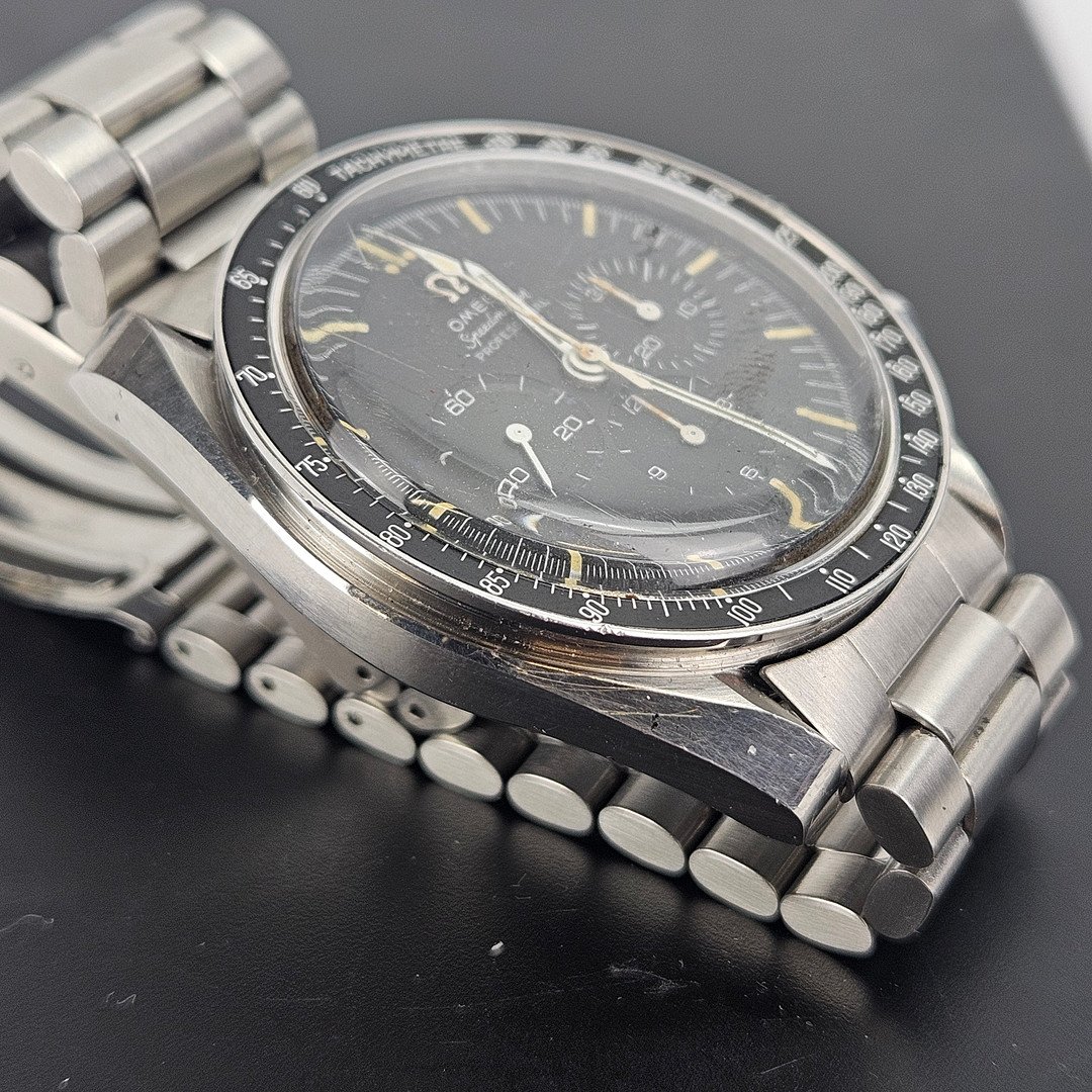

looking at this 105.012 66 coming up for auction ( dibs ! 😀 ) which has very good cosmetics to me, sharp case, good bezel and i think correct fat & low pushers. Lume looks good but the dial is a bit grey maybe ? Looking from the side the damage all appears to be on the crystal although some spots can be seen in the seconds register.

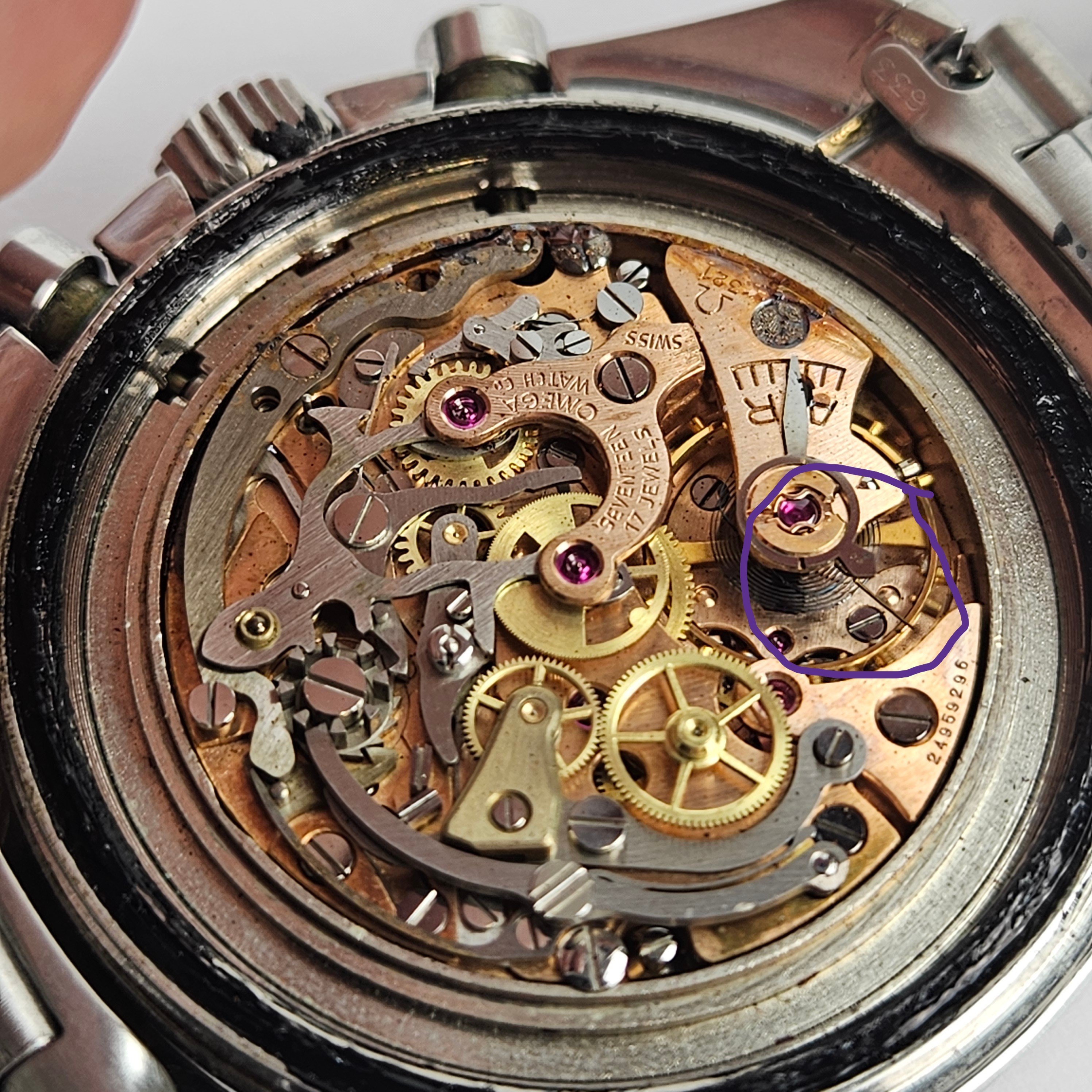

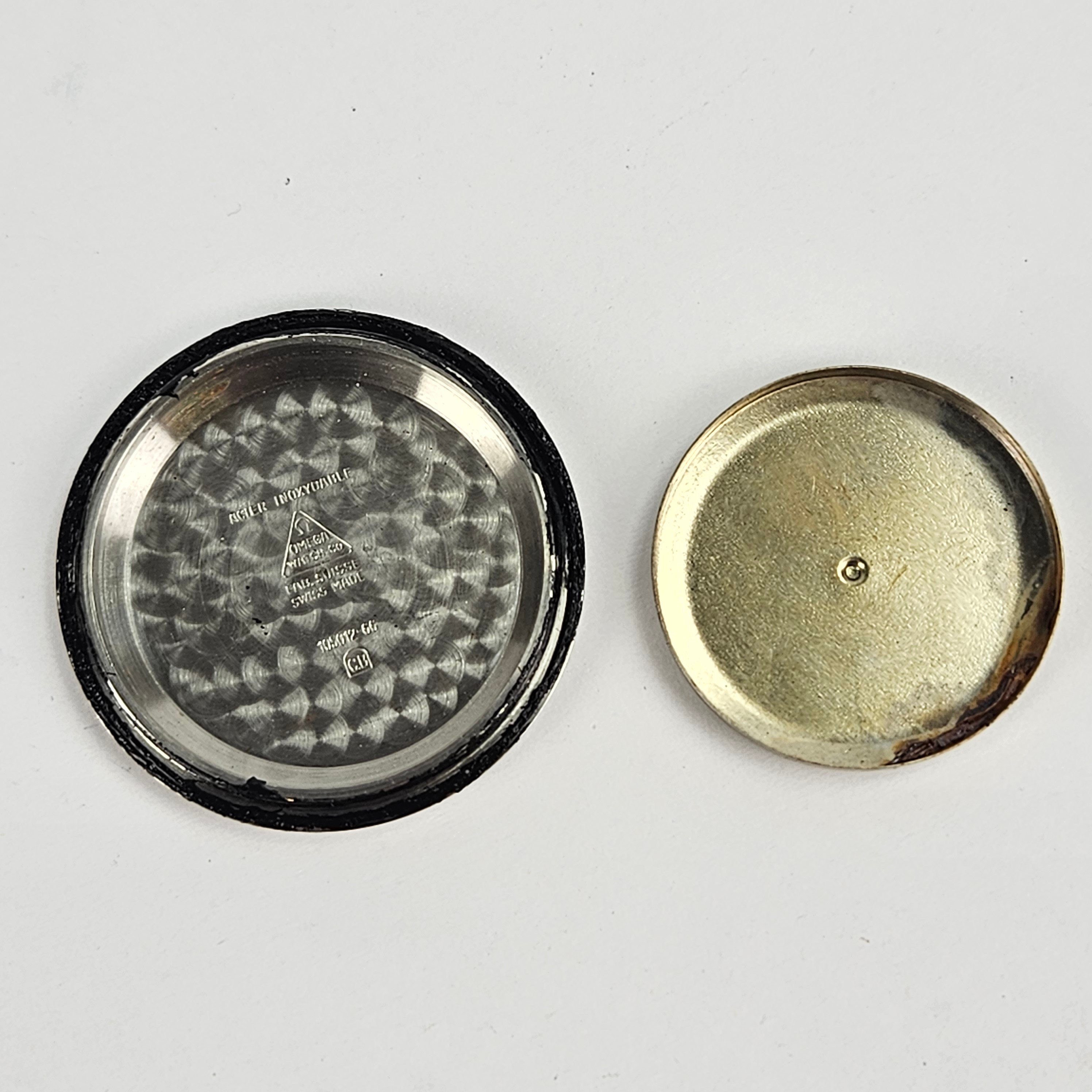

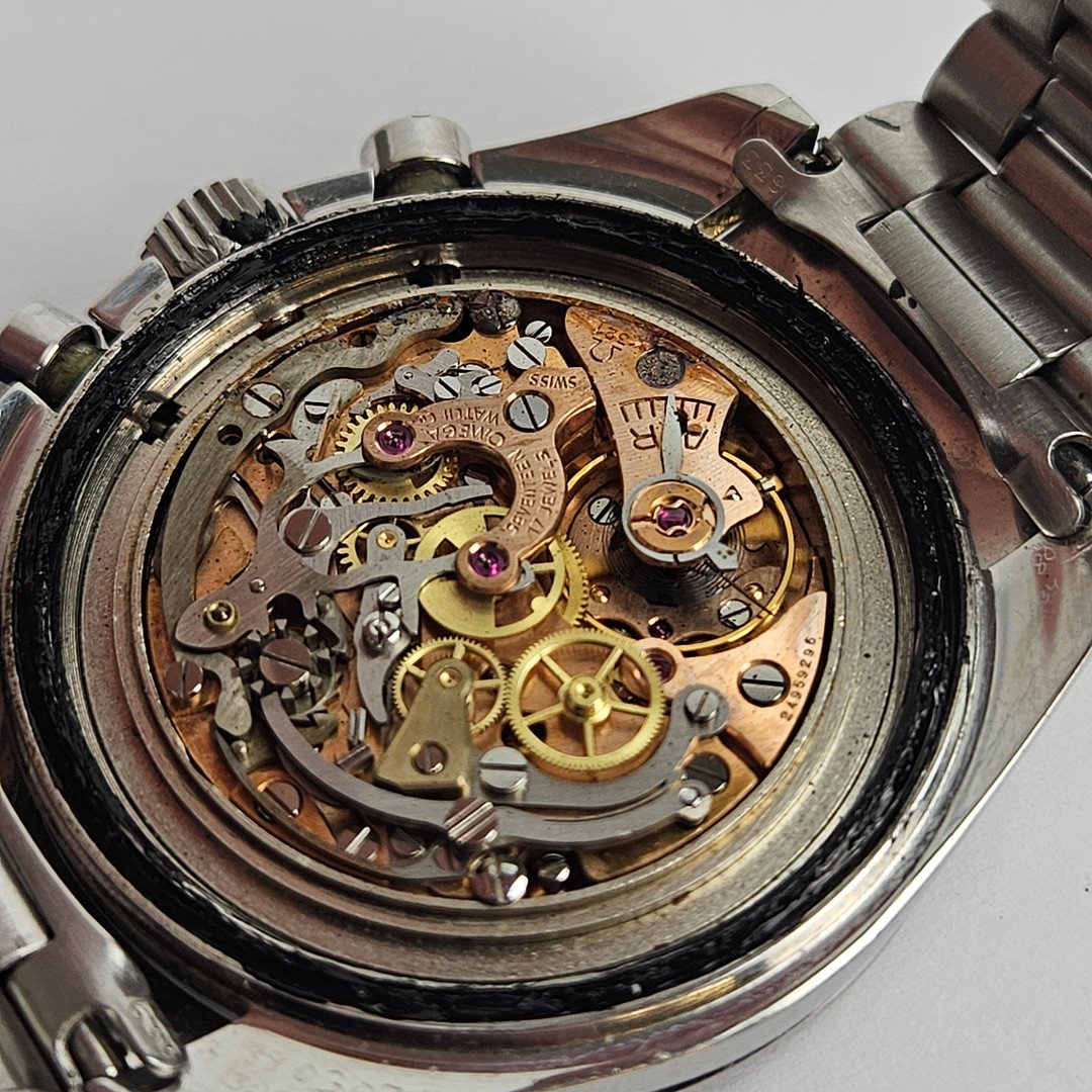

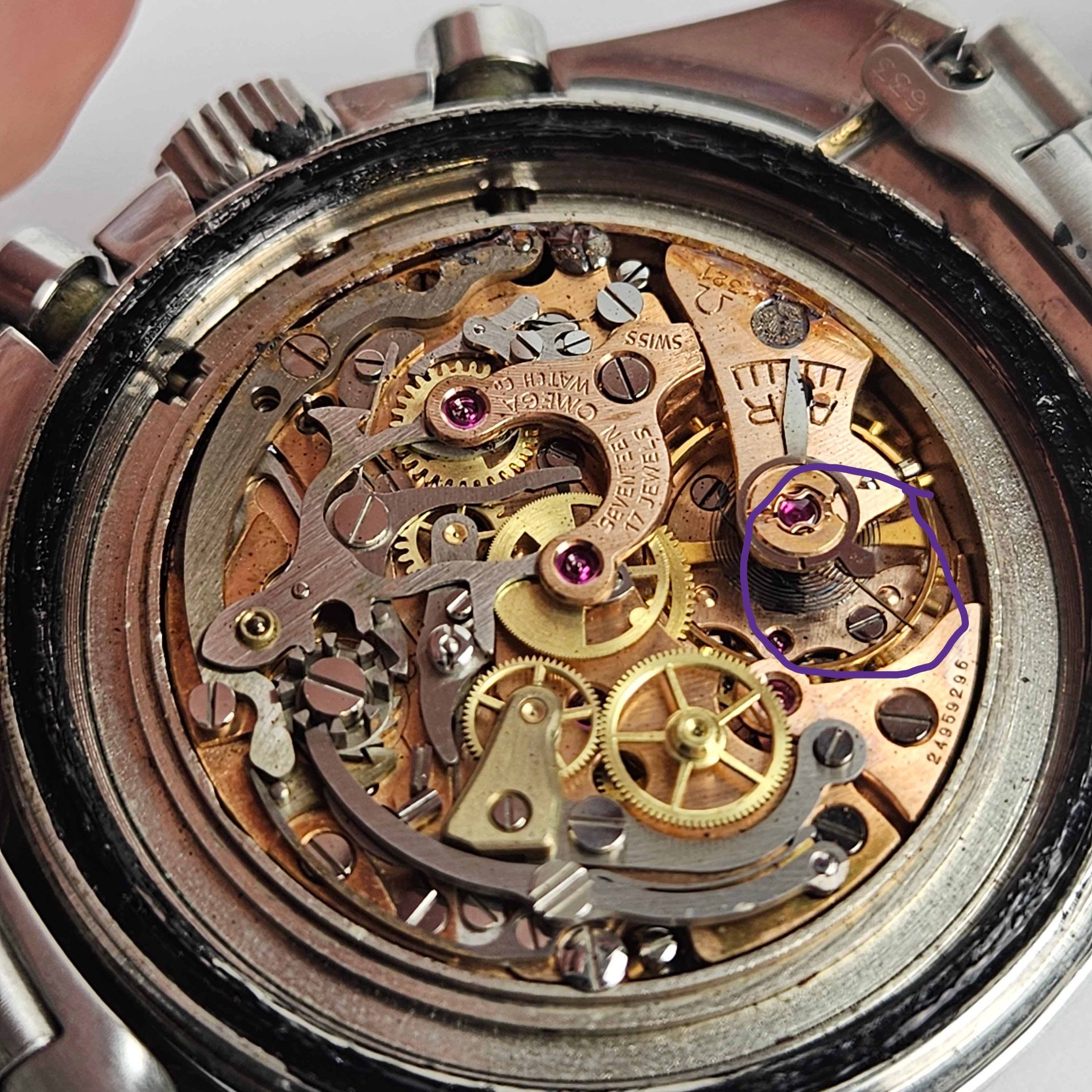

But......also signs of water entering / corrosion looking at the movement. Is the movement still worth a revision and what is the black pin sticking out above the balance wheel ?
Is the spring out of the piton or broken off ? If yes, full balance wheels can stil be bought for a c 321 i think ?
Did i miss anything, and thanks for your imput !

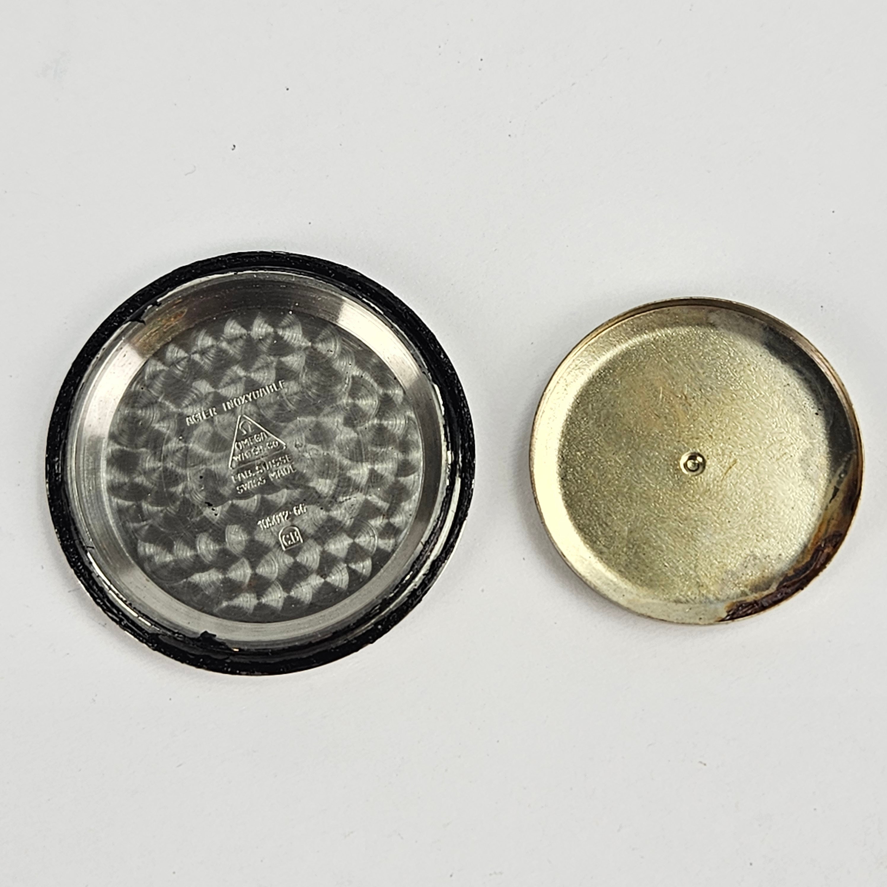

Briefly in between other things: this isn't a 145.012, but a 105.012. As you've already pointed out it comes with the nice fat neck pushers, sharp CB case and a good DON. Later bracelet which has some value. Movement appears to be in dire need of a service as testified by the caseback seal, or rather, what's left of it. 😉
That said, I would be worried by the rust around the pushers, on the dust cover and the rusted hands; this watch has seen a level of water ingress and could have more issues hiding inside it as a result of that. Knowing that sourcing 321 parts is still possible, but certainly not easy nor cheap, this is quite risky. For me, the price would need to be quite low to be comfortable with the risk/reward level this watch would come with.

Thanks !! and i indeed got my numbers mixed up but now corrected. And that gasket is melted cheese indeed 😲
I should expect rust everywere then, so replacement parts could be a big part. I`ll budget 2000,- for service and see where it will go.
But i do love that case, and lume !

Can you view in person? You could spend hours comparing photos from different angles to ascertain what is on the crystal and what’s on the dial, and still not get it right. Five minutes with it in your hands will tell you all you need to know.
It could be a killer watch once serviced but it could have issues that aren’t immediately apparent, particularly case corrosion or blemishes to the dial given the overall condition. If you cant view in person you’ll need to determine your price based on best and worse case scenario, then decide subjectively where your gambling/tipping point is.

With that obvious rust damage and tired movement, I wouldn’t take this on as a project unless I already had a donor 321 movement I could use for parts.

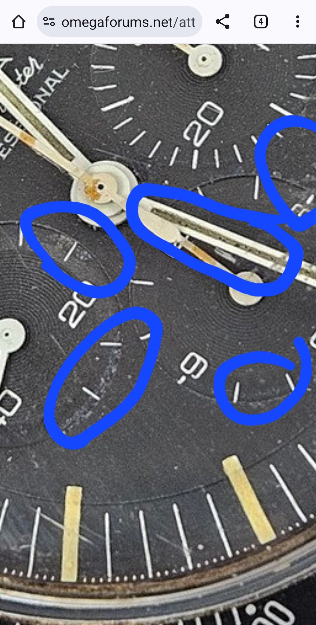

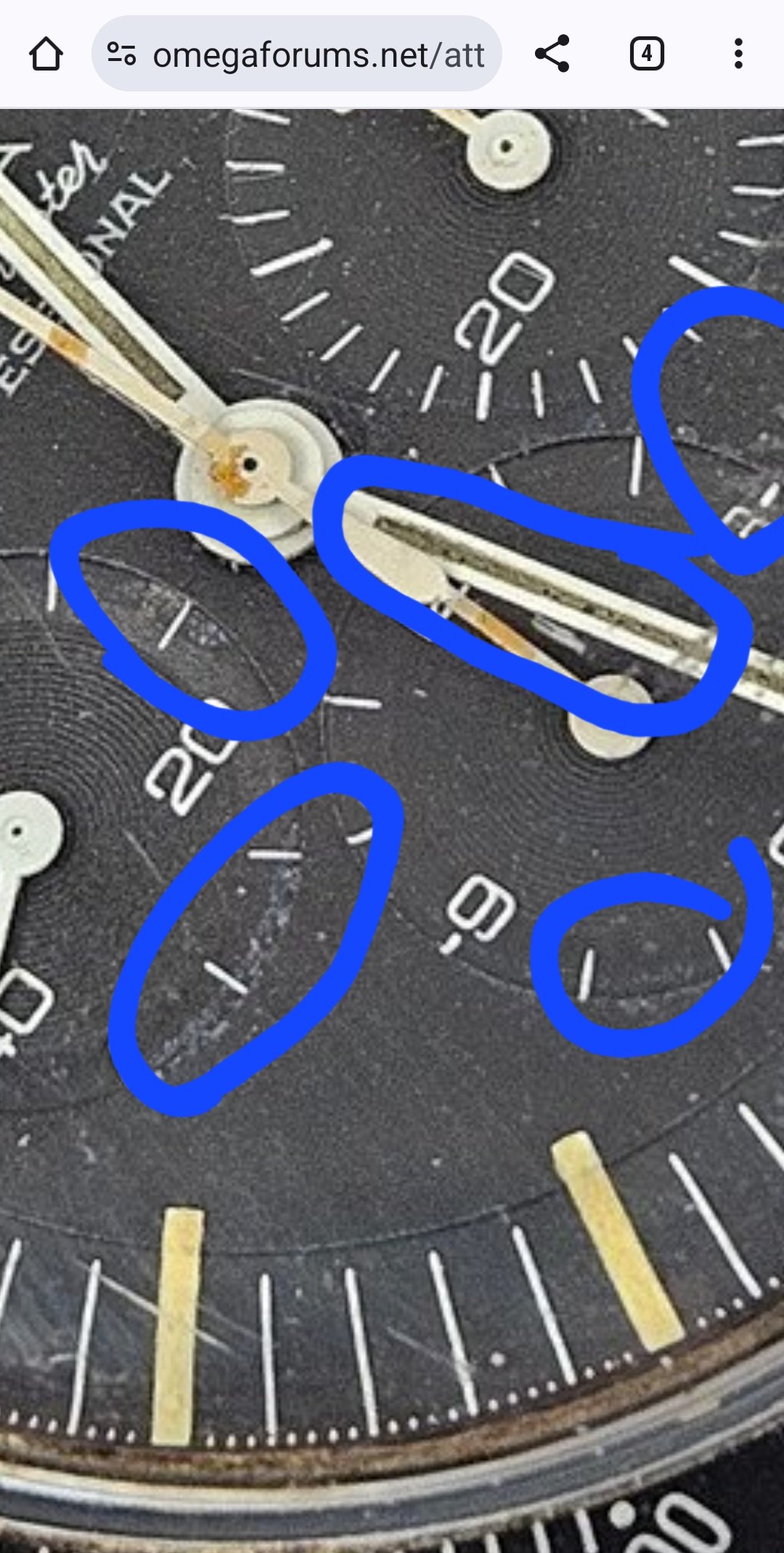

After comparing photos quickly, I think that quite a bit of the spotting is actually on the dial.
I will have a better look, thanks ! I know it is not pristine, but neither is my budget so i have to accept some aging etc. But not neccesarely a drowned movement.....
In the meantime i found that the pin i asked about is a safety to prevent the spring to catch on the compas in case of shock.

Well… we all get very exited every time a Speedy comes up for an auction?
This one has a lot of potential!
A lovely case and caseback.
Original crown and the desirable pushers.
The problem with this watch is that it has ”taken a bath” and water/moisture has entered.
The movement has taken some damage, with lots of rust that we can see on the pictures, but we can't see further.
And spare parts may become a bit troublesome?
And as David wrote - the dial could be very nice, but possible marks/scratches/damages are a bit hard to assess?
The hands have discoloration, and the leakage might have caused this, and maybe the dial has also been affected?

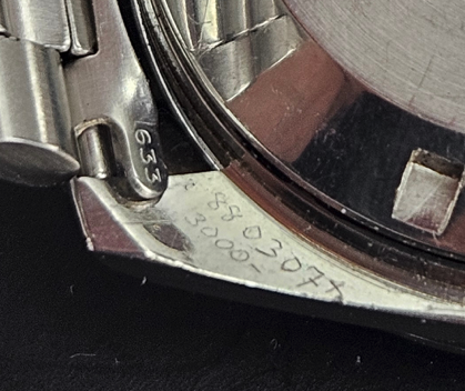

There is also an engraving on the back side of the lug.
This watch does need to be assessed on site (if you don't want to gamble??).

Looks like it has all the correct bits other than the bracelet. The case also looks decently sharp. I would also expect a pretty hefty bill from the watchmaker judging from the movement pics.

Why so much? It looks like the water damage is contained to only one side on the extreme edge. At best there is no further damage to movement in which case it would be a regular service for a321 movement.

Edit - That's a lot of mildew and mold. There's no fixing that:
Plus, there could be case rust inside and under the bezel, which would make the nice case and bezel scrap. It's a shame but this is probably too far gone unless it's free to a good home.

Given the stains on the dial and movement bits, my near-novice advice would be to let it go, unless it's a steal. 95% of the time I plan to embark on a 'project' I end up giving up before bidding. That's because these projects are way too costly if they concern addressing a permanent damage, if not impossible. You may especially risk the authenticity if the dial has been damaged. And imagine getting this watch and not being able to fix the stuff you wanted to, now you are living with an unwanted flatmate that you don't want to come across while grabbing a glass of water at the kitchen... Every veteran on this forum would probably be familiar with this story.
