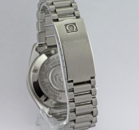

    Hi All,
    Considering to buy this Speedmaster.
    I have to admit: it would be a step in the dark for me: I do know some things about 50’s golden Seamasters and Constellations, but the diversity within the Speedmaster’s range in bracelets, end links, hands, ‘T’ yes/no, casebacks, etc is mindblowing. And leaves me very much in the dark, although I have studied @Spacefruit 's blog.
    And I have the 'this-might-well-be-too-good-to-be-true' bug ::screwloose::
    So, would appreciate your help very much :thumbsup: !

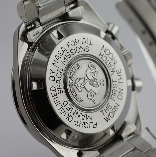

    Stated as 1991, cal 861, 145.022. That adds up. To my untrained eye:
    - case is crisp, although on the backside a bit worn. Not too much. Bezel is (too??) crisp and caseback seems in order too
    - the 1450 bracelet (right?) and 808 end links seem to add up
    - lume is OK too: bit yellow. As to be expected, and matching the hands, which seem OK too (right?)
    - having said that, I am not sure about the dial and font: the ‘S’ stands out in my opinion, although I have seen similar ones too. there is no patina visible in te pics. Dubious?
    - cristal looks good.
    - pushers right size?
    I will ask the seller (trusted party, as far as I know) for a close-up of the movement and movement number too, to date it accurately. Watch is serviced recently.
    Overall: what do you think??
    Thanks in advance; much appreciated!
    Willem

    Looks alright to me if perhaps a little polished. Bezel is probably replaced along with the hands but you do see bezels in great condition, so it could be original. I'm by no means a Speedy authority tough, so perhaps others can chime in.

    I think it looks nice, bezel is correct with tall letters DN90.
    It's all down to price. Because this is not considered special or rare. Or vintage. It's a second hand watch. A nice one yes, but not vintage value - yet.

    Let's be serious: technically speaking is probably one of the best Speedmasters produced ever. Excellent bracelet (1450), excellent caliber (it should be a yellow 861 with one of the longest power reserve and with the old type glucydur balance wheel), excellent classic case (waterproof at its best), reference 145.022 (one of the last) and nice old style dial (tritium, for the lovers of it).
