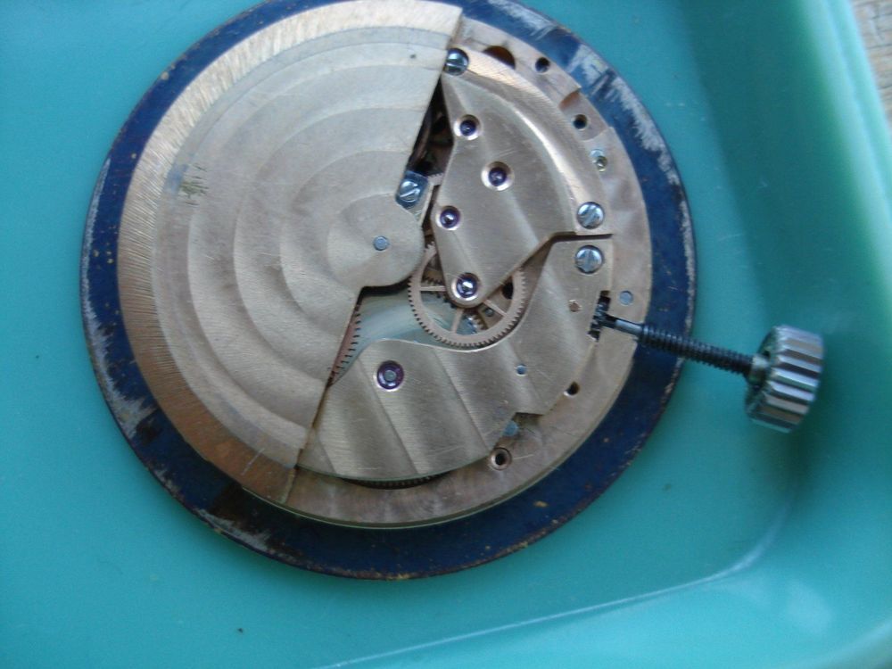

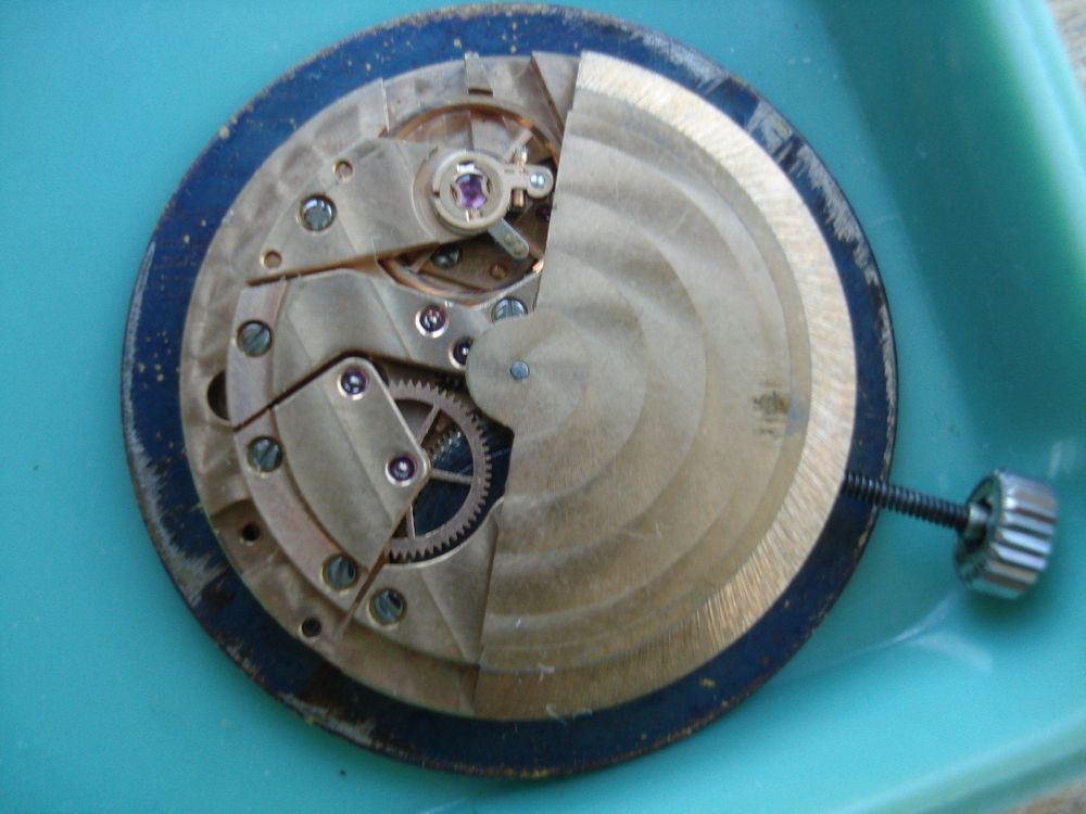

So, no markings in the case nor crystal. The movement is really not a high end movement, not with that finish and the cheapest balance wheel available. The dial is not marked "OM" but is solid gold? I don't see how you have determined that the dial is gold.
If you see prototype, then fair enough.
I see a generic case, cheap movement with an Omega dial, hands and crown.
We all have our own opinions and I won't convince anyone in the same way that you are not convincing me. I'm happy to disagree.
Enjoy, Chris
I think we are getting things mixed up.
The gold dial is on the watch in the thread I link to - not either of the two in this thread. There are non-gold dials for this ref, so that shouldn't be a smoking gun.
My points are that first, if this was a period fake, there is no way either dial or case were as good as on the one in question. 1:1 Omega fakes is a very new concept. Secondly, if this was a NEWLY made fake, the question would be "why bother?". It is not really a collectible Omega and if you were to go to such lengths creating a fake, why would you choose THIS Constellation and then leave out markings on the case and choose to make a dial leaving out the "Chronometer - Officially Certified"?
From a collector's standpoint - and a commercial one - it just doesn't make sense.
If it is a Franken, then why are there two of the same type using an obscure movement? While it may seem cheaply manufactured, it is still a slim, high-beat automatic movement with date - why not use something more readily available?
I just don't see the point of it being either a franken or a fake. If it IS a prototype Omega movement (or just a never-put-into-production Omega), the monetary aspect would still be negligible. We're talking 70's Constellations here, not rare Speedmasters.
Anyway, looking forward to learning more here!

Cheap movement? Name a cheap automatic watch with date and only 6.6mm overall thickness or a cheap automatic movement measuring only 3.2mm.

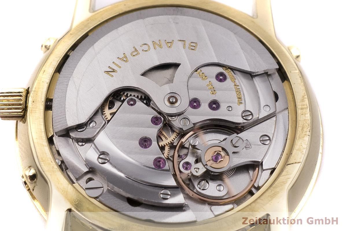

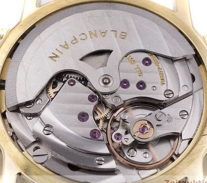

Hi,
It seems like a very interesting movement. Simply from the appearance it looks like a high quality movement, and I am pretty sure it is of Swiss or at the very least western European original.
The oscillating weight attachment reminded me of some old F. Piguet movements that I have seen in the past, but that have been discontinued (at least as far as I know). At this point, I am reasonably sure that the movement in your watch shares the same origin as the F. Piguet or Blancpain 6511. Please see the picture below.
Obviously the watch seen here was produced quite a bit later than the Omega's in your example. But the location of the gear train and winding train is the same. As well as the rotor shows a lot of similarities. One difference I see is that on the Omega, the ratchet wheel is assembled over the ratchet wheel, whereas on the F. Piguet the ratchet wheel sits underneath. However, it would appear to me that these two movements have the same origin, with the Blancpain shown here being an evolution (with plenty of other refinements and better finishing). I've added some of the pictures below for ease of comparison.
I hope that helps somewhat in your search for the origin of this movement.

That's a good match. Omega worked together with Piguet before the 70s and later. So it is possible, that Piguet made a new ultra slim Automatic movement for Omega, which never made it so series production.

The locking mechanism, that holds the rotor in place is 1:1 identical on both movements. Both have a 4 spoke balance wheel. The wheel train bridge is also very similar. Fr. Piguet is known for very slim movements and has worked with Omega before.
If I remember correctly the Blancpain (Rayville) extra slim 6511 movement is closely related to the Omega 711 family. After all, all those firms, Omega, Rayville, Lemania, Tissot, were part of one stable just before the quartz crisis hit in the 70s. What you're saying seems very plausible to me.

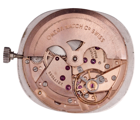

Excellent point, Aprax! Please see below a picture of the Omega 711.
As has been noted, the lay out of all the gears (gear train, automatic winding train, crown and ratchet wheel) on all movements is identical (plus the rotor attachment). This is not coincidence.
I have no clue who originally designed this line of movements. It may be Omega or F. Piguet or it may very well be another Swiss company in the 60's (or even earlier). However, I don't doubt that these movements share their origin.
If I would have to make a wild guess, it would be that Omega used these more "rough" ebauches for economical reasons as these were not good years for the watch industry (in fact very bad). Or Omega decided to use the same ebauche as used for the 711 but with added date mechanism. A lot of stuff that went on during the 70's and 80's most brands would prefer to forget about.
Or it could be a fake? Maybe. I prefer to keep my mind open.
It's definitely that family of movement. no question...
What's weird is ranfft has 6511 linked to that movement, but it doesn't appear anywhere on the page.

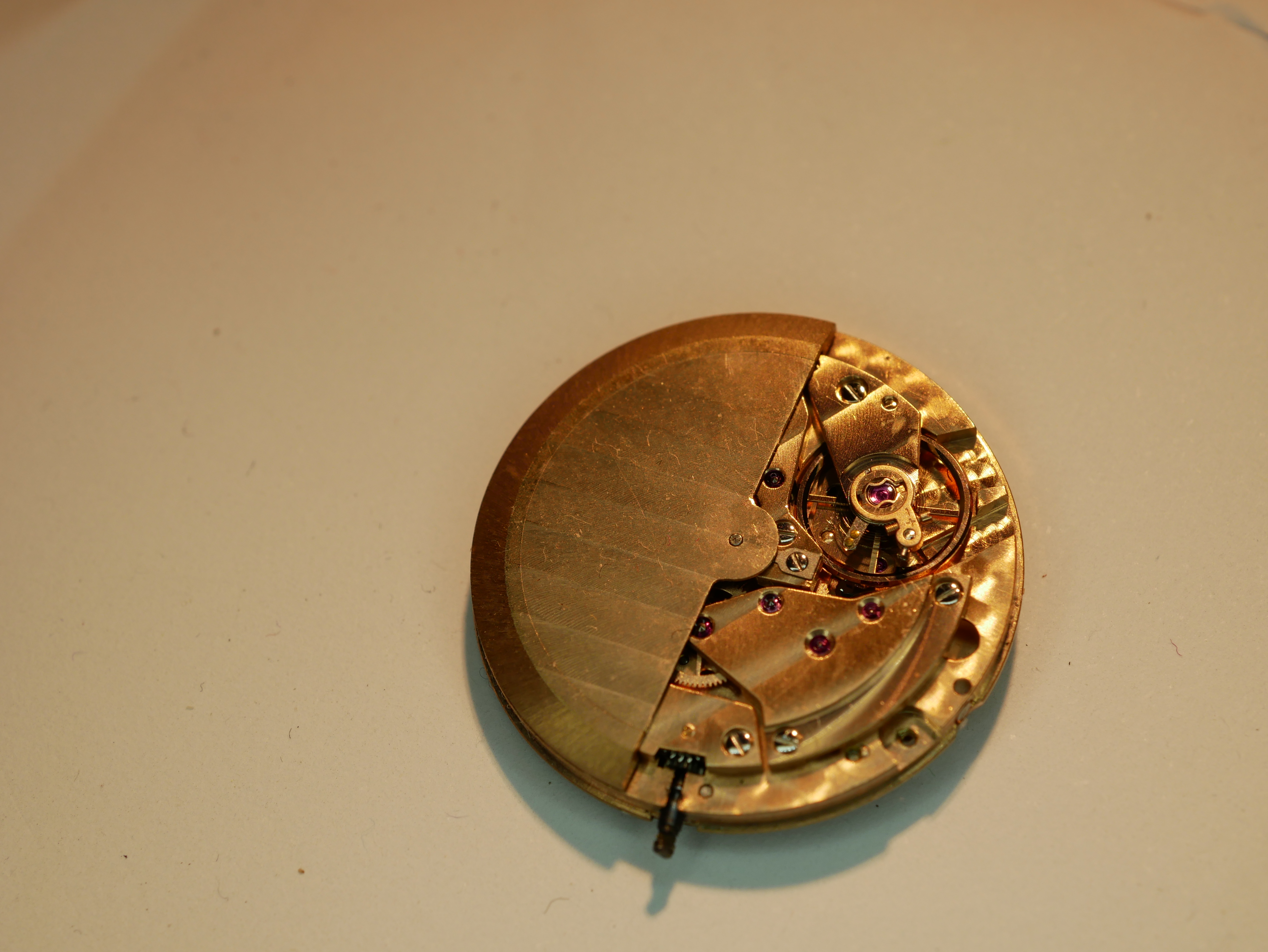

I came across this movement housed in a golden case. Whether the movement, nor the case show any markings or numbers.
A second one was sold here last year:
https://www.ricardo.ch/de/a/omega-prototyp-automatic-1135586130/
Can someone tell me anything about the movement? Data:
Diameter: 10.5'''
Thickens: only 3.2mm
Functions: no second; date with quick set function; TrioVis micro regulator
Beat rate: 28.800A/h
The lay out of the jewels, the retaining tounge for the rotor screams Omega.
If you pull up images of the 500 cal series & compaison along with the 1012, 1020, 1022 caliber you can see similarites. May have been an escapee from the turbulent shake up at that time in Switzerland. The other one you ref. to states a Prototype.
It is quite amazing the Swiss watch industry survived & pulled through thoses times.
The Swatch group bought up a lot of names & companies, Omega being one of the lucky ones. So, my guess is that movement is an original & most likely a small run or prototype that sliped out of the factory. You might have to do the old figerprint images of the set bridge for identification.
CIAO! Mike
