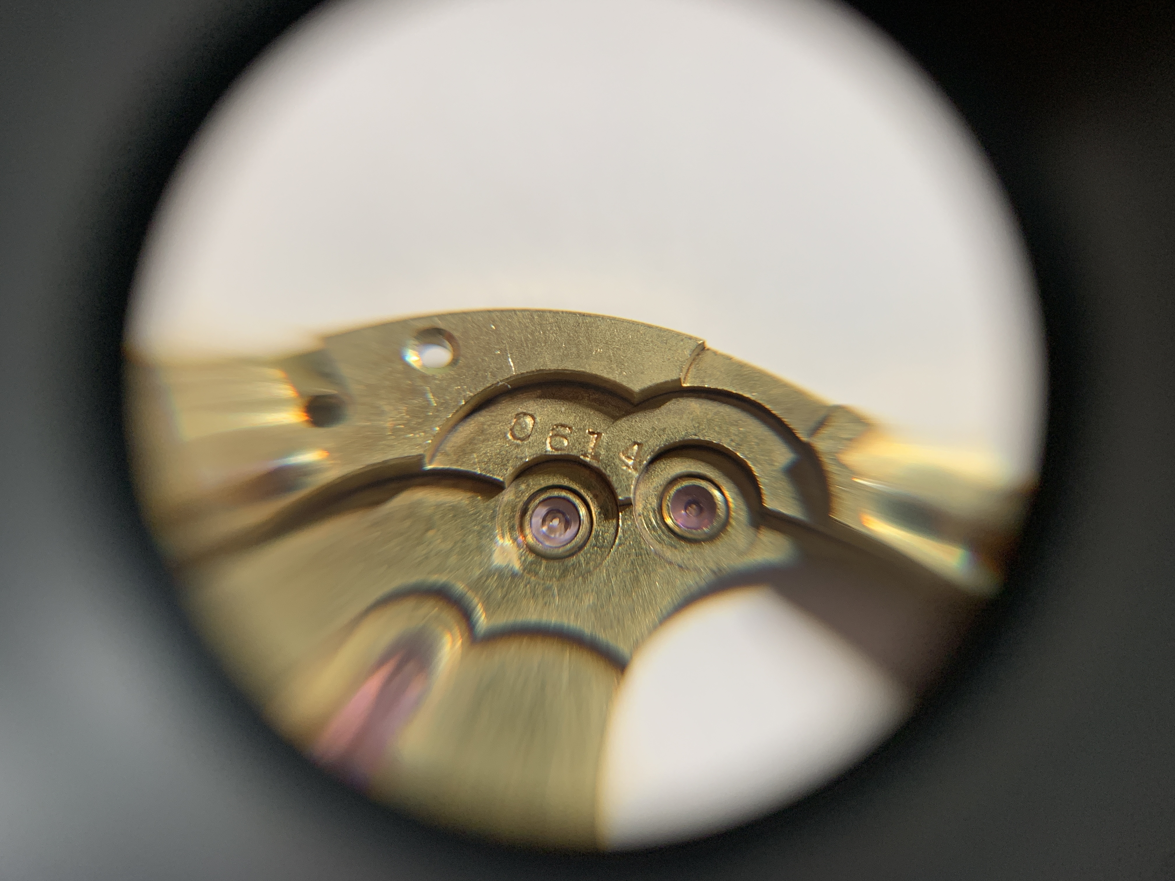

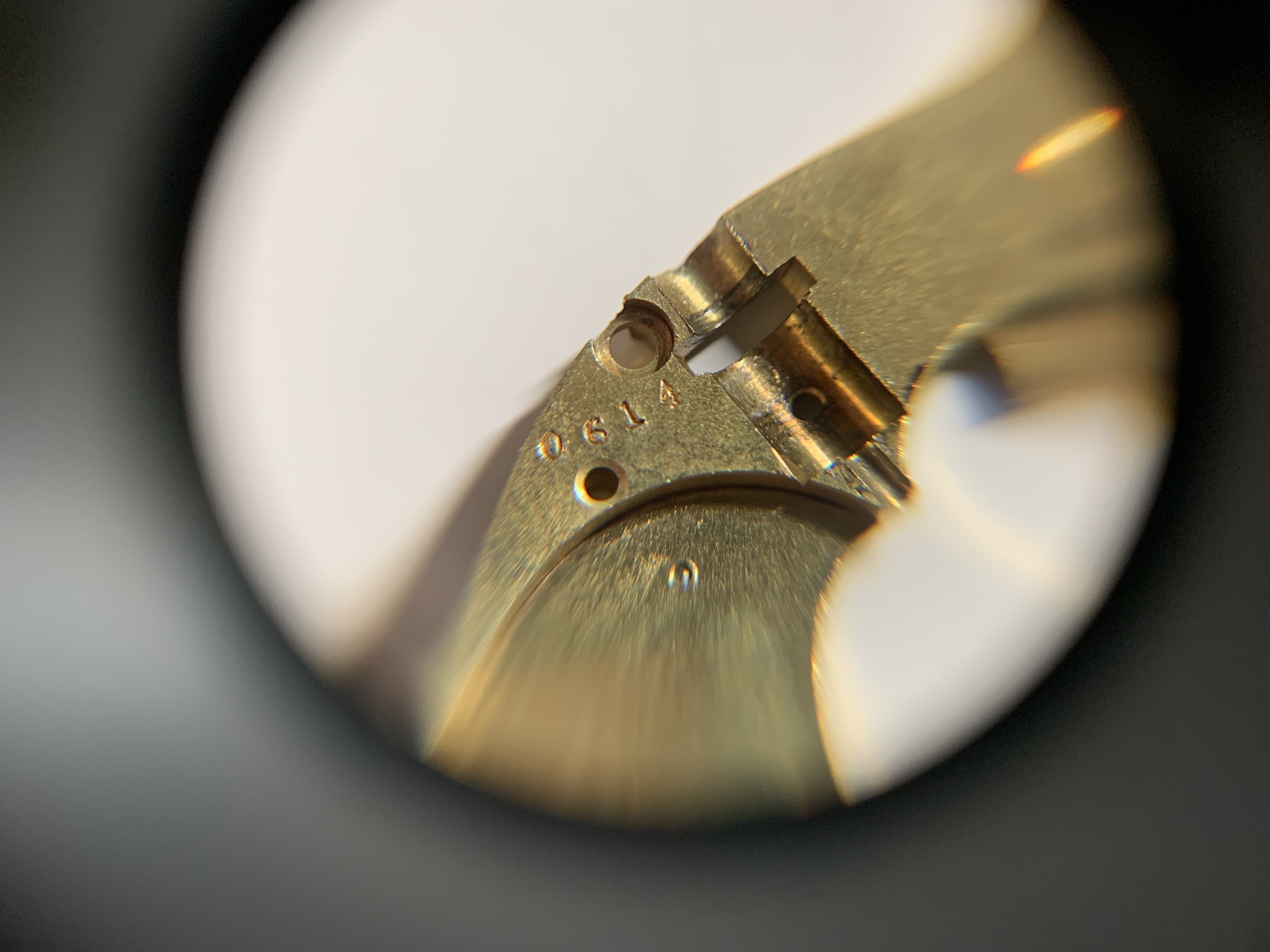

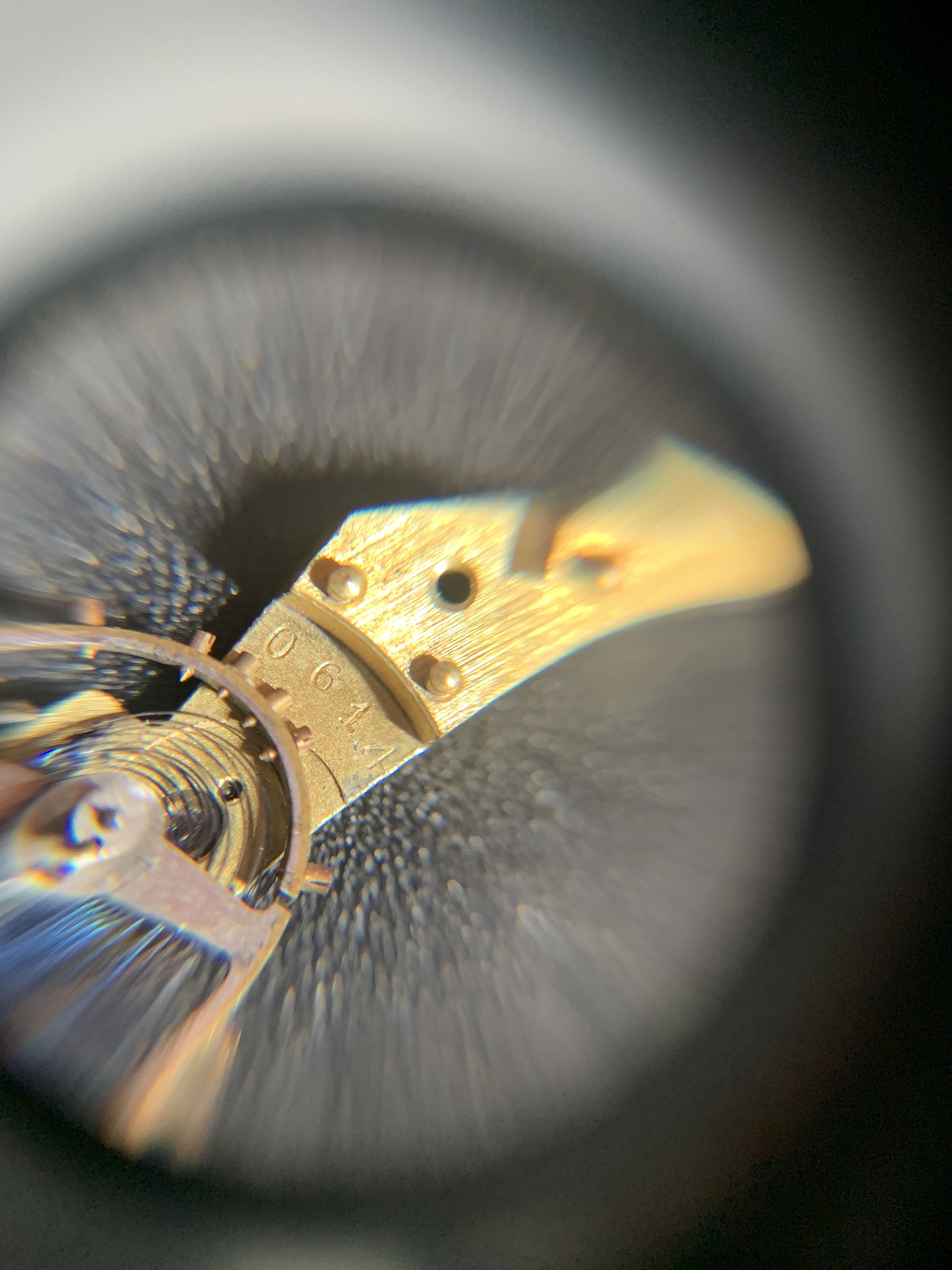

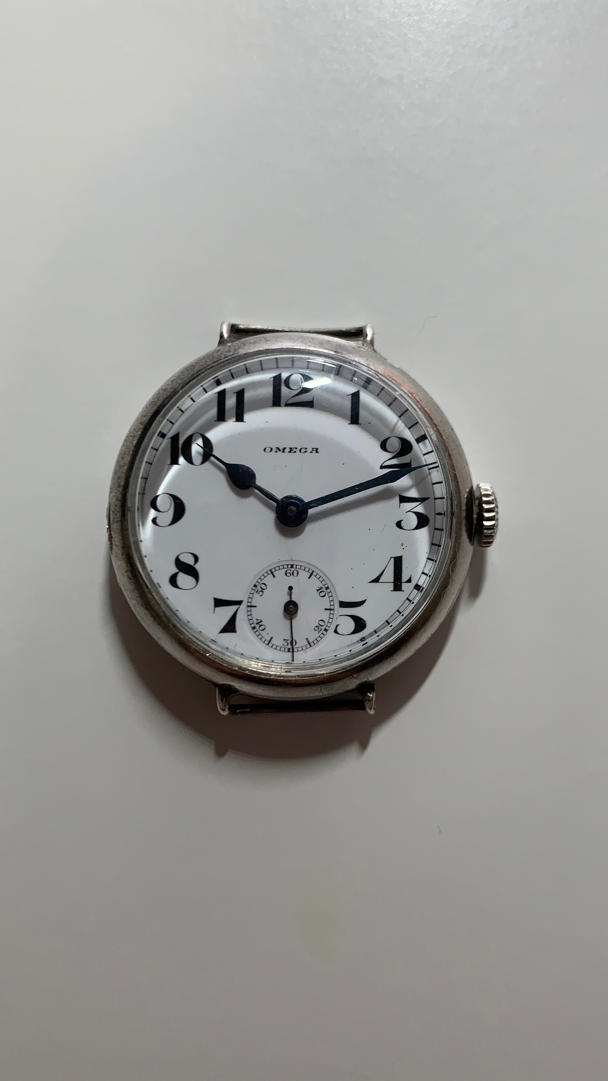

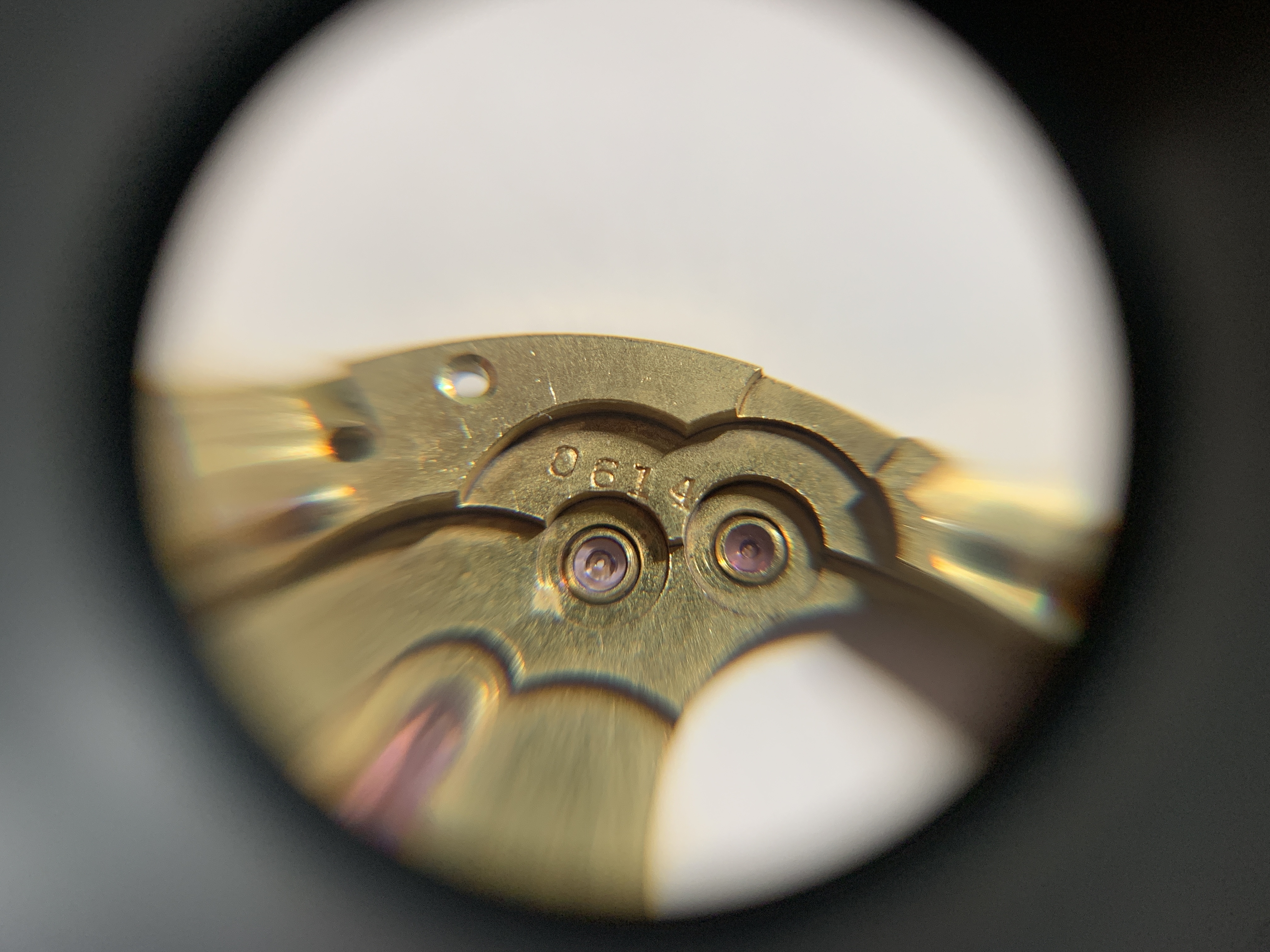

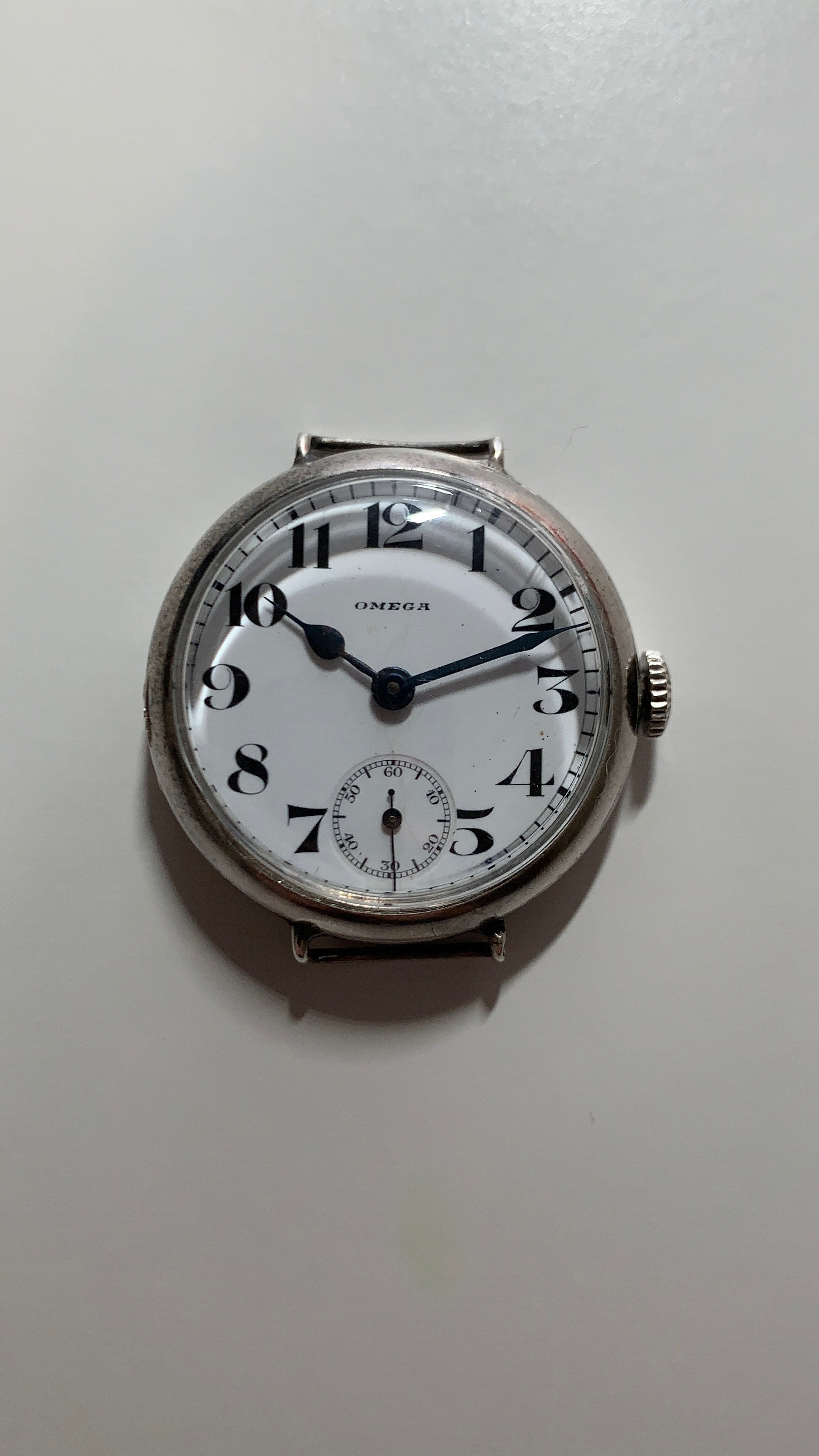

I recently acquired this Omega wrist watch with movement serial number 5310614.
The only other markings on this movement are under the bridges and the balance (marked 0614). I am assuming the 0614 was used to match parts to a specific main plate. I cannot find a reference to the caliber - even under the dial.
The dial has "27.5" with an "S" written on the backside. The diameter of the main plate is 29.52mm. I cannot find anything that seems close to this movement.
Does anyone have any ideas about what the caliber could be?

Have you searched the AJTT ? going by the diameter and movement design you should be able to determine the cal.

I have posted a few more photos of the underside of the bridge and the balance.
