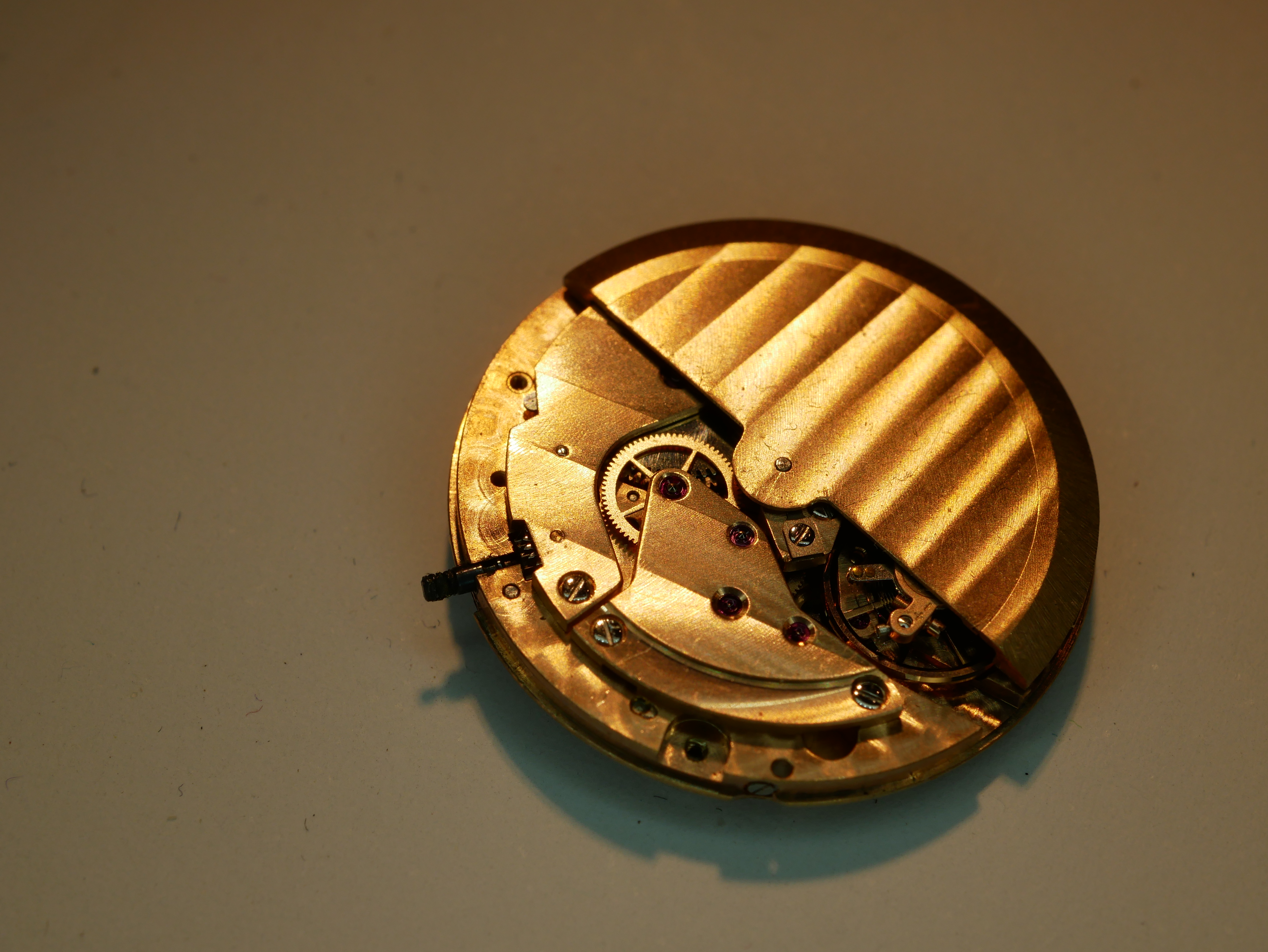

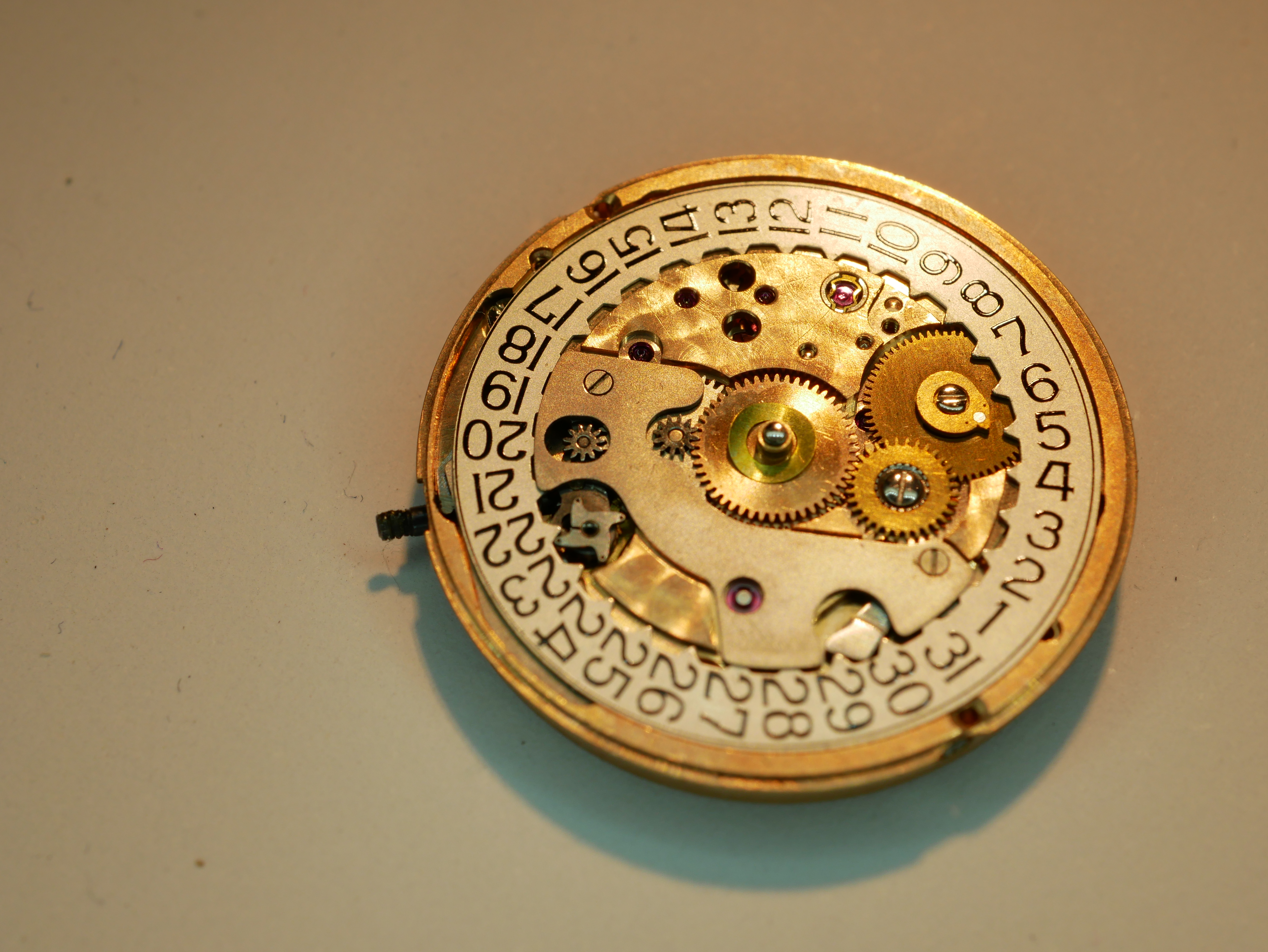

No there is no single stamp or engraving in the whole watch, except the dial. The movement is way to slim for a standard FHF, ETA or something similar. It measures only 3.2mm in thickness, including a quick set date function.

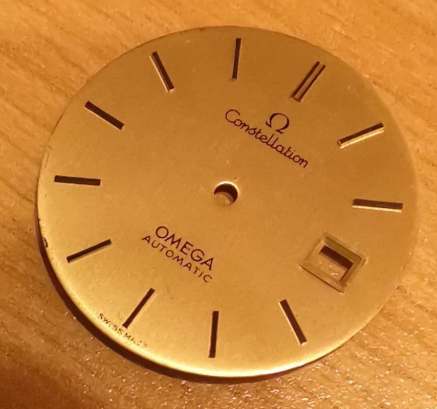

Very interesting that they both have non-chronometer Constellation dials mounted, those are from, what, the late seventies to early eighties?

As far as I can see, all parts are made of metal (brass and steel).Without removing any parts I count 23 Jewels. Maybe there are more for the center wheel and the wheels of the automatic gears.

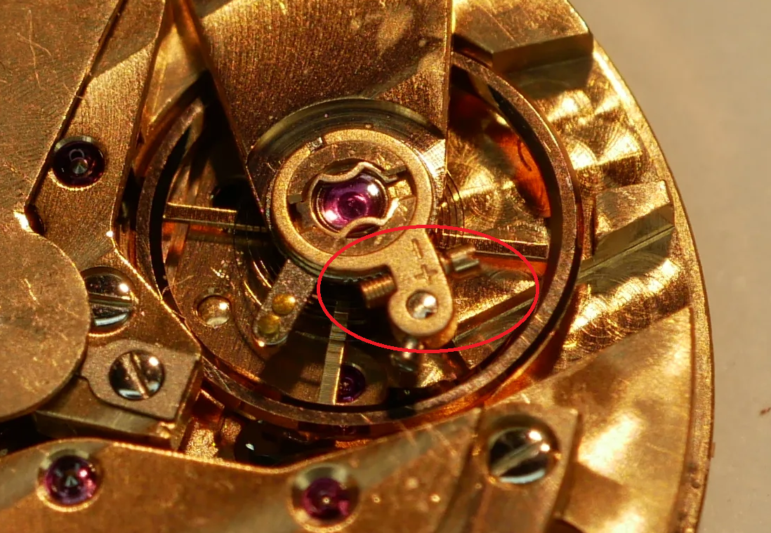

Looking at this photo, there is this unusual screw on the regulator marked with a + and -. It is not the screw that retains the stud, it is instead, a fine adjustment to the rate (like a swan neck on an Omega 550 series).

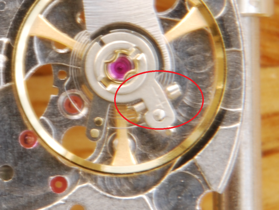

I've seen this before and here's a watch I serviced. I have never seen this feature on any other calibre but, it may be used by various manufacturers - other watchmakers may be able to comment:
Lot's of similar features in the shape of the parts as well. That is a Longines L633.1 so, I would suspect that your movement is a Longines or a copy of one. The finish looks poor on your movement and Longines always have very good finishes so it would be hard to believe it is a production Longines. Additionally, the spokes of the balance wheel are a far cheaper design.

Interesting. It's a very thin movement for an auto and shares some (well actually a number of) strands of "DNA" from other houses.
For example: Longines (as noted above), Omega (rotor retainer), A Schild (basic movement layout/incabloc/screw shapes) and even Seiko (dial side date works).
Ebauches S.A. was at the time I suspect this movement was made, a huge cartel of manufacturers, and possibly there were cross-pollinations of technology/design.
