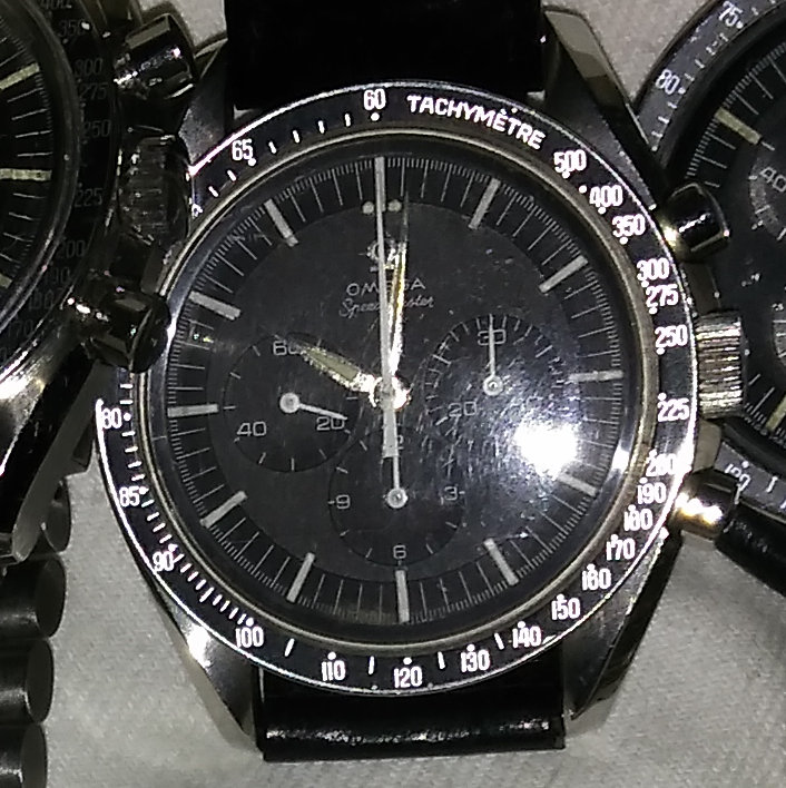

I took a look at your treasure box...congrats 👍 However, it took all of 5 seconds for something to jump out and hit me in the back of the eye-sockets (ignoring the incorrect bezels / washed dials).
With respect to all of your above mentioned comments regarding 'quality' and what's currently for sale, what exactly is/was this interesting piece in your box, and is this your quality?
- non-professional washed-of-all-lume dial (maybe has 't's)
- in a lyre-lug (professional) case
- with, what, later railmaster hour/min hands (too short to be 2998's)
- and a too short ultraman-style chrono hand
(If I had to hazard a guess I would say it was a 105.012 based on pushers, and maybe -63 with the benefit-of-the-doubt that the dial is original?)
I am so surprised, that on the basis of such a bad photo (quick shot), you can qualify the dial (with all reflection of the glass ) - Congratulations for me, you are a genius.

I didn’t qualify the dial, but the whole watch.
But the dial is easy using simple logic no matter how bad the pic 👍 Afterall it has hands with lume (a different color to ‘white’), and there are enough other watches there for ‘calibration’.
As to my questions...?

Hello ,
well observed 😉, 1963 - no professional under the Speedmaster and it has no "T" for Tritium, it's the last year, in 1964 it wasn't allowed to sale without "T".

I thought that there a consensus on 105012 all needing professional on the dial ?
9,217
24,055
Correct, though early -63s may be missing the Ts.
...and none should have seamaster hands .
Yes, there is a consensus. However, I(we - being OF, from posts here) have seen one other 105.012-63 without professional on the dial, as well as an early 60s period advert from Omega themselves with a professional cased Speedy (105012) without professional on the dial. Using those two little remembered ‘things’, and showing that we are a nice bunch of blokes here by ignoring the doubt of the authenticity of the dial for the benefit of ‘MrQuality’, apparently I correctly determined the sub reference of the strange watch. Or maybe it was just a lucky guess 😀 Seeing as how with every Speedmaster transition visual part changes bleed between the last and first sub-references (2915-3 -> 2998-1, 2998-62 -> 105.002, 105.002 -> 105.003, 145.012 -> 145.022) I don’t think it is a far fetched notion that the same could have happened very early on for ‘105.003 -> 105.012’ (despite this being the ‘new professional designation’, Omega production after all was not as strict as today). Not sure whether to expect t’s or not. And don’t get me wrong, strange watch is suspect due to Seamaster hands and funny chrono...

Yes, there is a consensus. However, I(we - being OF, from posts here) have seen one other 105.012-63 without professional on the dial, as well as an early 60s period advert from Omega themselves with a professional cased Speedy (105012) without professional on the dial. Using those two little remembered ‘things’, and showing that we are a nice bunch of blokes here by ignoring the doubt of the authenticity of the dial for the benefit of ‘MrQuality’, apparently I correctly determined the sub reference of the strange watch. Or maybe it was just a lucky guess 😀 Seeing as how with every Speedmaster transition visual part changes bleed between the last and first sub-references (2915-3 -> 2998-1, 2998-62 -> 105.002, 105.002 -> 105.003, 145.012 -> 145.022) I don’t think it is a far fetched notion that the same could have happened very early on for ‘105.003 -> 105.012’ (despite this being the ‘new professional designation’, Omega production after all was not as strict as today), but I would expect ‘t’s’ (but honestly can’t remember).
Where have all the vintage Speedmasters gone? Nowhere...they are still on planet Earth I say. They just need to be found again! Just look at the sales section...
I've seen the ad as well. I'm not sure it means they produced pre-pro 105012s & I guess it wouldn't make sense for Omega, since the value of the 105012 when it was launched was the "professional" aspect of it with the assymetrical case. Why they wouldn't they "advertise" this on the dial ? Anyway, anything might have happened

I do not think there is a collector here that would buy a 105.012 without professional on the dial as an original watch.
We could all be wrong, but that is how the money will fall.
