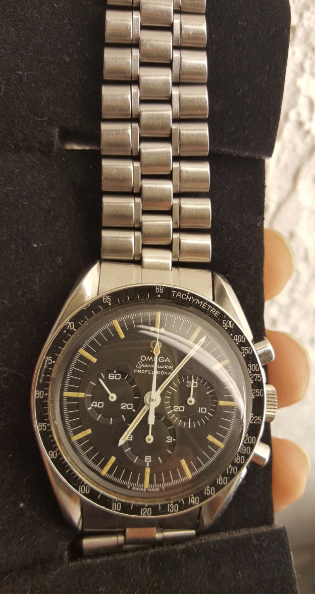

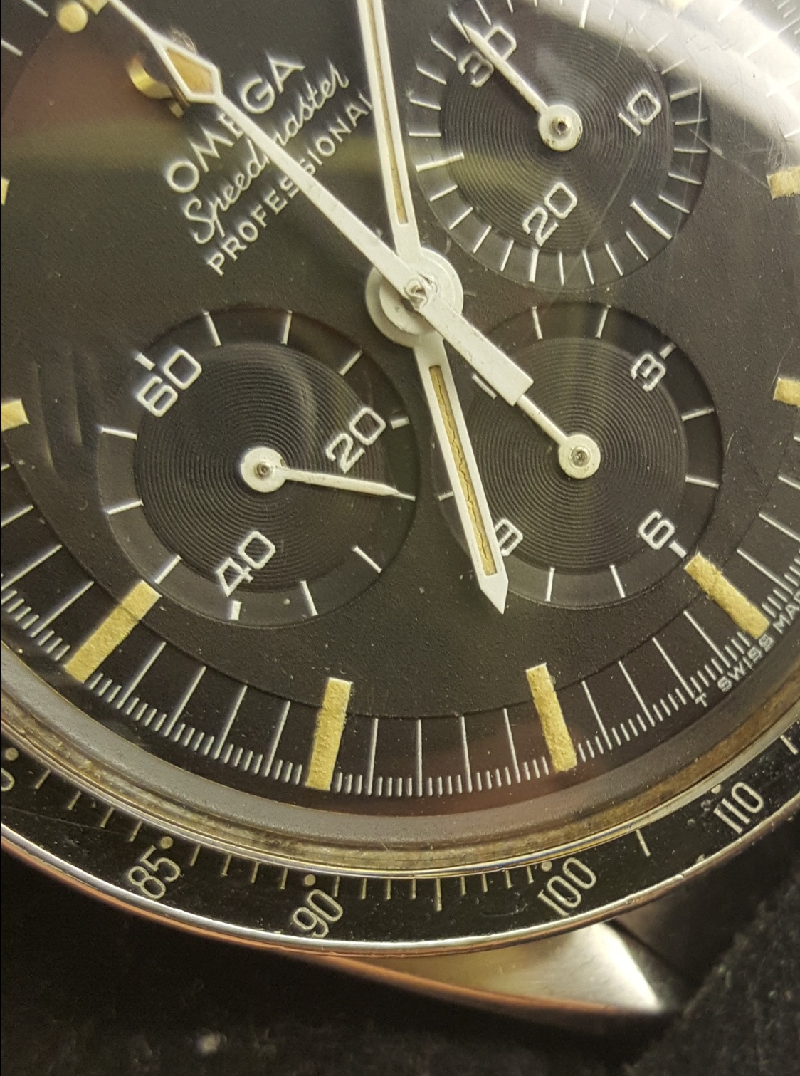

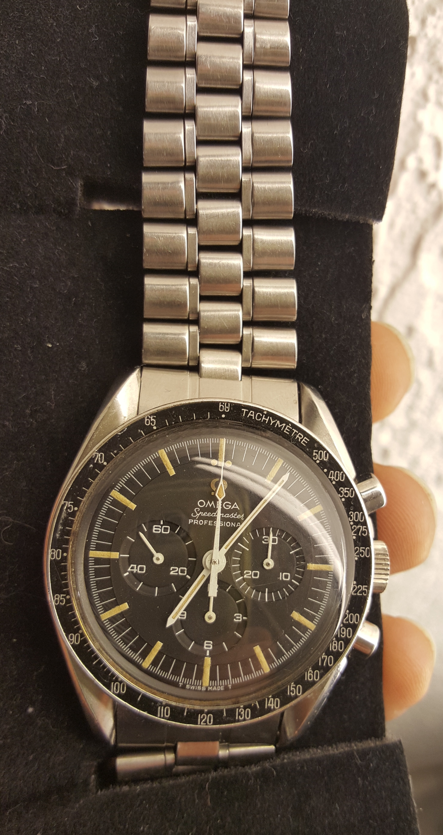

As promised...
Satisfied, as expected...
(Buts I'm not a photographer.... Don't know how to manage reflecting light...)

Very impressive work!
What year is your watch? Does it shine in the dark?

So If I well understood, it's not a redial but only a relume ?
Relume is a different job which requires different skills and tools than a redial.
Anyway it's a nice result.
Note : For reflecting light you need to add a polarizing filter on your camera.

Exact, only a relume, and I like the result, I had a look with a lens, it is really perfect.
Bravo Roberto... !
I just made a quick test in the dark: the index are visible, but I did not see the hands... I need to make a serious test again...
(The watch is a 145.012 from 1968)

You relume the hands as well? If the lume is too visible in the dark then is an obvious relume and it loses value in my opinion. Since is a vintage watch from the 1968 the indexes and hands should not be shining in the dark.
What I did:
The watch did not see the sun today.
At home, tonight. I go in a dark room: see nothing.
Switch on a light, place the watch under it for 20s, switch off, and then, I barely see the index. And not the hands, or it is too weak to see.
And yes, the hands have been relumed...
Is it normal?...

Correction: I see the hands. But it is very very weak...

And I have the confirmation that Roberto uses real tritium... Wonder how he can get this forbidden substance...

He may have an old stock.
I was not sure that hands were relumed when I see the crack on the hour hand lume.

I will say the intention of the watchmaker is to make those real weak! A 1968 watch can not shine as new, it does not look right. I would not want my vintage watch to shine in the dark as a brand new watch.
The look of the lume on the hands with the crack is really good! Only a true artist can do something like that!
