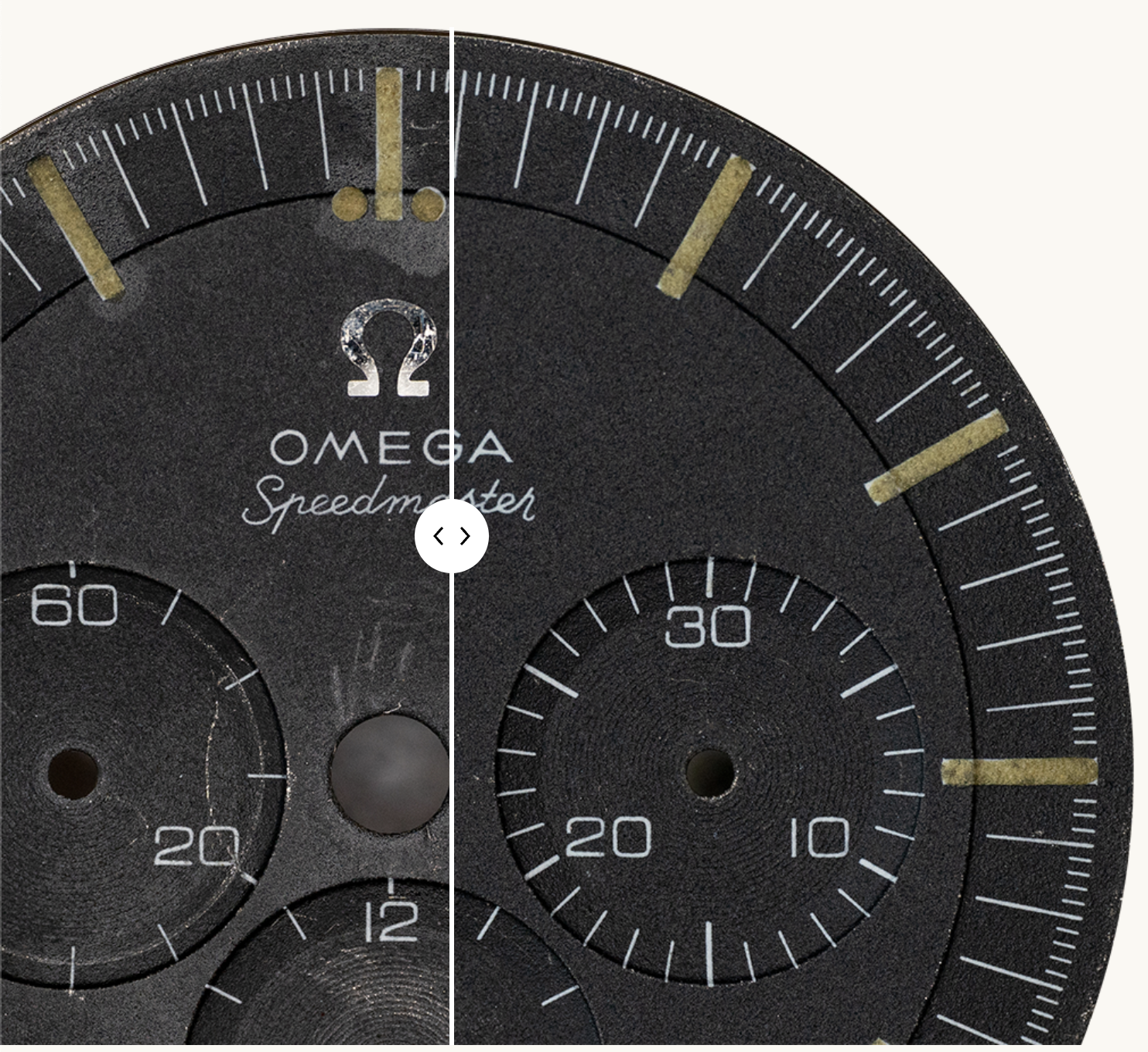

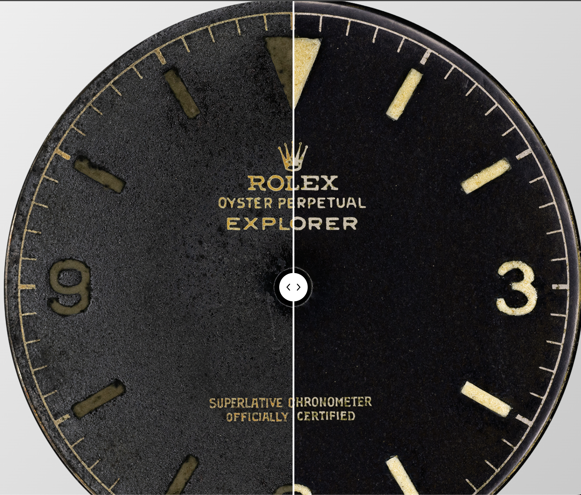

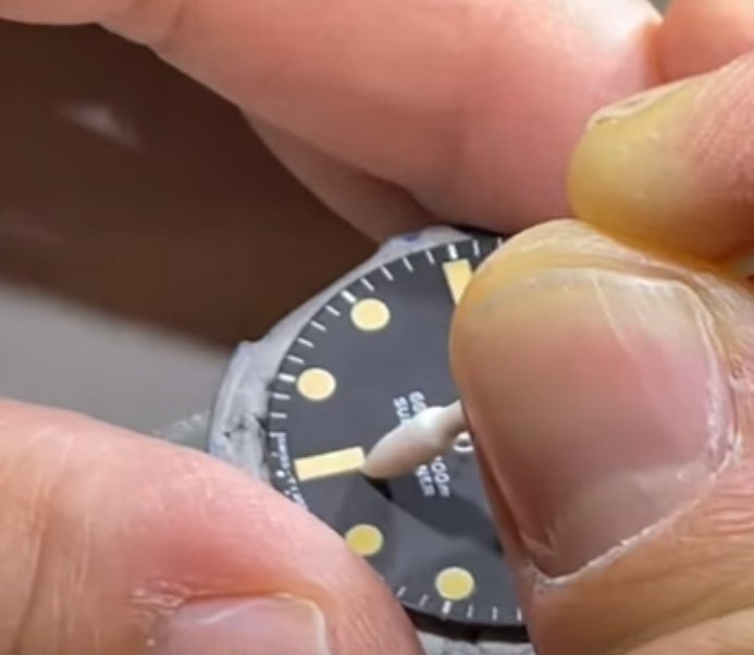

Just wanted to amke a post and get any info i can on how people are re-paint and refinishing dials.
Ive seen heaps of amazing work and its something ild love to offer to clients
Pic Attached on some ive seen

I spent years back in the 1990s taking jewelry classes in attempts to learn how to make and fix dials. At the time I was working for Apple and had access to then cutting edge laser printing technology.
The photos may use some trick lighting to make things look better than they really are.
The main issue is these are done with thin layers of lacquer. So once it is gone it is gone. The process is a sort of decal. The machines used are called pad printers. These use printing plates similar to the ones used for printing currency. So unless one has the original plates ...
There may be people in places like Italy or Vietnam, whom are chemists and can come up with good ways to paint and restore dials. These same people can make counterfeit currency although I suspect counterfeiting watch dials has less risk of a prison sentence. Art forgers may also have the skill. There are also book forgers who fake illuminated manuscripts and medieval binding. This has been going on for millennia as such things are called palimpsest. I used to spend a lot of time one the Voynich Benike Mss 480 mailing lists. Most of us who have spent decades now think it is a forgery.
Perhaps there is some gas process what could remove the grime in a vacuum chamber? Any liquid or abrasive is going to remove more than what is needed and damage the watch.
This does not mean I will not try my hand again at dial restoration. Such work however will always have tells, intentional or not what will let the experts know a restoration was involved.

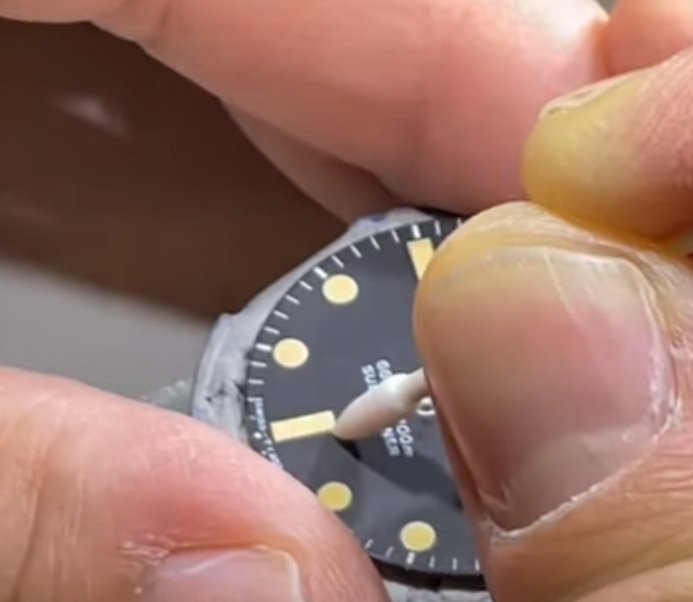

Ive seen some guy on youtube do it with a cotton swab and some Mystery liquid, even just being able to clean off whatevers on there and re finish would be handy

Almost impossible and any real watchmaker wouldn’t touch a vintage dial like that with a 10-foot pole.
Could you post a link to that video, please? There's a big difference between cleaning a dial (generally a bad idea) and refinishing a dial (even the best restorations don't match the quality of the original dial). I'm fairly certain that there are no skilled dial refinishers whose primary tools are a cotton swab and mystery refinishing liquid.
9
Around the 5 min mark
Also peep his instagram - has some good results as well for refinishing, My thinking its possibly a spray matte finish after hes touched up with hobby paint

Go for it. Start with a Rolex Milsub Dial .
So the guy is showing off with a pricey dial (restoration 🙄 can't stand the word)... Bare handed dial handling.
This is hilarious. If the dial is genuine ( I have my doubts , but pics. are lousy ) , you want to spray a matte' clear coat of paint over it ? That is the easiest way to reduce the Dial value from $ 20.000 to $ 200....

You are hopeless. Good luck for your future. That Milsub , if original, fetches Pounds 50.000 at Auction...

Yes, only the success stories are ever shown. I sometimes get emails from customers of other watchmakers asking what to do when the watchmaker has tried to "clean" the dial, and the printing is now gone, like this one...
This one was rinsed with the mystery liquid called "solvent H." Commonly used by some watchmakers to clean dials, but even though they say they do it all the time without problems, this is what happens when you push your luck.
The way he stabilized the lume on the hands in the video is odd. There's no need to mix any colour, you just apply the clear binder to the back of the hands - it doesn't change the colour of the lume at all. I've stabilized hundreds of hand sets using clear binder without having any colour change.
