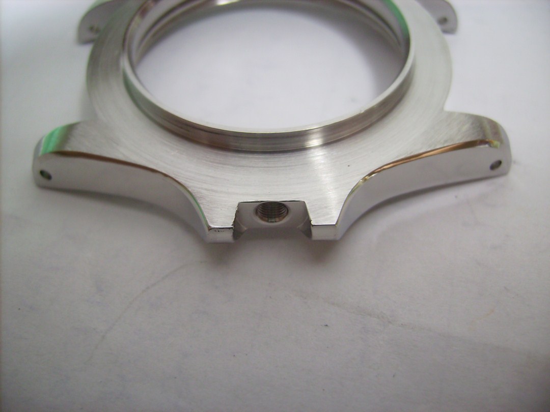

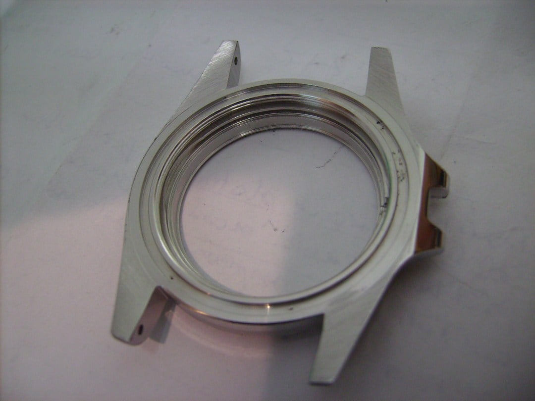

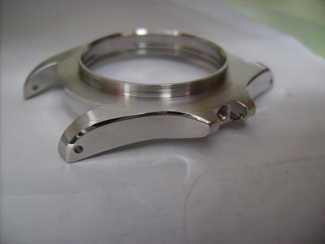

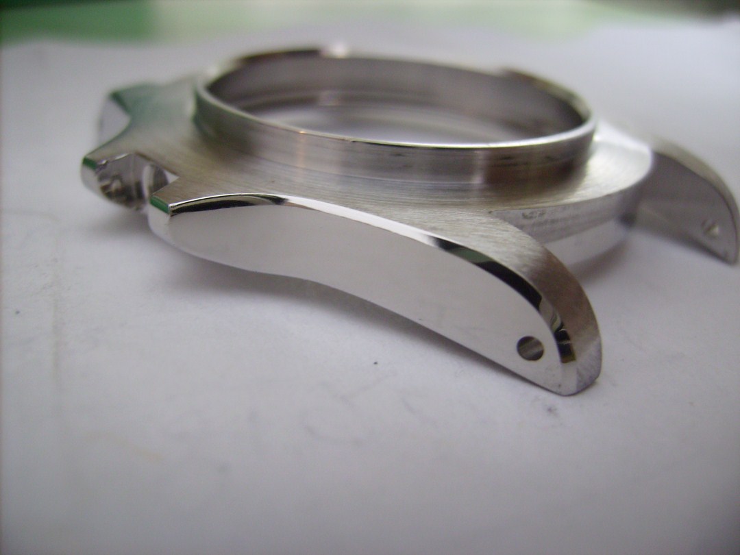

On a somewhat different note, but in the same paradigm 馃槻
http://www.yukiwatch.com/catalog/item/9060661/10345806.htm
Before you chastise me for posting: I assume this is a commonly known place for crooks, because the URL is desperately easy to find... True sharks would know already about it anyway. I read about the company on another watch forum, in a post from a while ago. I'm surprised Rolex doesn't do anything about it 馃槙 Mods feel free to delete if off-policy.
(the rest of the website is pretty enlightening, too 馃槖 what's crazy is, it's all "in the open")

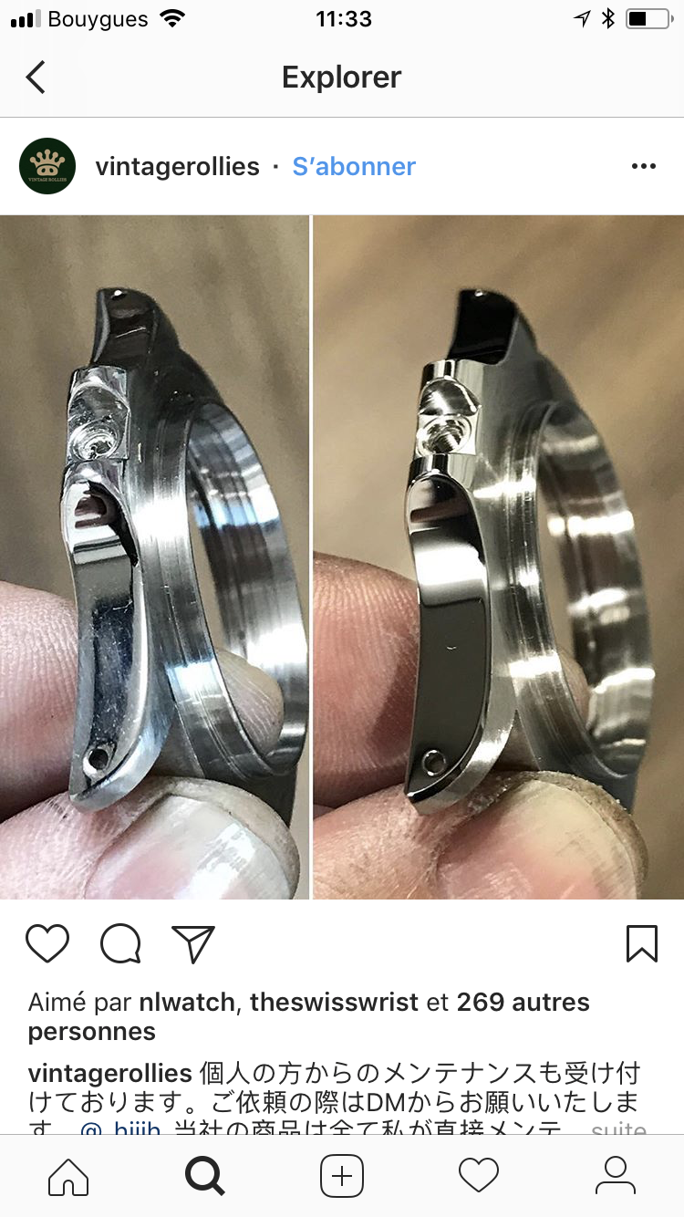

Just saw this on IG today ... quite impressive
Another reason to stick with age adequate traces, scars or polishing when it comes to vintage "Rollies"

..a Comex-Dial for 128 USD..I think I should change profession and become a Vintage Rolex-Dealer!

What a scary place... $200 for a 6263 dial !! ::facepalm1::

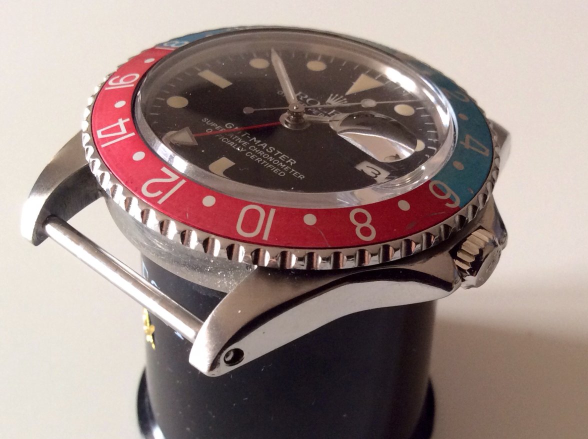

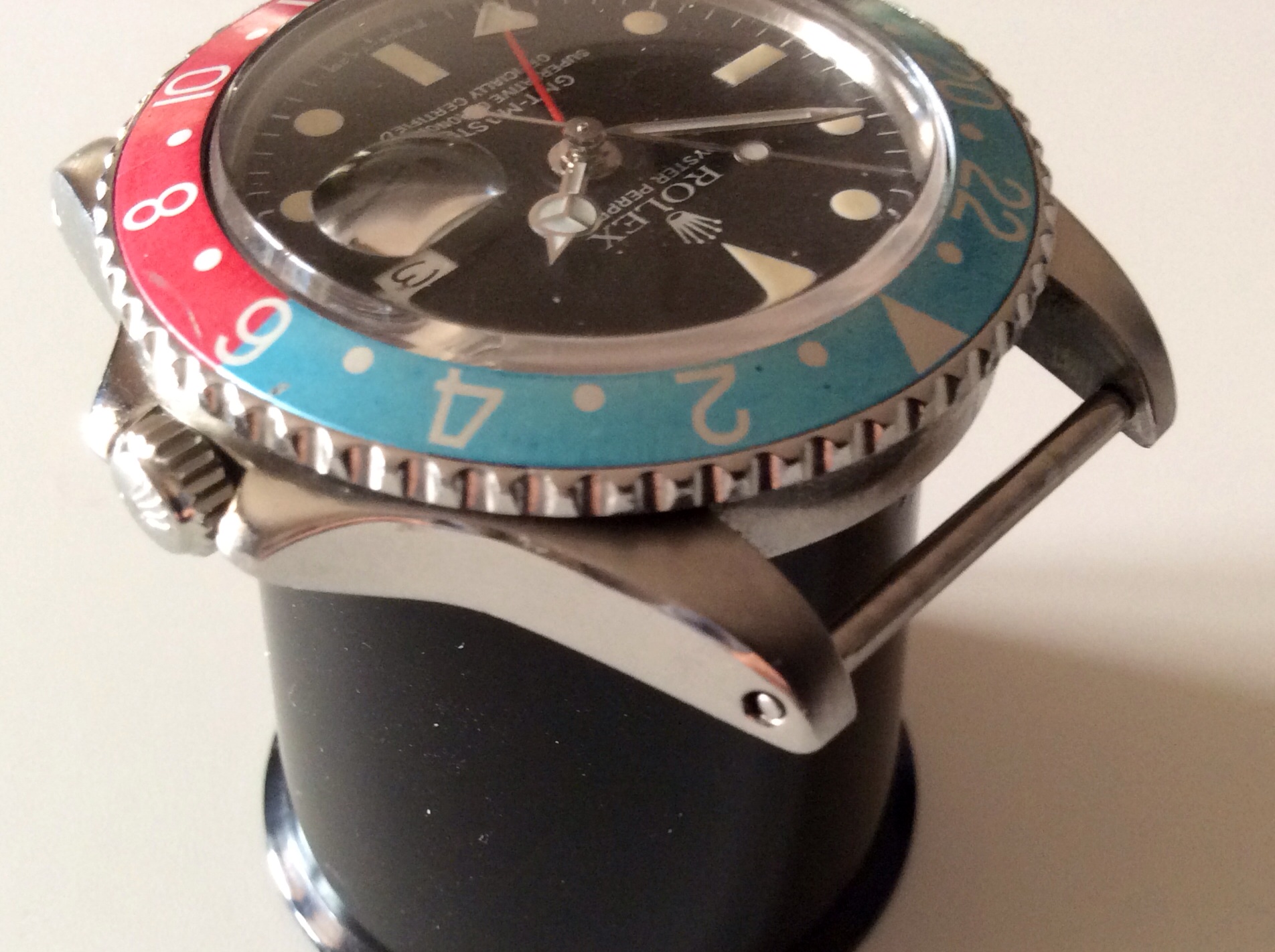

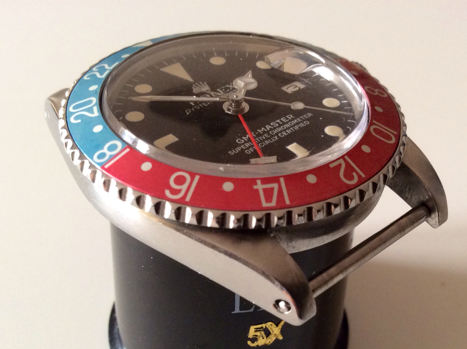

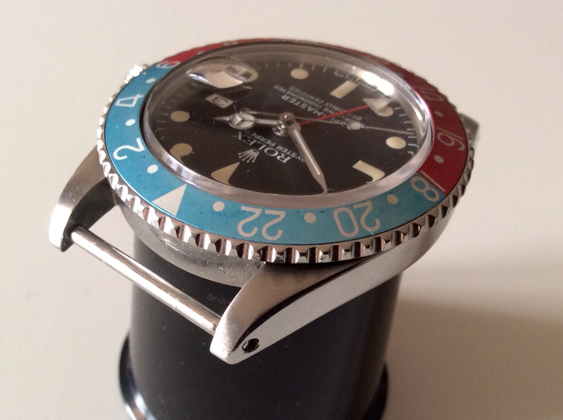

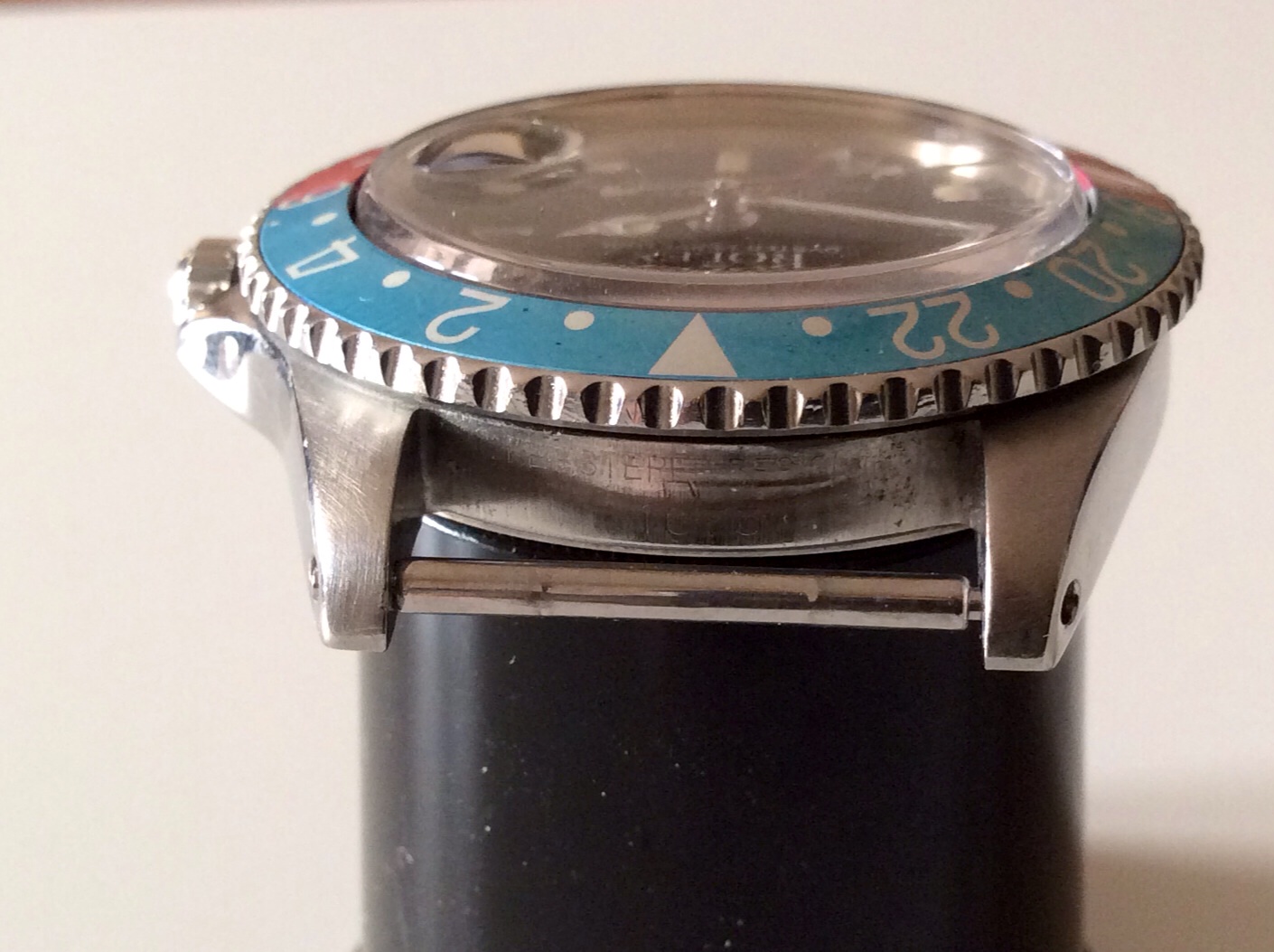

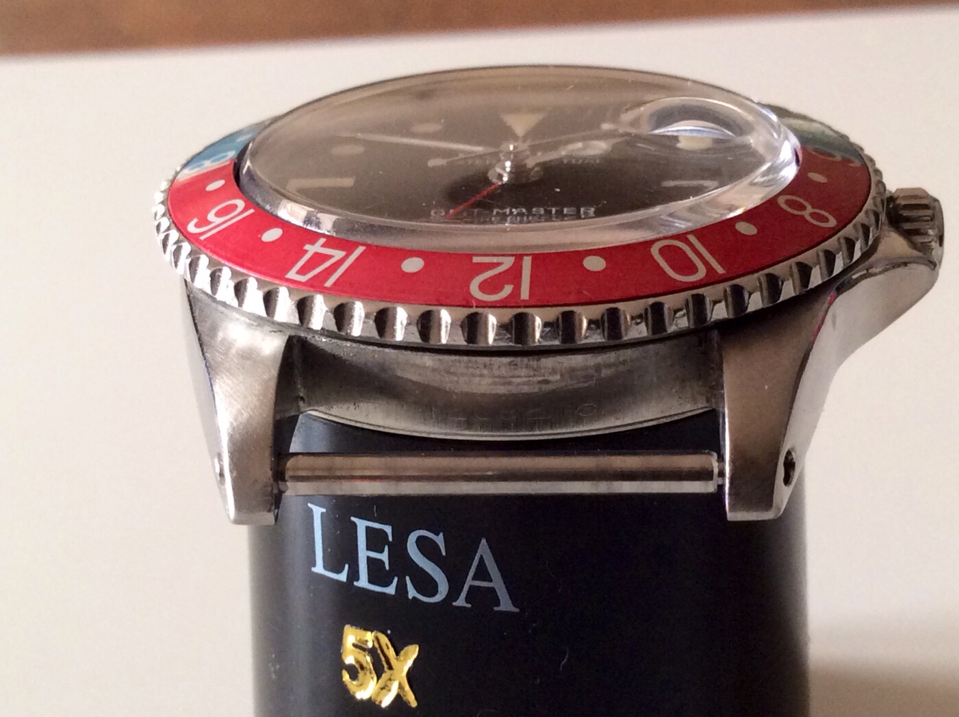

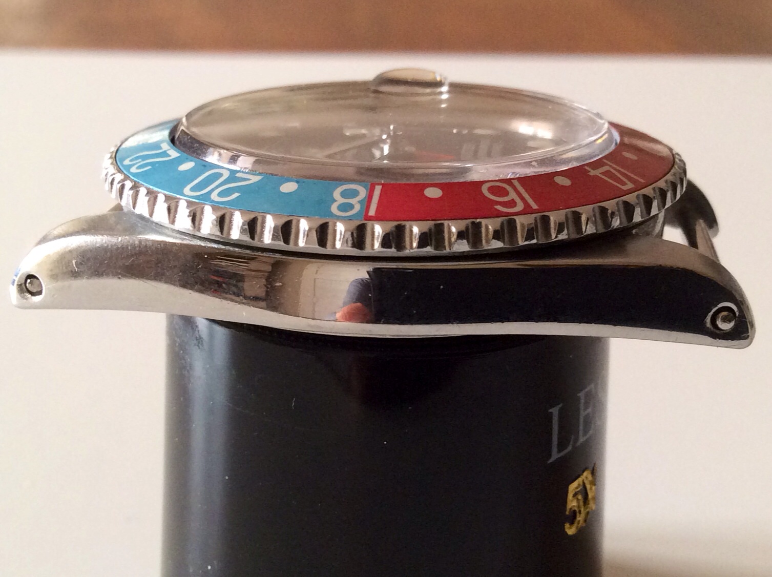

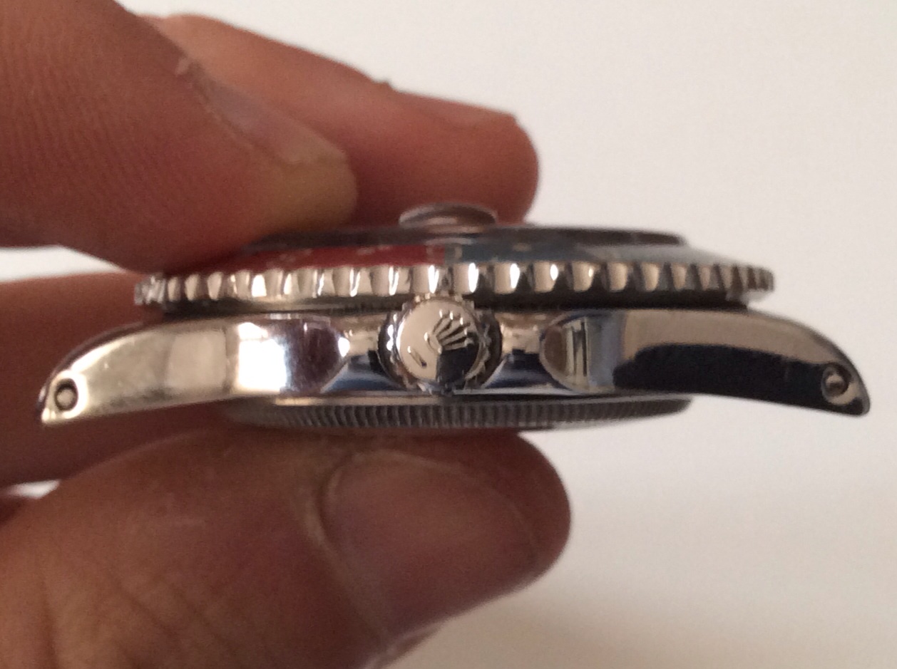

All of these watches were originally hand finished so they all look slightly different. The thickness of the chamfers also changed over the years, compare the chamfers of a 1675 with those of a 16750. The crown guards were also different.
Unpolished 1675:
16750, thinner chamfer. And look at the line on the crown guard:
The thickness of the chamfers was wide in the gilt era through around the Mark 2 matte dials and then started to become smaller through the 70's and into the 16750, as was shown in the post I'm quoting. The crown guard chamfer line moved toward the case, like in the 16750 that's pictured, as early as in 5.5m cased 1675s. Interestingly, there seems to be a good amount of overlap in the traditional 1675 crown guard chamfers and the 16750 between 5.5 and 6.0m when the 16750's take over. I haven't found a good logic to which case with which dial = crown guards A or B so I haven't put it up on my GMT site yet - gmtmaster1675.com for those interested. The site still needs some work and would love more input from you all.
Regarding cut/recut cases, it's easy to spot cases that are just recut but it can be very hard when metal has been added and the case is artificially aged. So, as always, buy the seller.

this is quite the eye-opener. at this point, i fear given the time it would take me to gain enough expertise to dabble into vintage rolex. I might be only be able to own a good condition vintage by buying a new one now and letting it sit in a drawer for thirty years.

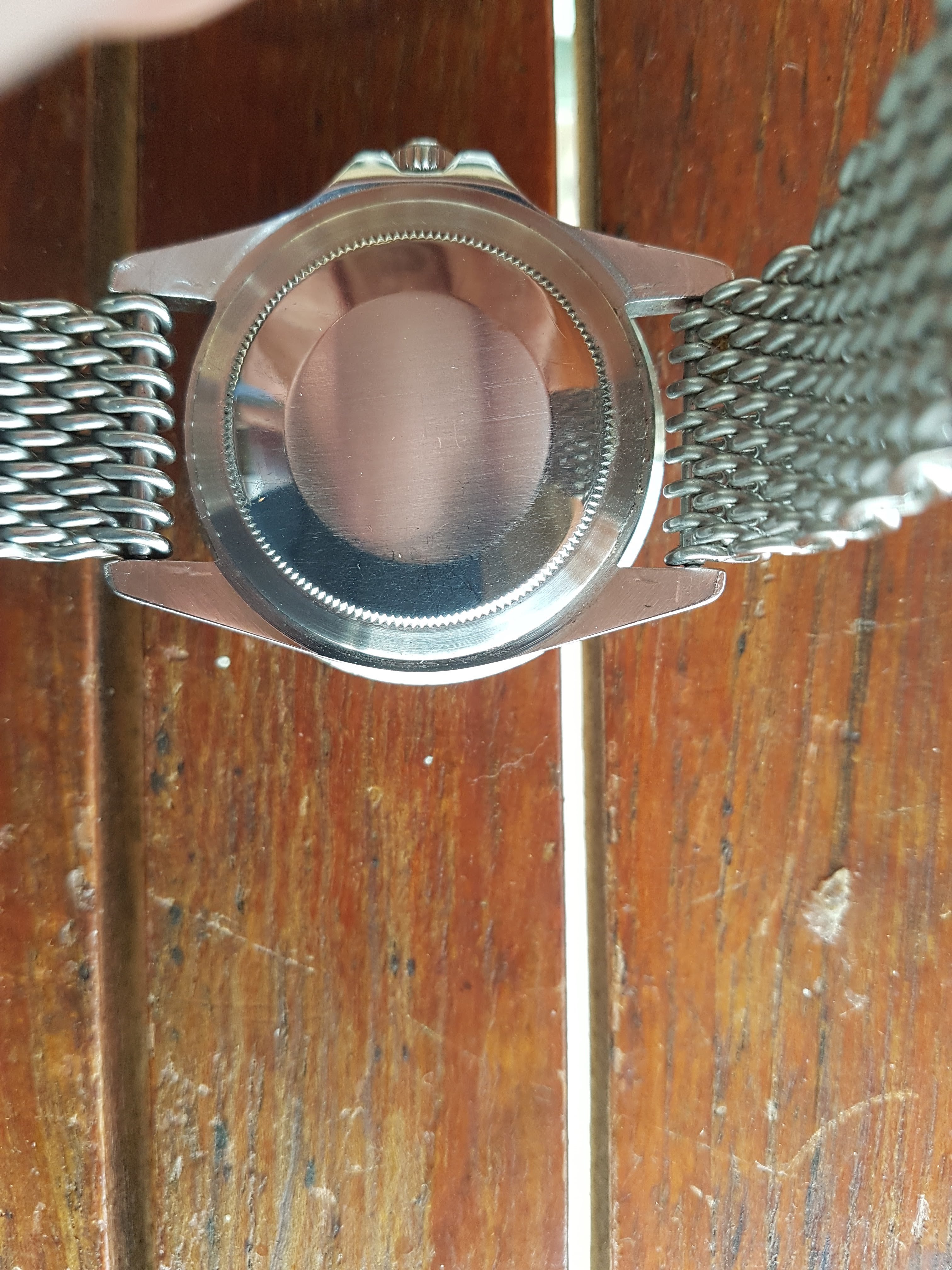

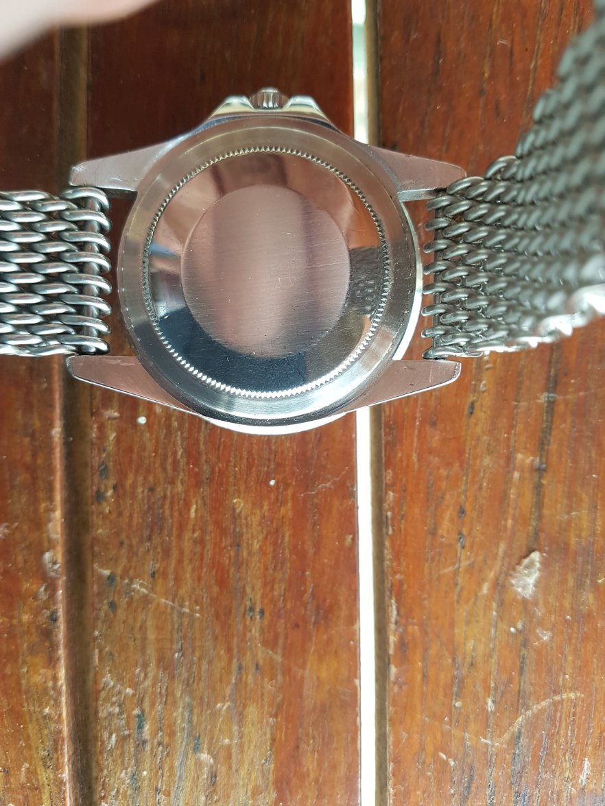

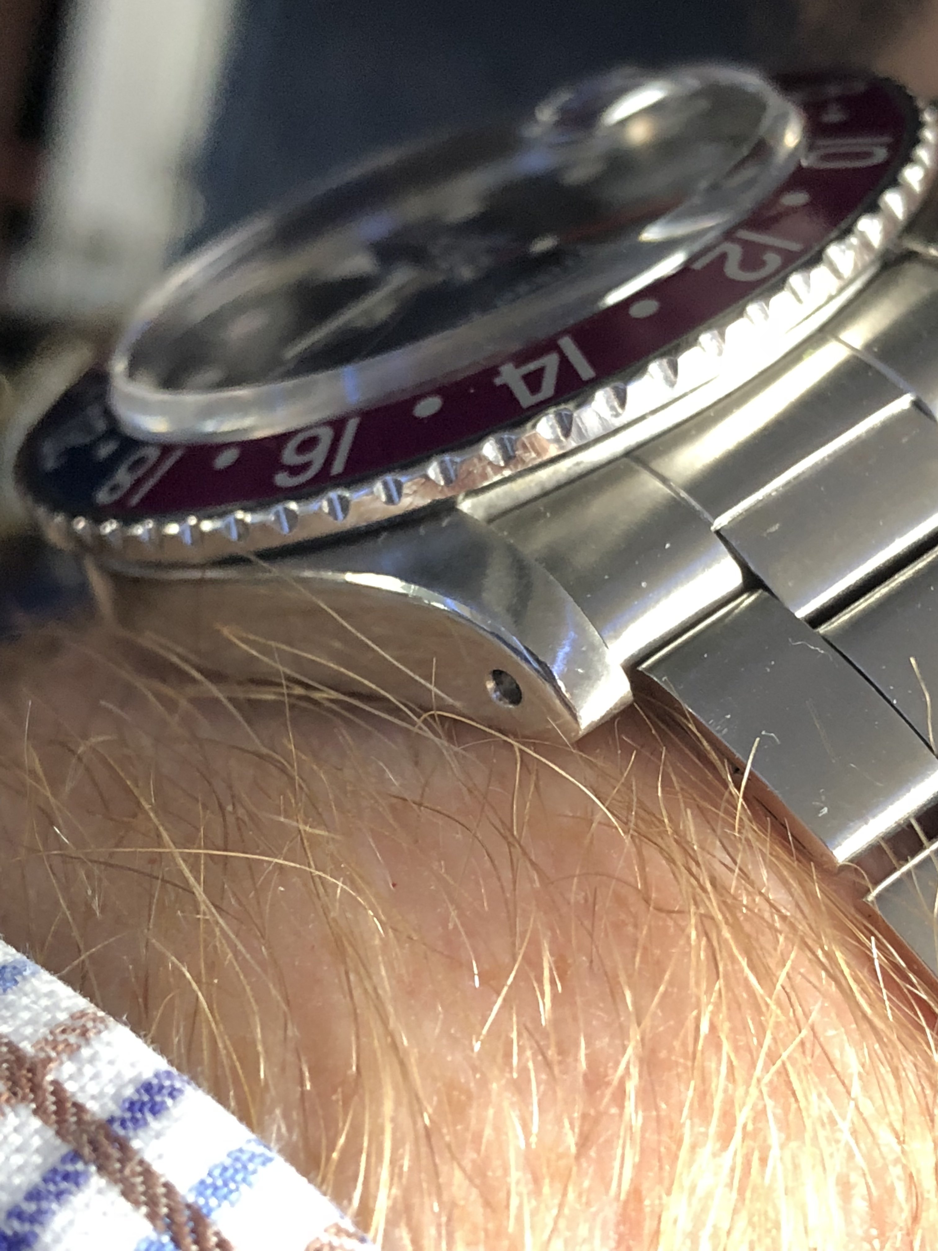

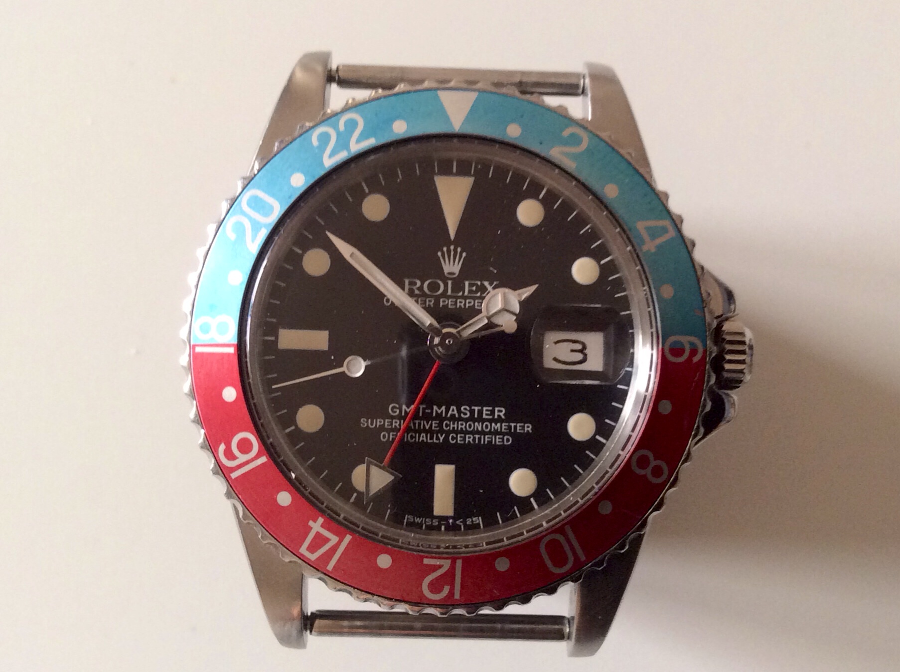

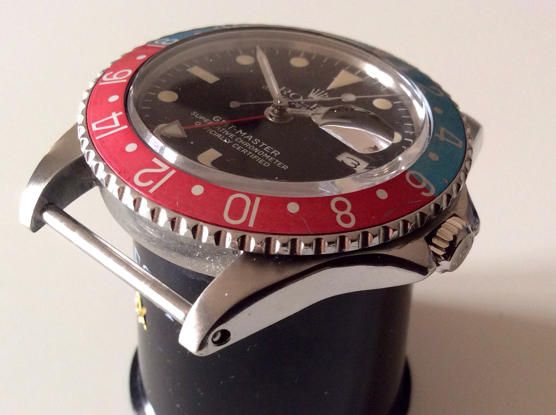

My polished 1675...a recut would do wonders, but I am holding off.
I have a 71 1675 in the same condition, just over polilshed.
I try to ignore it but it niggles, I bought it from the original owner so that helps my concern.
I think to rectify this case would be prohibitive $ wise?

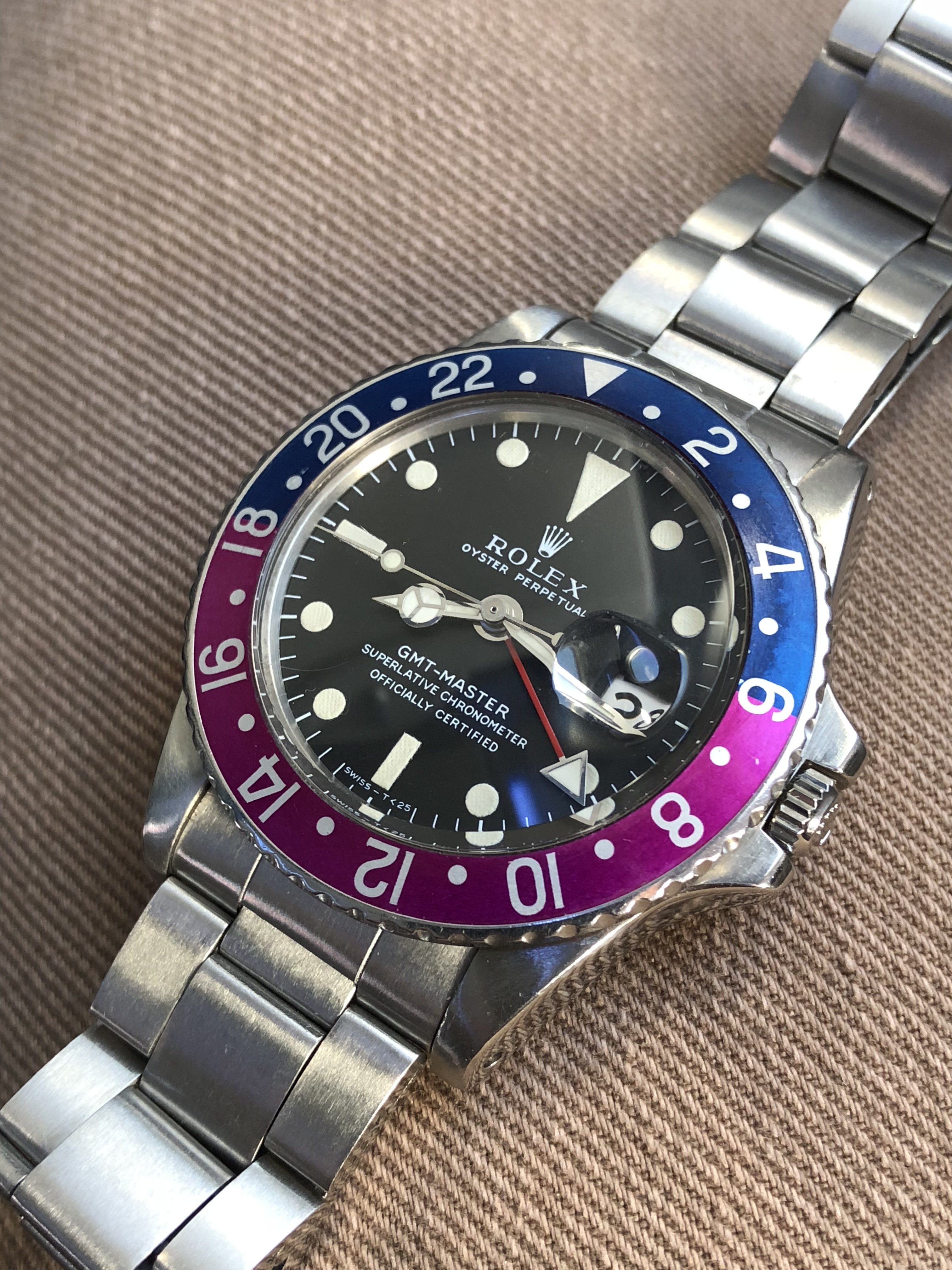

I'm perfectly happy with a nice, honest, period correct GMT. Not going to go crazy and on a foolish hunt to find an 'unpolished' watch, I buy what I like and enjoy wearing it. None of these watches are going to be perfect after 30-40 years of use, which is what's most attractive to me. Would I enjoy a NOS 1675? Probably a cool watch to own, but not one to wear, so where is the enjoyment in that? I have NOS watches in my collection, they are an enigma, a test in ones will power.
This GMT brings me the most pleasure to wear on weekends. It's an honest '72, MK2 and most notably, its been POLISHED....which doesn't bother me one bit.
Good on you man , I know the feeling.
Nice looking piece btw.
Measure the lug length tip to tip. Spec should be 47.5mm, a restorer would would have to weld metal to the top and sides of the lugs before the recut for a good restoration. LAWW just recut which leaves your with a bevel but thin lugs.
$500 is what LAWW charges to recut and lap the case. I have toyed with it, but then it will look brand new...
2,218
6,927
There isn鈥檛 much metal left on your case, the lug holes are so close to the edge. If you decide to refinish, metal would need to be added. If it bothers you, go for it, I鈥檇 leave it as is and enjoy the watch. Remember, a watch is original only once.
