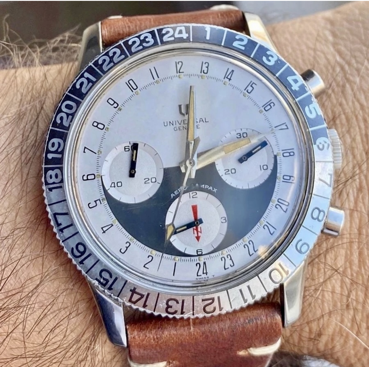

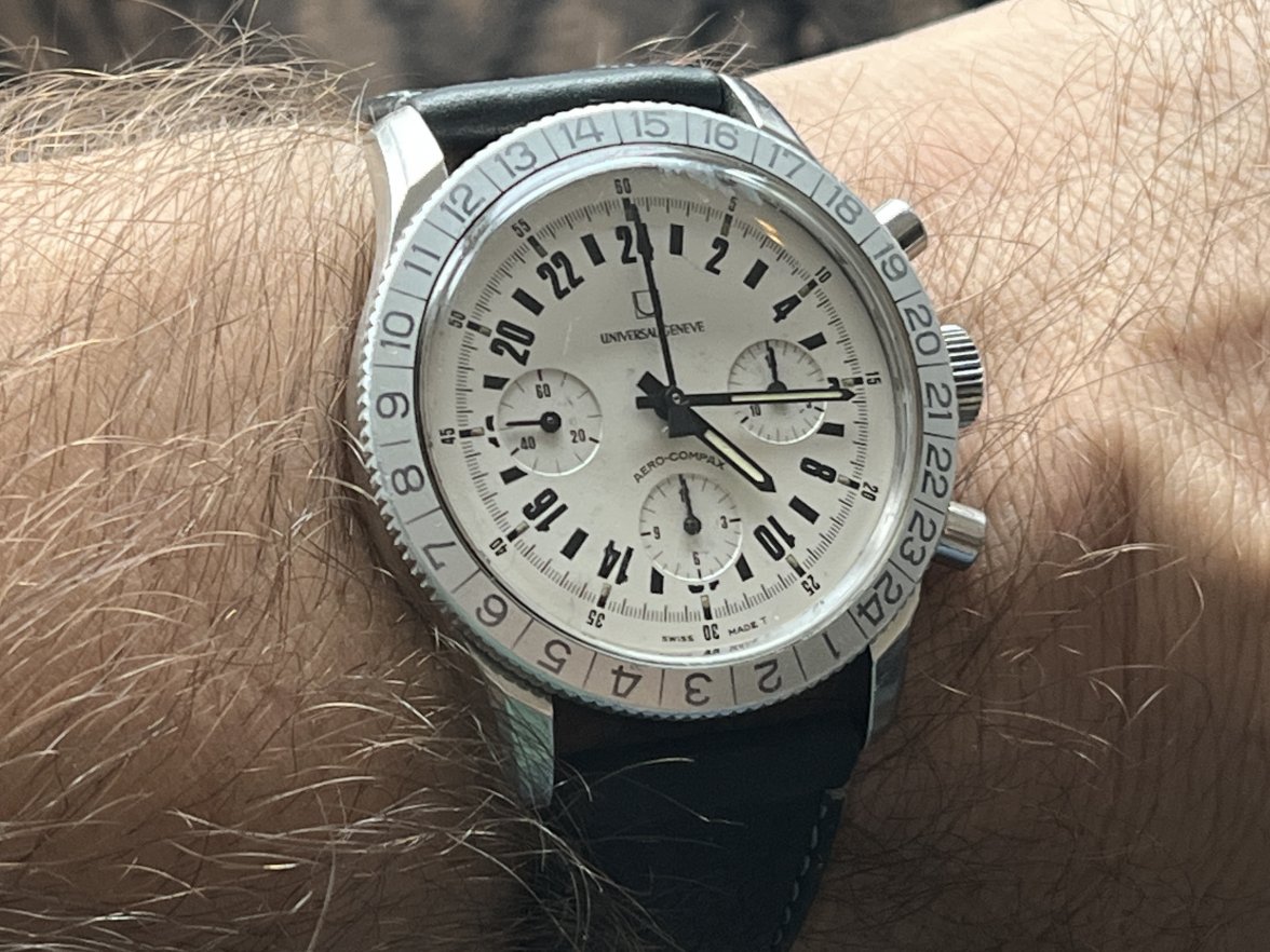

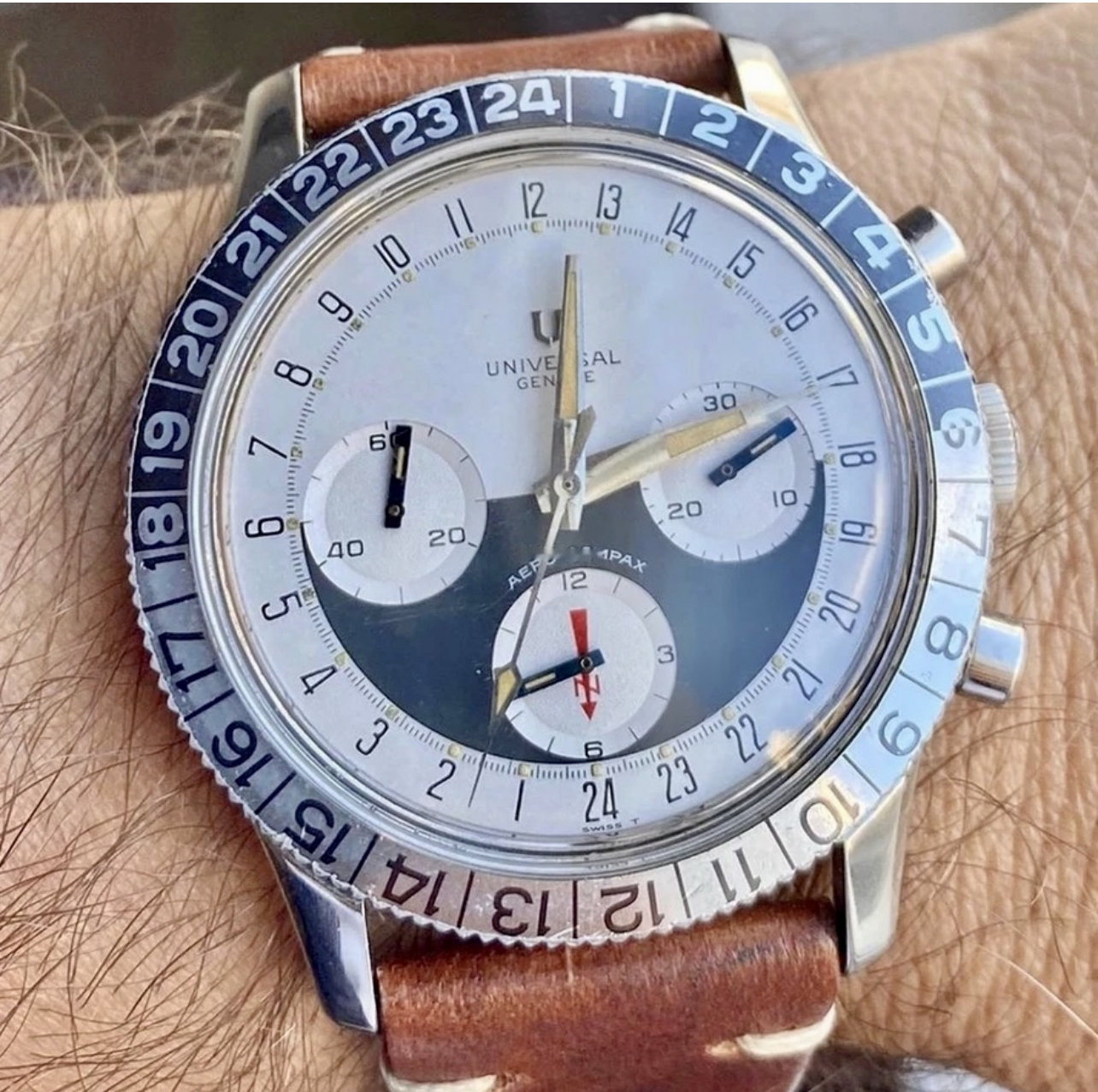

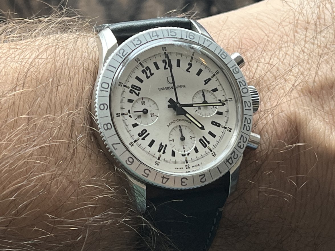

I first noticed an oddity in the minute totalizer on pilot’s chronograph when I purchased my Universal Geneve Aero-Compax 890101/01. I purchased the watch from the original owner, who was a professional helicopter and fixed wing pilot. He purchased the Aero-Compax in 1968, because at the time he needed the chronograph to time his helicopter’s unequal burn rates in doing many stop-and-go jobs.

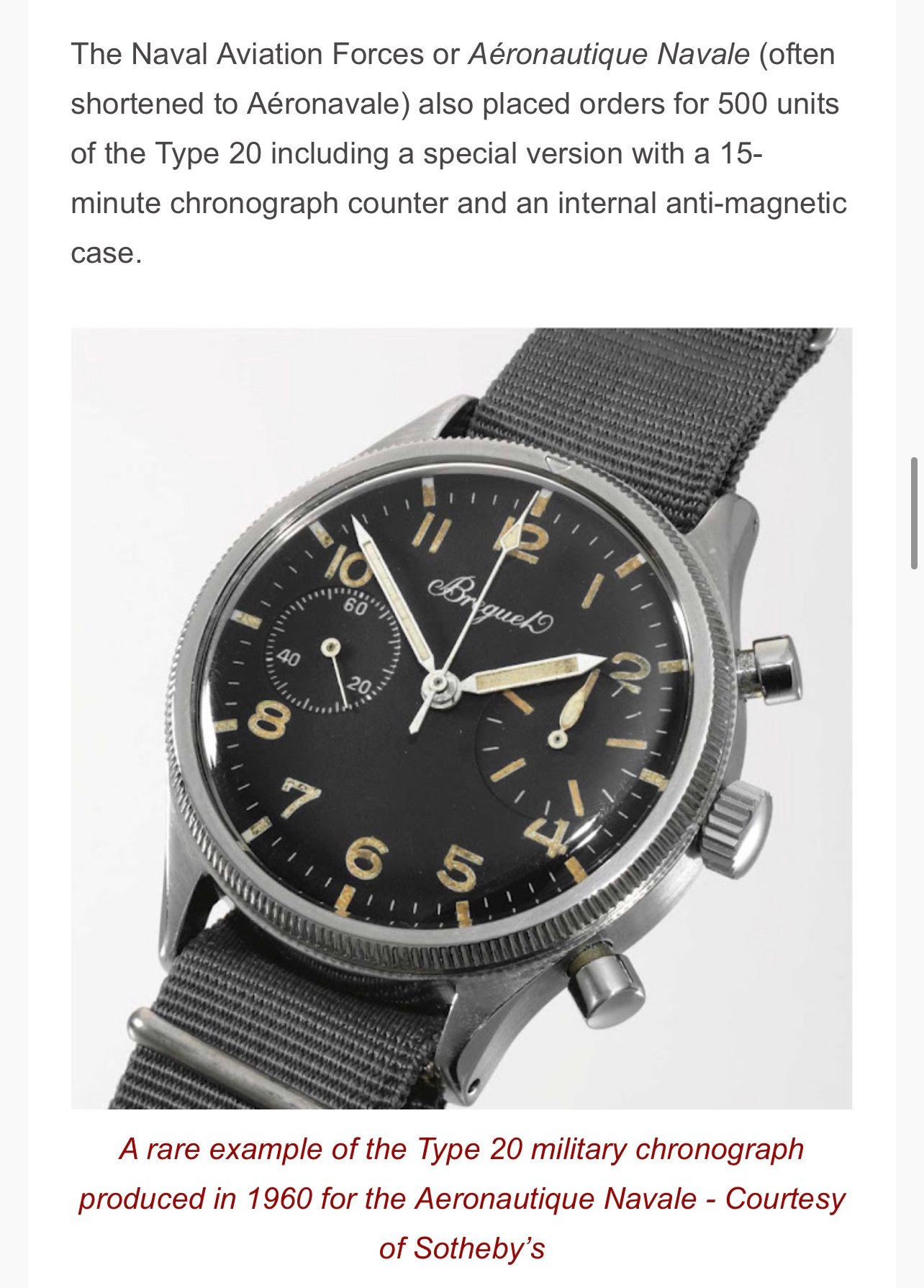

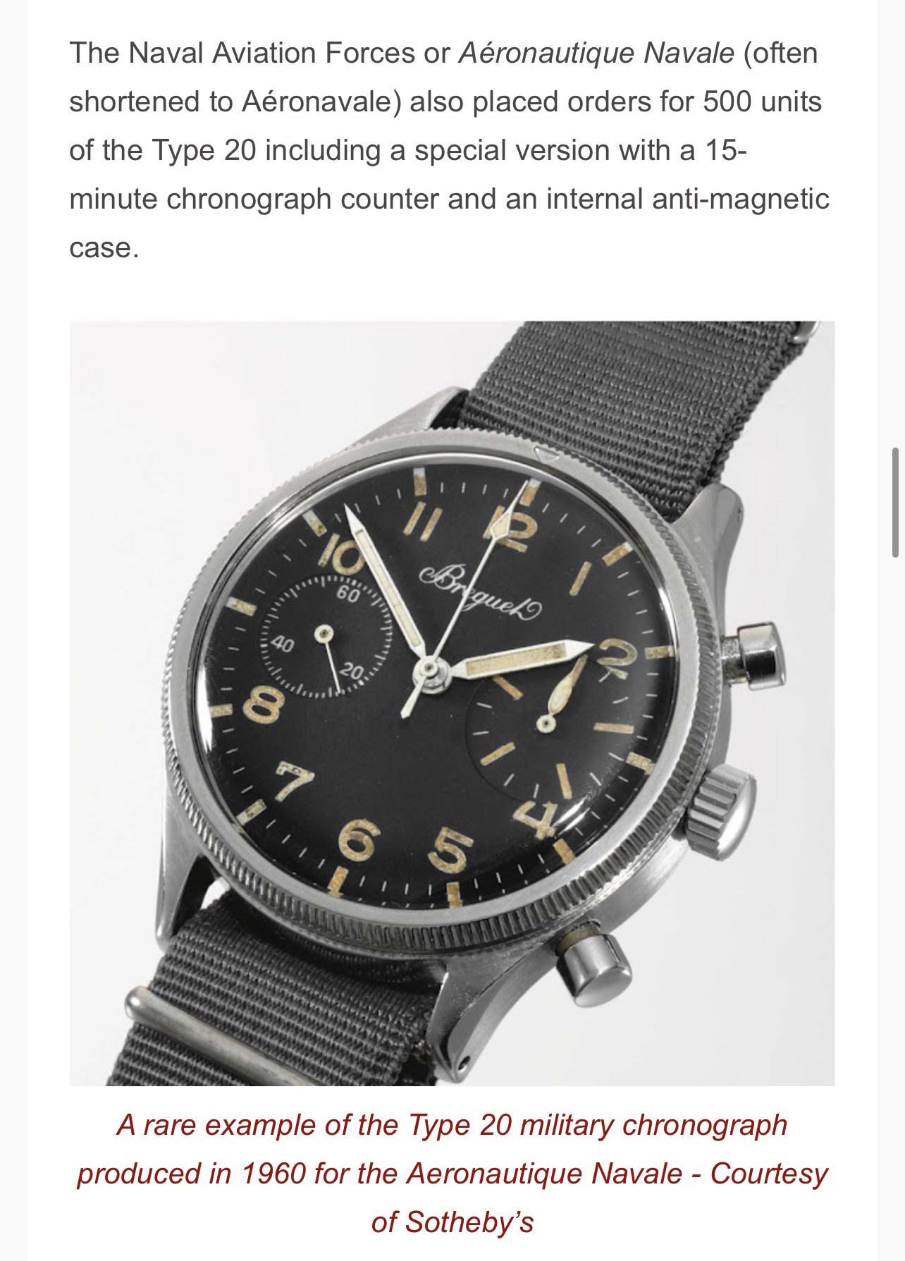

This Aero-Compax displayed an atypical 15-minute totalizer where usually there was a 30-minute totalizer. The underlying movement, the Venus 178, was used in many watches of the period and - like most chronographs - was set up for a 30-minute totalizer. UG (or Venus on behalf of UG) had purposefully altered the movement to offer a dial with a 15 minute instead of 30-minute totalizer.
This intentional alteration of the function of the Venus 178 was almost certainly intended to appeal to pilots. Similarly, the UG 890101/01 had altered the Venus 178 to be a 24-hour movement, with dual 24-hour time zone capabilities between the dial and bezel. This watch was intended as a pilot’s watch through-and-through.
And, they made a sister version without the 15 minute totalizer having instead the more standard 30 minute totalizer.
The original owner of my UG 890101/01 could not remember nor tell me why a pilot may have valued a 15-minute totalizer over a 30-minute totalizer in 1968. That is just the sort of mystery of horology that gets under my skin.

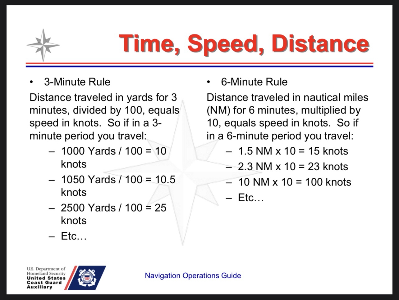

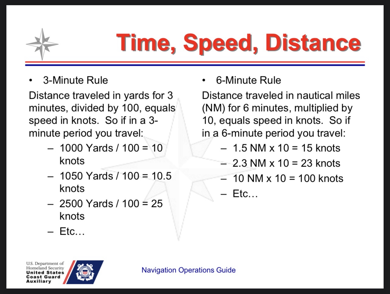

THE “RULE OF 3” (TO QUICKLY ESTIMATE GROUND SPEED IN YARDS): the “rule of 3” states that the distance a craft will travel in 3 minutes in yardsis equal to speed in knots [multiplied by] 100.
THE “RULE OF 6” (TO QUICKLY ESTIMATE GROUND SPEED IN NAUTICAL MILES): the “rule of 6” states that the distance a craft will travel in 6 minutes in nautical miles is equal to the speed in knots [divided by] 10.
So, a pilot that knows his air speed in knots, can reference either 3 minute or 6 minute intervals to quickly determine an estimated ground speed (and so distance traveled), and/or to time (using 3 or 6 minute intervals and their larger integers) longer ground distances needing traveled.
As put by a different navigation white paper (in the maritime context), “The six-minute rule is a great tool for the cockpit navigator and is useful for a navigator looking for a fast way to lay down a series of short-interval DR positions. The 6-minute rule is also a vital part of any radar collision avoidance plot. The rule states that the distance traveled in six minutes is equal to one-tenth the distance traveled in an hour. Sounds almost too simple to bother with until faced with trying to calculate the distance traveled in five minutes (how many of us can quickly calculate one-twelfth of eight nautical miles?) …. The 6-minute rule really comes into play in close-in harbor approach navigation, when precise position information and navigation decisions must be derived quickly. It is much easier to law down a DR track at 6-minute intervals (or a multiple of 6, since the rule can be used easily for 12-, 18- or even three-minute intervals) than to struggle to find the calculator or the circular slide rule. With the six-minute rule the navigator can do all such calculations in his or her head.”
The bold emphasis above is again mine, because…

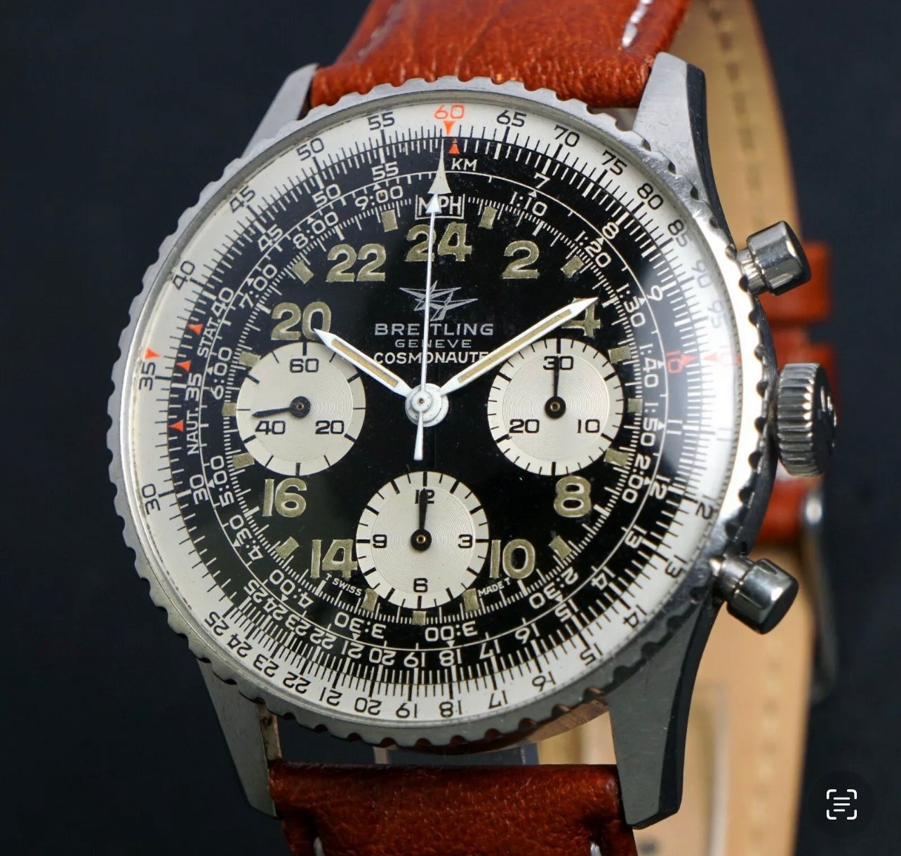

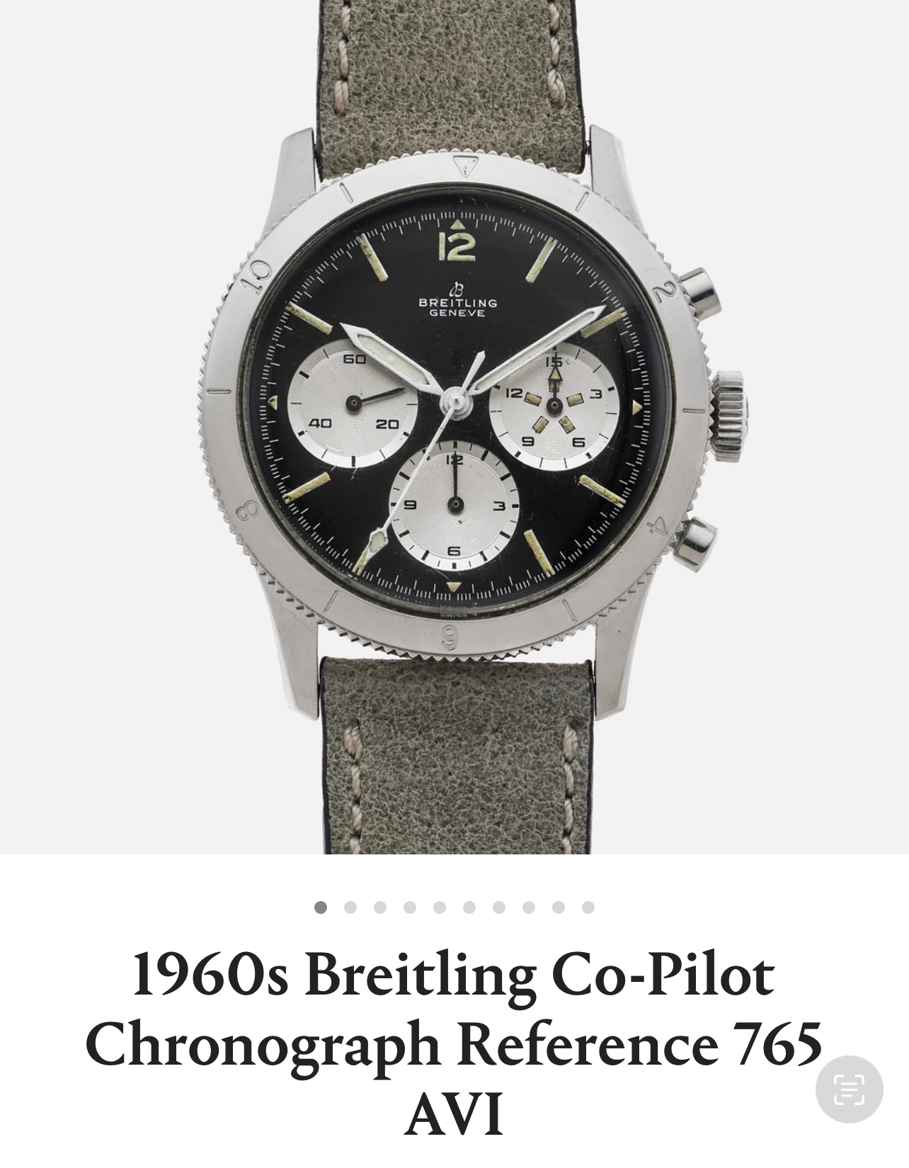

THE BREITLING PROBLEM
When considering the “mystery” of the 3-minute and 6-minute increments on pilot’s chronographs, it’s almost comical to consider the role of the various slide-rule or ‘computer’ watches that are widely recognized as being intended for pilot’s navigational purposes. A Breitling Navitimer/Cosmonaute is a classic example for which there is little debate the company intended the watch to be useful to pilots, and utilized for making various calculations.
In the same breath, many - I think including pilots - will comment on how overly wrought with information such “computer” bezels are. So, while a Navitimer is unarguably designed to assist pilots with navigation calculations, it is at the same time almost unhelpfully complete in that effort.

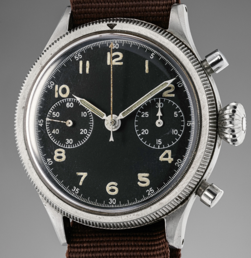

Ironically, the far more simplistic approach of a highly visible 15-minute totalizer with 3-minute indices, is almost so elegant in its design-to-utilization approach that over time it has become lost on us why anyone might ever offer this feature to a pilot’s chronograph.
In a way, finding an agreed explanation of the utility of 3-minute indices on a chronograph may have been hampered by “the Breitling problem” of thinking that an aeronautic navigation watch must look far more complicated than is even useful to many pilots. For many pilots, their cockpit compass plus a chronograph with 3- and 6-minute increments goes a long way toward helpful navigational tool.

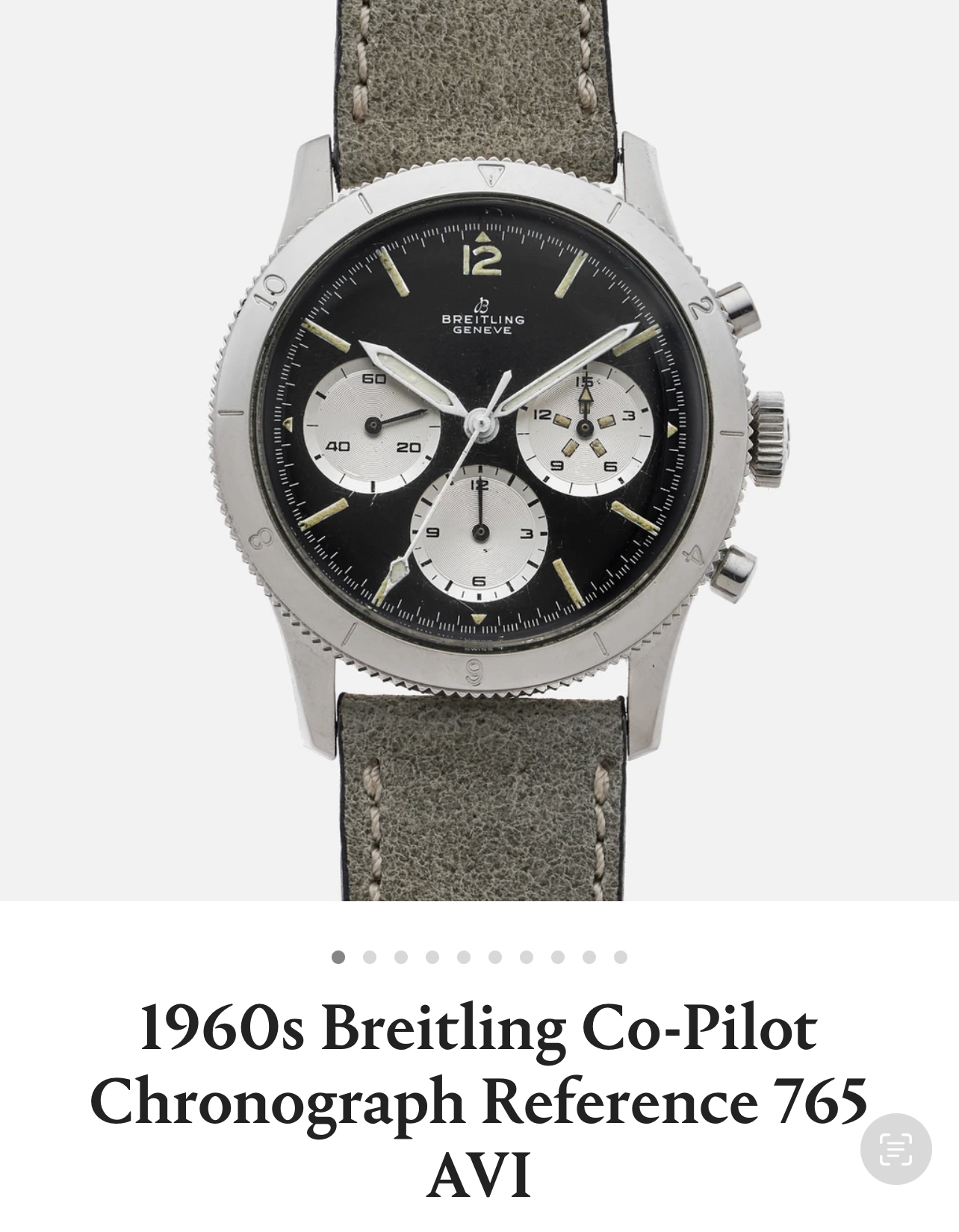

THE 9-MINUTE MARK PROBLEM (AND ITS VARIENTS)

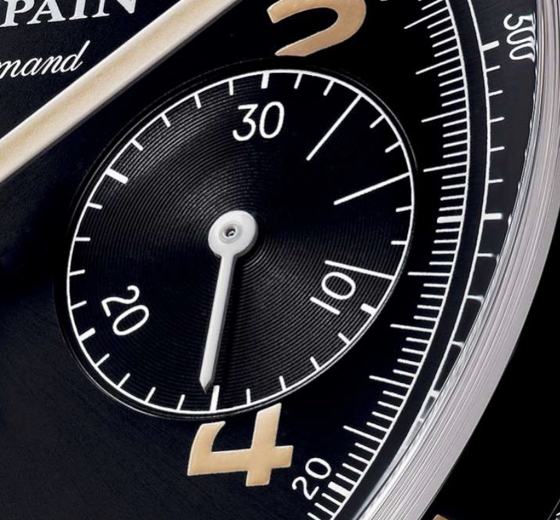

The skeptical might at this point be wondering about the 9-minute demarcations found on many chronographs, given that the explanations above focus so heavily on 3- and 6-minute “rules.” It’s a good question, and one that I think can be largely explained by two things in conjunction.
First, several of the most serious pilot’s watches do not have only 3-, 6-, and 9-minute demarcations, but instead their minute totalizer is entirely displayed in 3-minute increments. We might take these examples as really going the distance in providing legible demarcations in increments of time useful to navigation.
Second, regarding the many chronographs that have an otherwise normal minute totalizer except for elongated or highlighted 3-, 6-, and 9-minute indices: these are arguably the bare minimum indications needed for the totalizer to become helpful. With a 9-minute demarcation, a pilot traveling at 160 knots for 3 minutes will have traveled approximately 8 nautical miles, for 6 minutes 16 nautical miles, for 9 minutes 24 nautical miles, for 15 minutes 40 nautical miles, etc. Put differently, if a pilot can string together 3 contiguous 3-minute runs (totaling 9 minutes), or instead a single 15-minute run, he or she may have covered the waterfront of the bare minimum tool needed for the sort of calculations the chronograph can help with. Remember, the rest of the chronograph with this design approach (the 3 highlighted indices at 3-, 6-, and 9- minutes) will still otherwise denote 10-, 12-, 15-, 30- minute or hour-long intervals, as may be needed.
[EDIT: It now would seem more plausible that "simple" watches that merely highlight the 3/6/9 second marks on the minute totalizer were in fact intended to assist in long distance calling in the UK and possibly other parts of Europe that charged in successive 3-minute blocks; why they chose to only mark up to 9 minutes, when calls could certainly last longer, may have been purely an aesthetic or practical decision.]

THE PROBLEM WITH MY UG AERO-COMPAX
Having for weeks fretted over all the above rabbit holes of 3-minute demarcations, dead-reckoning navigation, etc., I then return to my UG Aero-Compax which has a 15-minute totalizer but without particularly highlighted 3-minute increments. What’s the deal, UG!?
I assume that this dial design decision was borne of the Venus 178’s rather small sub-dial design. If the minute totalizer were to instead demonstrate 30 minute total, then differentiating single-minute increments at a glance would be particularly difficult. Whereas when the minute totalizer is reduced to a 15-minute totalizer, each minute is now - in effect - twice as easy to read.
Admittedly still, for as much of a pilot’s-pilot watch as is the UG 890101/01, it now irks me a bit to look at that sub-dial and see the 5-minute marks emphasized.

This is exactly the point of “the 3 minute rule”: your air speed in knots X 100 = the distance (in yards) you’ll travel in 3 minutes.
If a pilot instead prefers to know nautical miles, the 6-minute rule (or a derivative in 1/2 over 3 minutes) may be used in the alternate.
I didn’t quite say he did, did I? After all, he’ll ideally have a working air speed gauge in knots (that as a separate matter may need conversion to ground speed and/or ground distance traveled).

Perhaps either it’s worth a re-read, or instead you’re incredibly adept at performing quick calculations in your mind with more complicated proportions. I quoted a navigation primer that specifically addressed why, when navigating, simple proportions are easier to use than more complicated proportions: see the quote above RE “how many of us can quickly deduce 1/12th of 8 nautical miles”
It’s my understanding that, in a pinch and certain other scenarios, this is exactly wrong.
For example, DR navigation can be used to quickly plot courses of intersection (or avoidance); I didn’t get into it, but this sort of navigation was/could be used in war to achieve various flying objectives, for just one example. With some information about the heading of another craft, one could use DR to quickly determine how to intersect or avoid that craft. Throttling one’s own speed to achieve this would absolutely be amongst the methods.
Similarly, if one flew over a known rail road crossing at a certain bearing (ignoring wind) and knew that a turn should occur in, say, 20 nautical miles, the pilot might absolutely choose to achieve that by traveling at a given speed for a given time: it seems rather plain to me.

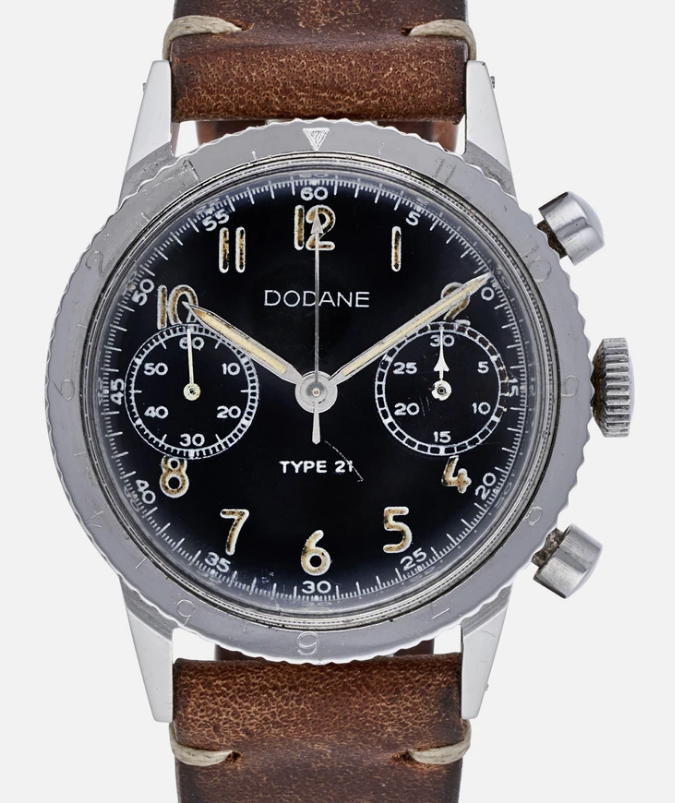

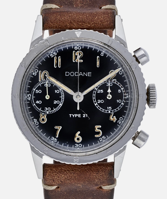

It should be noted that a number of chronographs that were intended to be used by pilots do not have these 3, 6, 9 minute markings. These chronographs span a number of decades (1930s-1960s), were made by a number of brands (e.g. Tutima, Hanhart, Longines, Breguet, Dodane), and were used by a number of Air Forces (e.g. German, Romanian, French). If such markings were useful to pilots, I wonder why they would be omitted? The omission is especially puzzling given how ubiquitous such markings are on chronographs at large. See examples below.
https://monochrome-watches.com/tutima-grand-flieger-classic-chronograph-review-price/
https://www.vintage-portfolio.com/shop/hidden-gems/vintage-1944-military-style-hanhart-chronograph/?marke[]=0
https://omegaforums.net/threads/longines-13zn-auctions-originality-authority.40453/#post-473641
https://www.phillips.com/detail/BREGUET/CH080118/120
https://shop.hodinkee.com/products/1960s-dodane-type-21-with-military-engravings?variant=22124825604

I've done a little bit of private piloting, so I will say that in my experience this is on the right track but I think you're flying inverted.
I think it's more likely that a pilot who is relying on dead reckoning will know how fast he's going but not how far. Dead reckoning is determining your position based on calculations when you can't necessarily see the ground. Your navigator (or you) has a map and can get from point A to point B by traveling a set speed over a set time. In my experience, even under the best VFR conditions, I can't gauge how far I've gone just by looking at the ground. Thus, if you invert the calculations, you can come up with another rule of thumb which, in my opinion, makes more sense for 3 minute increments.
Relying on your math, if I maintain a groundspeed to 88 knots (reasonable for most light aircraft to maintain, and rather easy to remember in my opinion), I will travel 8800 yards every 3 minutes, exactly 5 miles. I might have to estimate my groundspeed based on reported head/tailwinds in the area +/- airspeed, but that's an increment that can easily be measured on a map and/or radio back to someone on the ground. "Tower, I reckon I am 5 miles past the coastline."
