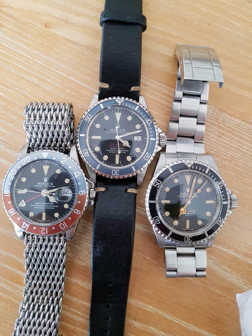

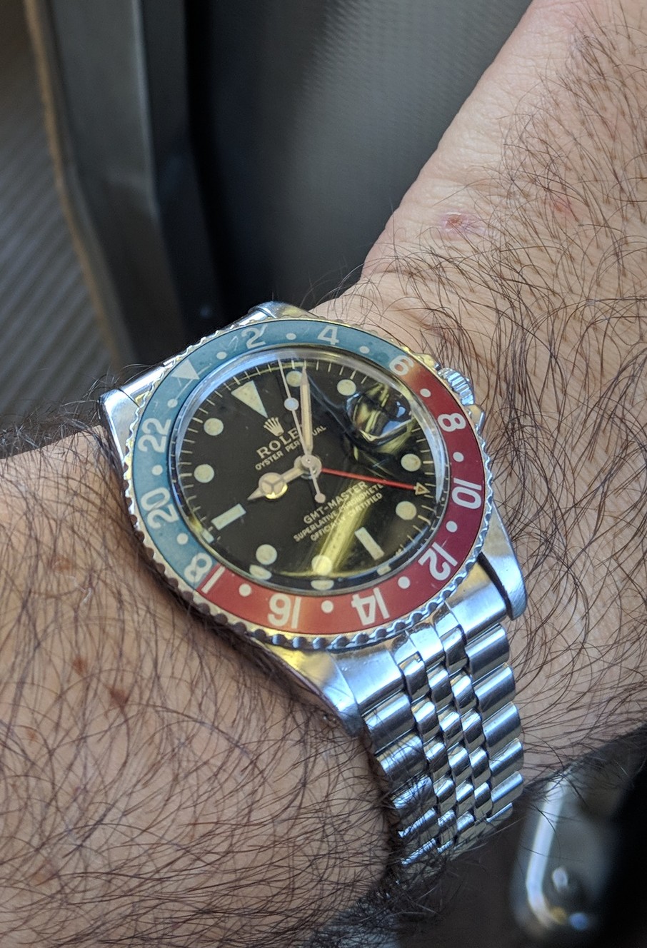

Here is the one that was my dad's
Doesn’t get better than this, wear it inngood health!

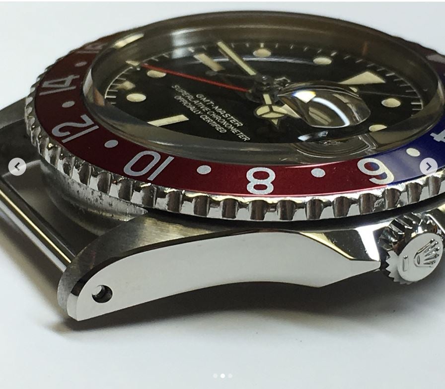

https://www.instagram.com/p/BmwiI9nHQVs/?hl=en&taken-by=losangeleswatchworks

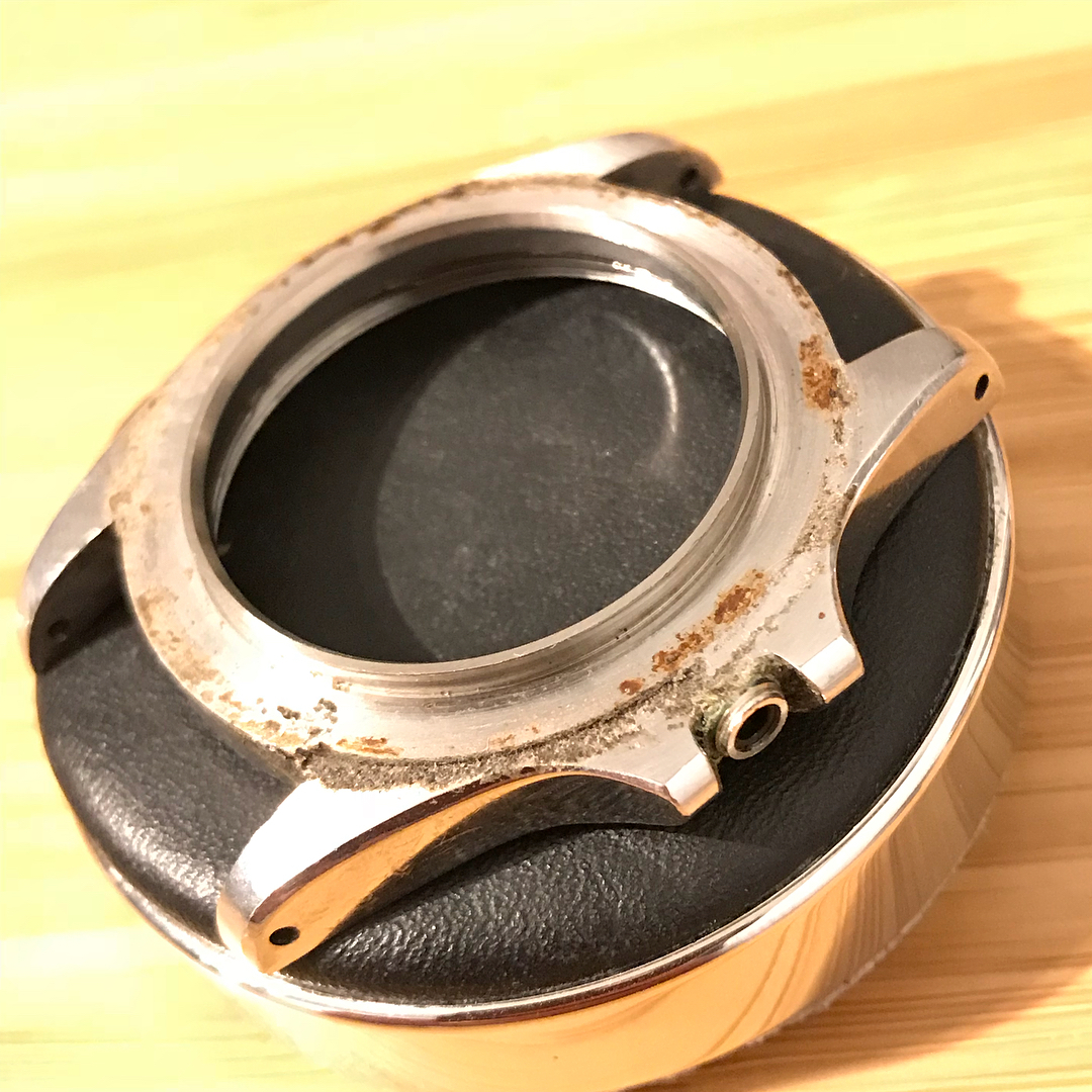

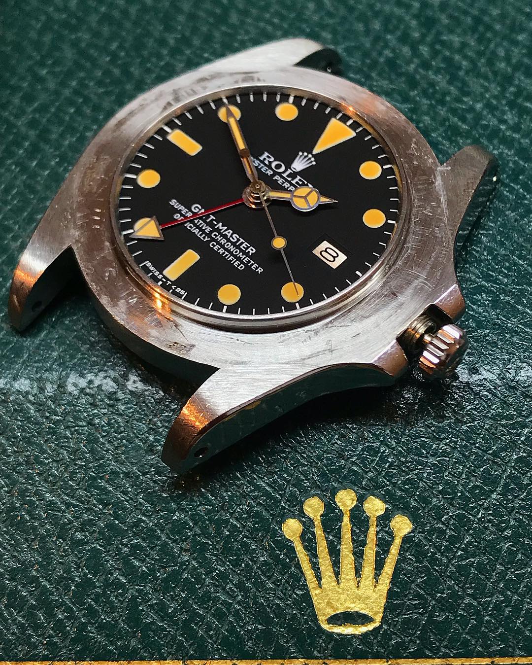

Take a look at the work of LA Watchworks, look at the comments. Most people (on instagram) love the look of the cases that they have restored. They have a lot of fans, not everyone is so negative!
Of course a true watch nerd would spot that the lugs became thinner in the process. That's the choice, soft rounded lugs or sharp but slightly thinner ones.
Why aren't more people complaining about the fact that Rolex wrecked the cases of most of their watches with polishing wheels during service? And it went on for decades.

RE: GMT 1675. They are thinner for sure, look how thin that bottom right lug:
Not the exact same model (different crown guards) but you get the idea, this is the unpolished one:
https://www.watchprosite.com/rolex/a-case-primer-for-the-rolex-1675--unpolished-/732.791448.5303788/
This is an interesting article.
Honestly I think the angle of the photos are deceiving so it doesn't immediately look thinner to me. Also I'm not surprised RSC actually makes lugs thinner. My comment was more directed at third party case refinishers.

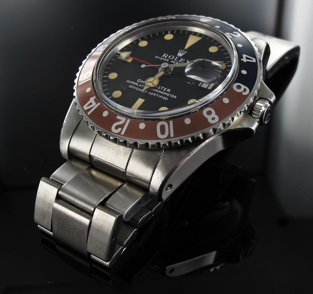

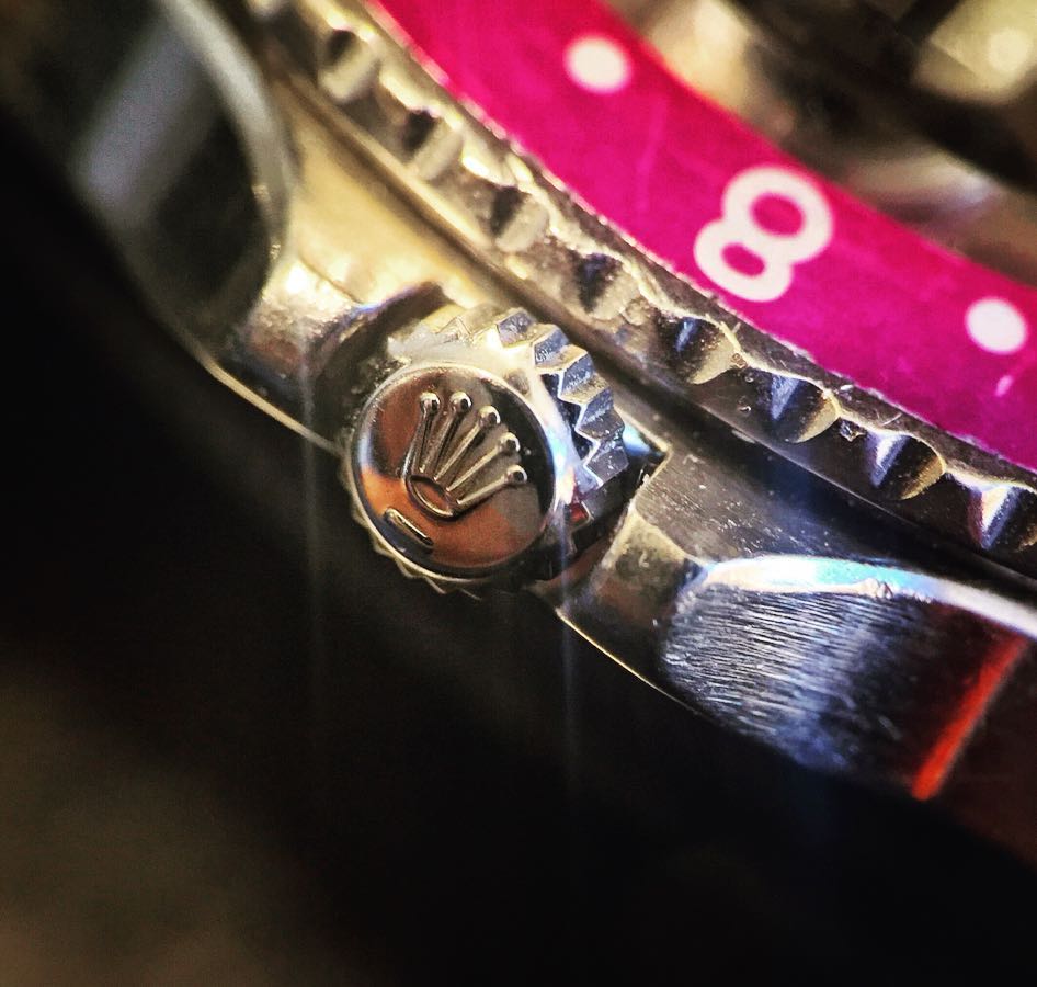

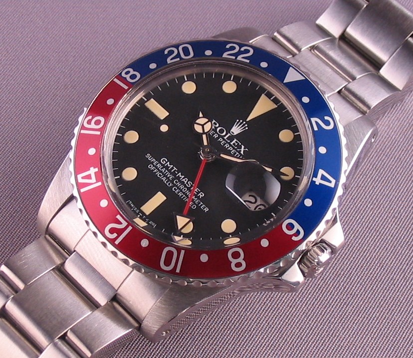

2) Another thing that I don't think has been mentioned explicitly is the variety of case/crown guard shapes seen on what are considered 'rounded' or standard matte dial crown guards. Please see below - the Mark 1 crown guards start beveling very far out from the case (usually lines up with the outer edge of the threads on the crown) and the sides of the crown guards are more vertical whereas the later examples have more and more rounded sided and a bevel that starts much closer to the case. I'm trying to see if there are particular serial ranges that correspond but I don't have enough info to include on my site (gmtmaster1675.com) yet. The second and third pictures are credited from @Autaviano , the first is mine.
Mark 1
Mark 2
Mark 5
- Andrew

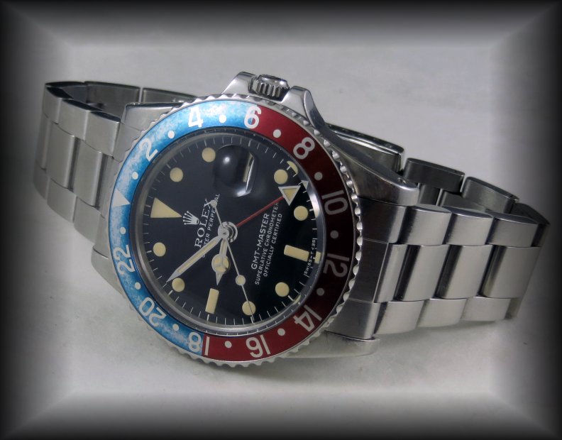

Mark 5
Mark 1, 2, 3, 4, 5 refer to the dial and not the case. The crown guards are all a little different even when looking at unpolished examples. It's surprising how different the bevel on the crown guard can be on watches with the same dial and from the same year.
Here is a mark 5 in good shape sold by Springer. The crown guards are different to the one in your picture.
Compare the crown guards on these two 16750 models, they have the same mark 2 dial.
These two watches show the two extremes. I've seen everything in-between concerning the crown guards: no bevel, light bevel, a more rounded look and a sharp steep bevel like the one in the picture directly above. The facet line can also be closer to the crown (16750 again):
I asked Springer about this and he told me "The lines on the GMTs are all over the place, not unlike the thickness of crown guards on the vintage Submariners. Nothing is 100% the same on these older watches"
I know that the dials and not cases correspond to different matte Marks. My point is that there is consistency with which the cases evolve over time and it is not random. Yes, there is overlap and no, each is not identical, but there are obvious trends too. You don’t see any late gilts or unpolished 1960's Mark 1 mattes with the rounded crown guards whereas, conversely, late 70's Mark 5-6 looks almost close to the 16750.
