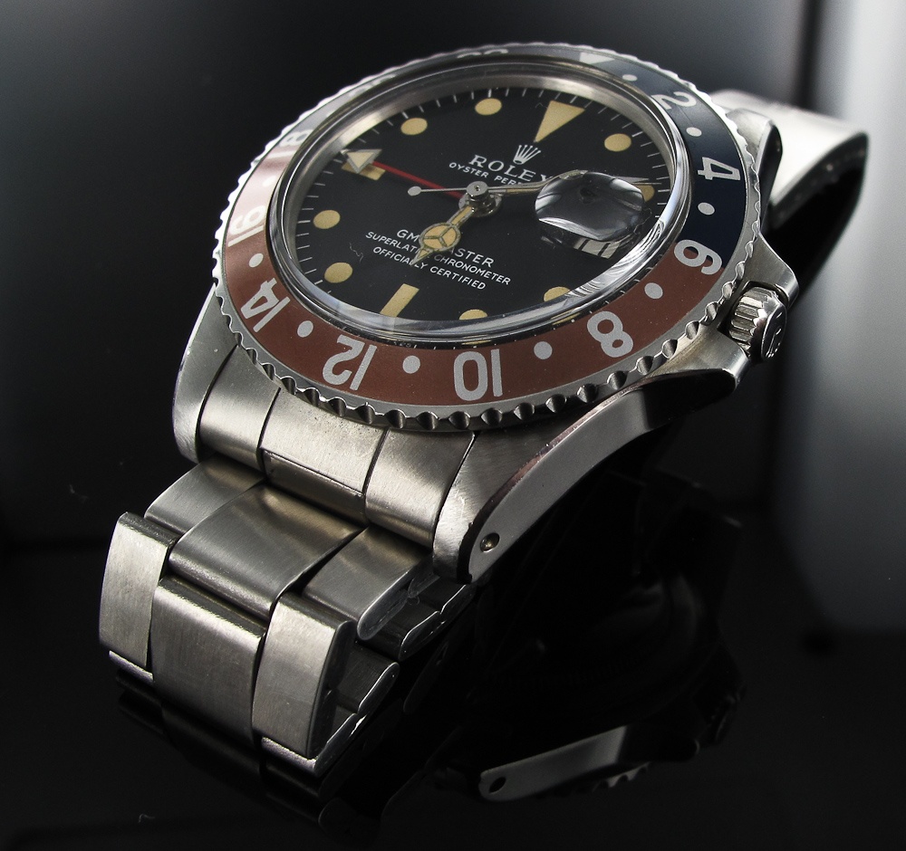

Here's a new listing on Chrono24 Very clean chamfers on this one.

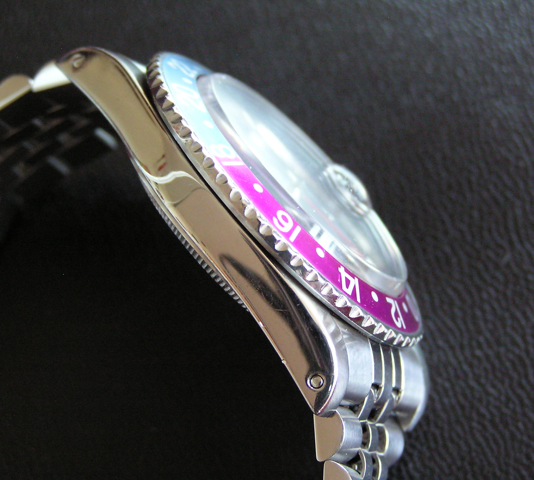

A few tips (in general, not talking about the Chrono24 watch specifically) Look at how close the lug holes are to the chamfer, too close and you can tell that the case has been recut. Look at the clasp, it seems a bit odd to me when I see a pristine case but a clearly polished crown on the clasp. The crown guard is the hardest part for a refinisher to get right, some recut the chamfers but don't touch the crown guard so it's obvious.
All of these watches were originally hand finished so they all look slightly different. The thickness of the chamfers also changed over the years, compare the chamfers of a 1675 with those of a 16750. The crown guards were also different.
Unpolished 1675:

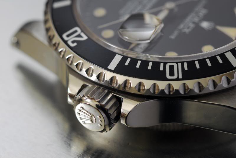

16750, thinner chamfer. And look at the line on the crown guard:
Unpolished 1675:
I see crown guards like that last photo in about 1% of 1675's I look at. Maybe.
4,043
13,956
Always look for a sharp line on top of the crown guards, and the chamfer goes all the way around the top of the guards.

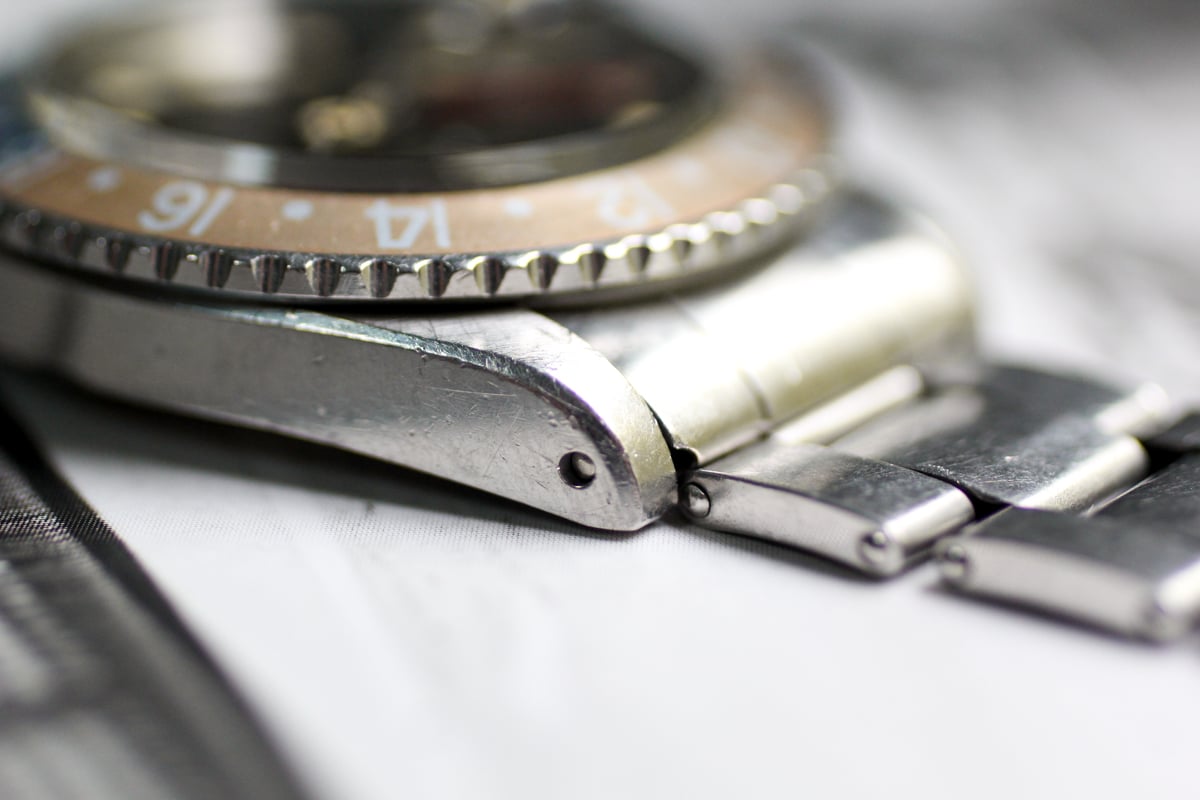

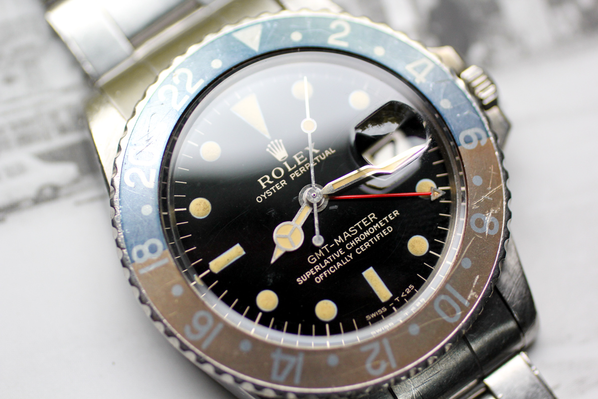

It's actually funny to see this thread, as it's near and dear to my heart as well. I am very well versed in some brands, but I'm also smart enough to know what I don't know, and vintage Rolex has always scared me away from diving too deep. I wanted a GMT for a long time before I got it, and ended up taking this one in a trade from a collector (@CajunTiger, if he's still hanging around here) who I knew well from years of interactions. When I sat down to write about it on my site, I got to the "Fine Print" section where I typically talk about the condition of the watch and found that when my word vomit was done, I'd gone on a rant about re-cut cases and re-done dials. Not shilling the post, but you can read that part here: http://www.bazamu.com/rolex-gmt-master-ref-1675-gilt/
Cliff Notes version for this post though - THIS is how bevels should look if it's a piece that's been used / has an aged and worn bezel like the one here. If the lines were nearly perfect with only the smallest of superficial scuffs, my antenna would be way up since the bezel tells a different story (see second picture).
Also, re: gilt dials - my good friend @t_swiss_t spent a lot of time researching hallmarks of a re-done lacquer job and it can be scary. This one is in great shape overall but has a couple small marks under / around the hand stack, which again, I'd expect to see. As a newbie, this is the condition that I'd be searching for. Overall, a dealer could still artificially age a watch to look somewhat similar to this, but once you've had enough reps / seen enough vintage watches, you should start to get a good feel for an honest, (likely) unpolished watch versus one with a lot of cosmetic work and a bogus backstory.

Seems like an odd form of internet spread psychosis to me 😜 That GMT right above just seems like a worn out old watch. I could understand if it got that way on YOUR wrist, but why buy it in that condition (and pay such a premium for the pleasure)?
Your post reads like an attempt to troll. If you think that GMT looks like a worn out old watch, then vintage isn't for you. Leave them to us.

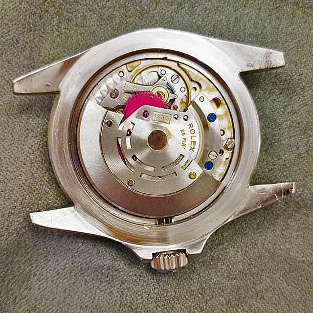

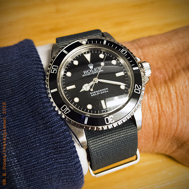

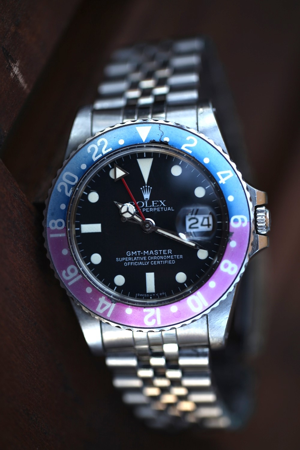

With so much fakery going on there's something to be said for plain old OEM service replacement parts. If you know that's what you're getting, you pay for what you're getting. I'd always wanted a Submariner with three specific characteristics: no date, two lines of text, and an acrylic crystal. I would have never guessed I'd end up with a 5513/cal.1530 made in 1964, given where prices are for this particular reference and vintage. But I found one that the seller said had a polished case (not overly so, in my opinion) and replacement bezel insert, pip, hands, and dial. I paid a fair price for what I got, which is an attractive watch that's a lot of fun to wear.
It just came home from the spa a few days ago. This is an after-spa shot.

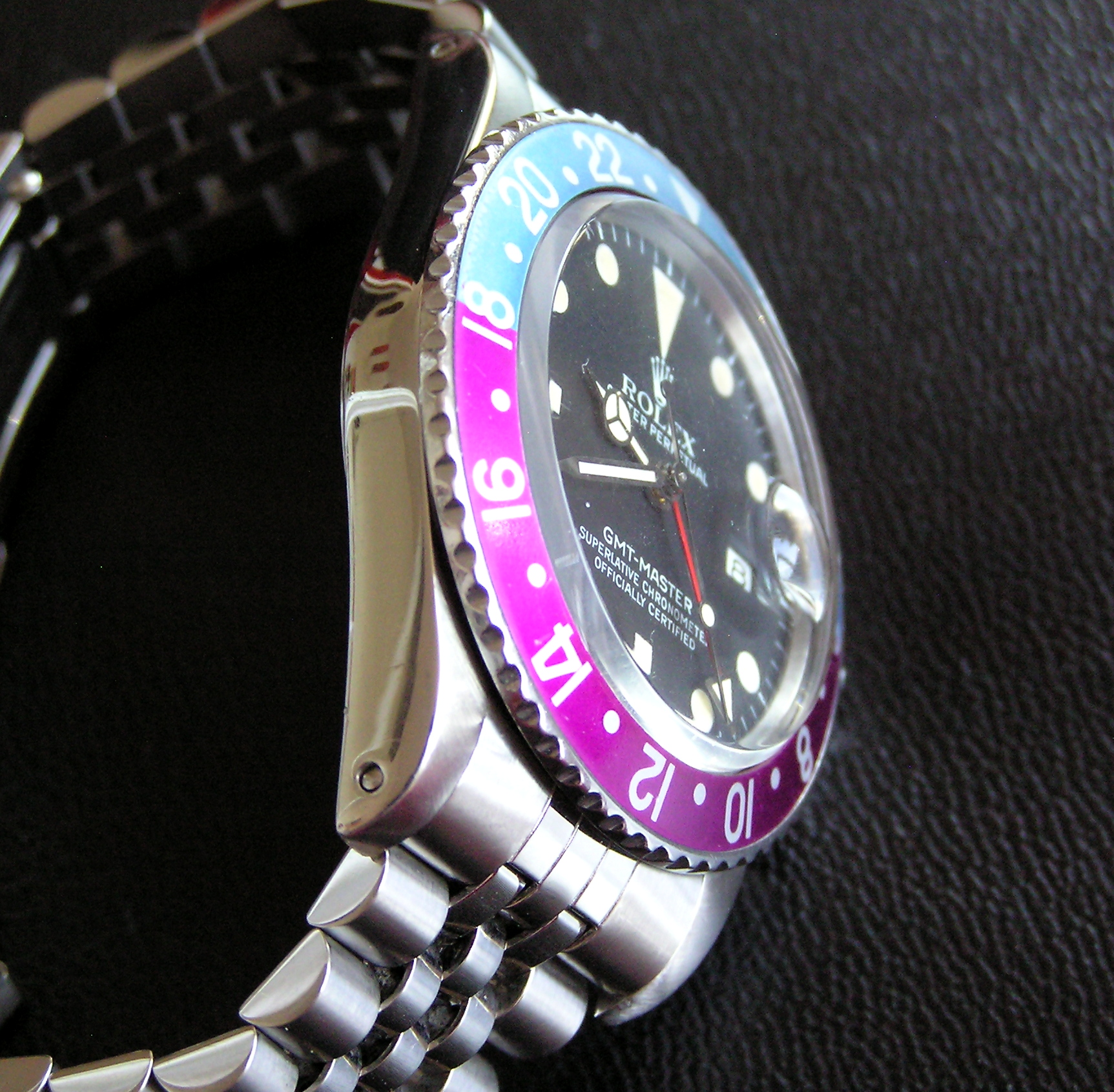

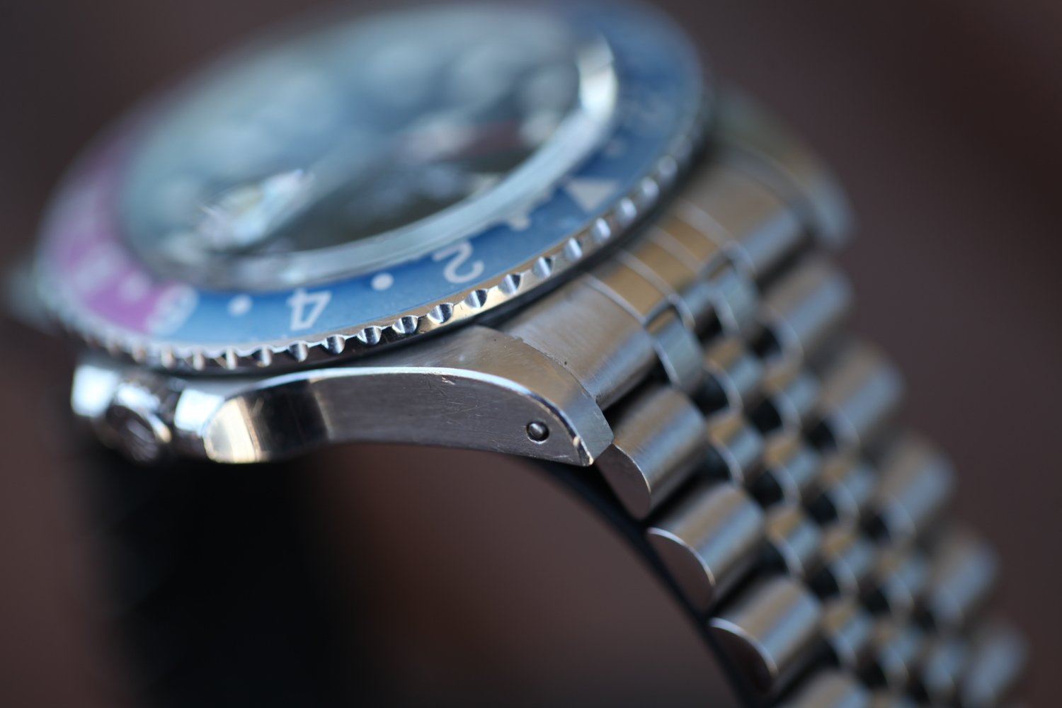

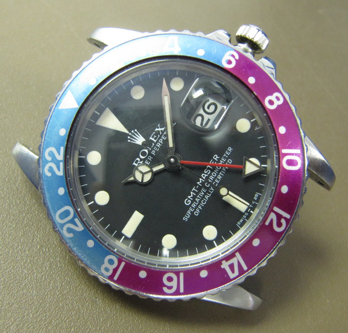

A very interesting thread and very topical for me.
I am currently searching for an unpolished 16750 and am using this pic as a ref for the condition I would like............
As I already have a 16750 (it has been polished and I want unpolished) I have explored a replacement middle case as an option. Rolex will only supply one as part of a service so total cost comes out at around £3000. In addition the Rolex replacement cases are not quite the same as the originals having a very small bevel and replacement case are also frowned upon by many as the original serial number is lost.

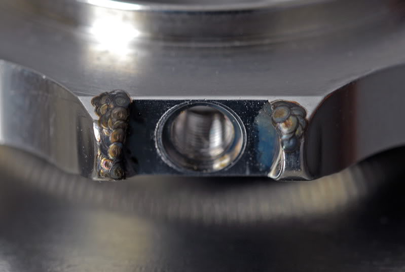

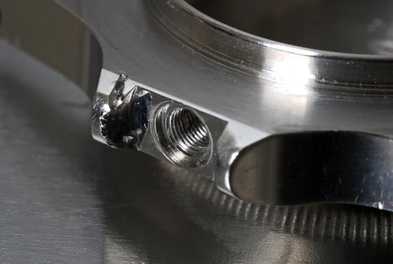

@JACK G Try to upload a photo of your watch. A service case would be a bad move, you pay a fortune and lose 50% of the value of your watch. For me there are two options, sell your watch and look for a better one or get your case fixed.
Rocco Manfredi @ http://www.watchworks.co.uk/ in Bristol does some amazing case work.
He turned this:
By doing this:
Into this:

That's great work by Rocco but a localised repair is very different to a complete case job and I have had a long discussion with Rocco who declined the job. One of the reasons being that although he could recut the bevels the lugs would end up thinner than they are now.
