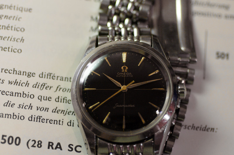

Mine came to me like this, generic plexi and the crown 😲 :
Might as well do the full monty in this case. Even if I don't intend to get it wet.
Look forward to seeing the finished article

Not to be a spoil sport, but shouldn't this one have a scalloped crown? No matter what it should have, it is a beautiful watch 😀
I don't know. I have seen other 2975s with the four leaf crown, and back then when I asked, nobody said it was wrong, so I went on with this model. I welcome any further input though...
No input from here, I was only curious 😀
