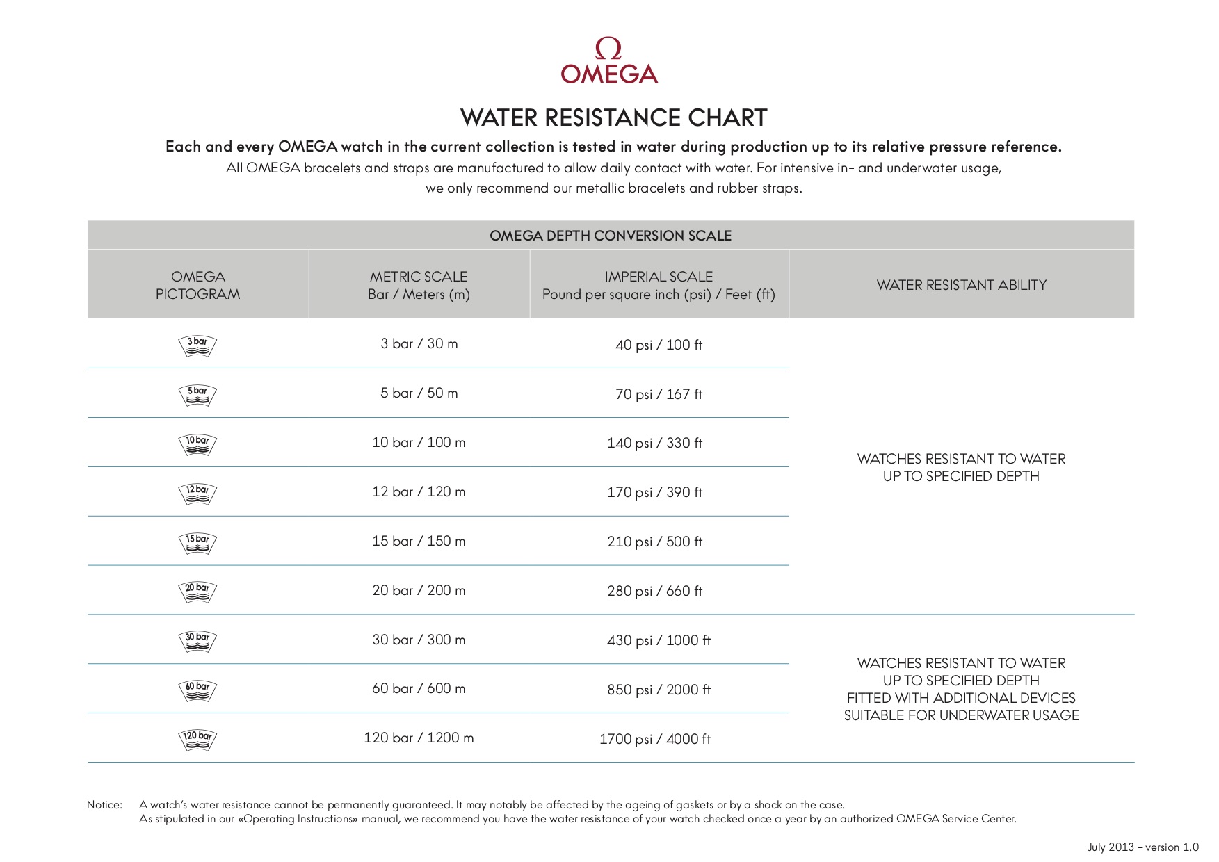

Maybe this will help you - no silly challenges required...
omega_water_resistance_chart-jpg.841374
214
426
That would be applicable for modern models, not for a ‘60s Connie.
