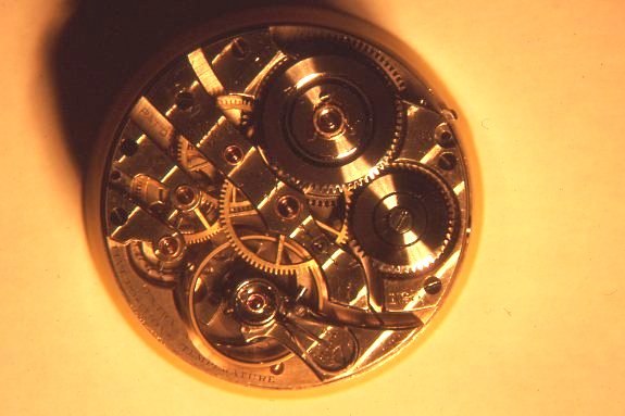

Almost 40 years ago, a fellow I worked with told me he had a pocket watch that he inherited form his late grandfather. the story was that the old man had retrieved his pocket watch from the wreckage of his burned out home, after the fire was put out. My friend inherited it after his grandfather passed away. He told me it was a mess, but I asked him to show it to me. It was a 16-size, series 5 Keystone Howard railroad pocket watch. I'd never seen one, and i had never seen any watch that was such a mess. He really wanted it restored. The pictures show you a badly rusted watch movement and stained vitreous enamel dial. Too much wrong to contemplate repairing the watch, so we put out the word that we were looking for a donor watch. About a year later, one with a bad dial, a few missing parts, and no case, surfaced. We bought it. The end result shows in the picture of the serviced donor movement, the cleaned up dial, and the cased watch. The serial number on the donor movement was 22 digits away from the ruined one.

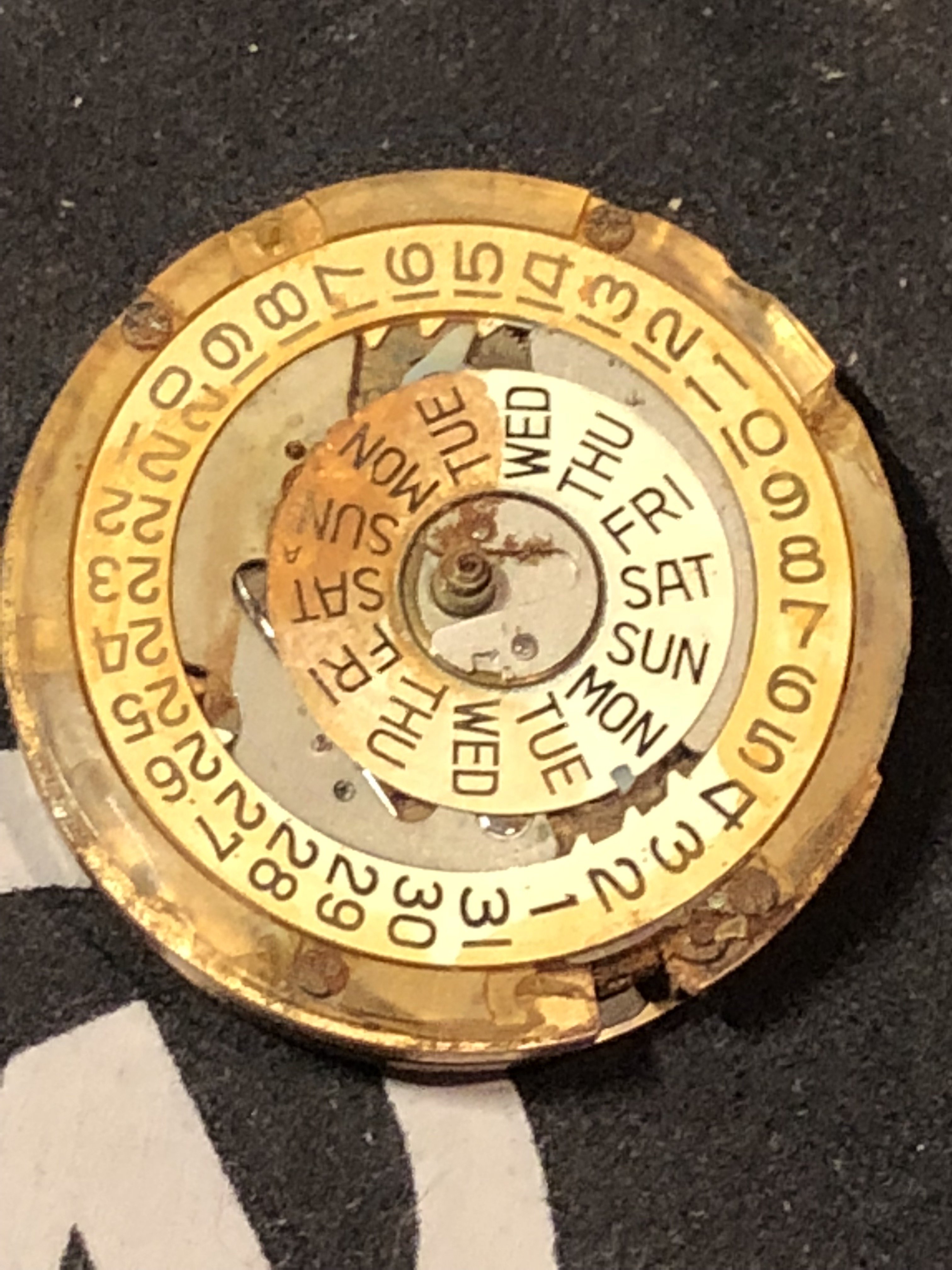

it was the traditional "winds and sets. Works but needs service before use. As a vintage watch, water resistance not guaranteed."
I will try and dredge up the original sales post. Dial and hands are actually okay, I have been trying to track down a 1040 as a transplant.
