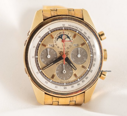

no, it is not. That is a redial, and not a good one.
Printing is uneven, and printed over non-removable dial furniture, subdials not properly centered. If you can't spot this as a redial, you need to do a little more training for your eye before spending your hard-earned.

The 2s and 5s on the 45 min counter don’t even match and I know nothing

i find the dial messy, other will jump in, i would pass, too expensive (wrong hands, markers, redial).

aside from font inconsistencies, the fonts in general are not quite right. Plus the railroad tracks are not right. Plus the sub dial hands seem too long. Plus the minute hand seems too long (same length as chrono?). Plus the watch is from Italy. Lots of monkey business IMO. Still, attractive watch at the right price.

I’m the new lucky owner of this watch (direct offer).
I have doubts about the dial also, anyway it could be correct.
I will do some research and post macro shots 😉
