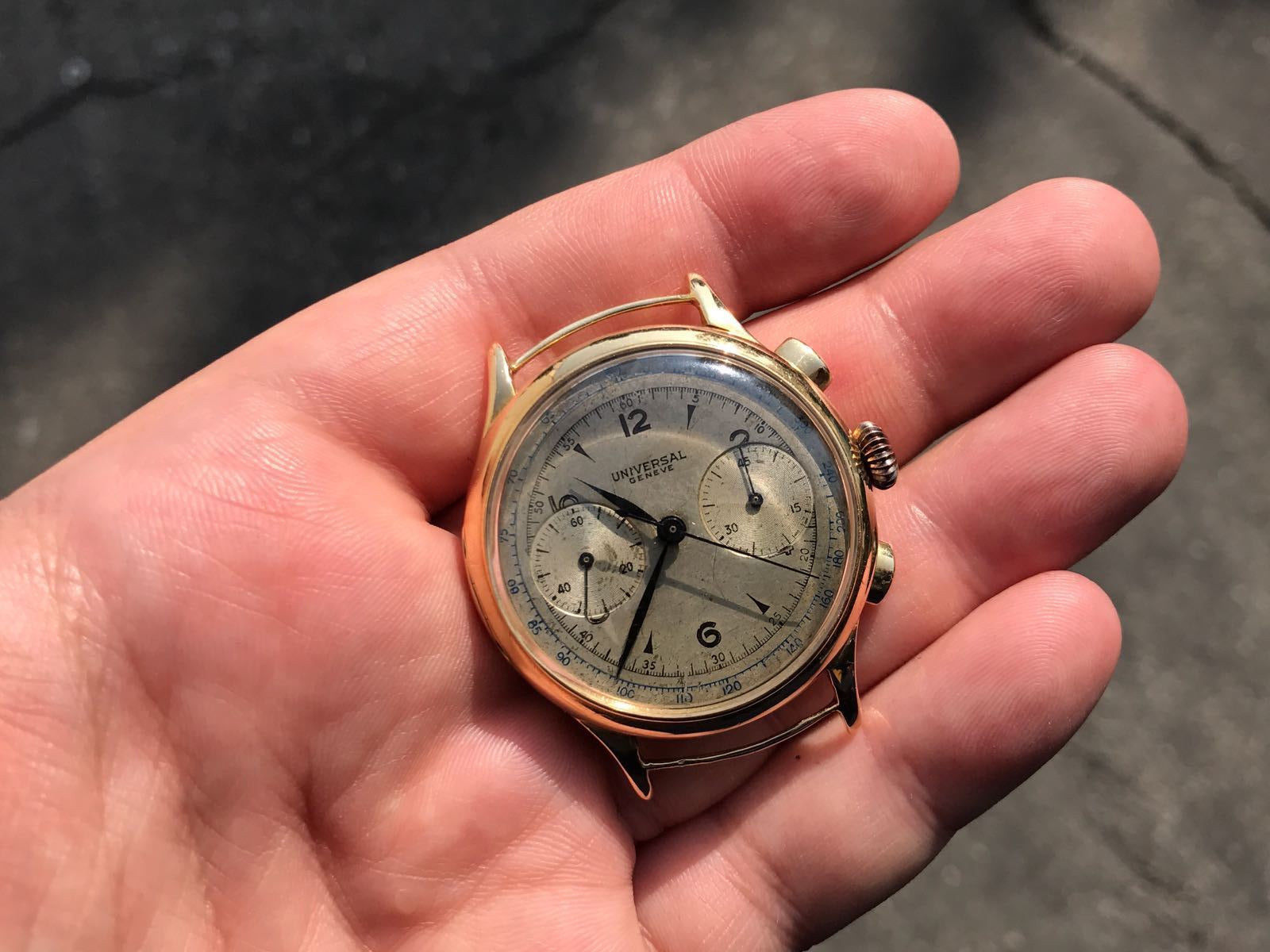

Nice and plausibly correct... I defer to those with deep knowledge of the early period.
Thank you! Guys with knowledge about early Universals?

Yes ... from I was able to reference it looks it might be ok but there are members with personal databases that might shed more light.

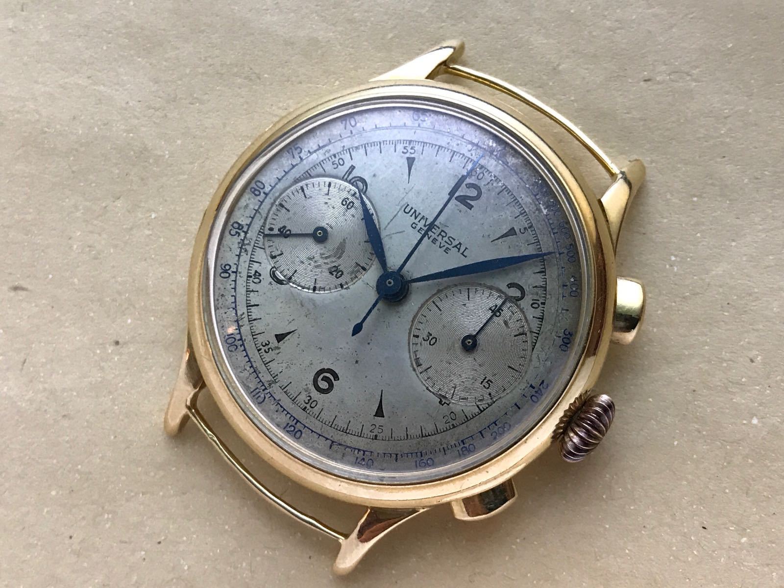

I don't think that dial is correct or original.
Fonts?

The hour fonts also. I couldn’t find those anywhere.

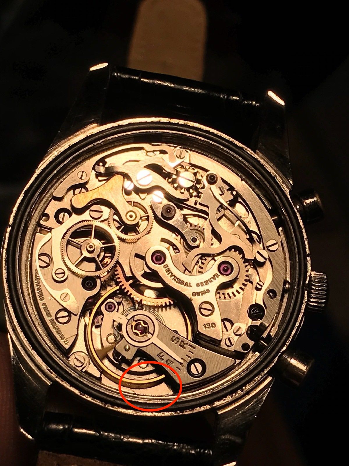

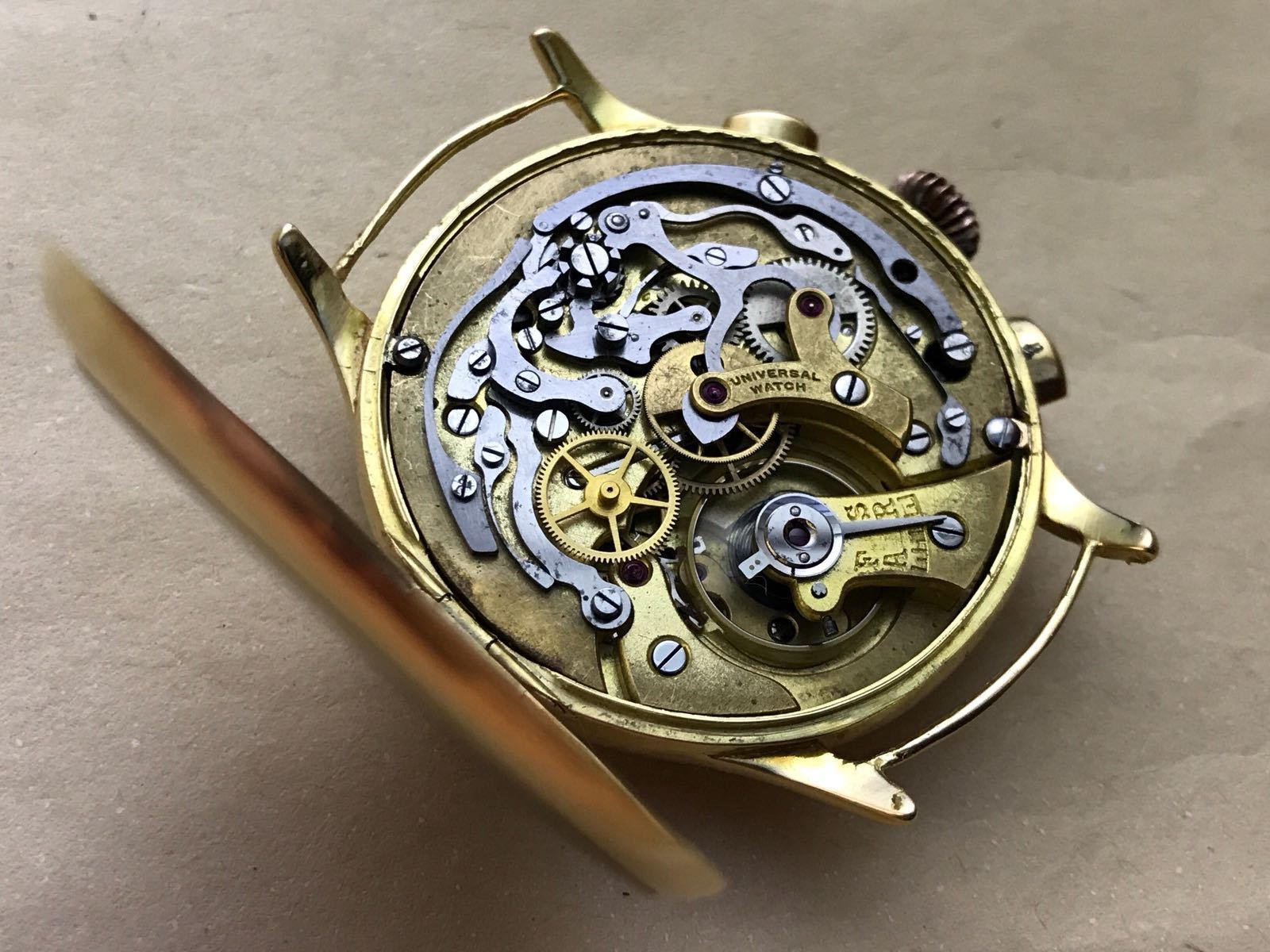

One more UG question, this is a cal. 130 movement. strangely missing the Valjoux stamp, otherwise it looks good. Is it correct?

I think I read that it was early days for double pusher ... not sure it matters .... but again I defer. Personally if you own this already and got it for a good number I’d just enjoy it.
If someone were to make a perfect replica of a Valjoux 72, down to the details of finishing, puts it in the correct watch with a correct second-party bridge, would it be a fake?

I think the real question is why go to the effort? 😕

Thanks! So just an unmarked Valjoux mainplate? UG 130 is the Val. 72.6?
'zackly. We get so caught up on the minutae in this hobby, every now and again we lose sight of the forest among the trees
