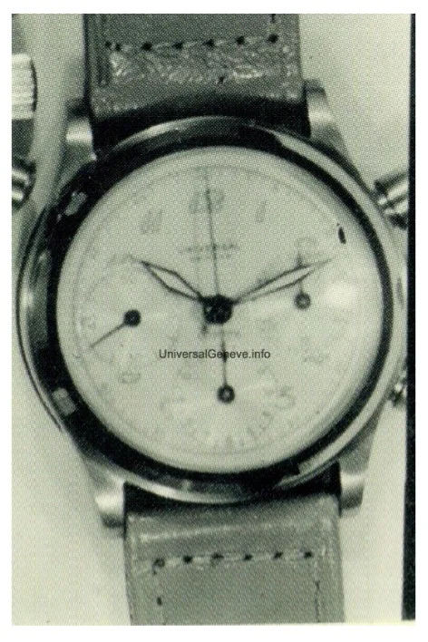

Could be a 22203 as shown in the archive.
I think I've never seen one of this reference.

Wow, thank you for posting this. The numerals on the dial are a very close match!

Of course the case reference does not dictate the dial, and vice versa, but still its cool to find an early waterproof case with breguet numerals. IMO the 22203 case size looks too small to be this exact watch, as the subdials are so close to the outer track there is not room to fit the 15/30/45 outside the subdial, whereas those numbers are present on the example under discussion.

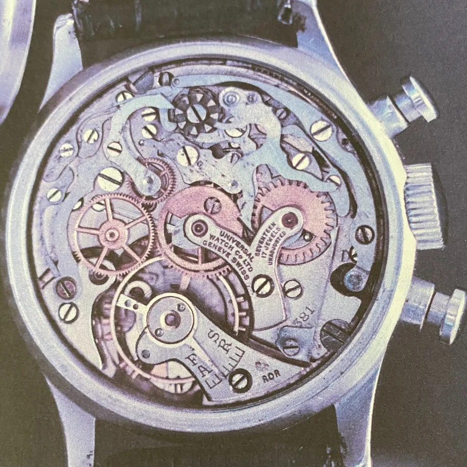

At the risk of adding more wrinkles. Here is a better movement picture than the one posted previously.

Does that say RDR on the movement? Does anyone know what country that import code is for? I don't think I've ever seen RDR before?

Well the caseback with the coin edge is seen on ref 22205 (see for instance: https://omegaforums.net/threads/universal-geneve-watches-on-ebay.3584/post-2484361). 22205 is 381 as well. That may mean that 22203 and 22204 also have them but unfortunately I have no examples of these references recorded. So it may be a 22203. The dial is still at least relumed and the pushers are not correct. And there is still the issue with the missing numbers. I'd say it is easy to overbid on this one
You just beat me to this. I have have not seen that either. It may be ROR and that is Audemars.
yah I couldn't get anywhere with RDR so far, and was considering the same thing about ROR, but that doesn't really make sense either, Audemars didn't use any UG movements did they?

Not as far as I know. Vacheron did but completely reworked them and this example is standard.
Only think I can think of is something along the lines of a UG produced other brand (like the Gallet ones) or even private label which imported them themselves with a replacement dial.
I get confused, are the 3 letter codes for USA only, and each code represents a different company? Or are the 3 letter codes international, and each code represents a different county?
6,498
10,176
US only. Each code is a different importer
3,586
8,278
another thing I have never completely understood, the import code are for the watch brand itself or for the retailer who is selling the watch brand, or both? I guess some of the watch brands would retail themselves, some would also be sold by other retailers in addition to themselves, and some might only be sold by other retailers without maintaining their own retail presence.
So we have HOX listed for IWC and Universal Geneve, and we have UOW listed for Universal Geneve, why two codes for the same brand.
And Henri Stern has exclusive rights to sell UG in the states as of 1942, why no import code for Henri Stern ?

where is this watch for sale? does the seller know where it was originally purchased? can you confirm if the 3 letter code is RDR or something else?
The watch was offered to me privately here in Canada. There is no additional history known. The movement photo is all we have.
