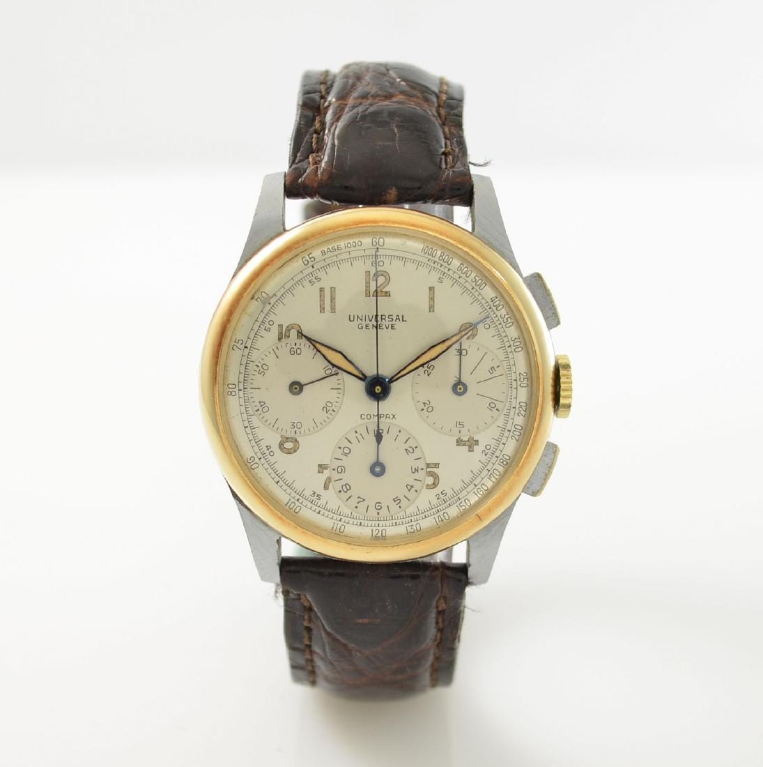

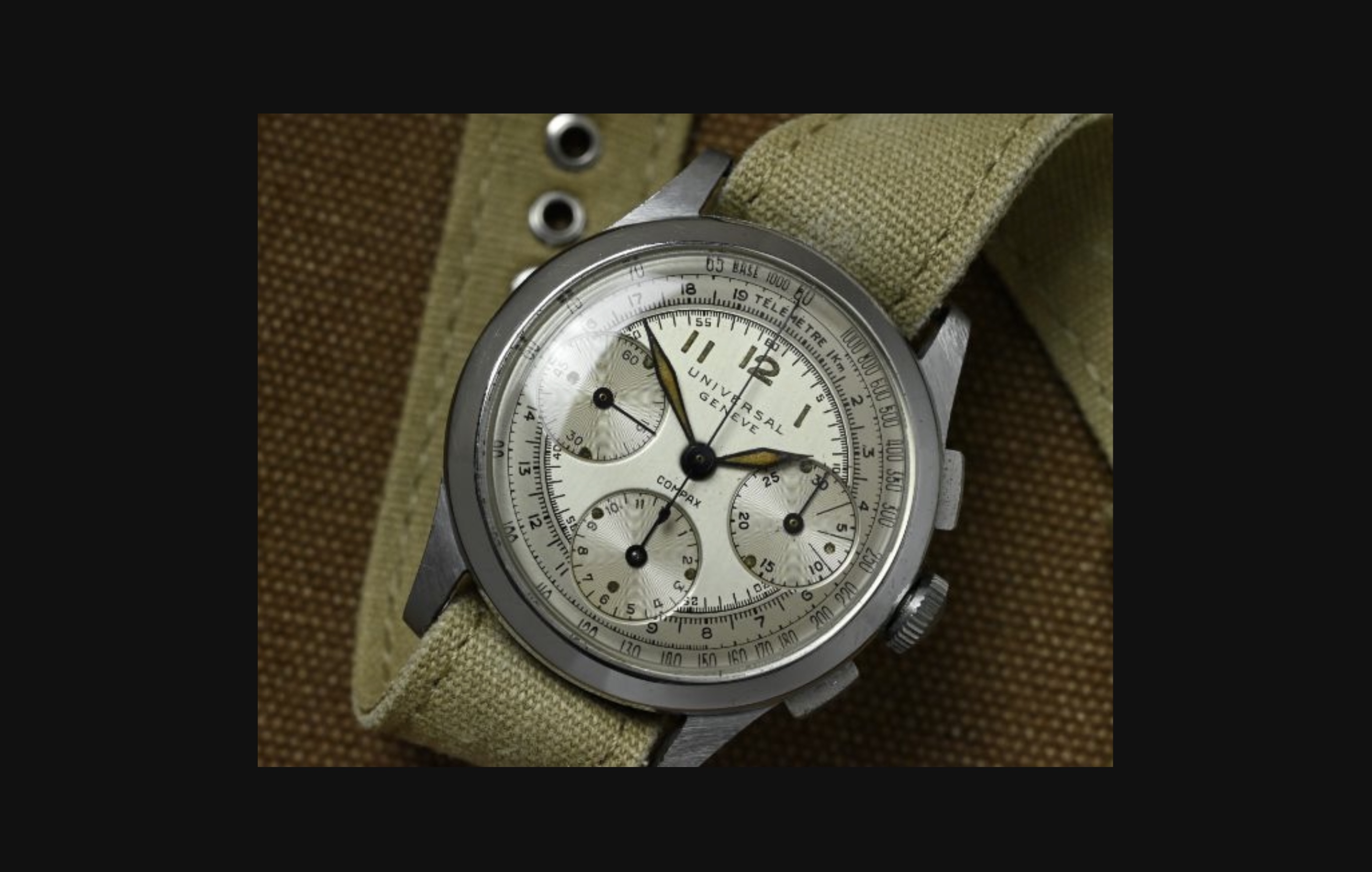

Hi. Long time away from this forum and an equally long time away from home. Hope you all are doing alright!
Recently started to look for a new watch to bring home with me and found this on a local site.

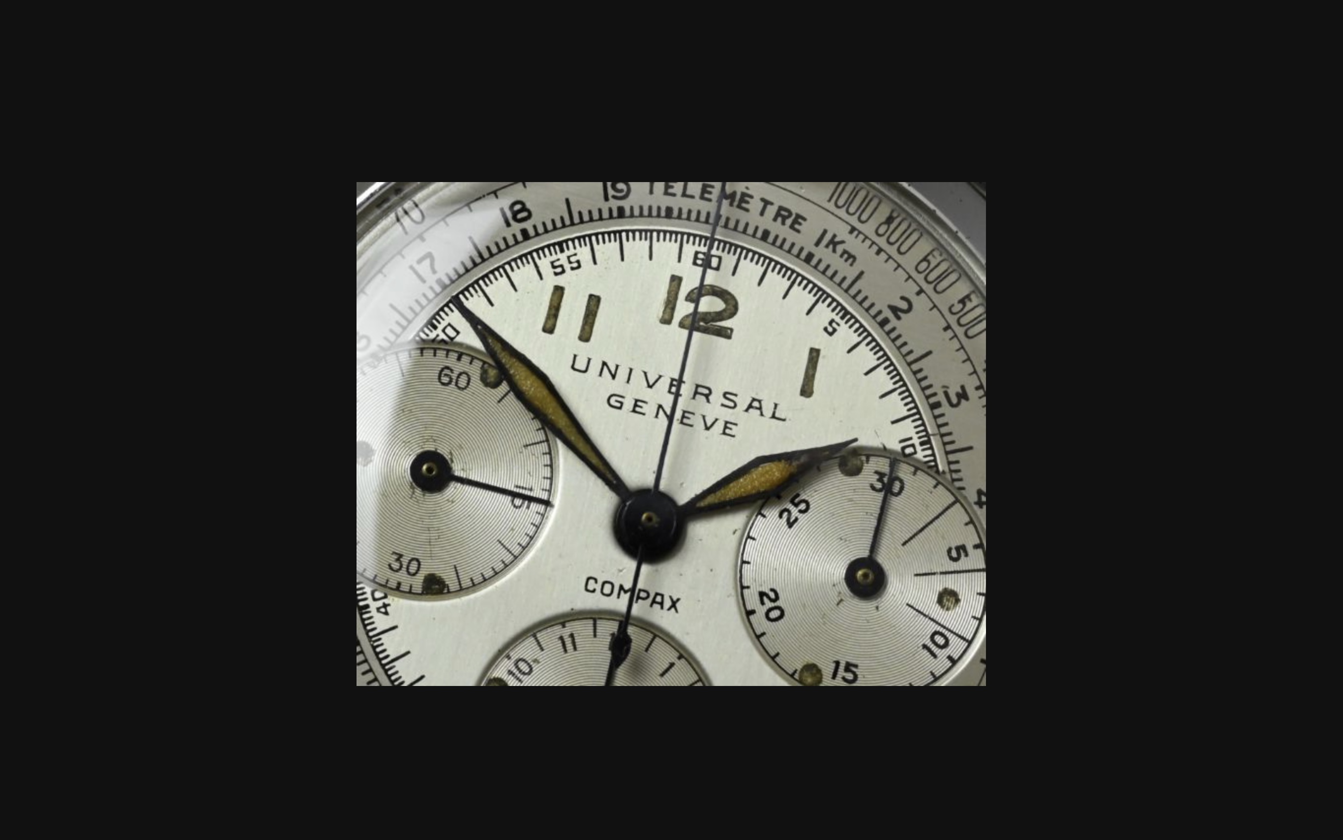

its a compax 32412. I have never seen a ug dial like this. And multiple factors make me question its authenticity.

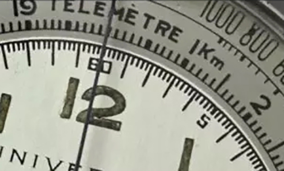

The lettering on the inner seconds dial. The 5 and 6. But maybe it was to mix it up?
the universal geneve font
the overall dial condition.
Searching the referance does not give any matching dials. I get the big 12 dial etc.
Feel free to share some thoughts and light as i might want to pick this up.

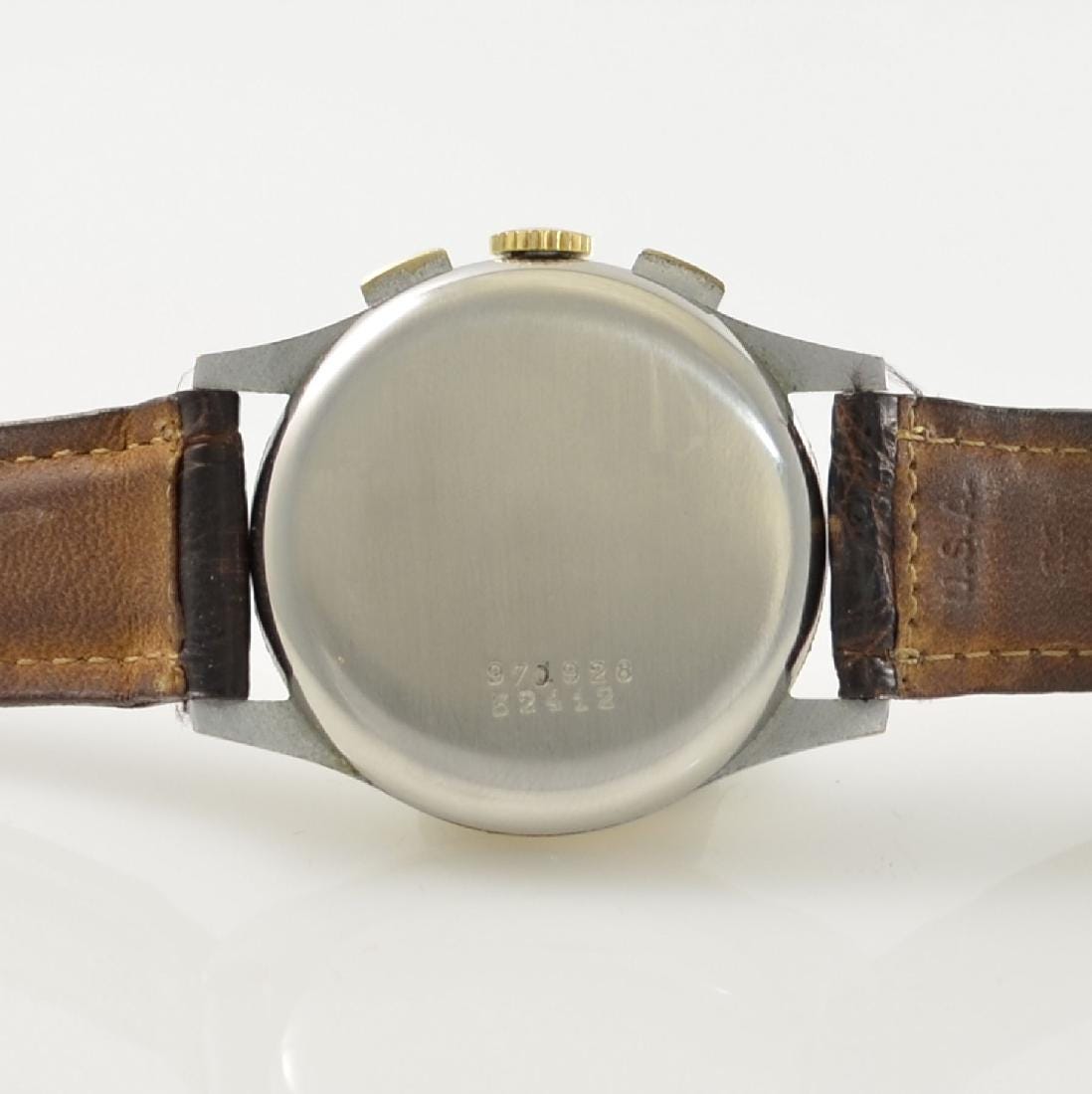

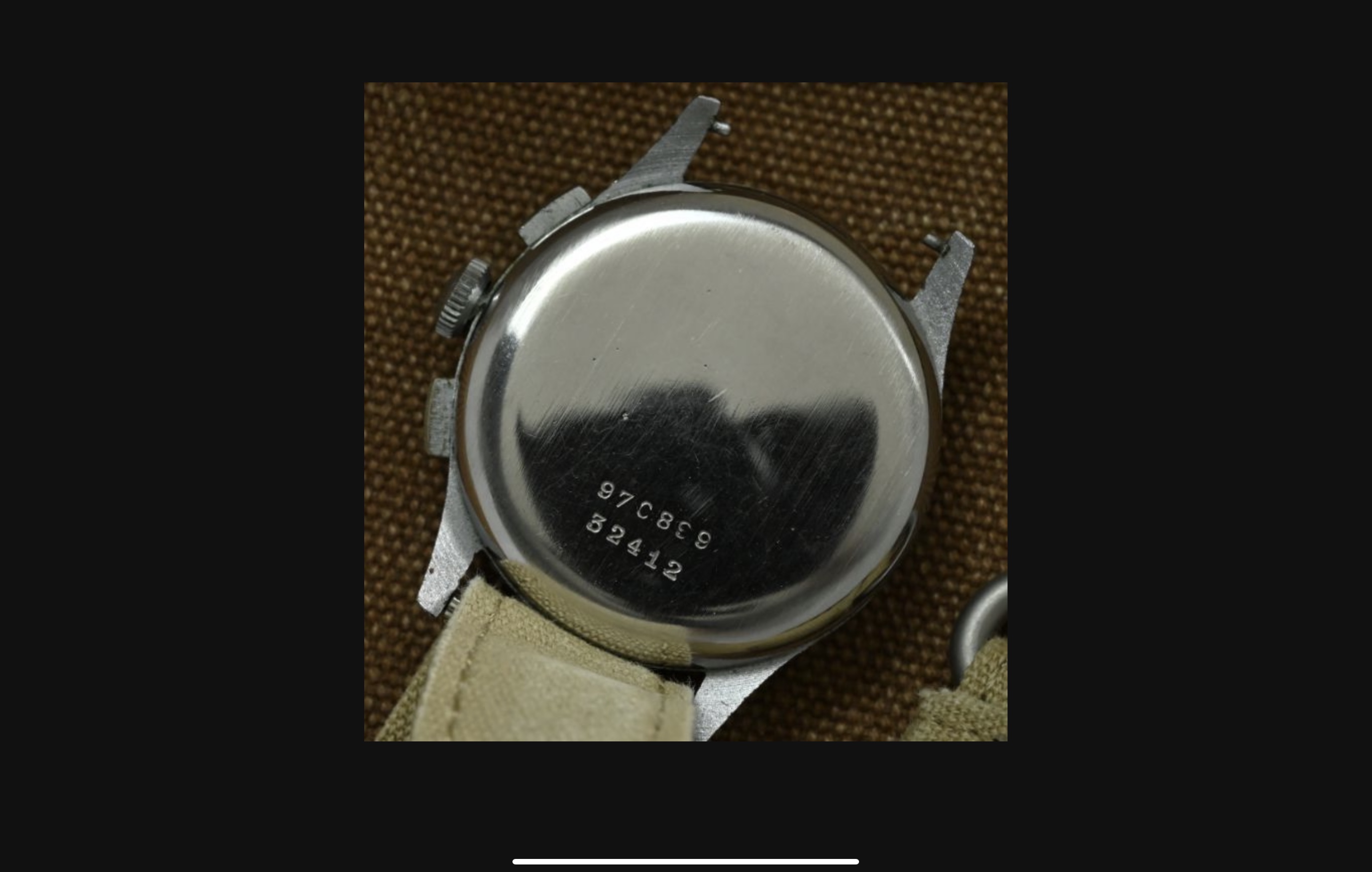

Think so too. What is the serial?
200
328
970899
The thing that makes me maybe think it is authentic is the lumen and overall quality of the dial. If its a redial it is a quality job. Past anything I have seen on an UG.

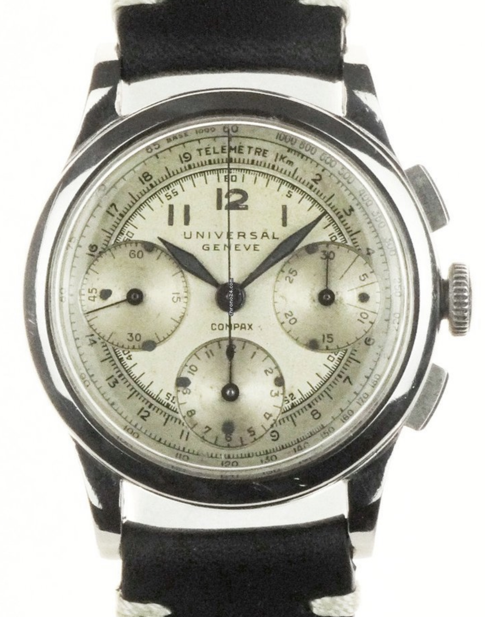

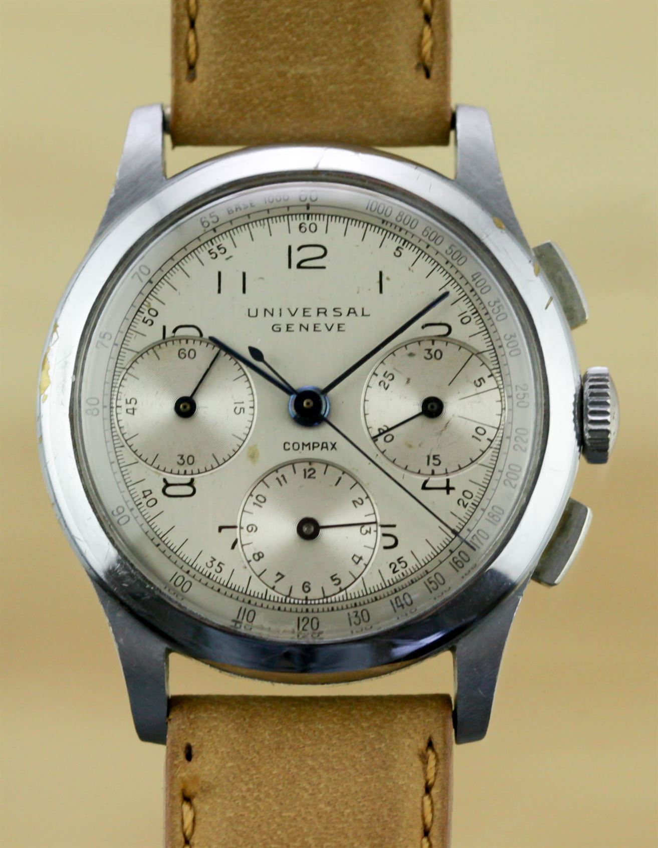

Some close siblings:
In return: can you tell me the movement serial?

Not willing to slam the lid on this one either. I’d love to see the inside/ outside case back and movement.
Asked for movement shot. He says its a 287.

I would not rush to judgement. My gut impression, without thinking, research, or justification, leans towards original.
The dial printing is quite good, however there are many oddities. To me this suggests more research is needed.
I would identify some key idiosyncrasies of this dial and see what evidence you can find for or against. Ideally you can find this exact dial. However sometimes this is not possible, research is inconclusive, and then you just have to make your own call.
PS I don’t see any immediate reason to question the above spillman dial
3,677
8,482

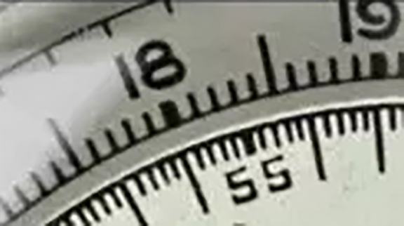

Hey B! What about these parts?
the boxy 5 and 6 in the minute track are very odd. Some of the minute hash spacing is also not consistent. I'm not suggesting there are not questions.
it's just my personal approach i guess, in cases like this where I'm on the fence, not to form an opinion without detailed research. I find UG to be too inconsistent and unknowable.
I could be wrong, and don't have the time to do the necessary research myself

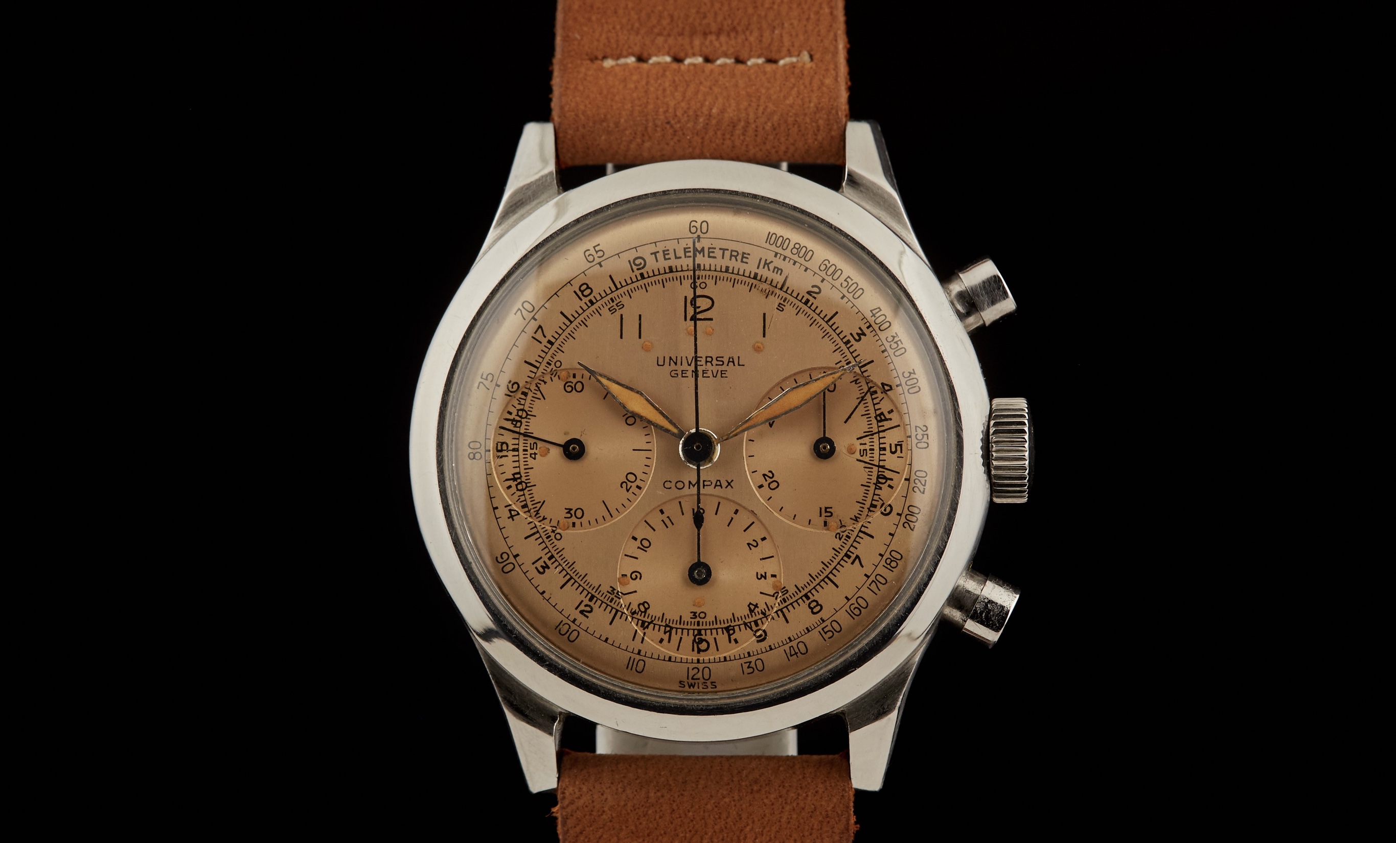

I vote for unusual but (probably) original dial.

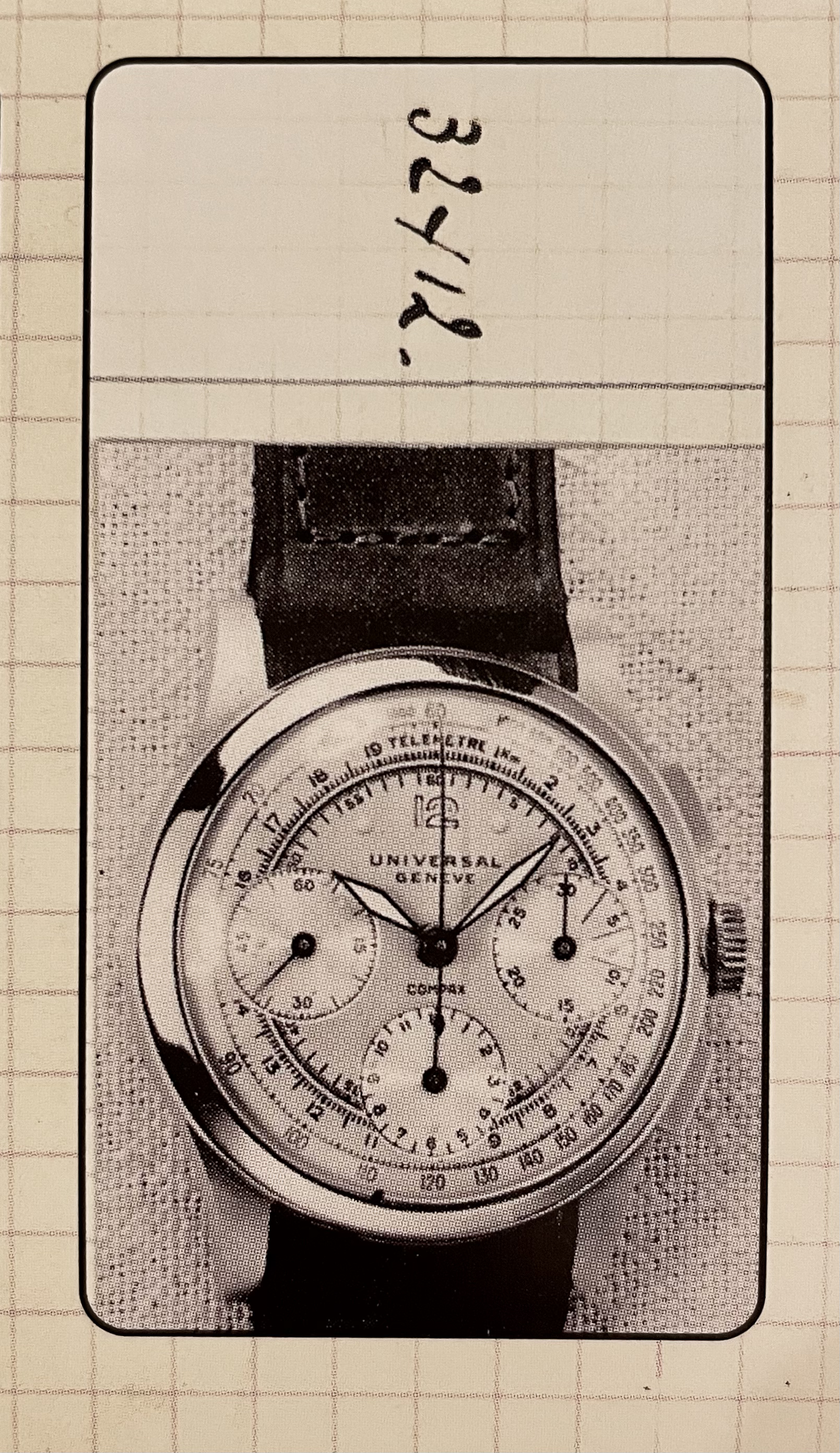

If you look for the reference on Sala (page 296) the dial on the archive example is similar with the strange “expanded” font of company name:
And here’s a ref. 22493 with, I would say, exactly the same dial and equal font and “boxy” 5’s:
https://www.chrono24.com/universalg...42-military-compax---ref-22493--id9535701.htm
or directly on dealer’s site:
https://www.highlifewatches.com/store/p105/compax1942.html

good research, and I agree, with two examples plus Sala, I would feel comfortable calling the dial original

Next time: first Sala and then something else ;-)
3,144
23,990
I stand corrected then! After all these years, UG is still a mystery!
