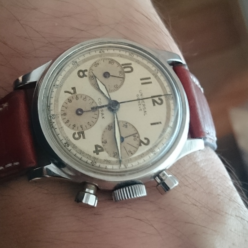

I like this one but get a gut feeling that there is something not quite right. The reference is well documented. I am dubious of the "swiss made" at 6 o' clock and the font that is used (compax and universal geneve). It does look like pushers are also mis-matched (not 1940's for sure) ...
Opinions?
2,671
24,903
"Universal Geneve" and "Compax" looks repainted, feels like an older redial with good character. Also Chrono second hand is not the right one....
Edit: as others point out, I am wrong, it is original dial.

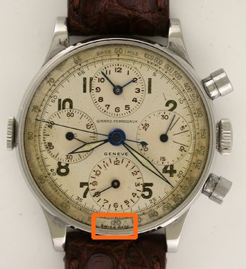

Could it be this one ?
In that case,it is completely wrong ...

Hi guys, this is my watch so I feel free to comment. I have done some research before I bought it.The ref 22209 is used by Universal Geneve and girard Perregaux. The UG ones have a UG case back (like mine), the GP have a GP logo on the CB.
The picture above is from a GP dialed one.
Swiss Made is indeed a bit 'odd' but both the GP and UG dials of this reference use it. I talked to some collectors and they were sure the dial is original.

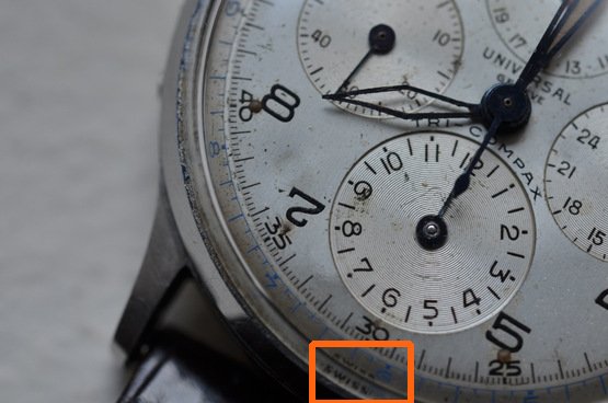

A close-up of my dial:

I understand.
However, the case is not correct either though. I have never seen those pushers on any UG and definitely not a 1940's. At best we have a case with parts that are not correct and a mixture of hands on a dial that is supposedly correct.
One point that stands out, is that GP always signed their dials "swiss made" while Universal used "swiss" at six o clock.

For me pushers look strange as they are not round but "grooved/serrated"... But I might be wrong.
Hands look relumed too...but I don't mean to interfere in the current sale...

+1. The hands have clearly been relumed. Not unusual or a big issue for me personally, however I would have liked them color matched to the dial lume.
2,929
6,248
IMO dial is original and attractive. Can't vouch for the pushers. Hands look relumed.

The close up of the dial is far more convincing than the original image.
The hands however don't just look re-lumed (which is not necessarily an issue in my eyes if done conscientiously), they look like they have had a paint job too. They do not look like they were painted by a professional. It all looks a bit messy.Second hand is a 60's replacement. I am unsure if they are service replacements as every image I have seen (catalog and reference documentation) shows a different handset
The pushers are replacements and that would be an issue for a collector.
I am still a little unsure with the "swiss made" at six o clock and will research that.

a comparison or GP and UG below. different models but same era ...

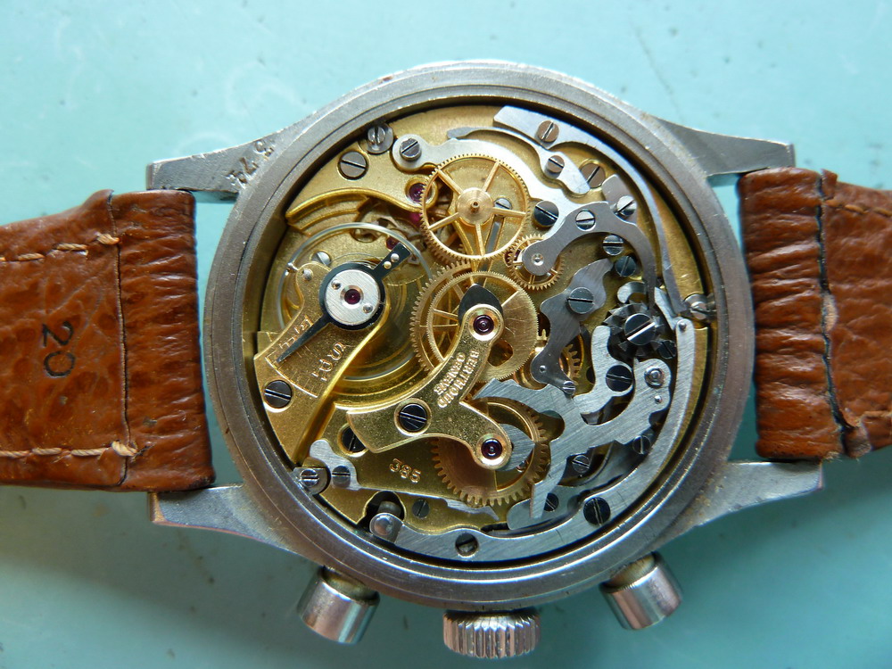

Alright, this one again... I had the movement completely serviced by my watchmaker and he fitted an original secondhand. I put it up for sale on Chronocentric and someone commented that the dial was a fake/reprint/partial reprint,...

There is a discrepancy between the Italian Chrono24 dial and yours in the printing of "Swiss Made" and the fonts/width of the "COMPAX" text.
