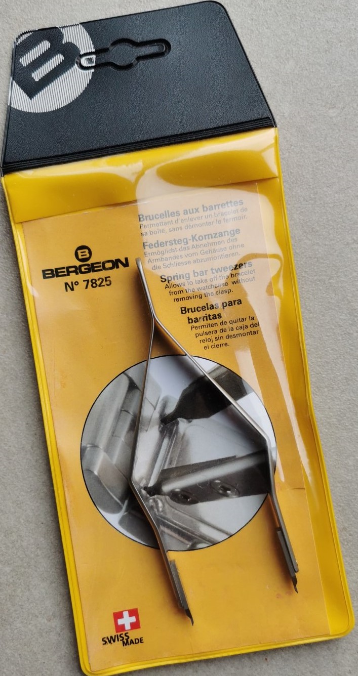

This one:
The Horotec version is probably good enough and is less expensive. That's what I have. Admittedly, I don't often use it.

Cant speak for the Moonwatch but for my Automatic to be honest I use an Bergeon 7767 and that work perfectly for me.
But I have experience for changing maybe a thousand bracelets and for beginners the 7825 is perfect with the bonus that you dont have to separate the clasp.
