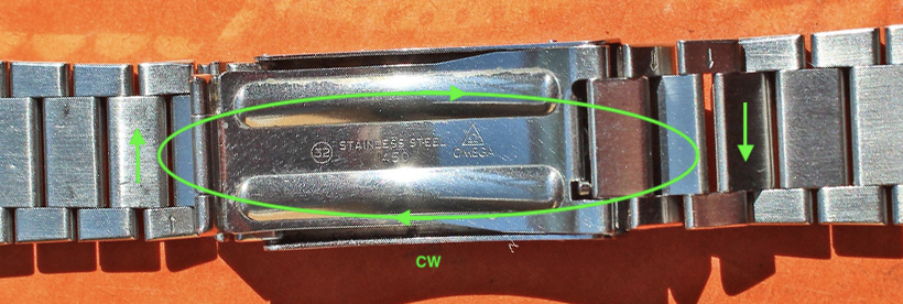

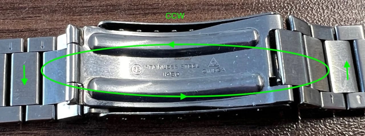

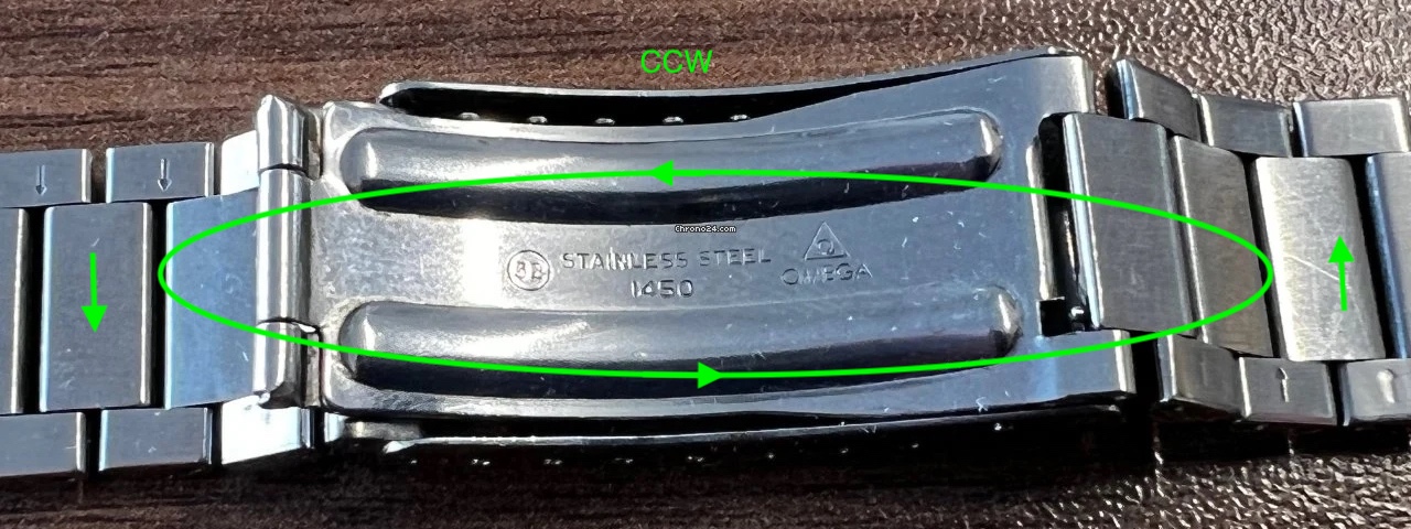

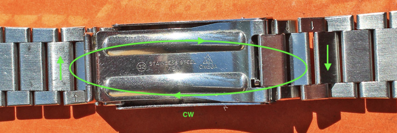

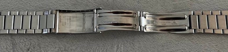

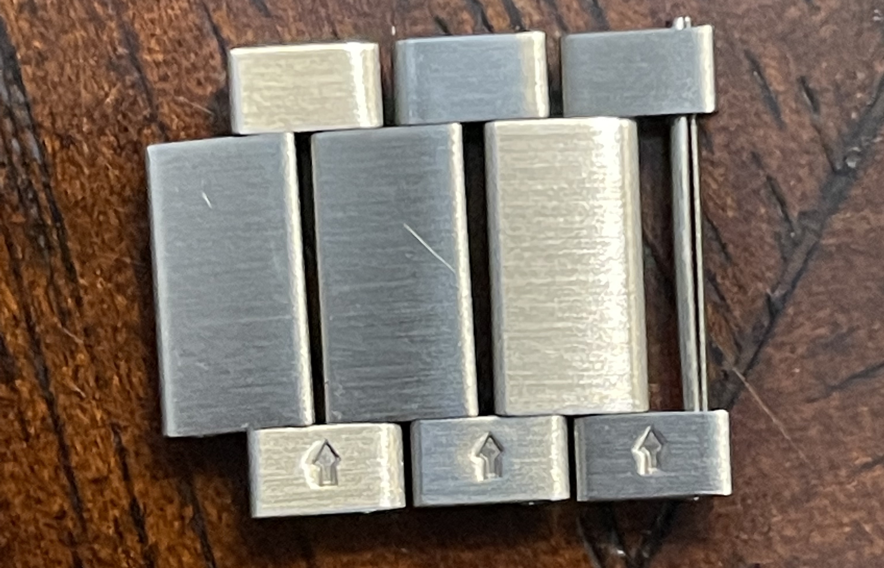

Keeping the clasp so it can be read (not upside down), I will define these links as clockwise (CW):
And these as counterclockwise (CCW):
It is important to note that the links can’t simply be turned over or the clasp turned around to make the CW links point in the same direction as the CCW links and this is because the links are non-superimposable mirror images of each other like your left and right hands. This results from the removable pin always being on the clasp side of the link and the fixed pin on the watch head side. Take a look at the pins in this side-on view:
It is conceivable that these could be reversed, and this would mean you could assemble the link either way, but the fixed pin seems like it is intended to be just that, fixed.

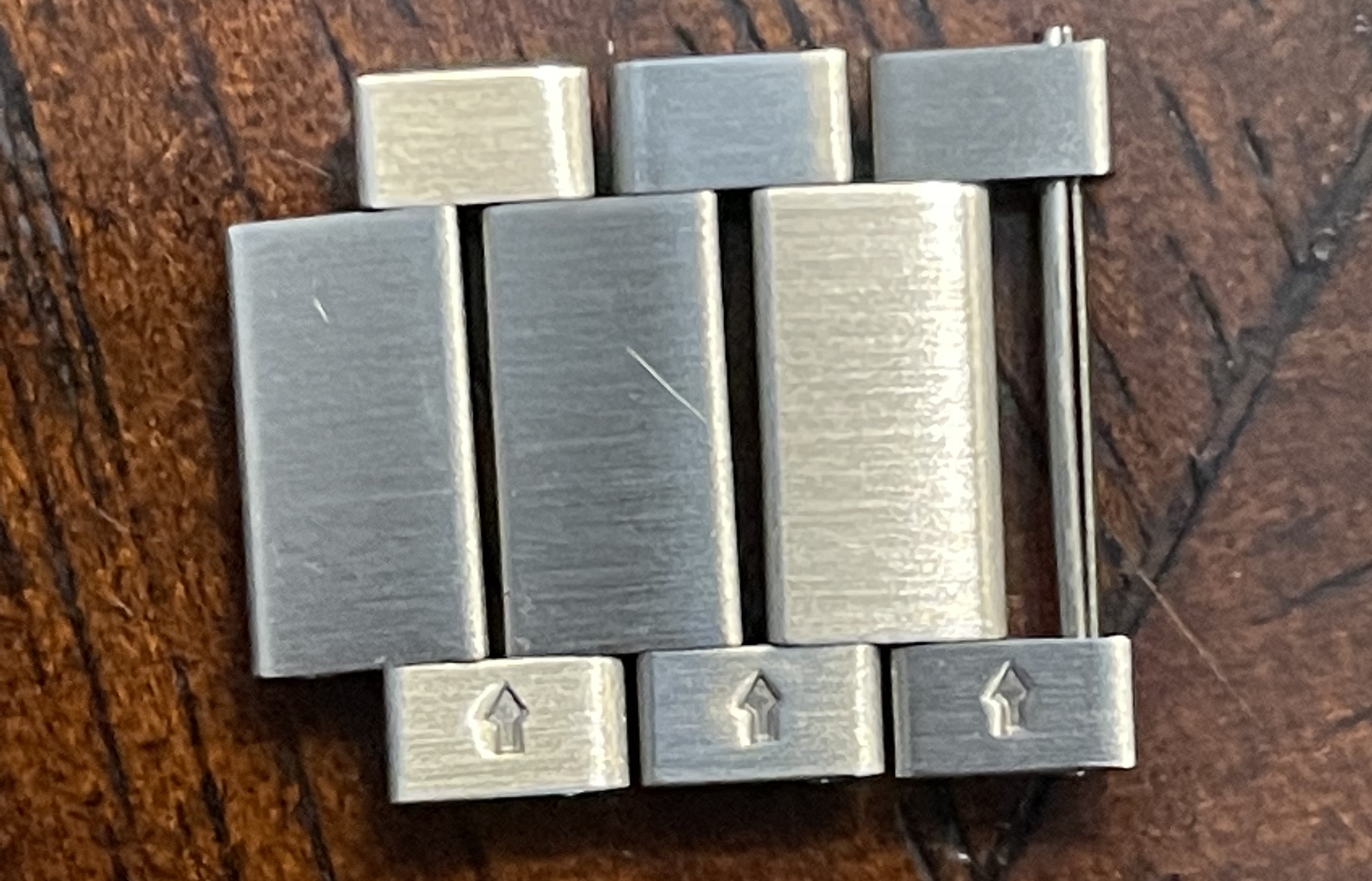

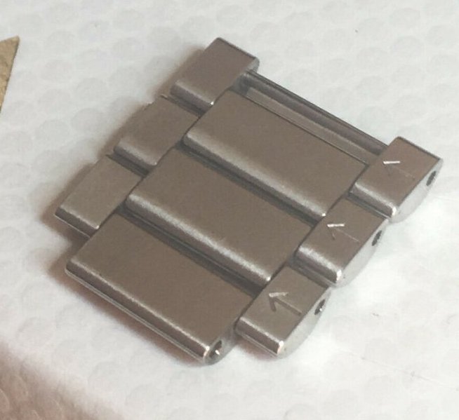

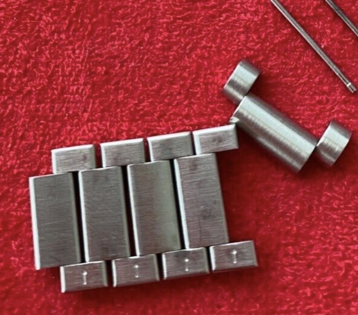

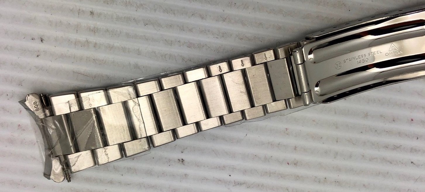

These things said, I needed CCW links, but the Uncle Seiko links are CW:

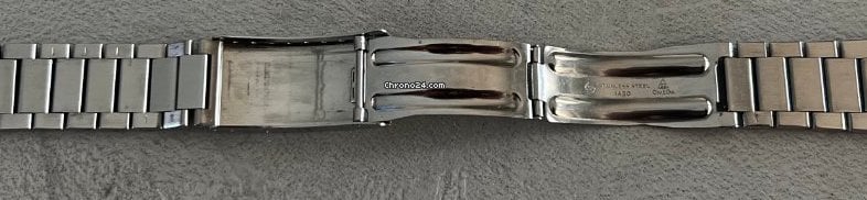

Unfortunately, I don’t have the Moonwatch Only book, but found this image that clearly shows the 1450 as a CCW 1450.

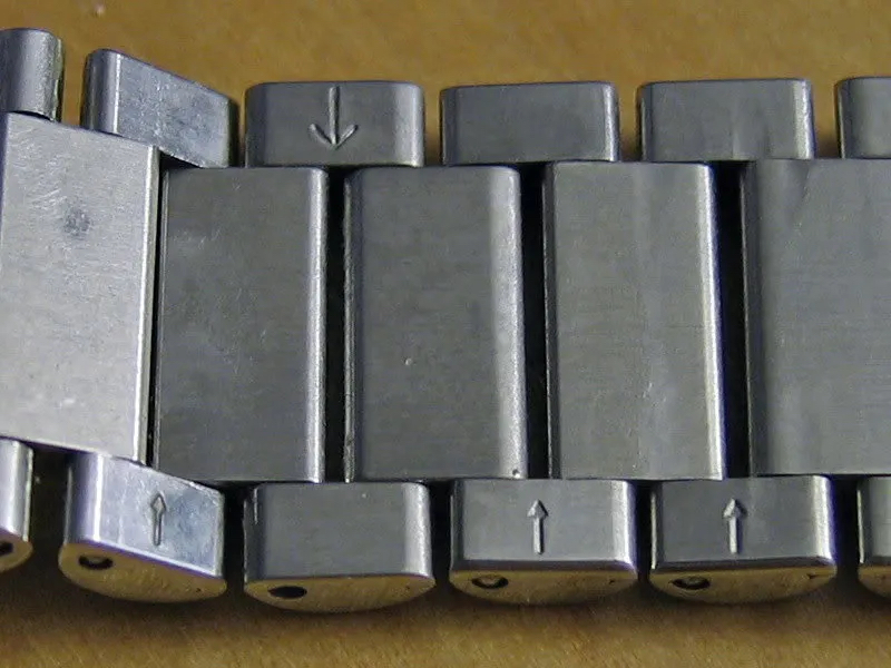

But this doesn’t seem to be a definitive end. Examination of images of 1450 bracelets and links reveals that there seems to be almost an equal number of CW and CCW 1450s out there:
And finally, in a Watchuseek post from 15 yrs ago discussing the use of extra Omega links (which apparently are produced wider than the clasp so that they can be fit to the bracelet), there is correspondence from Omega stating:
“Well, I exchanged a few emails with Omega, sent photos, and finally received the following response:
It seems that several versions of this bracelet have been produced and that only one type of link has been produced.
Therefore depending on the type of bracelet you have the links must be adapted. Please feel free to contact our representatives in the USA for further assistance:
The Swatch Group (US) Inc.”

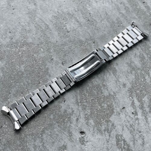

So apparently Omega produced more than one type of 1450, and perhaps this accounts for both the CW 1450s and CCW1450s that one might encounter. However, I can only surmise that they mean that only one type of extra link, likely 114ST1450.

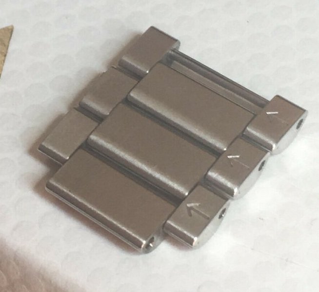

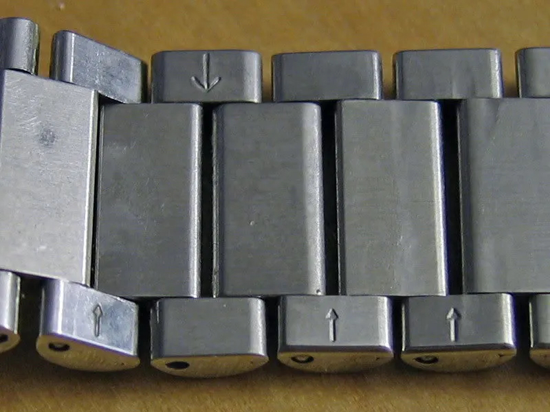

Interestingly, few have both CW and CCW links, although this variation can be seen:
Presumably from someone sizing the bracelet with whichever links they could find, much in the same way that I did with the US links.

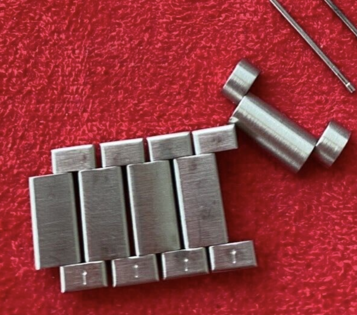

Here is another image. I suspect that the CW arrow is the extra link, the 114ST1450, and the others are original to the bracelet. Not that the arrow shapes are also different. The CW arrow is much thinner than what I believe to be the original Omega arrows found in most of the pictures in the post. The US links (pictured above) are easily distinguished with the thickest of the arrows seen.
Other Link Pictures:
I guess my questions are:
Am I missing any important facts/information here?
Can someone confirm that the thin arrow links are the 114ST1450?
Aesthetically, should one stick to exclusively CW or CCW links? Does this matter to the community? For some reason, it seems to matter to me…even though only the wearer will see this detail.
After looking at all these things, I would conclude (guess) that both CW 1450s and CCW 1450s have been produced and are equally authentic, but I could be wrong on this. Happy to hear people’s opinions or to see additional data posted.

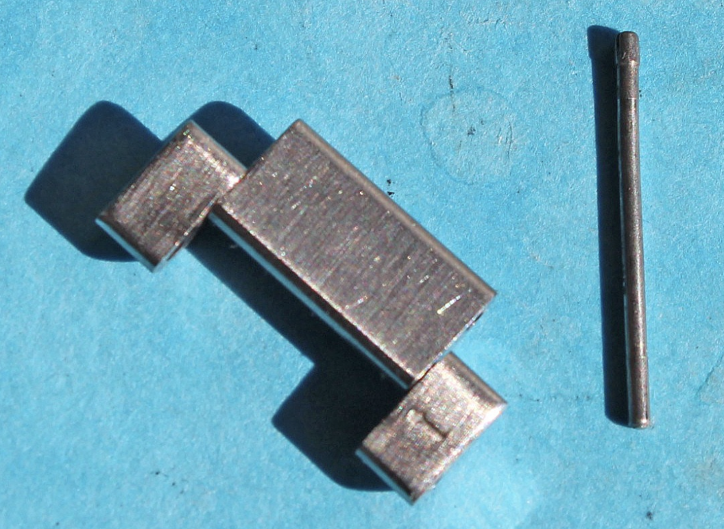

Thanks for sharing your research, very interesting.
Mine seems to have the CW links on both sides. I will post pictures later when I get the chance to take a shot.
Can you please elaborate on that? Maybe it's the summer heat or my lack of sleep, but I've read this sentence like a dozen times and I still don't get it 🤦.
Are these prices you've observed on closed transactions or mere asking prices. Tbh, I would sell mine immediately at these prices lol. What I observe is the one offered here for €1500 sitting unsold and the one offered on a Swiss auction platt form (see link). I was offered with a reserve price of CHF 1750 and BIN of CHF 1950 for a few weeks and now the seller turned into a non reserve price auction. It'll be interesting to see where it ends. Btw, also a CW / CCW combo.
Thanks! I am glad this might help some enthusiasts.

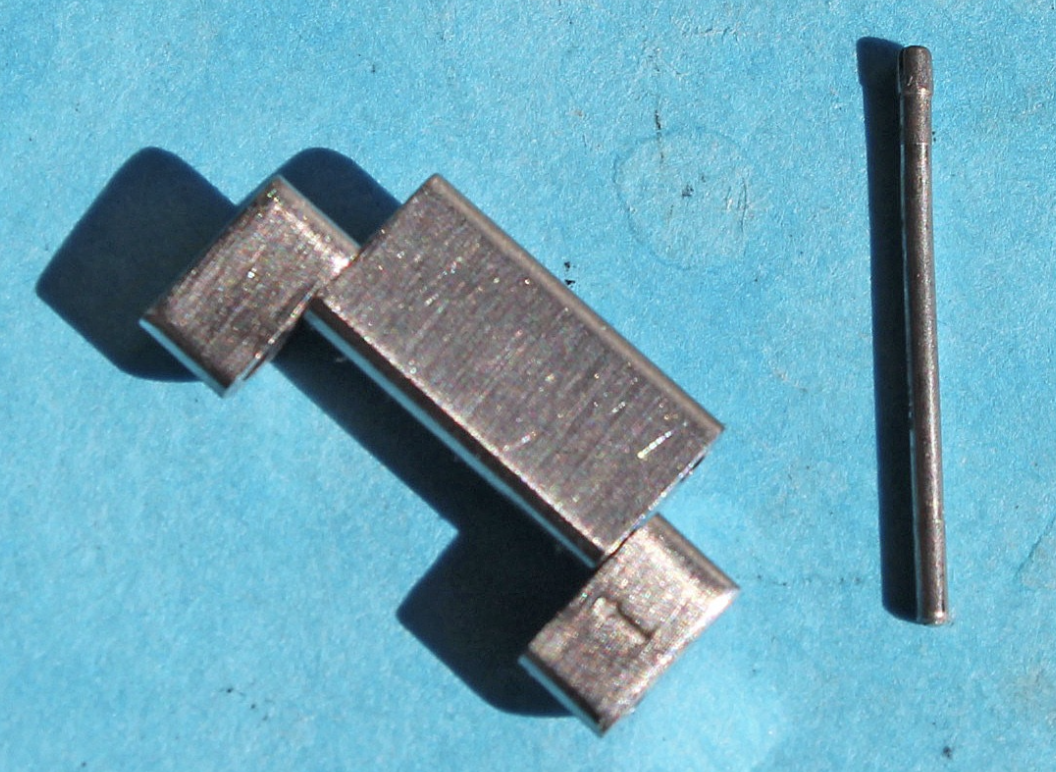

As for the sentence "This results from the removable pin always being on the clasp side of the link and the fixed pin on the watch head side. Take a look at the pins in this side-on view:" let me try to elaborate.
If you look at the removable links side-on, the removable pin is always on the side towards the clasp and the center link always juts out towards the watch head. There are no links where the removable pin is attached on the watch head side- there couldn't be or the links wouldn't fit together. So the left and the right side of the removable link are different and not interchangeable. If you want to move a link from the 6 o'clock side of the bracelet to the 12 o'clock side, the result would be that your CW link would point "down" on the 6 o'clock side and "up" on the 12 o'clock side (when you look at the clasp in the way prescribed by my somewhat arbitrary convention). So if your links are CW and you buy an extra link that is CCW, there is no way to make the CCW link arrow point in the same direction and match the CW arrows you currently own, short of hammering out the fixed pin and reversing things (which I am not sure can be done and would most likely not be recommended). This sort of arrangement is akin to your hands. The CW and CCW links are mirror images of each other and no matter how you turn them, they will always be different from each other (short of the hammering thing). Your hands are the same as they are mirror images of each other, but you know that they are different and not interchangeable (think about a hand shake: RH to RH works but RH to LH is awkward for both of you because hands are not interchangeable) . Hope this helps.

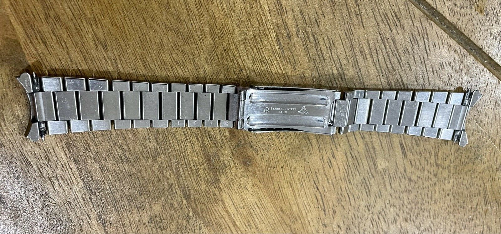

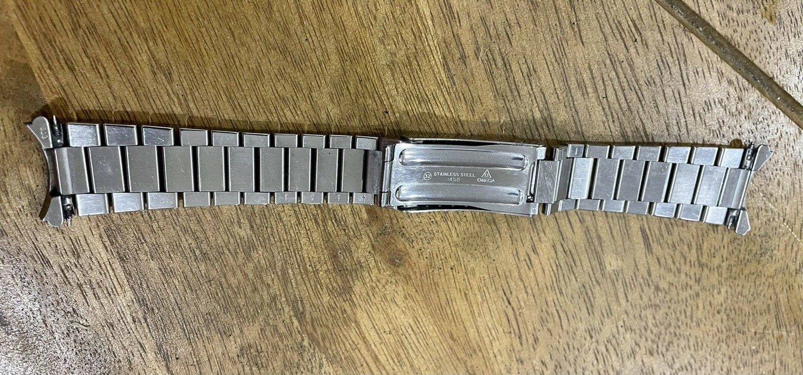

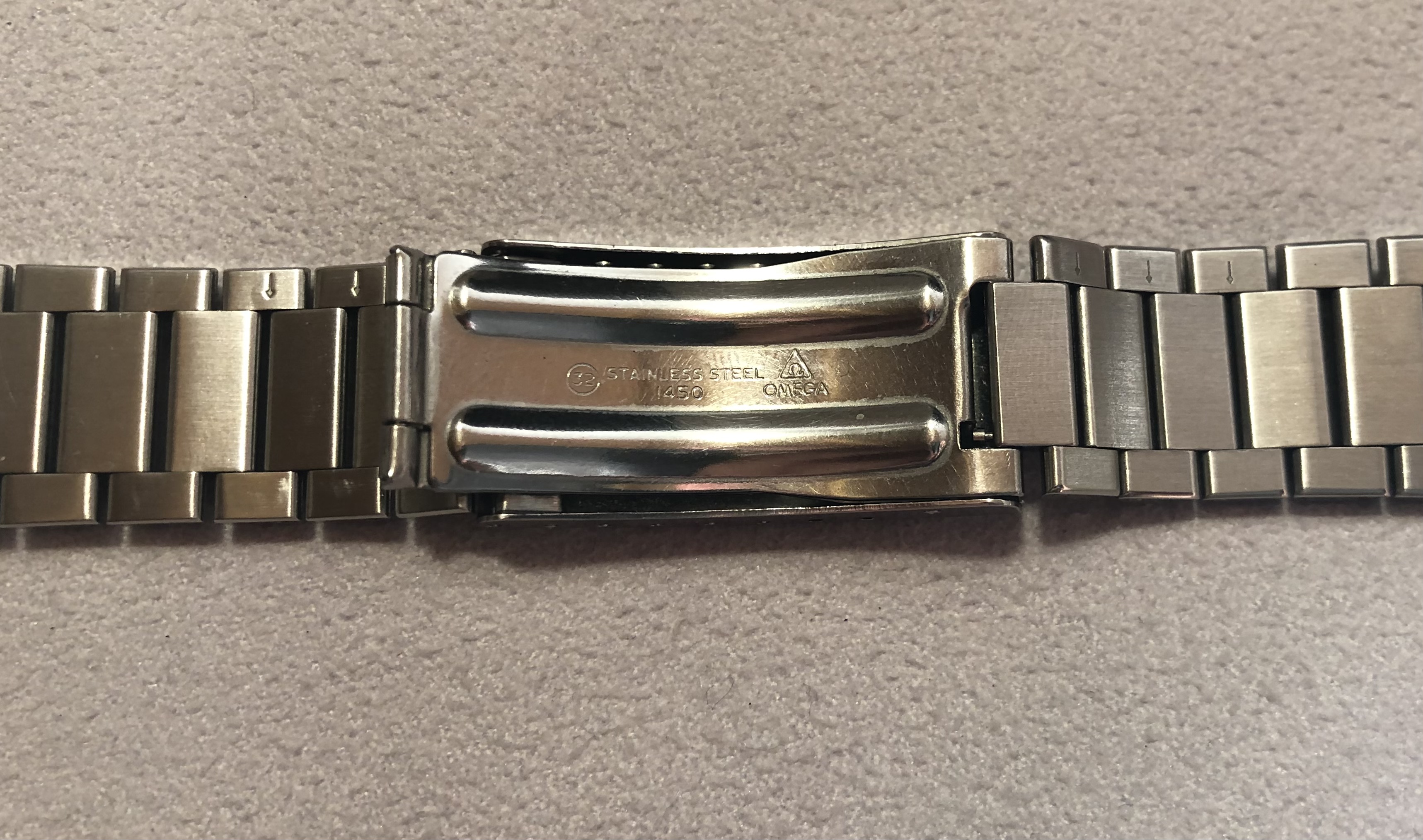

Here my 1450 with arrows on the links pointing down on both sides though the arrows on the left of the clasp are somewhat broader.
What‘s your take?
What‘s your take?
Thanks for sharing the pic! I was actually wondering if I would see this link arrangement (all arrows on one side). So you have a mix of CW and CCW links. I don't know how the links are made, but if the arrows are stamped into the steel, it looks like the arrows on the CW links are shallower than the CCW links. Is that actually the case, or does it result from the lighting? I'm guessing that the links are not all original to the bracelet, because they would likely have the same CW/CCW orientation and appearance. Did you size it or get it like this? Can you post a side-on pic?
