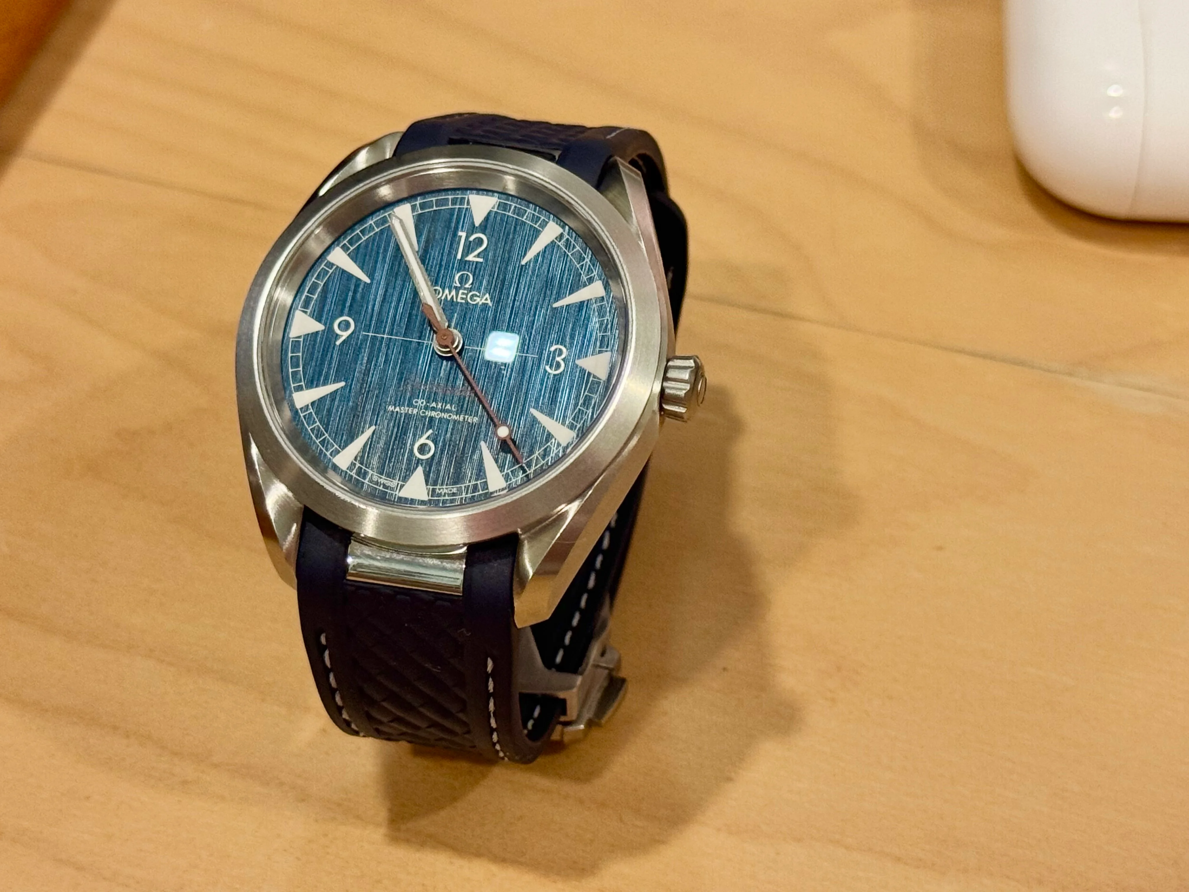

The striations on the dial that flash blue and bronze with the light never get old. Also, the Aqua Terra rubber does fit, even if the polished end links are a bit weird with the fully-brushed case.

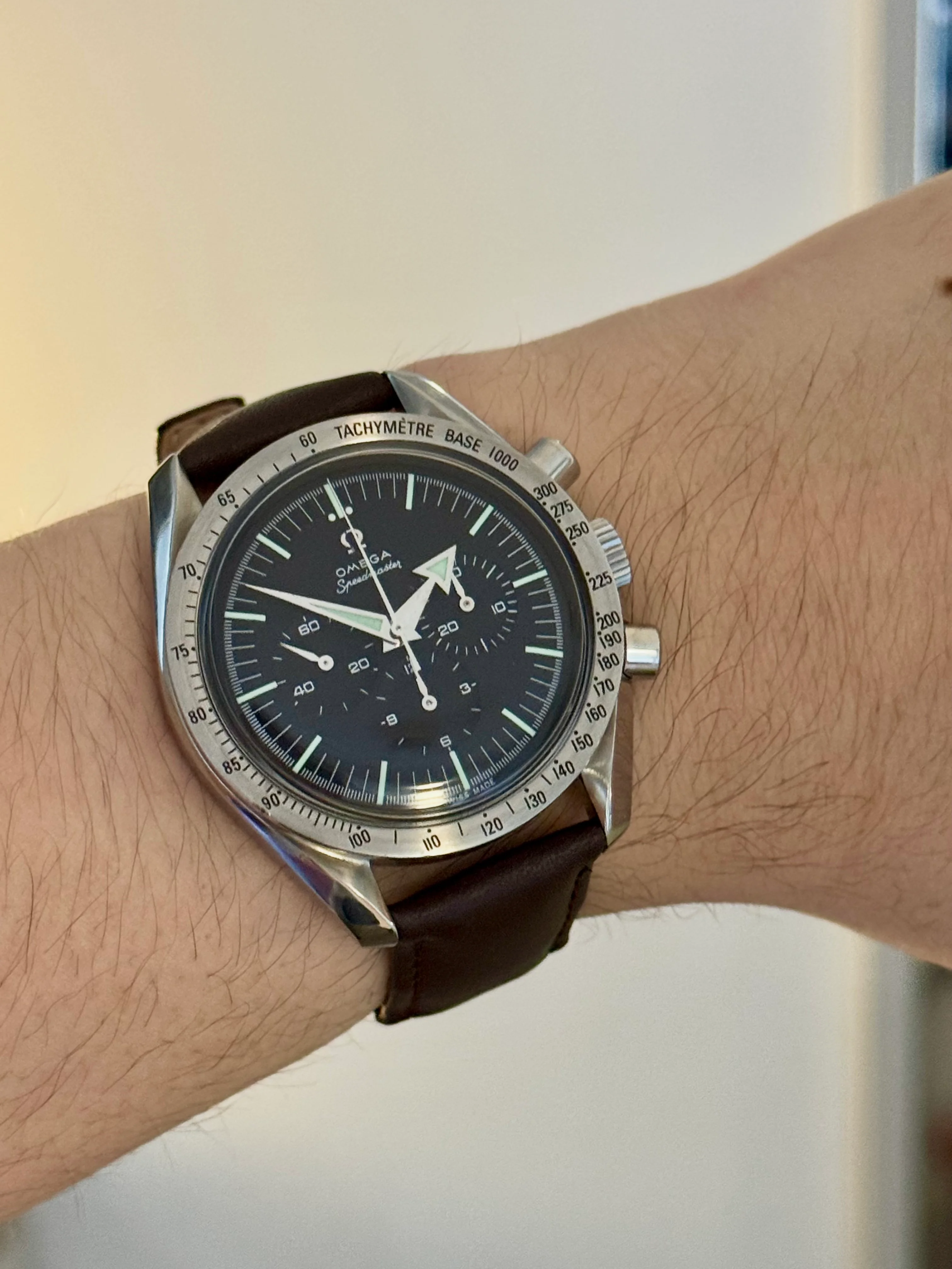

After keeping an eye on eBay, I eventually picked up a 3594.50 from Japan as the cheapest way to get a new-ish 1861 with the pro case. It was in quite rough shape, with a dent on the metal bezel and the corrosion on the AML and hands that people often warn about as being possible liquid damage. The watch was however supposedly recently serviced and had been given a light polish, and all the less-than-deal parts were going to be replaced, so this was a great opportunity to revive a rather sad Speedy.
The watch as I received it - I didn’t have the tools to size the 1498/840 bracelet it came on, so I threw it on a spare vintage-esque leather strap. You can see the dent in the bezel at 90, but not the corrosion on the AML or the hands from this angle.

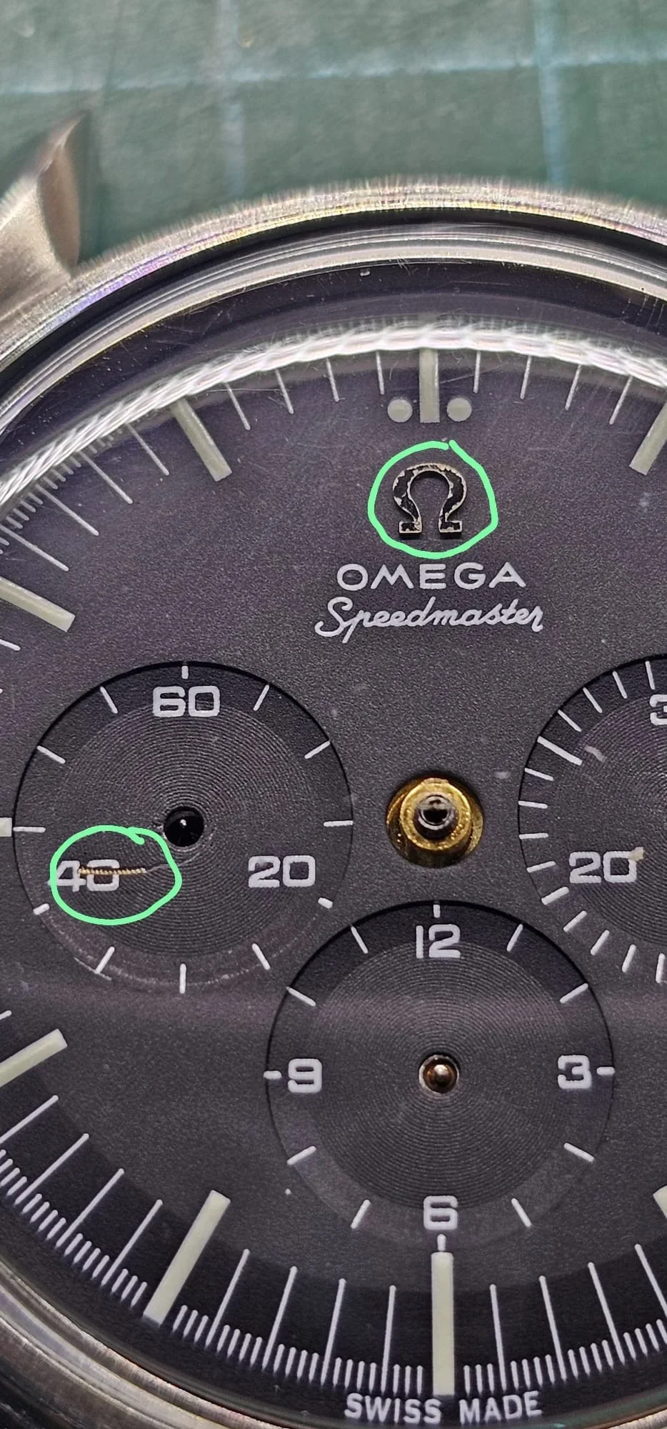

A picture sent to me by the watchmaker who installed the 321 dial showing just how deep the scratch was - you can also see the corrosion on the AML.
Needless to say, I don’t recommend them if you need any work done. We did go back and forth but they refused any responsibility for the damage as I had provided the parts, and presumably also held the hands of the technician that gouged the dial while he was working on the watch, being my fault. The obvious damage to the dial also meant that the dial swap plans had to be moved up. I had been looking at one on eBay that was supposedly picked up from a deceased watchmaker’s estate, but it was quite expensive compared to what the OP in the other thread had paid. Luckily, I spoke to the seller and offered him the same $900 that the other dial cost, and we had a deal.

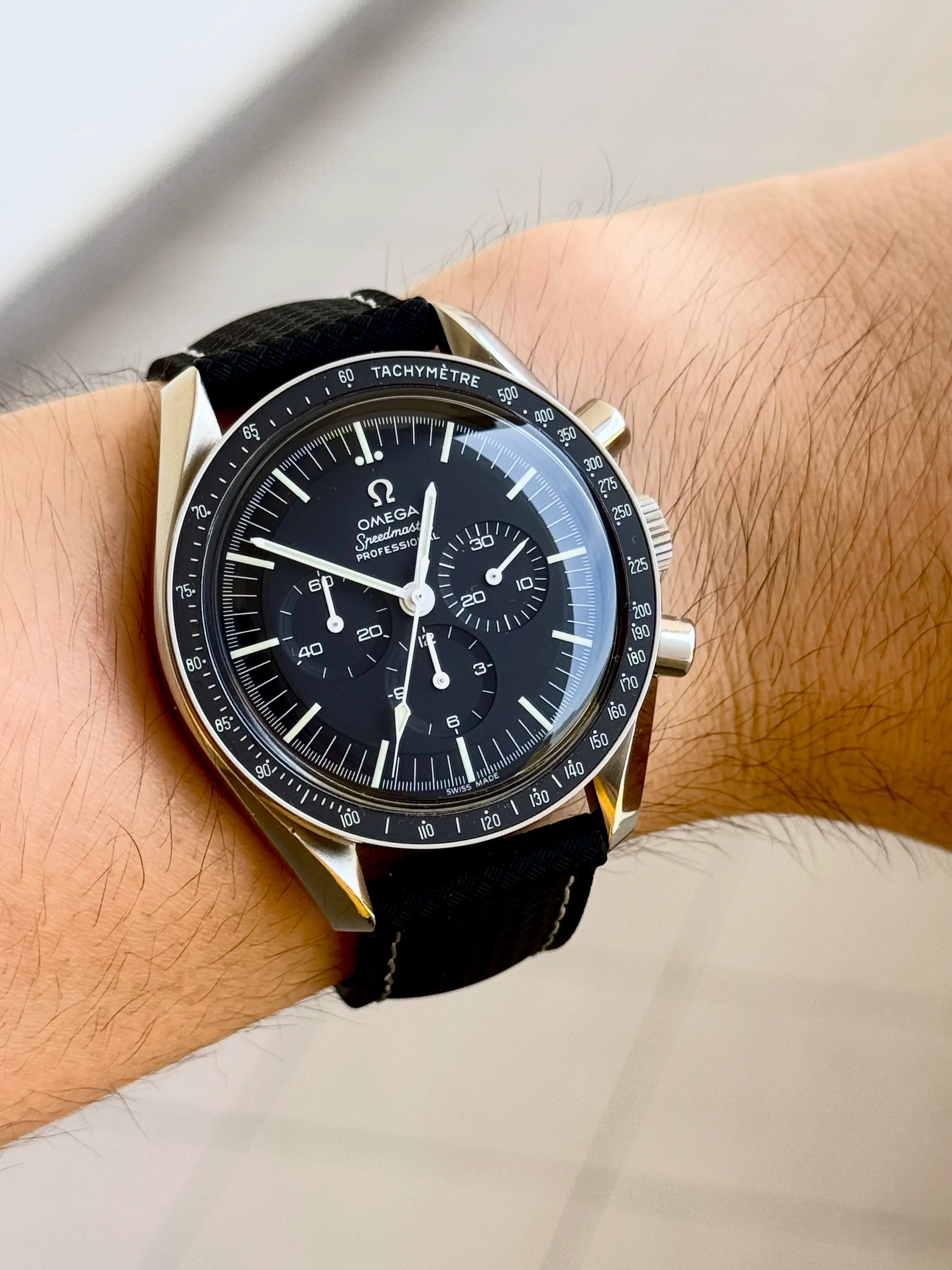

Eventually, I had the watch I had always wanted.

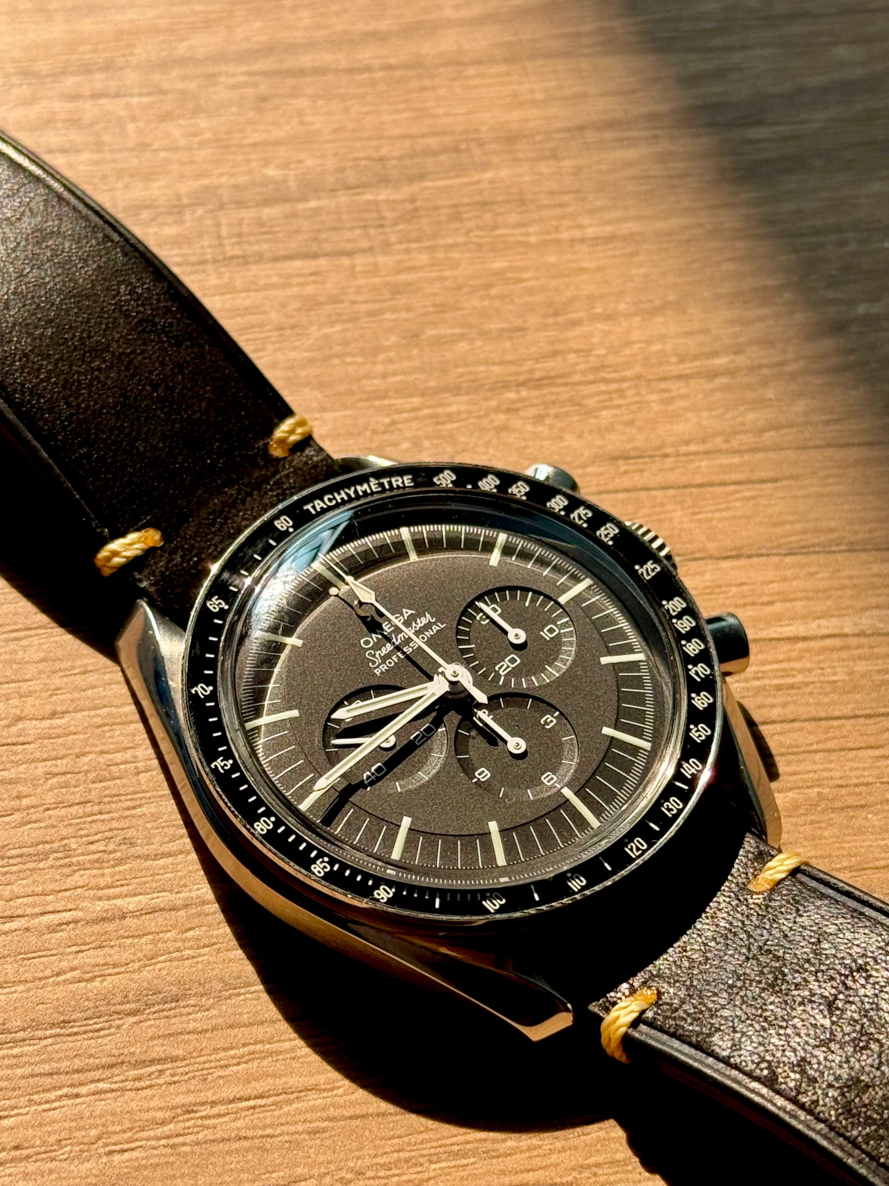

The chrono has the glamourous job of timing how long I’ve parked the car for - clearly the most useful watch complication. Strap is a FKM rubber with deployant clasp off one of the more recommended AliExpress stores whose name escapes me, which unfortunately ended up a bit big for my wrist. Also installed is the Spiralwinder DON ceramic bezel.

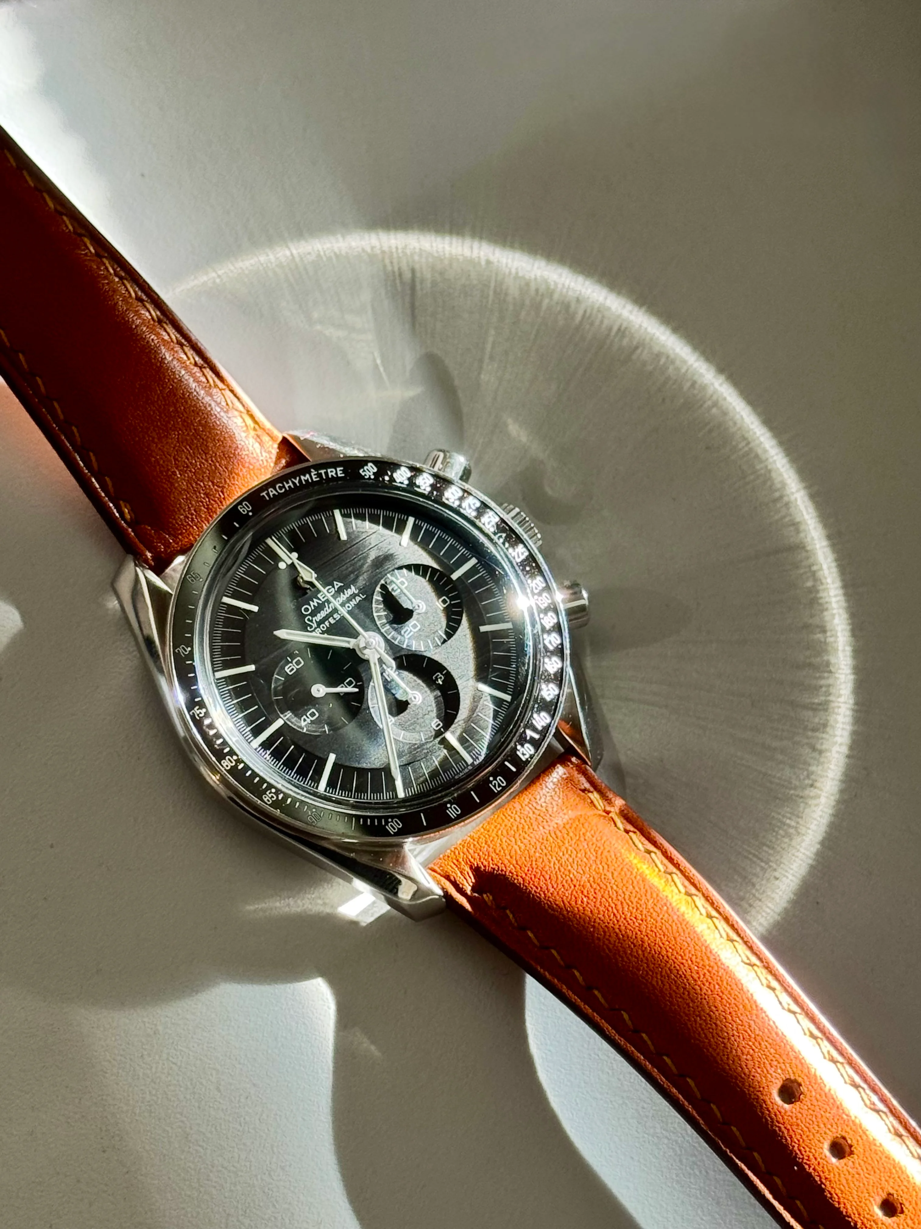

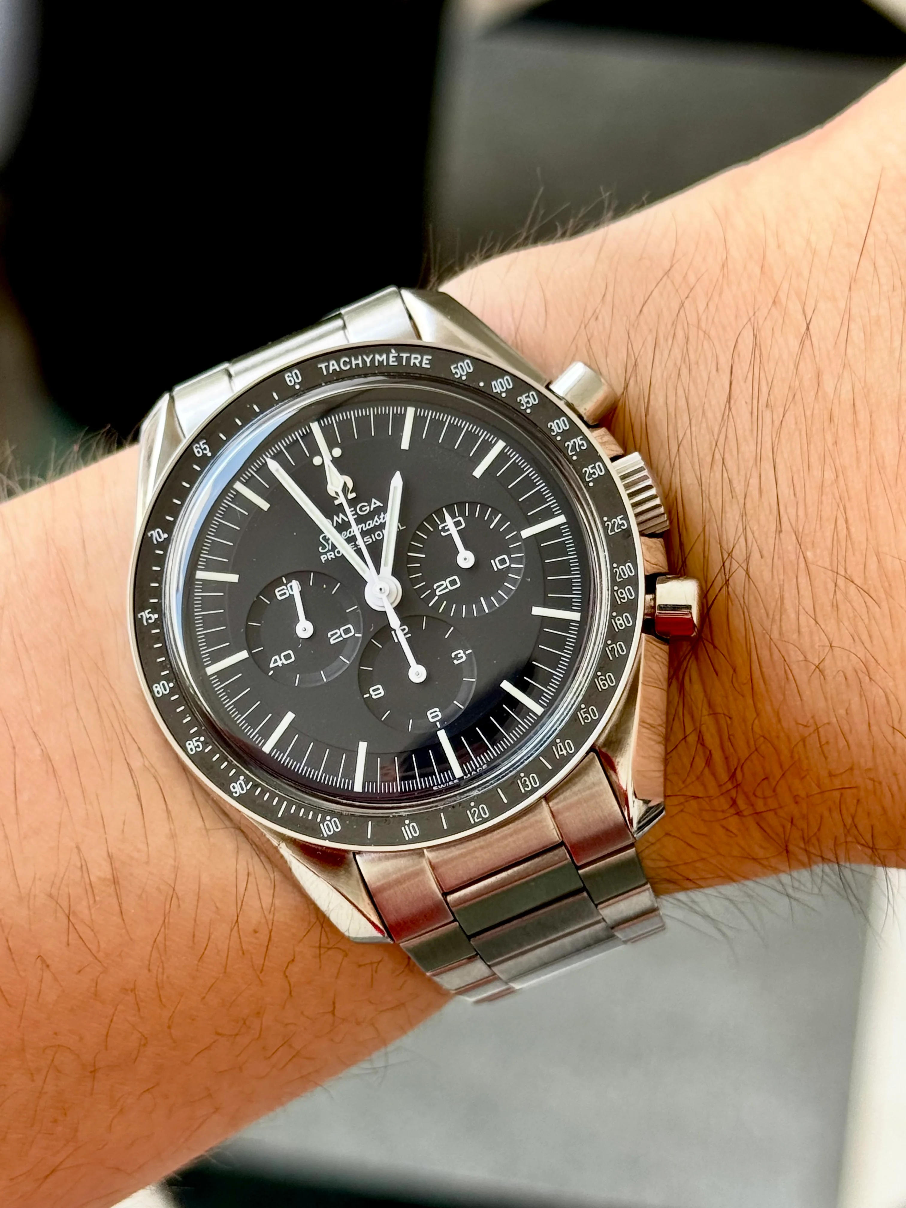

If you ask me, Omega got the Speedy Pro design right first time in the 60s and has never been able to replicate it since. Bracelet is a fully-brushed Forstner flat-link before my wallet recovers enough to get either the Apollo 11 50th with appropriate old-logo clasp or the ’57 flat link with microadjust.
The step dial isn’t very obvious, but it’s nice to know it’s there even if you don’t always see it. Strap is a Strap Atelier Buttero leather strap.

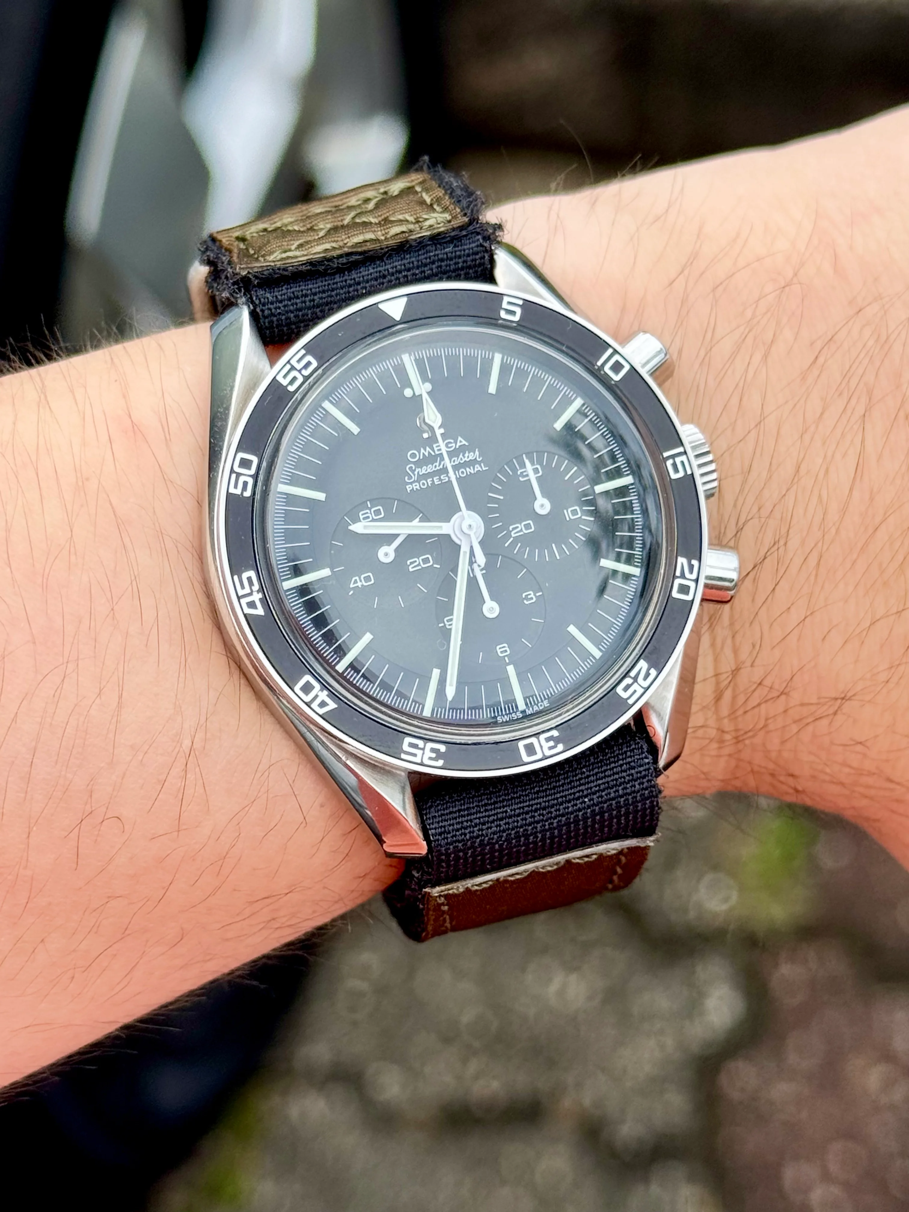

Are you really a Speedy owner if you don’t at least try an astronaut-spec one? Strap is the short Apollo Velcro from Kizzi with the Radial Project Apollo 15 radial bezel.
