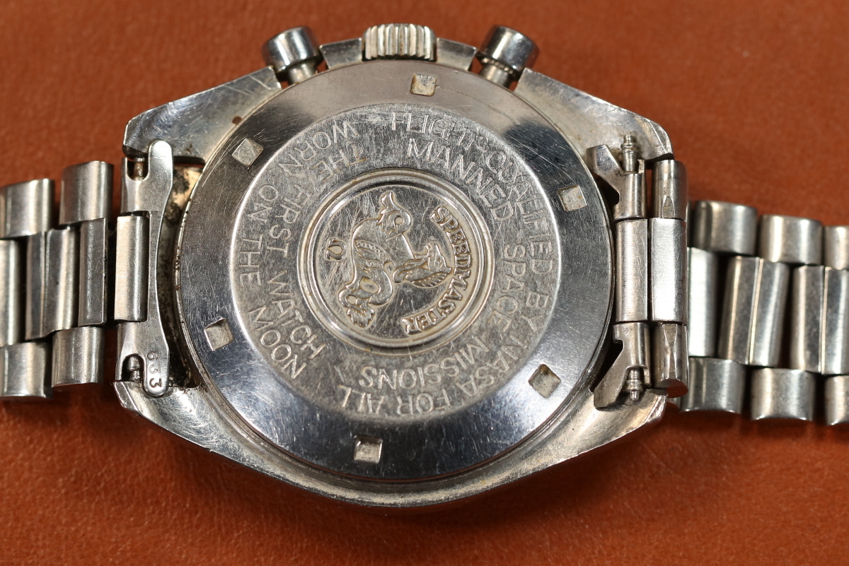

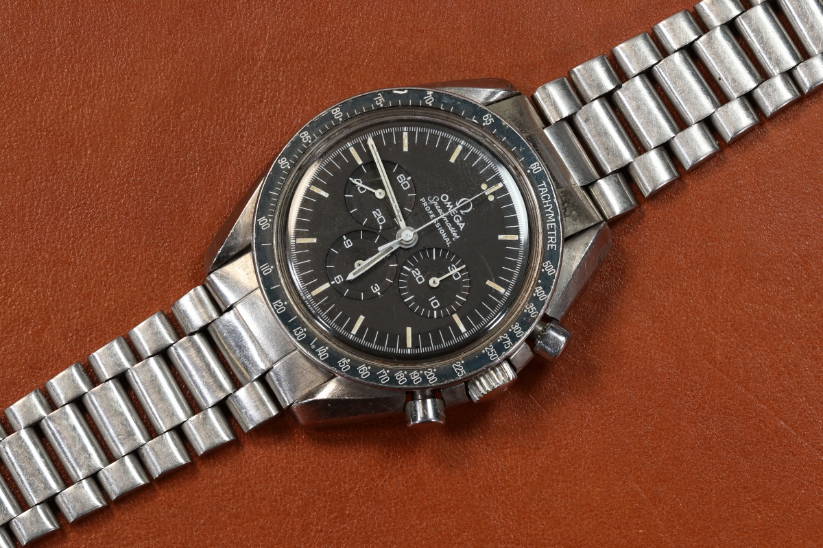

This just arrived from an Australian family, a well worn and used watch:
It is filthy and used.

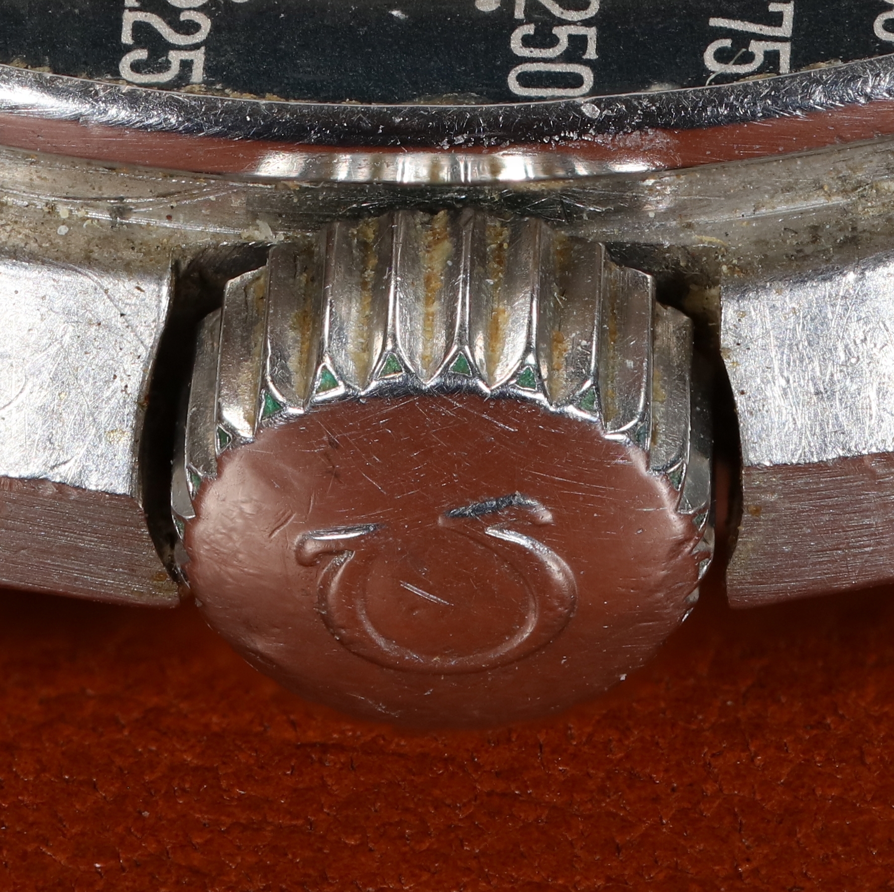

Look at the crown:
There are some other issues too...

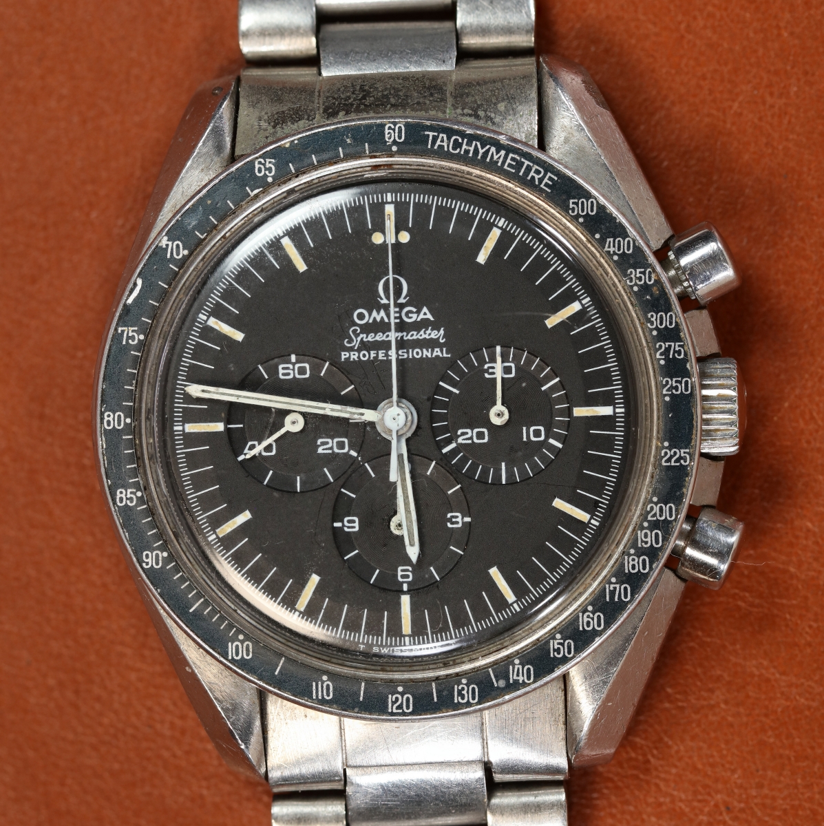

First lets identify the watch, then the issues.
From what we can see, (which was all I had to base my offer on, no movement shot).
1. A domed dial, with no step. The "S" does not descend to the tail of the "P", indicating a -74 or 76. T marks, short indices and professional.
2. Asymmetric steel case with stamped medallion and engraving.
3. Dot next to 90, with tall TACHYMETRE letters.

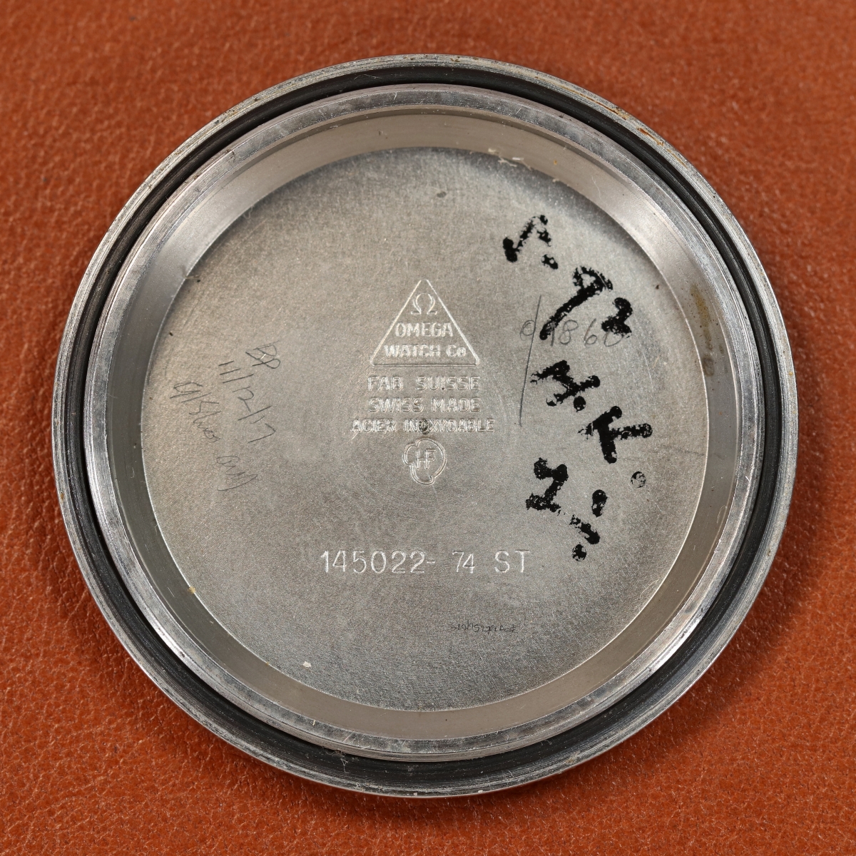

So I am expecting a calibre 861 and -74 or -76 inside:
(Filthy!) Note the photo above shows only one side of the bracelet has released - the other is corroded in, and in spite of having a hammer and chisel I have found depths of patience and will let Simon Freese do it.

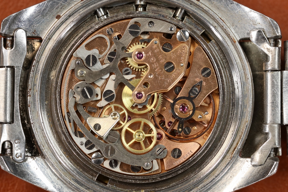

A lovely, relatively intact movement. Often with these family watches we can see extensive screw damage, but not here. Just the apparently obligatory hairs inside.

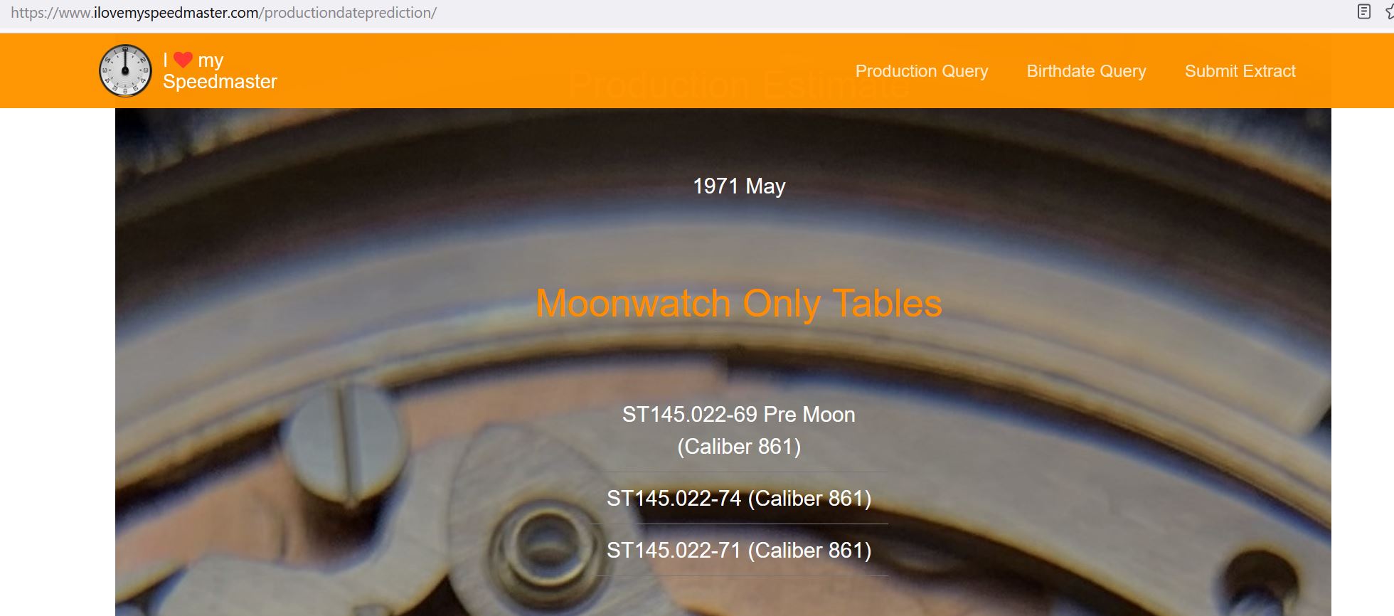

The movement number is in the low range for -74, and I have seen many 145.022-69 Straight writing with this range. I will get an extract and see when it was made. It is possible the case back has been swapped.
A quick check on the wonderful:
https://www.ilovemyspeedmaster.com/productiondateprediction/
And I have this:
Note there is no pearlage in this, some have it, some do not. Plenty of service marks, which makes the excellent movement condition more remarkable.

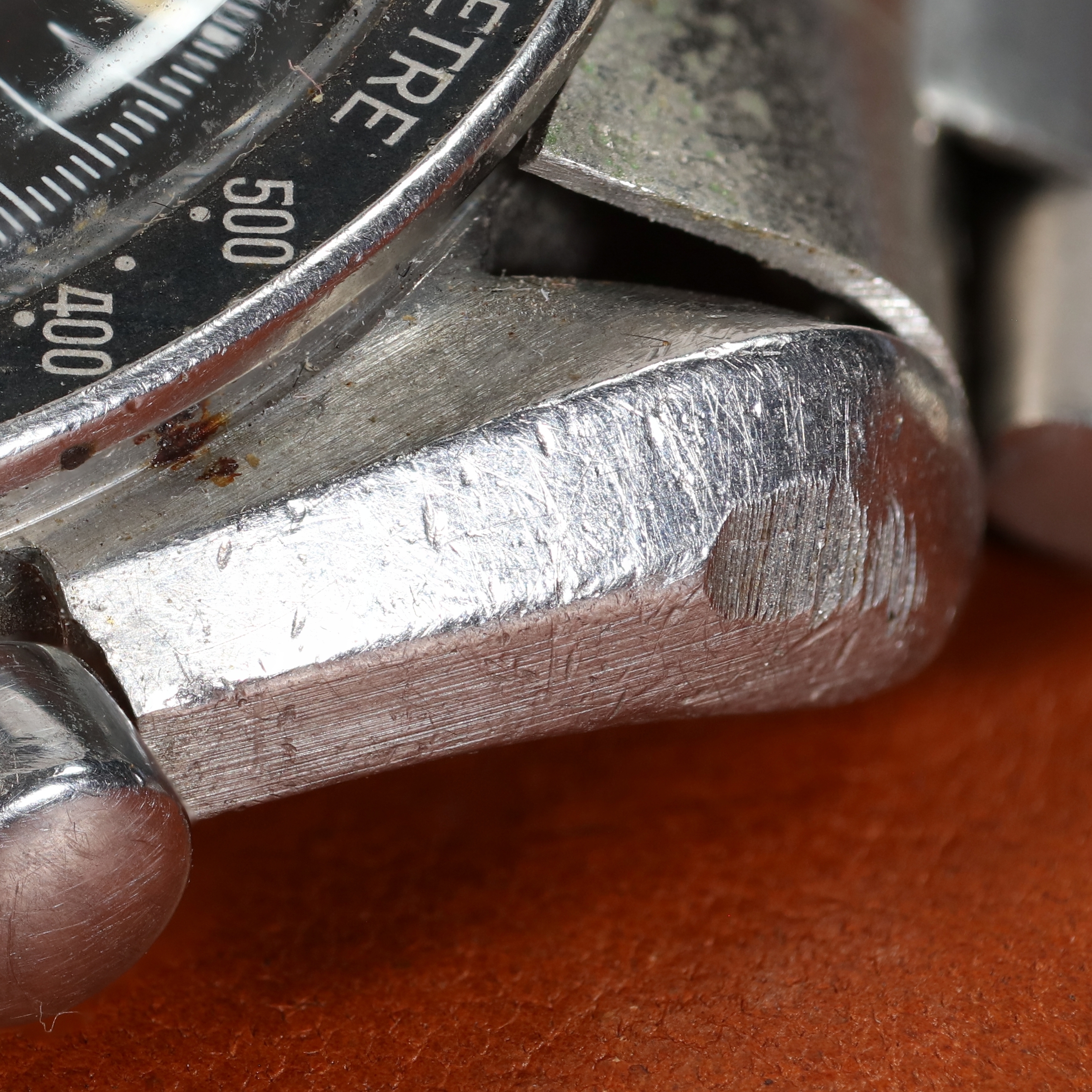

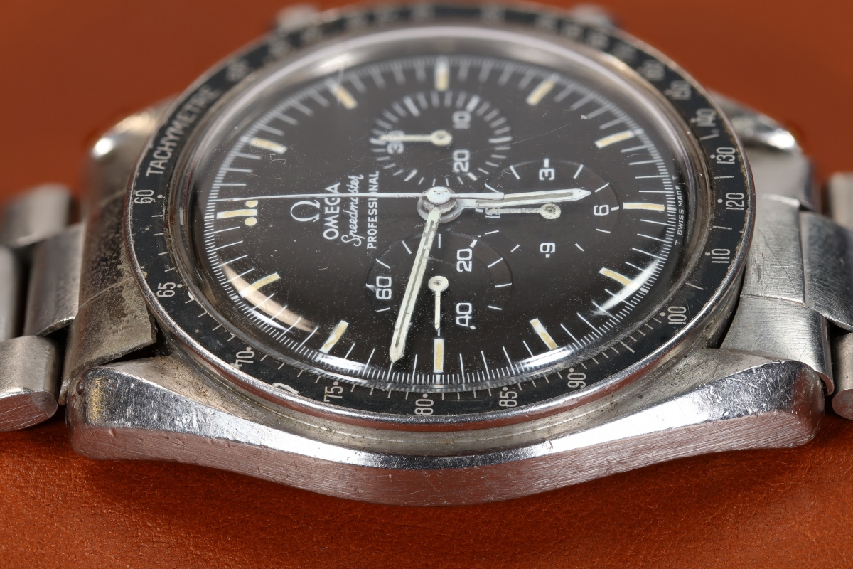

Major case damage, though otherwise un-messed with:
Not much to do with that. It is priced at a level where I can accept this as a part of the charm.

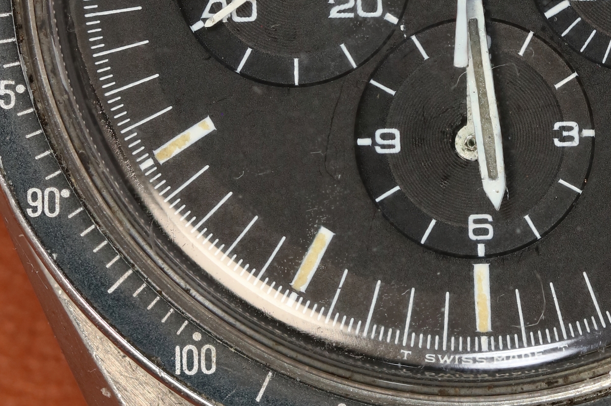

The dial:

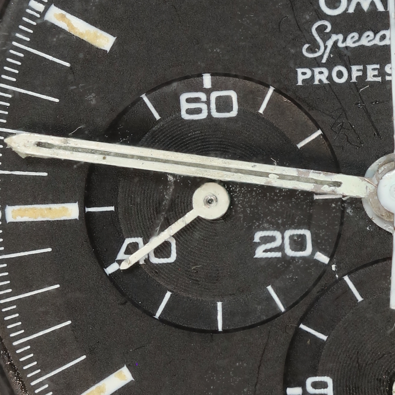

Now this mark, headed downwards across the 40, had me worried. However, I can now see it is on the crystal:

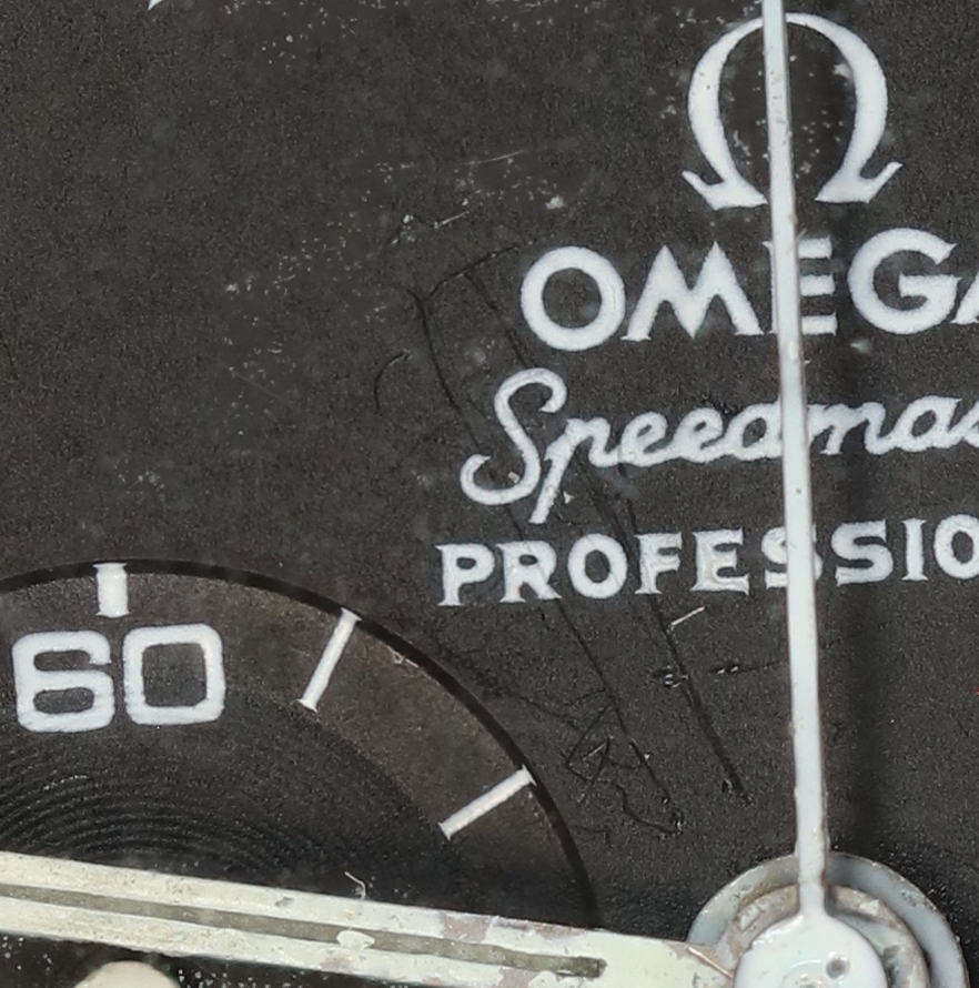

There may be a lot of debris on the dial, which I am hoping Simon can remove. I have no plans to adjust the lume.
There are also some scratches on the surface of the dial. Not a disaster at this level, but in anything above this level it would kill the watch for me. It is a good reminder to check when buying, as these marks rarely show on sellers photos.

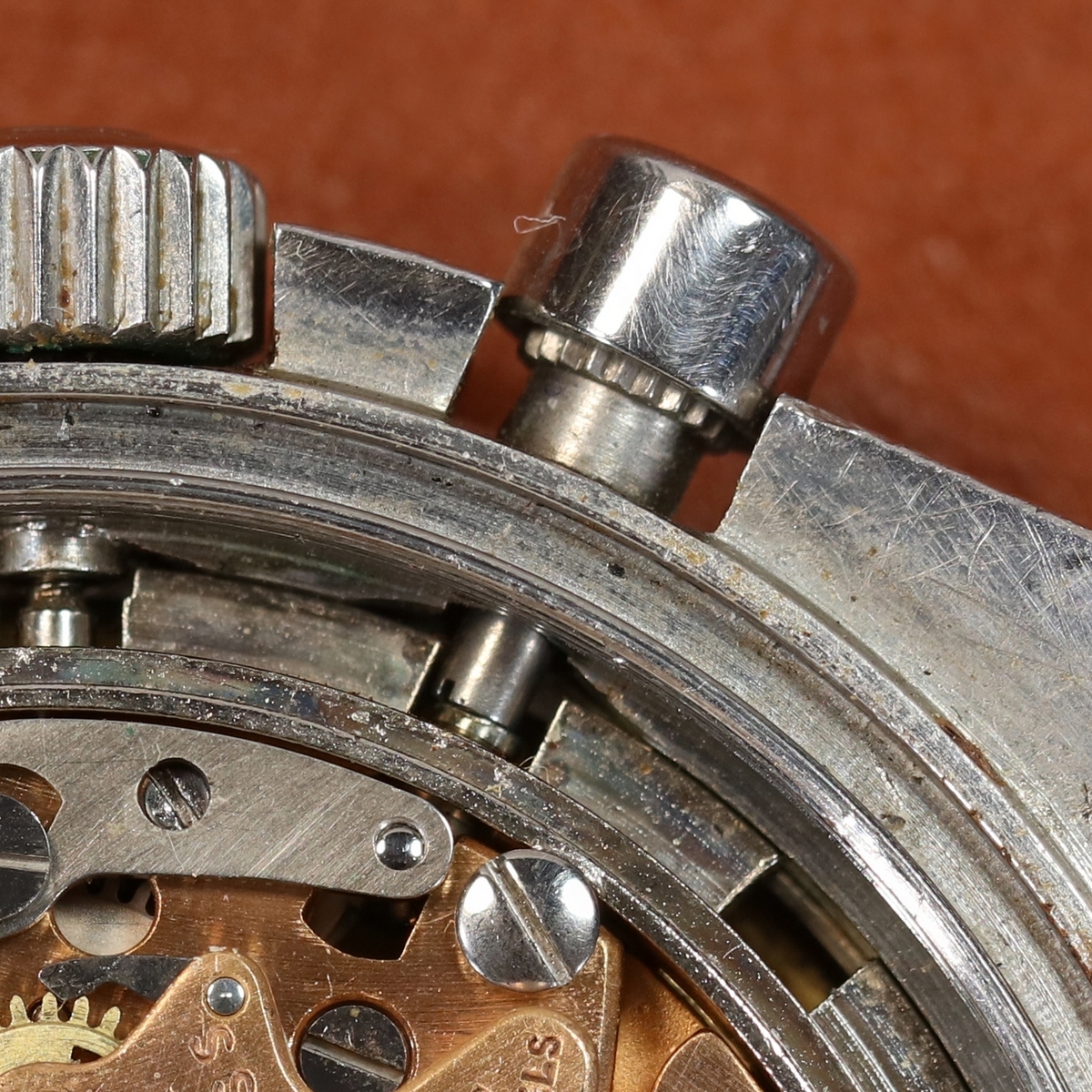

An issue with the pusher fitment :
And of course I have to fit a correct square end Chrono hand.

This Speedy has an awful amount of damages here and there. Despite this, I find the watch having and incredible charm, probably due to the fact that was really, really used. Probably the only thing that bothers me are that deep damages on the dial🙁
@Spacefruit , are you planning to have the case repair/repolished or will you keep it as it is?
5,365
24,500
In my experience, the improvements by simply servicing and cleaning will be immense.
The only way to repair that dent in the lug will be to laser it and then re-finish the entire case. That will change the entire character of the watch and leave me with a reconditioned case Conflicting with the rest of the watch’s condition.
My plan is to do as much as possible to it without severe intervention.
That means servicing the movement and cleaning everything, refitting correctly the pushers. I also have high hopes for improving the dial by simply cleaning and removing the loose material and it is possible we can reduce the effect of those scratches which by the way are barely visible under normal circumstances.
Remember my background is diamond grading, and my habit is to go in under severe magnification, then change the lighting until whatever I have found is highlighted. Kind of the opposite of what a seller wants to do. (Compare my photos with say, Phillips who in my opinion are the best auction photographers).
My photographs fiercely critical and part of my assessment process. Most of what I find many people won’t notice until I tell them. Those dial scratches for example are minimal, and you can’t see them with the naked eye.
