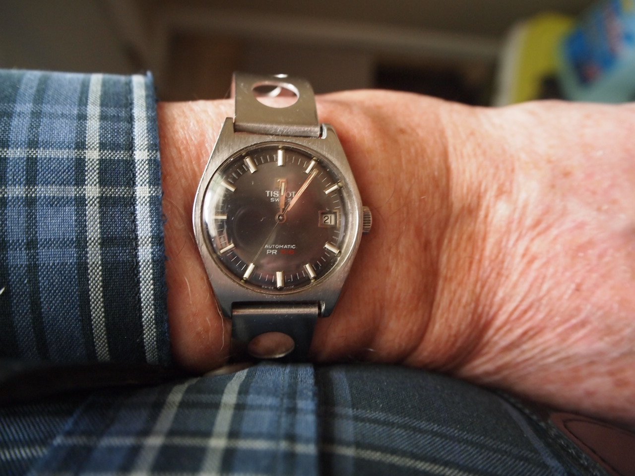

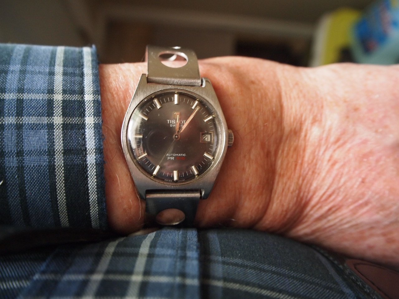

I have a couple Tissots……….made before Swatch Group got their hands on the brand.

That bracelet looks good. How comfy is it? Your observation about the plastic movement is similar to mine when I see “Genuine Leather”. Genuine Crap is more like it.

That is the most uncomfortable, stupidly designed, most difficult to manipulate of any bracelet I own! Thanks for asking.😉

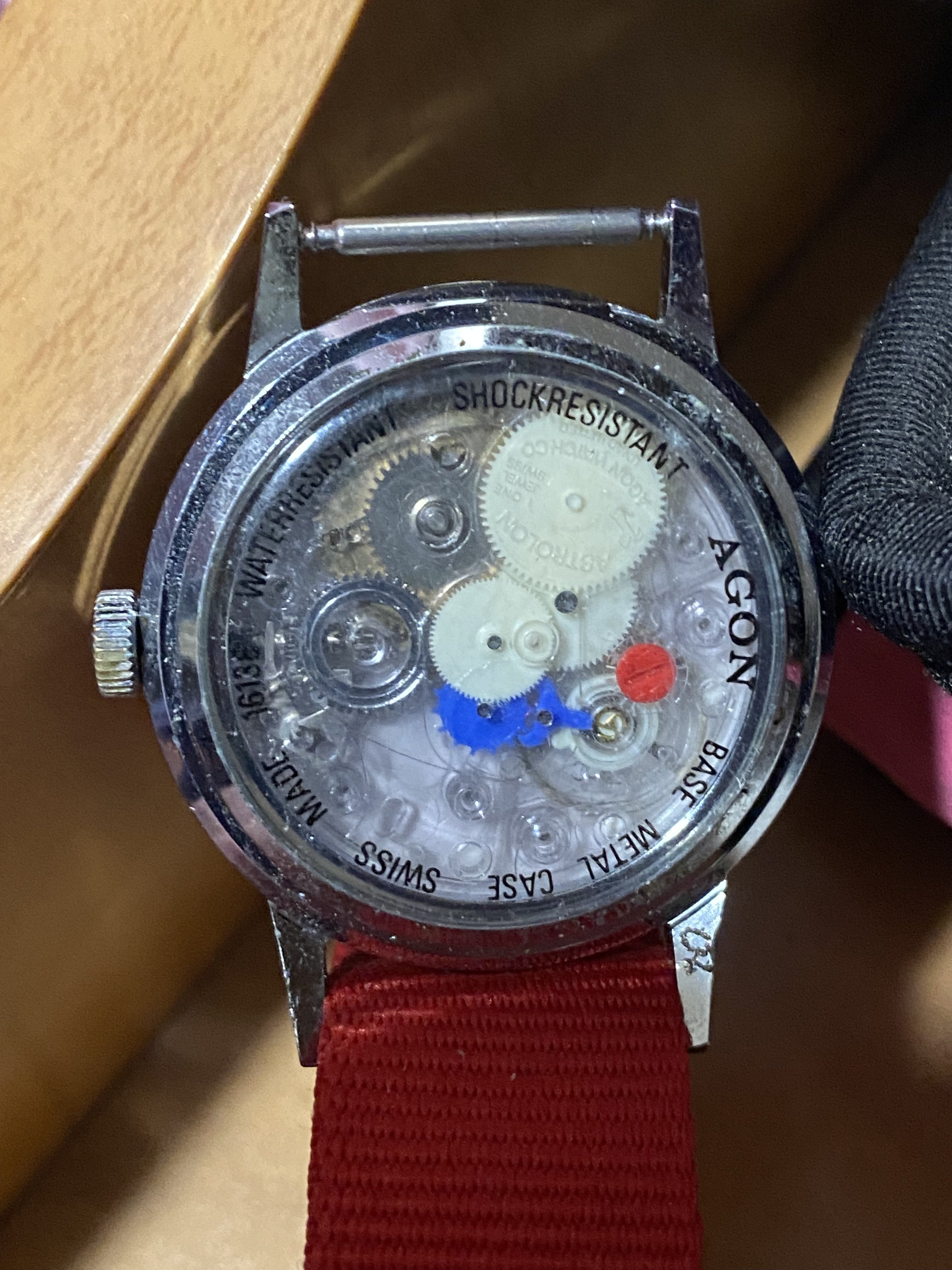

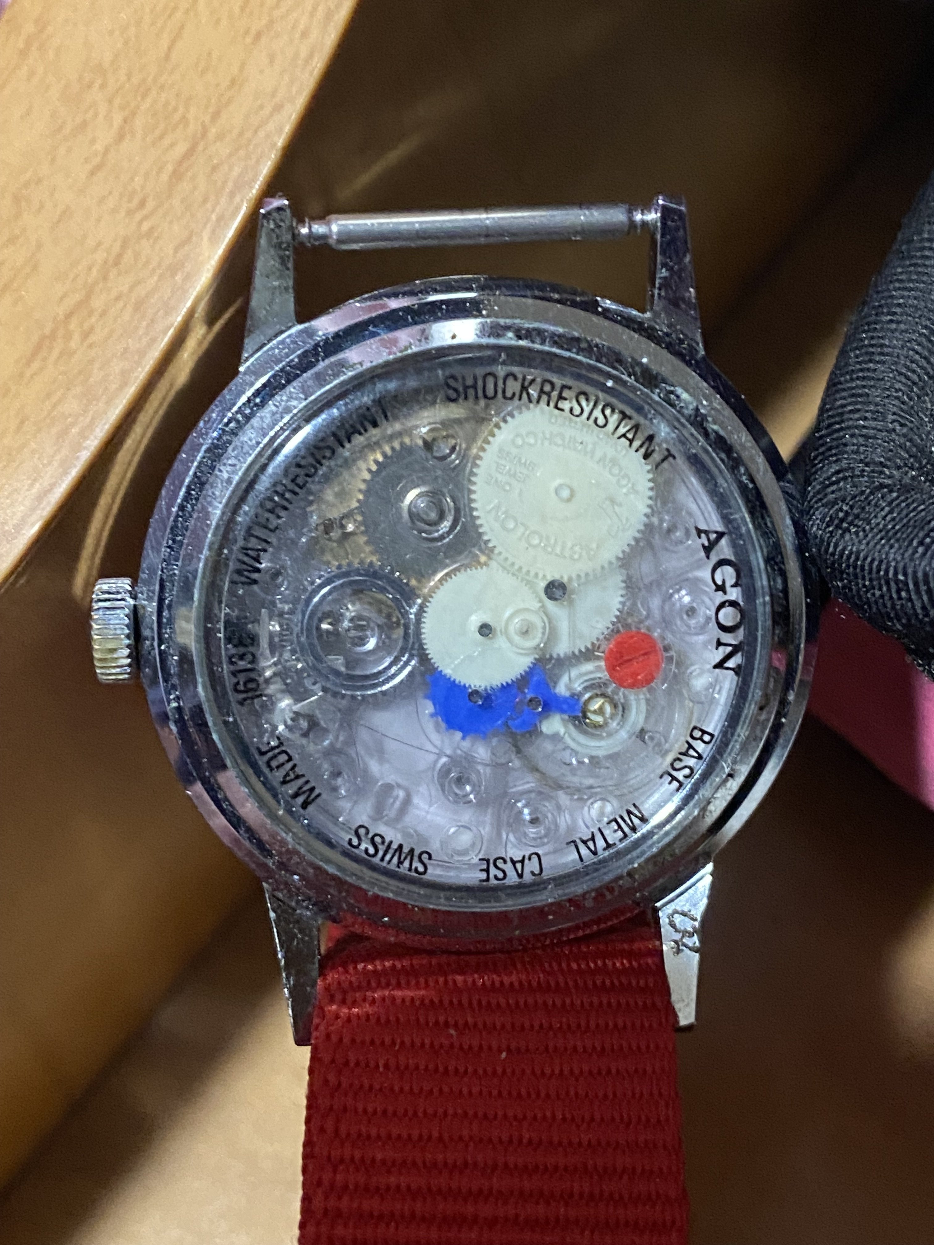

Astrolon here
30,293
78,219
Astrolon here
Nice! I always get a kick out of the “How dare Tissot start using plastic in these new watches!” outrage posts, when this beauty was made by them 50+ years ago...

Thanks! Pretty much NOS when it came in from Switzerland and it is a decent runner. Keyless works a tad wonky as it’s tough to set time and have the minute hand wind up where you want it.
