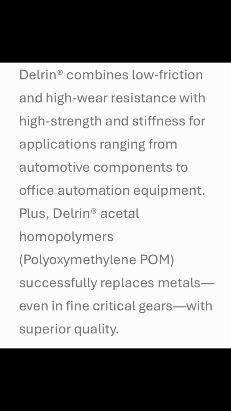

Yes, Delrin is a thermoplastic (a polymer). It's quite durable and in some use cases probably better than steel. Iirc from what has been said in the past, some speedmaster movements use it as a brake/blocking lever instead of a steel part.
Thermoplastics definitely fall under the category of "synthetic materials," but that doesn't mean inherently bad. Some see the term "plastic" as slanderous.

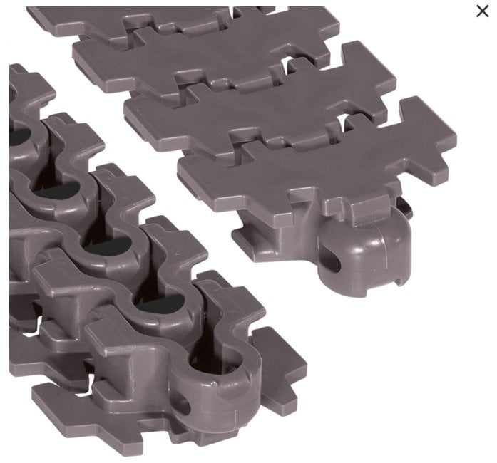

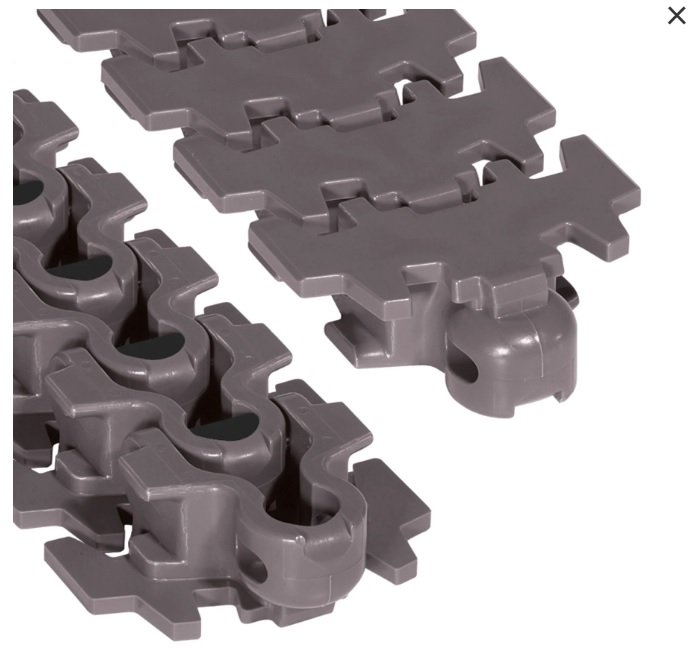

Back before I became a watchmaker, in my engineering days, I had a lot of material handling projects, using flexible chain conveyors. The chain looks like this...it can go uphill, down hill, around corners, etc, so it was very effective for the types of product that I was tasked with conveying between different machines tools and testing equipment...
The frame of the conveyor was made of steel, and between the frame and the chain we used a wear strip that could be replaced. The standard material in the industry at the time was UHMW-PE (ultra high molecular weight polyethylene), but that would absorb the cutting and honing oils that were still on the product, and they would swell up, jamming the conveyors.
The solution was Delrin wear strip - I used miles of it on conveyors back then...

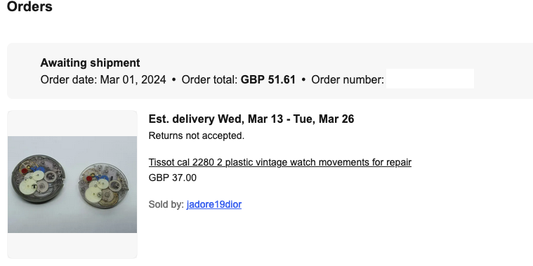

I hope it does come from Finland and not Moscow. Interesting that the price was in UKP. The seller accepted my lowball offer. (probably still to much.) Not sure there is a real demand for these. Still it has been on the bucket list ...
Curious though, when I check the sold listings on eBay, it shows what the seller offered. Not my counter offer that was accepted. It is also interesting I have to click worldwide to see the sold listing.
