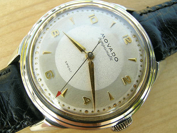

late 30's early 40's date windows & slightly similar dial layouts Movada's & Zenith watches ..
I'm not so sure. Can you post some pictures of similar dials from the 40s or 50s?
so unless ETA copied a revolutionary Milus movement it must be post war
It's very unlikely a new and small watch company could be so revolutionary but no one has heard about.

Vintage triple date watches are easy to find on-line, then of course there is the 1945 DateJust
That dial is very different in style to your watch. Hands, numeral and arrow markers, and surface finish are all different. They are certainly a decade or more different.

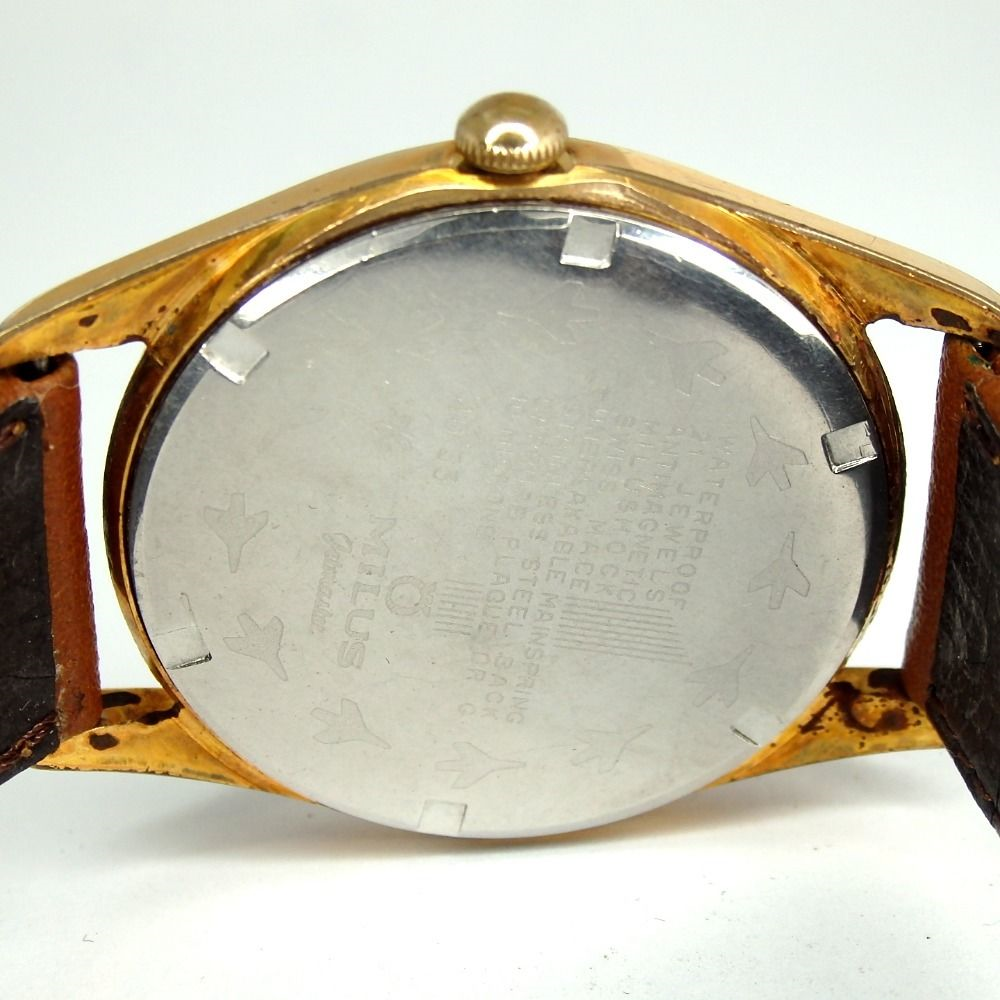

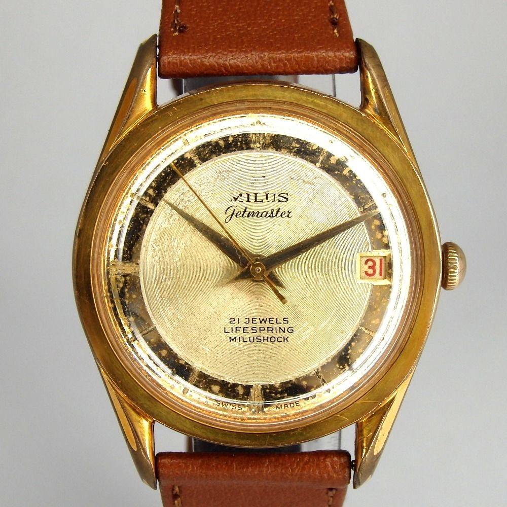

Milus Jet-Master .. Looks like it kind of kills off the last hope of the Snow-Star even coming close to the date needed
Very strange that a company that now sells $250k time pieces didn't work that out ... Well they certainly ran with it, I think the 2000 limited edition Snow-Star Heritage kits netted them close to $9m in just 2 years. Slight loss for me as I know a pair Atlantic/Pacific Barter kits advertised as WWII sold for $15,800 recently

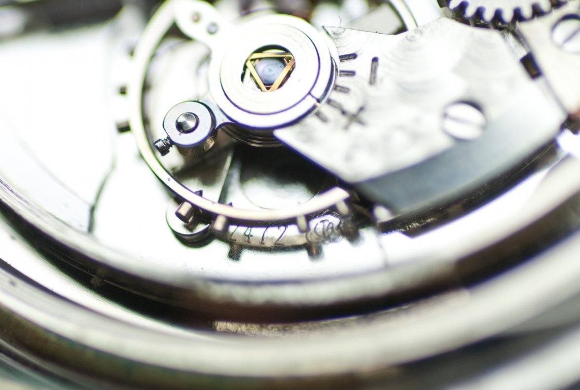

Any clues in the shock protection? My best guess is Novochoc B (old version maybe). There are a couple others I found that are roughly triangular.
Not that I've found much info for dating that, but all other photos of 2408s that I've seen appear to use Incabloc. Hopefully we'll have another example to compare.
2,876
1,962
The shock system can be custom ordered with ETA. I've seen the Novochoc mostly on lower tier brands. I guess this was chosen so it could be called Milushoc, whereas Incabloc costs more and cannot be called differently. Both types exist in vintage Milus watches.

Here's a couple of pics of the eta 2472 housed inside
