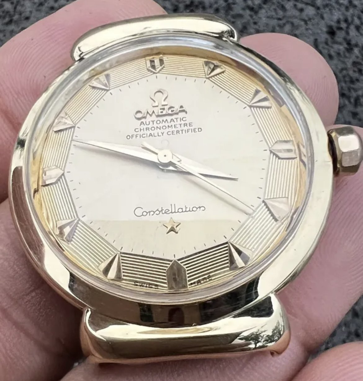

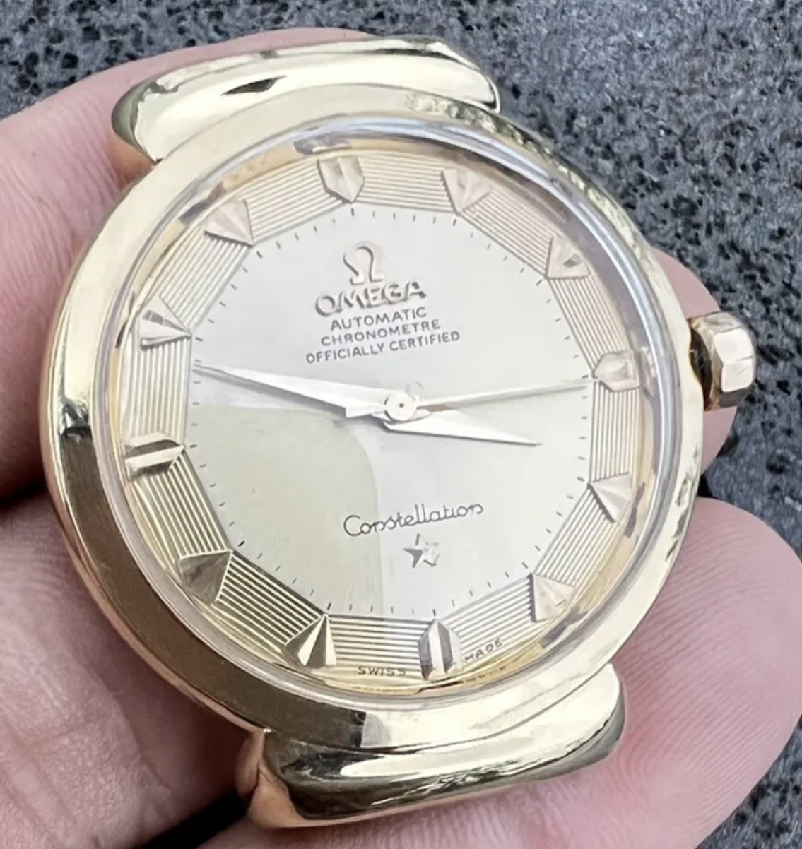

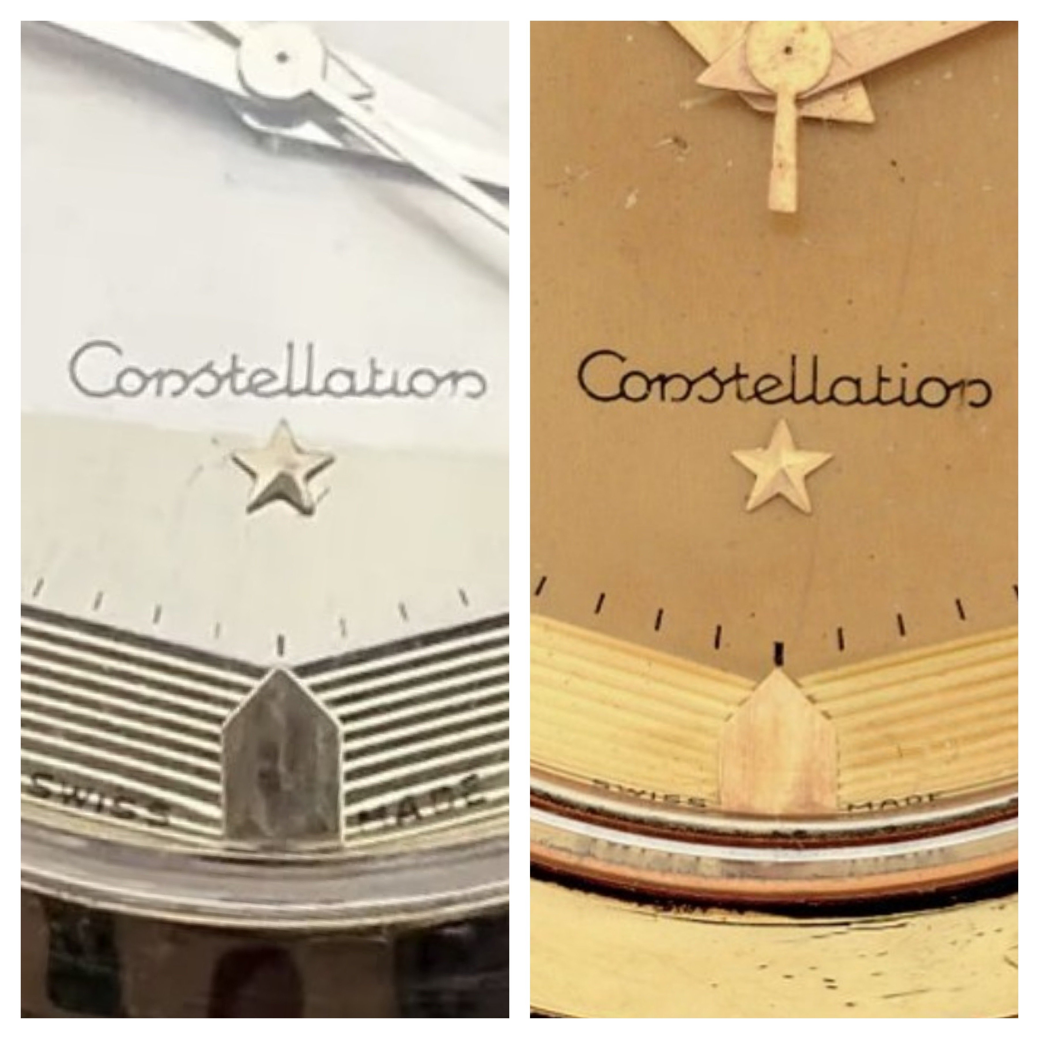

I’m curious what the experts think of the originality of this 14355SC esp the dial?

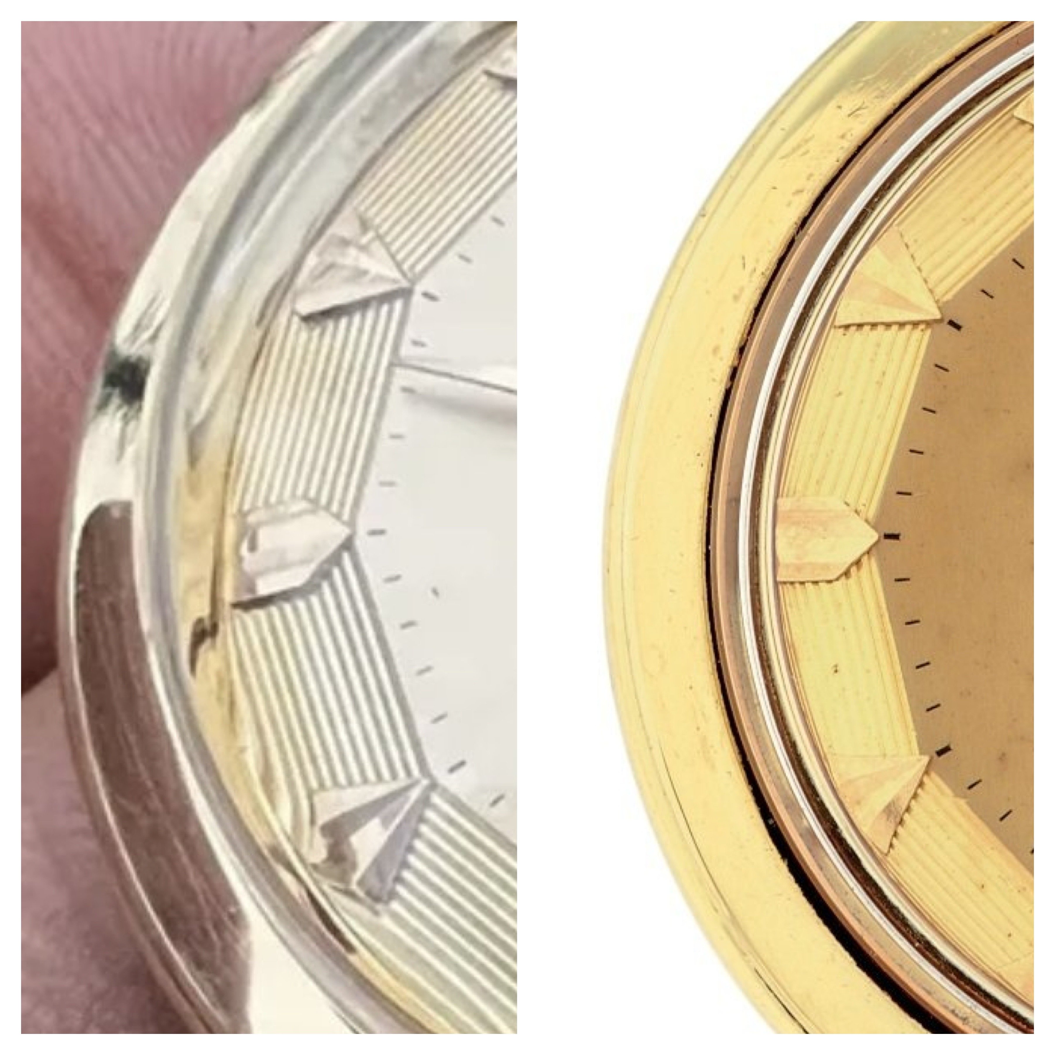

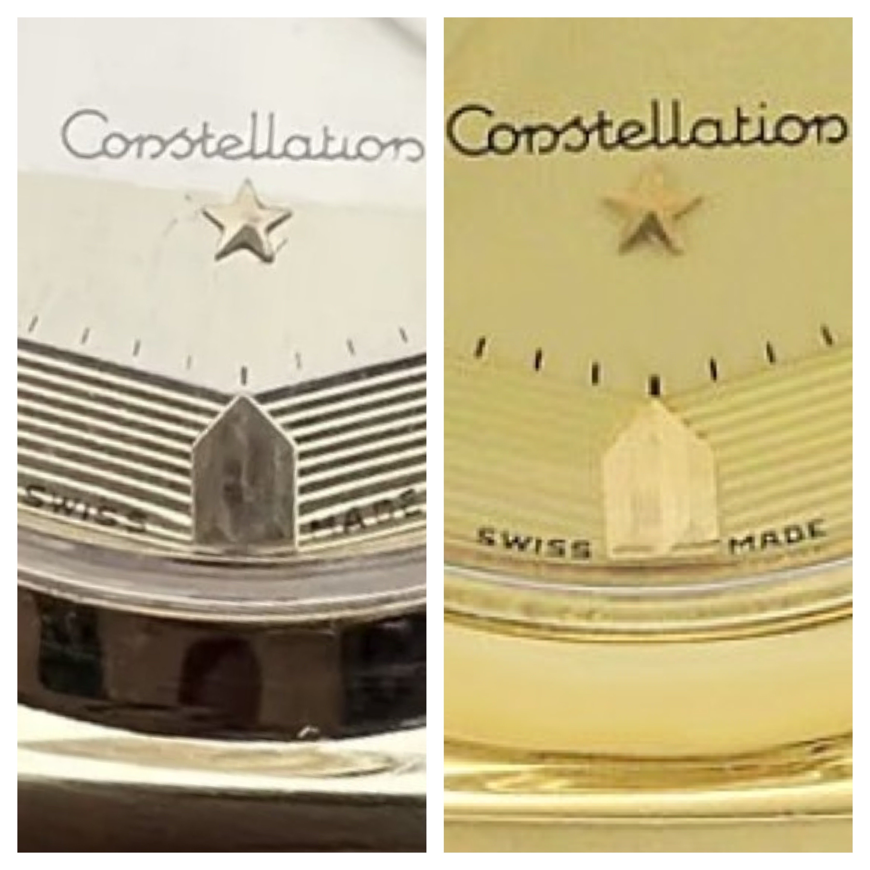

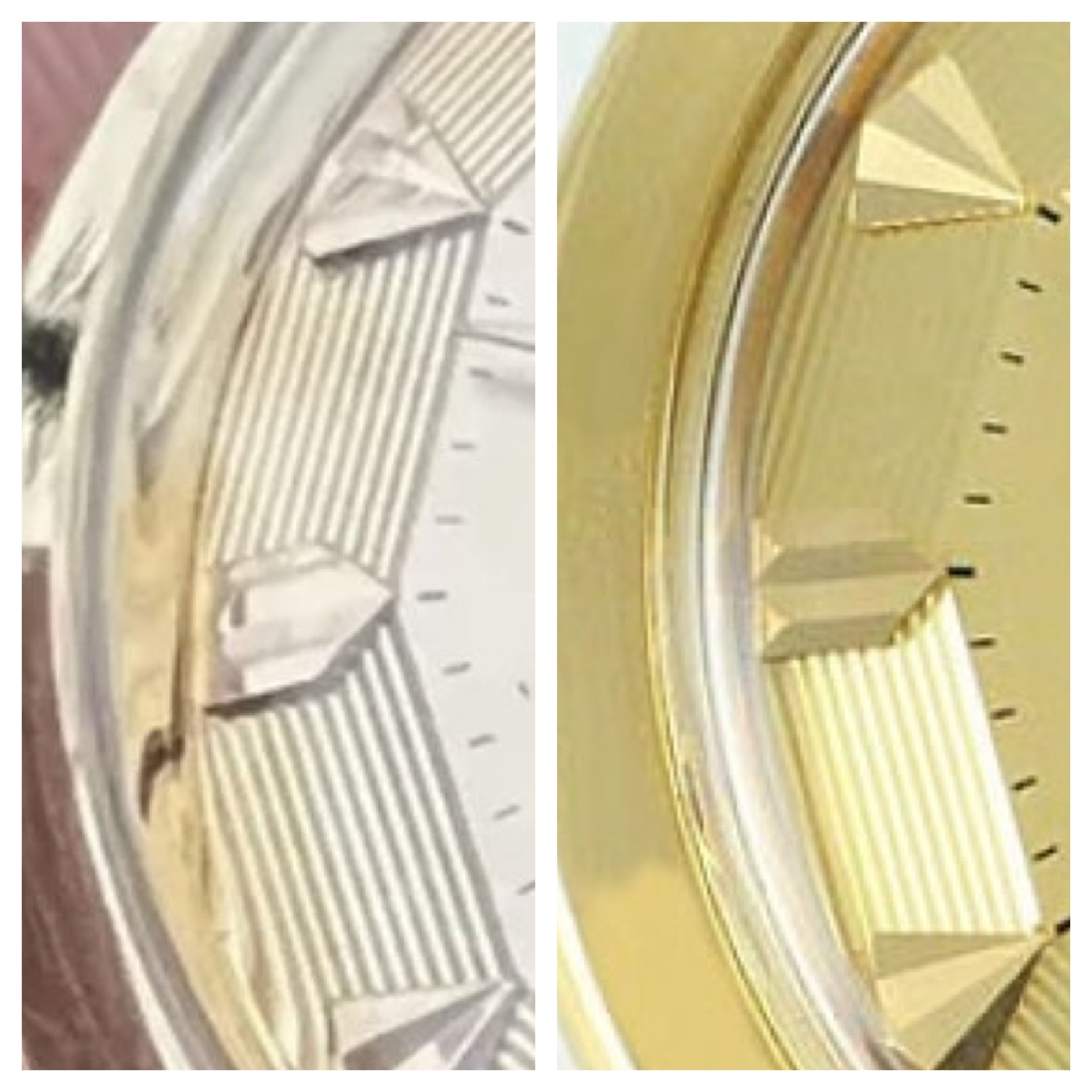

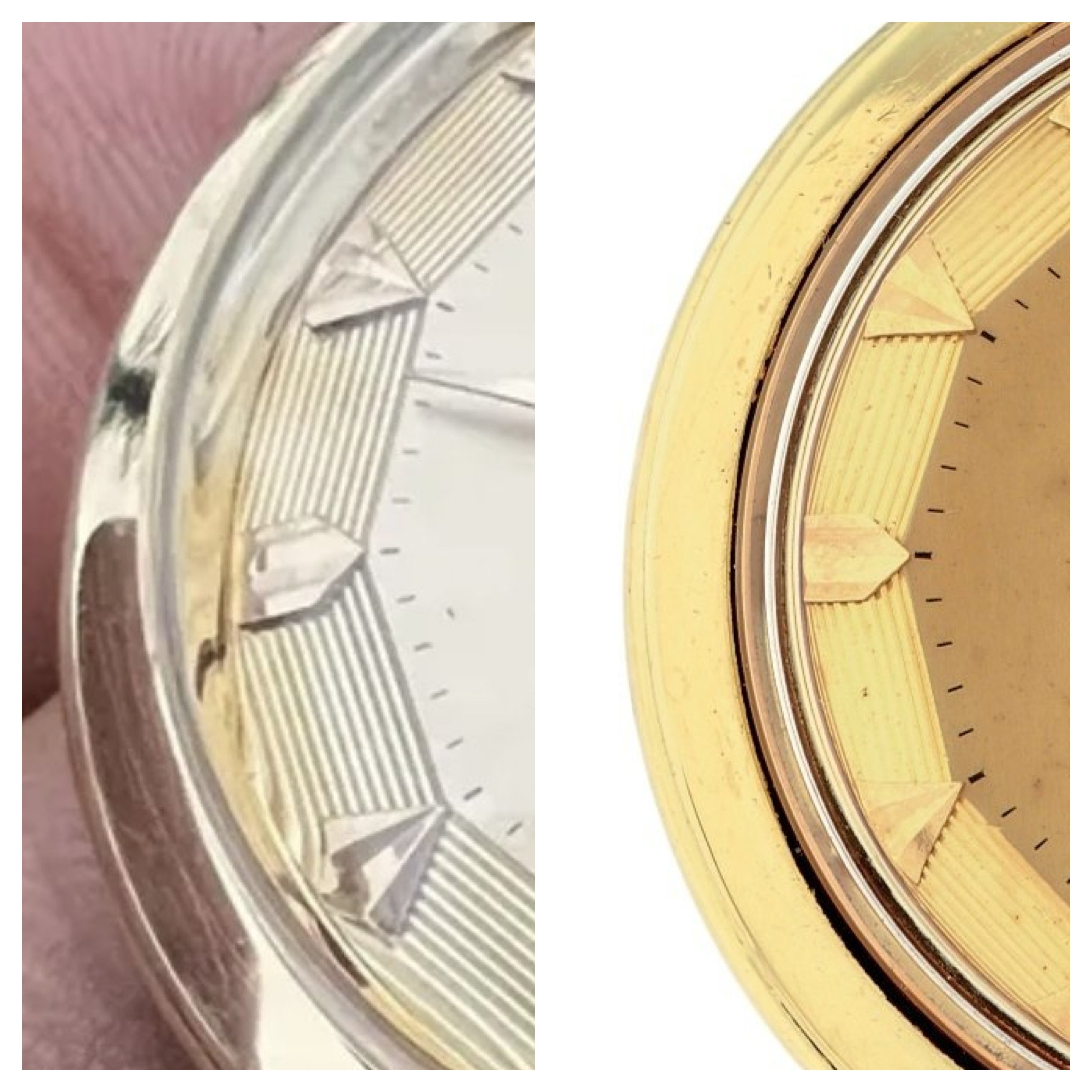

I saw it too, but I have doubts. The gap between the tip of the arrowhead markers and the minute ticks is larger than usual, I think it might be missing one step, Swiss Made looks off.
Compare to two examples that I believe to be legit, with your example being the one on the left, and focus on the points mentioned above:

I am not an expert on the model, but broadly speaking, when photos are over-exposed, they often mask flaws. Sometimes this is done intentionally.

Impossible to tell for sure from the pictures. There is an issue with the crystal on the watch in question.
I would want to see the watch in person to make that judgment.
