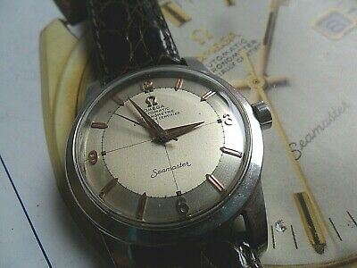

Posts 13,674 Likes 19,043 gatorcpa ·May 30, 2021·ΩF InvestiGator I think there is nothing wrong with this watch and you will have competition in the bidding. Good luck, gatorcpa

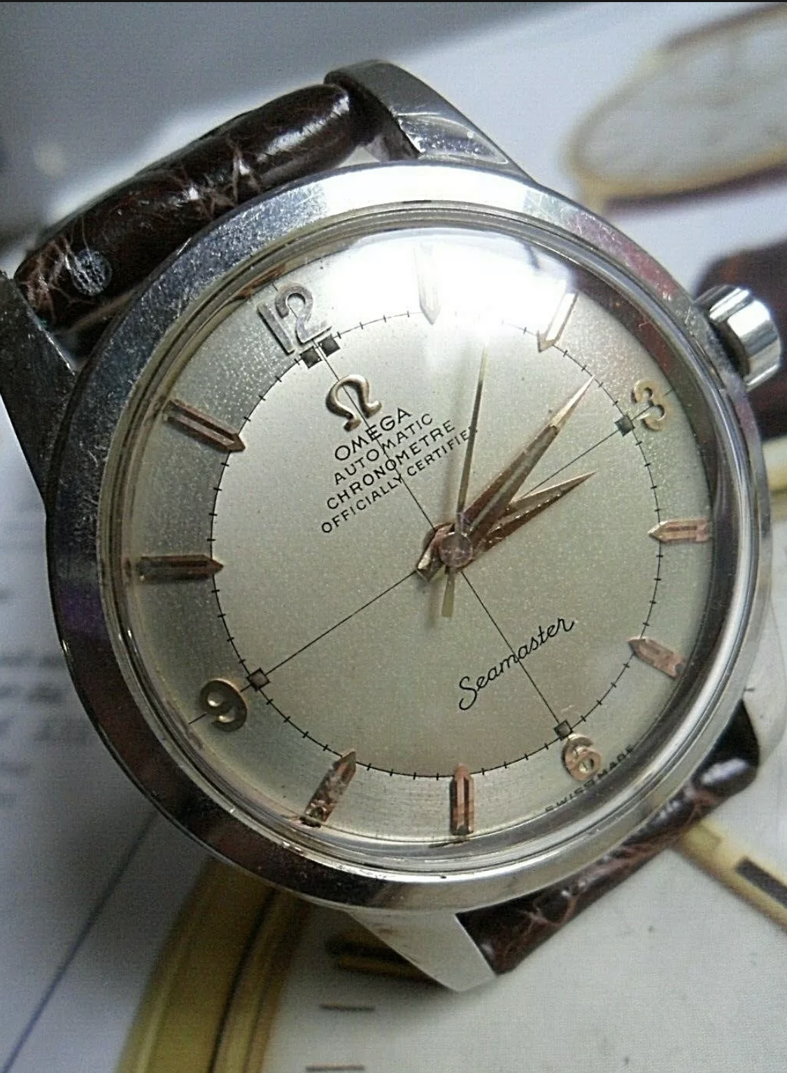

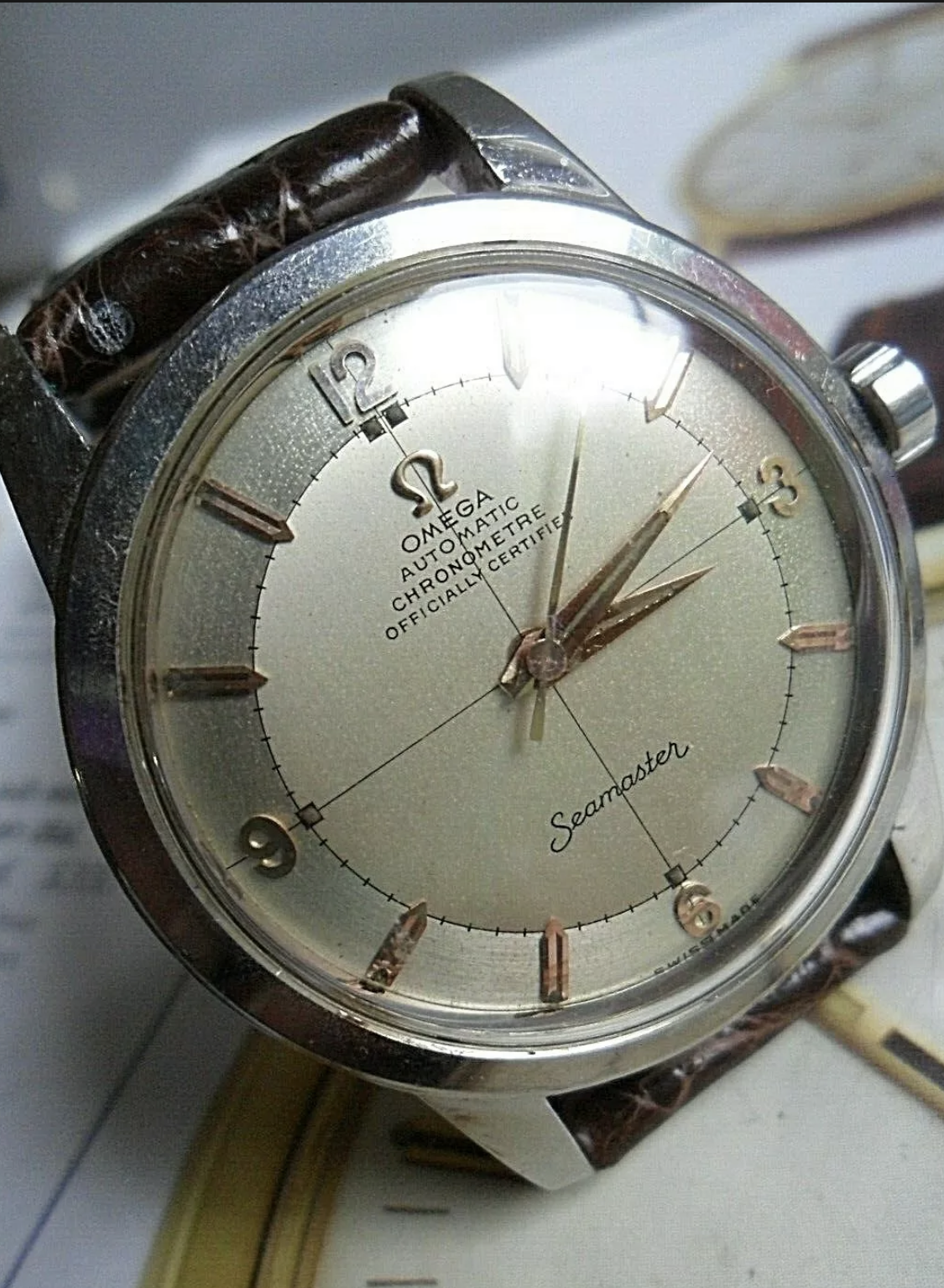

Posts 2,346 Likes 1,475 DON ·May 30, 2021 My opinion. Case and movement look fine. Dial appears to be an old refinish. A check of the reference and other two toned dials. Show the minute markers sitting on the inside of the dial and not extending to the outside color. Only one I did find that was similar was also a old refinished dial (no luminous in the indexes and too clean) In this image. Center color looked to be brushed. Faint lines in a down/up finish Again. My opinion DON
Posts 13,674 Likes 19,043 gatorcpa ·May 30, 2021·ΩF InvestiGator DON Dial appears to be an old refinish. I respectfully disagree. But if you’re right, I’d send all my redial work there. The fonts are perfect. gatorcpa

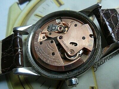

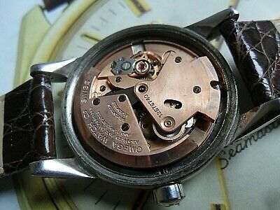

Posts 3,237 Likes 6,783 Fallout Boy ·May 30, 2021 jeppe888 how high would you guys go for the watch? Without loupe-check and with this bumper-movement: max $ 750. AFAIK bumper spare-parts , as the .352 are hard to find....
Posts 5,631 Likes 5,815 SkunkPrince ·May 30, 2021 Fallout Boy AFAIK bumper spare-parts , as the .352 are hard to find.... Some yes, some no. Fortunately the balance staff is easy to get and the auto mechanism's holes can be bushed if they're oval.
