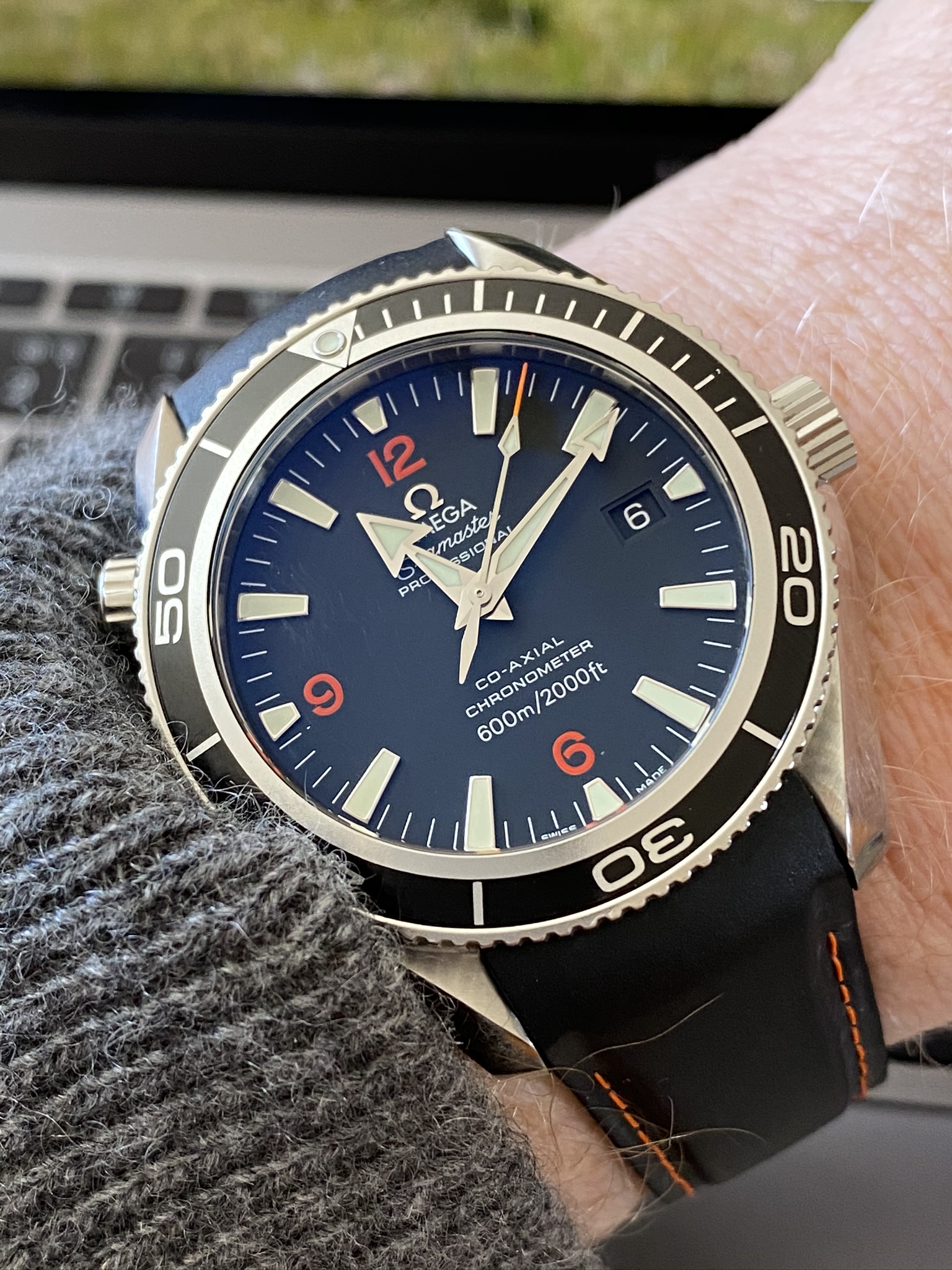

Back on my wrist today, been sat in the safe for a while. Bought new in 2008 for my 40th, continuous wear for 10 years until a speedy for my 50th, will treat it to an overdue service this year.

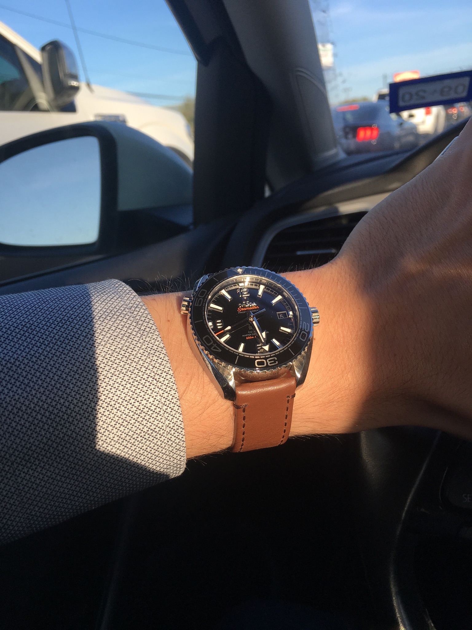

2019 PO 39.5mm in traffic jam, a bit of a retro look with leather strap. I have 6.25” wrists.

How have you found the stitching on your strap? I've got a 2017 model of that watch and wear it everyday, however, I am seeing some fraying with the stitching?

Stitching is still perfect on mine, bought on bracelet and added the strap a few years later, so probably about 8 years wear.

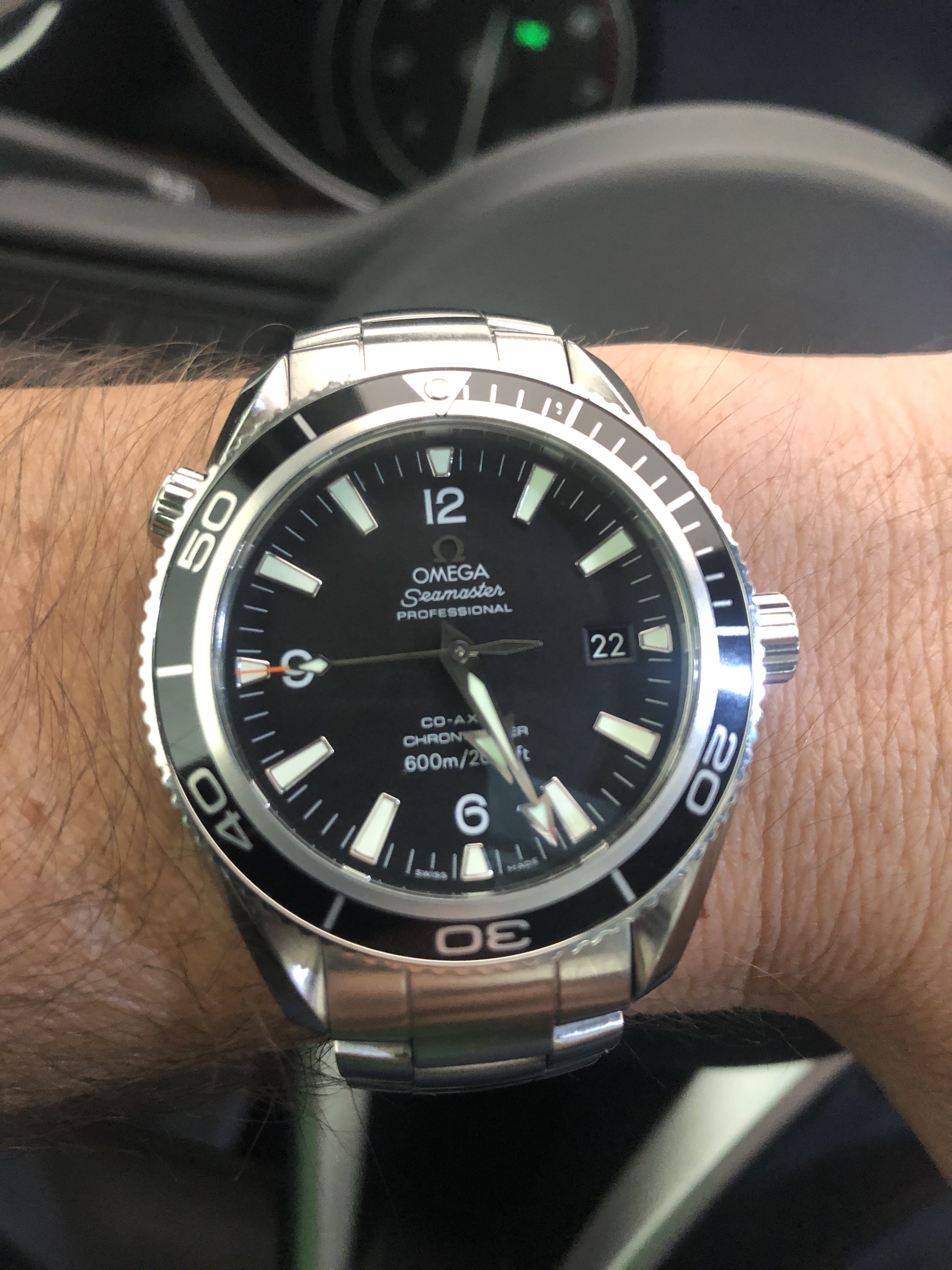

Could anyone enlighten me as to whether this has a Calibre 2500c or 2500d . I have read many articles but cant seem to find a definitive answer,
Watch number begins 8465****.. Photo shows straight 1 & flat top 4.
TIA
Jeeper
easiest way to tell a 2500"C" vs a 2500"D" is the serial number, only watches with the serial number of 8525XXXX+ have the "D" movement. Also the "One" on the date wheel would look like "1" on the "D" series whereas the "C" series would look like " l " (lower case L).

With the "stop dead" syndrome on the C series, OMEGA's answer was to redo the entire escapement, going from a 2 level escapement from the 2500"C" to a 3 level escapement on the new and improved "D" series.
Depends what you mean. Omega doesn't convert a C to a D, but yes the eventual solution to the design issue was to change the design.
For the B and C versions still out there, they are still 2 level but Omega implemented different lubrication procedures to mitigate the "stopping problem" which was caused by a build up of black sticky residue on the intermediate escape wheel teeth and the co-axial wheel teeth. Here it is on the intermediate escape wheel:
I would be cautious taking this as gospel. The way to be 100% sure is to look at the movement, which will be stamped with the version. The next best method is to use the serial number to look up the movement in the actual watch - only Omega or someone with access to the Omega Extranet can do this.
Note that the date indicator font is not 100% reliable - people have asked me to change the date indicators in the C to the one from the D. I refused, but it's possible others may do it without thinking.
