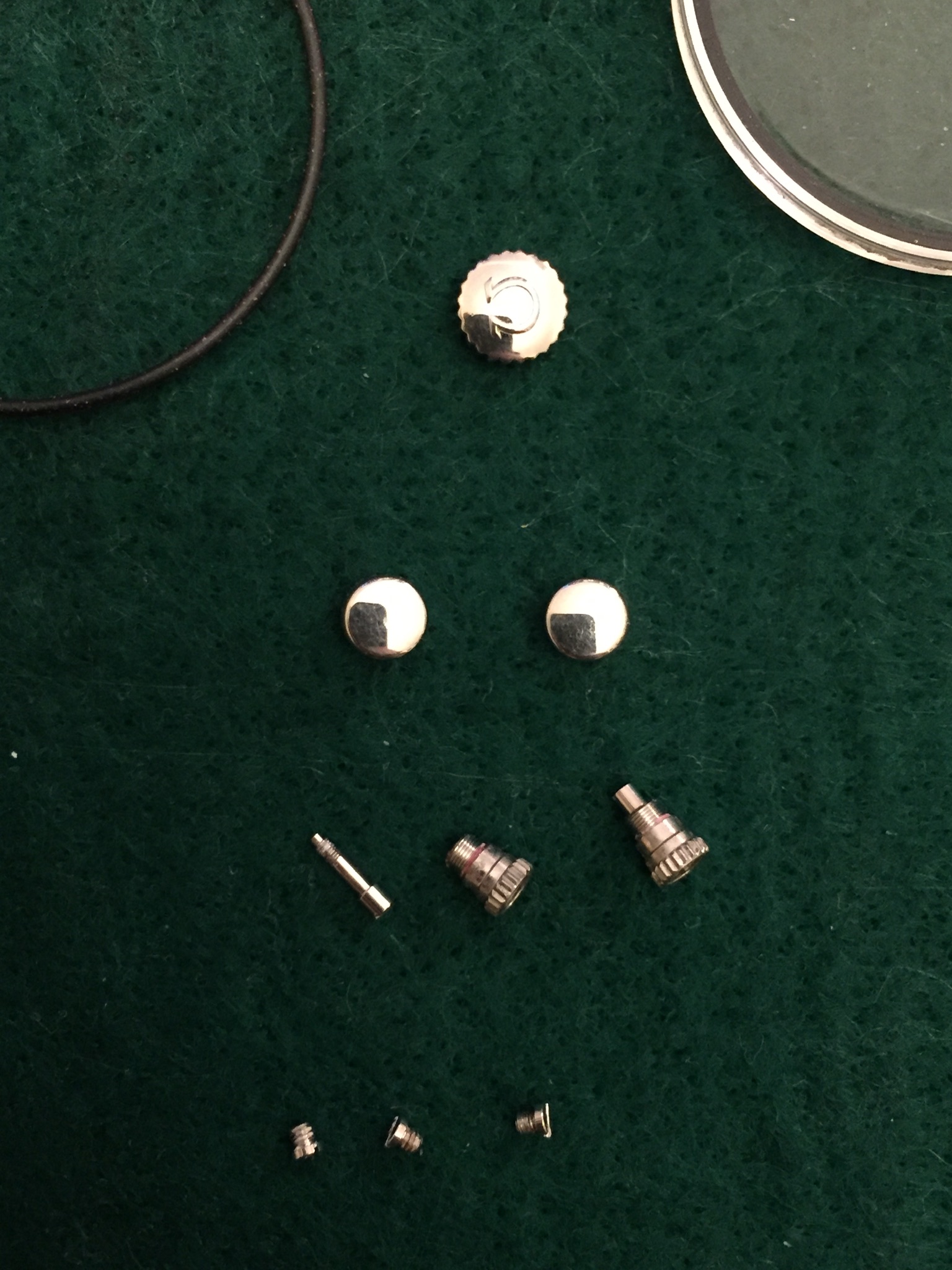

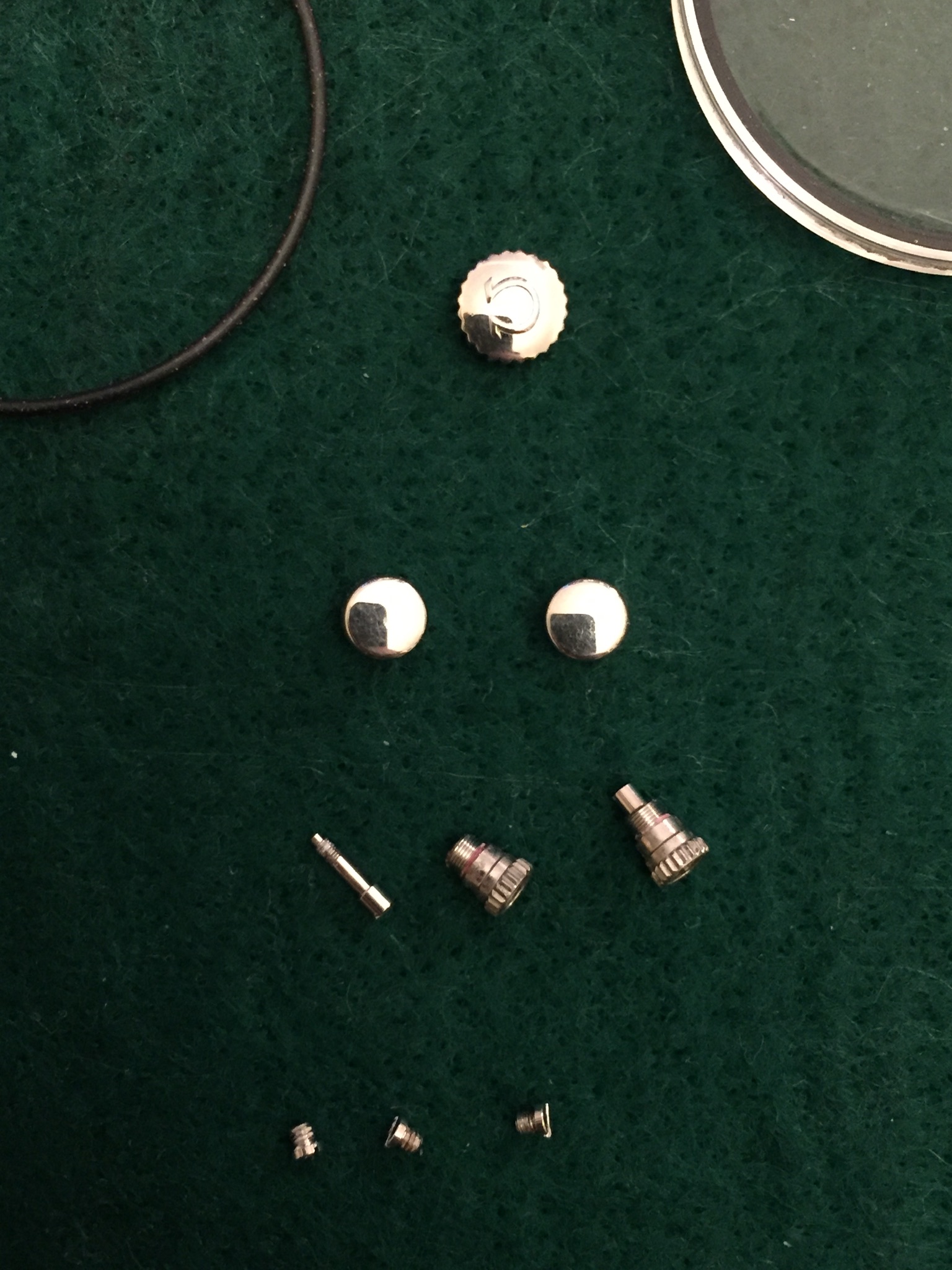

Update… watch is home in time for Christmas! And looking good. AND the pusher hasn’t jammed again!
No word from Omega on the cause of the pusher issue, unsurprisingly, just the standard ‘needed a full service etc.’ They have returned the bits & pieces replaced though - pushers, crown, gasket and crystal… I’m curious to know what the other bits in the photo are/do though, if anybody can shed any light (or explain if they might have had something to do with the original pusher issue)? Otherwise, I’ll shut up, let bygones be bygones, acknowledge this as a need-to-know basis, enjoy the watch and get on with my life! Cheers 👍

Top row is the crown, second row are the pusher caps, third row are 2 pusher tubes, and one pusher screw.
Last row are 3 screws...maybe dial foot screws, but there's only two of those, so not 100% sure.
Maybe the third one is a rogue screw that infiltrated the watch, sneaked past QC, and then ended up blocking the pusher as per earlier photos… 😉
