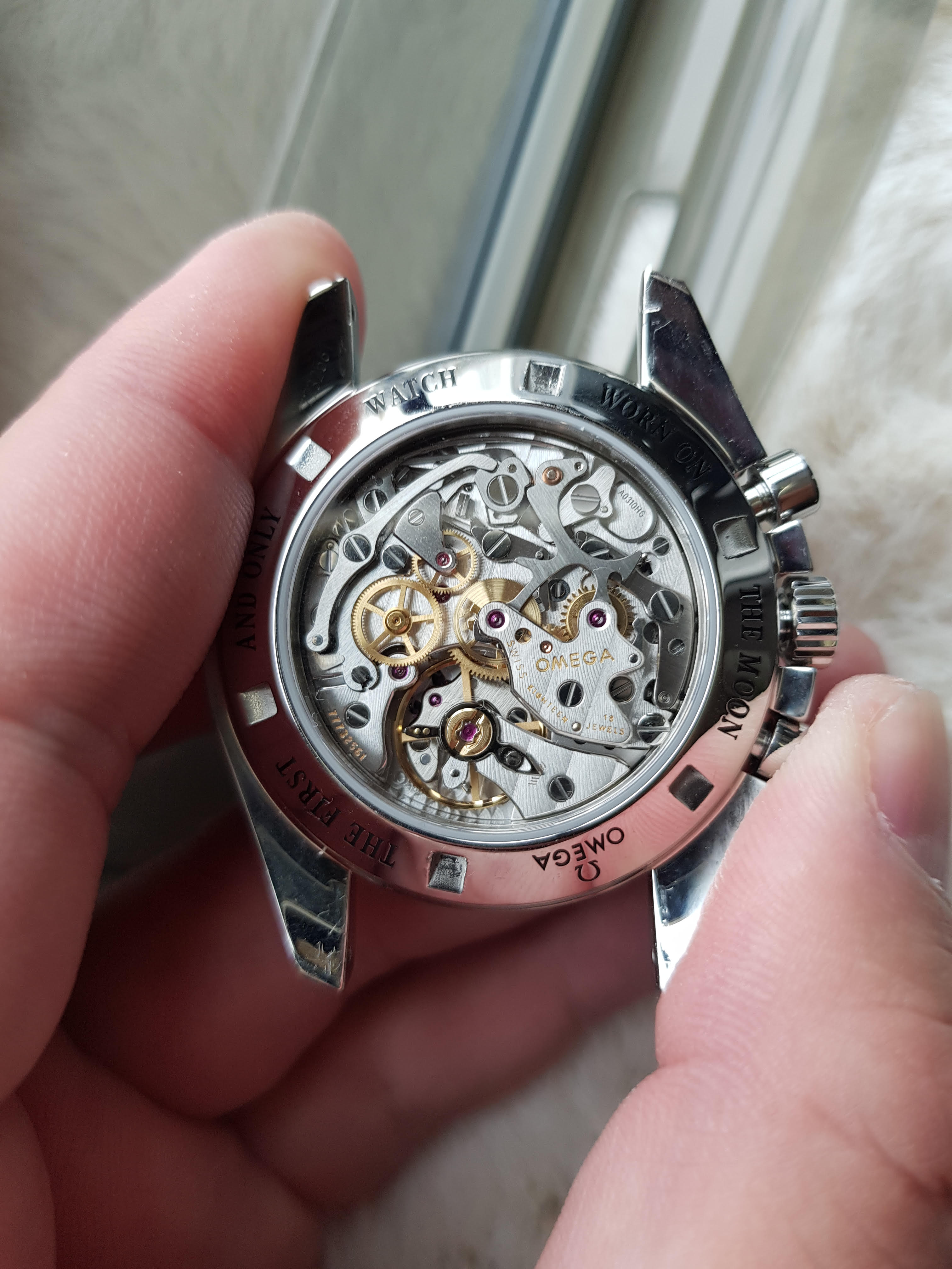

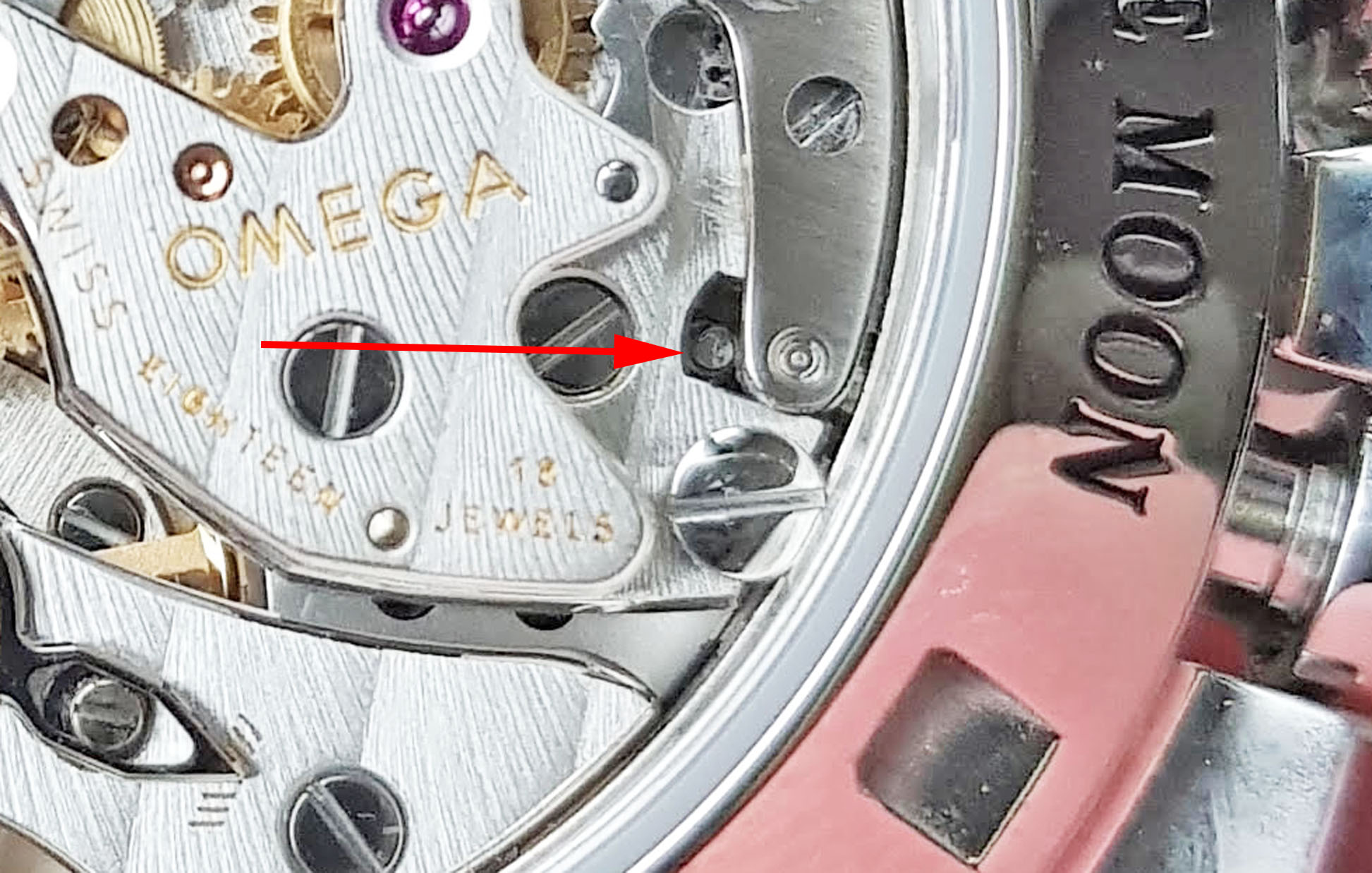

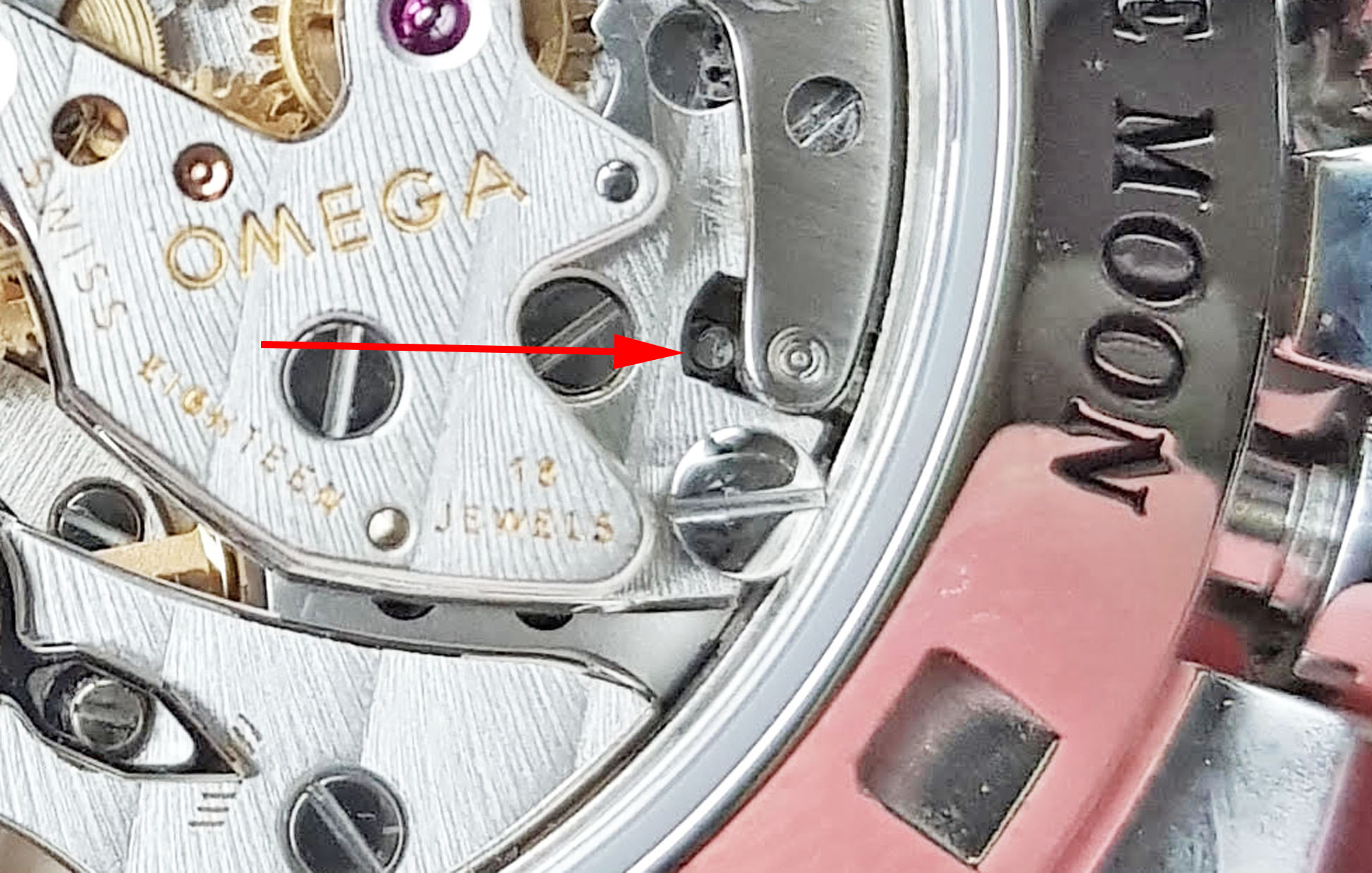

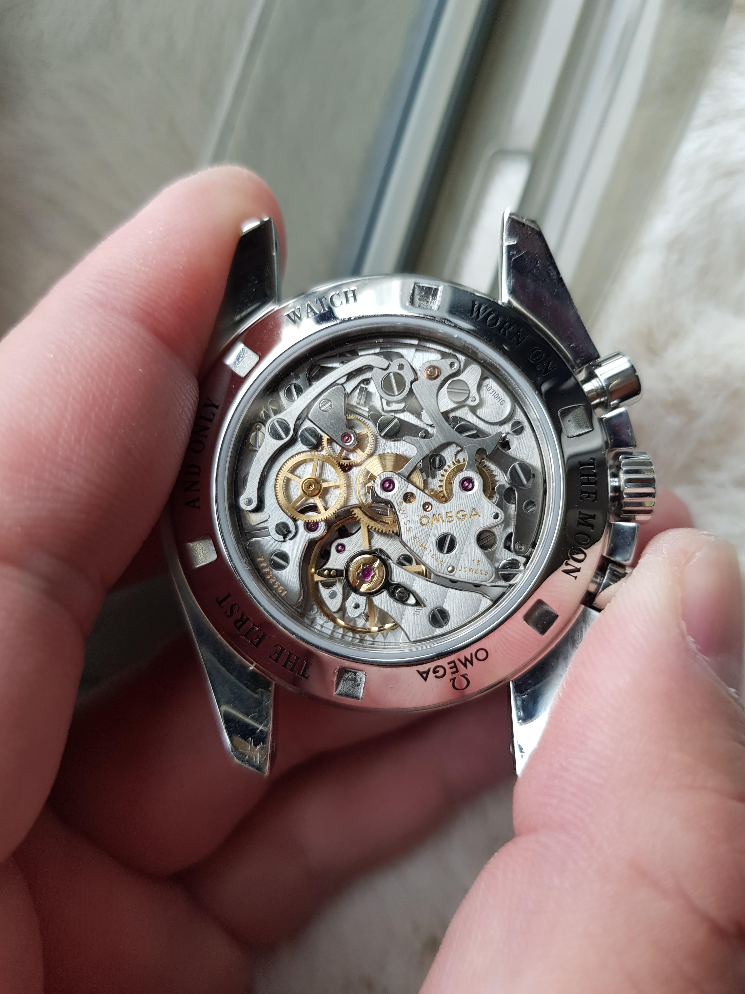

Interestingly, I had this question from someone last month on a forum - can't recall if it was here or not. I asked for a good clear case back shot, and was sent this:
Little zoom, brighten, and crop...
et voilà...
Dial foot screw had come loose and was jamming the pusher. Note that this screw is mobile, so if the problem goes away, that doesn't mean it's fixed...

First off, the state of wind won't have anything to do with the start/stop, or reset functions working.
et voilà...
