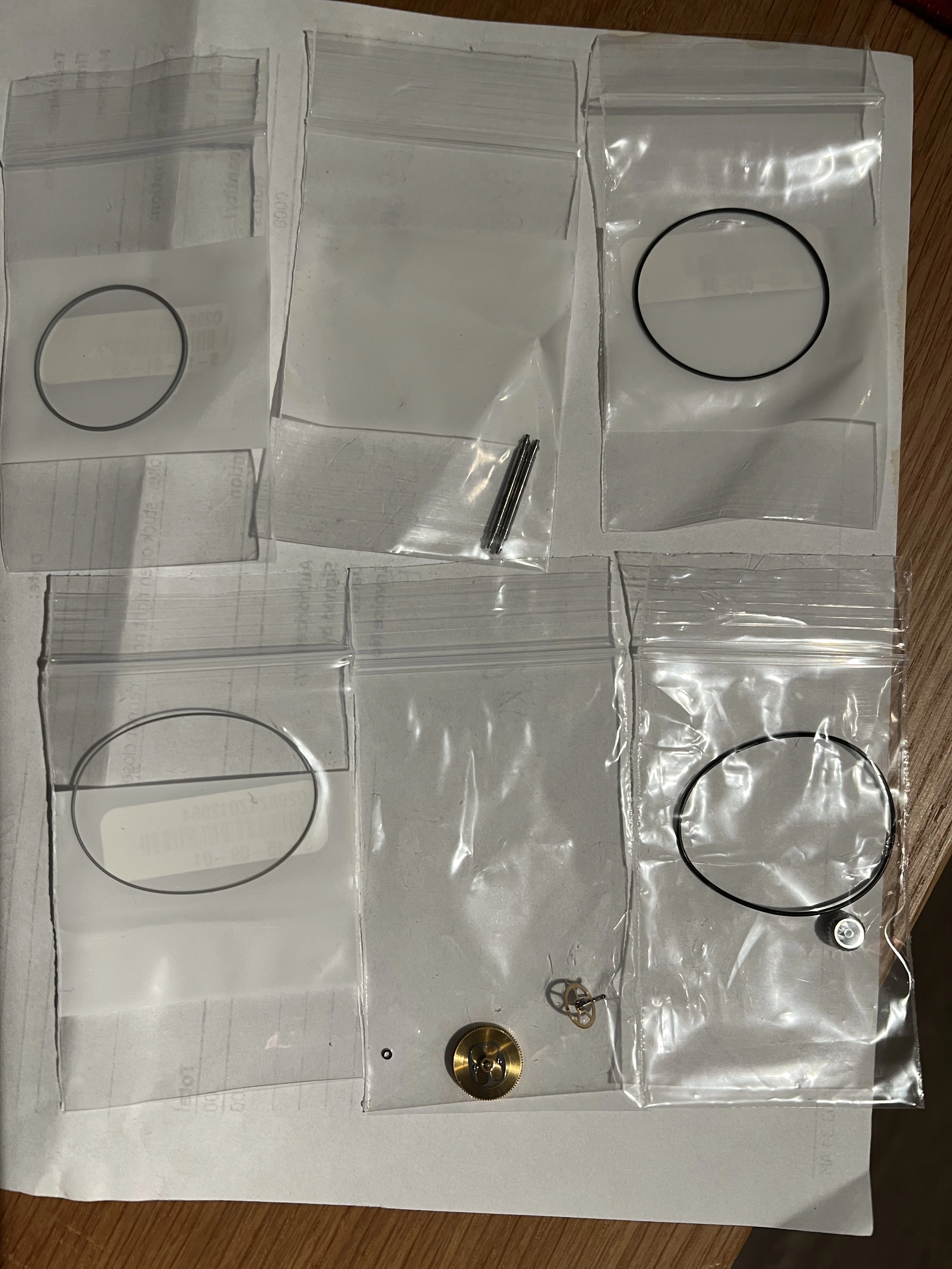

It's back. Here's what I got, but I replied you in another thread too. Thanks for the advice.

They replaced the crown too? So, they thought it was slipping?
I guess. You never get a description of what they did, just the old parts and a little white card. But almost 48 hours and still going, when it only went 18 max before.
It's standard practice for the crown being replaced at service on a Speedy.
7,800
14,403
Replaced the spring bars, too. Wasteful on a new watch. But that is what the procedure calls for.
