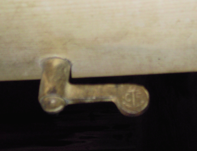

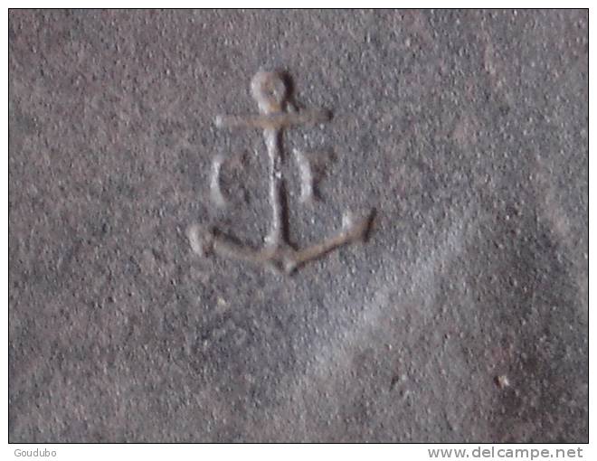

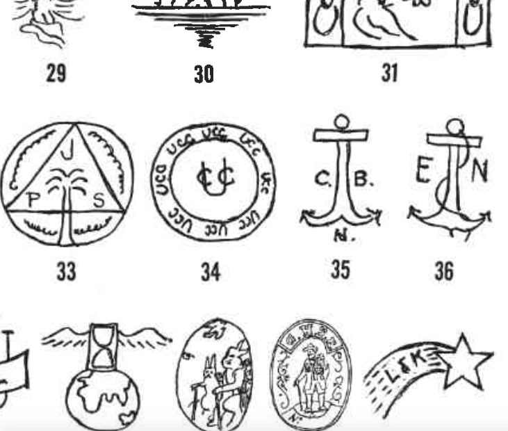

Your quest intrigues me. I could not resist investigating the anchor symbol with a C and a F. It is a very, very small part of your investigation but here is my contribution:
Do a google search on "Camion Frères" and "Camion Frères Ardennes" and then look at picture results and you will see who made your swivel lock.
Very unlikely to have anything to do with the clock but at least it is a small part of the puzzle.

styggpyggeno1 , you are officially my hero today! I am so thrilled with your discovery, I must have spent 12 hours looking for that small anchor! I nearly shouted EUREKA! when I found a trademark of a small German clock manufacturer called C. Baker at Nauen, (Brandenburg), Germany (see red herring photo, number 35 on the trademarks). But I had to concede defeat when I couldn't convince myself that the letter at the right of the swivel lock's anchor was not a F (it is clearly an F...).
So, bravo! Hats off! I'm showing a few items of Camion Freres, their catalogue showing swivel locks (!) and the imprint of their anchor on a metal surface. Photos from Google images https://tinyurl.com/gtrgm7e

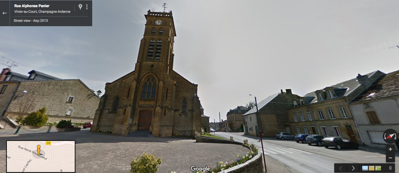

So, I went strolling to Vivier-au-Court (thank you Google street view) and what did I see in Rue Alphonse Panier? Check it out, people! https://tinyurl.com/jdhymrx
Yes! A tower clock!
Where do you propose we go from here? I say we check if Vivier-au-Court had a clock manufacturer and then try to climb the tower and have a look at the Vivier-au-Court Church clock.
Are we getting closer to solving the mystery? I say we are.

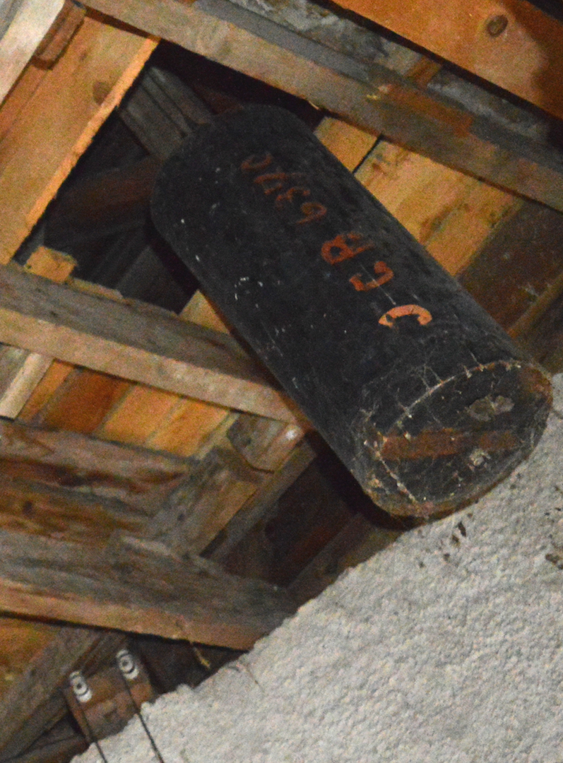

4) the pendulum, with FB 5.70 or 570 (is this indicative of the pendulum's weight or length?)
5) the bell, marked "Ruetschi AG, Aarau, 1928"
6) one of the weights, with a crude "JCB 6370"

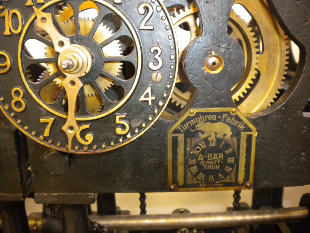

Exciting news, pouring in this morning!

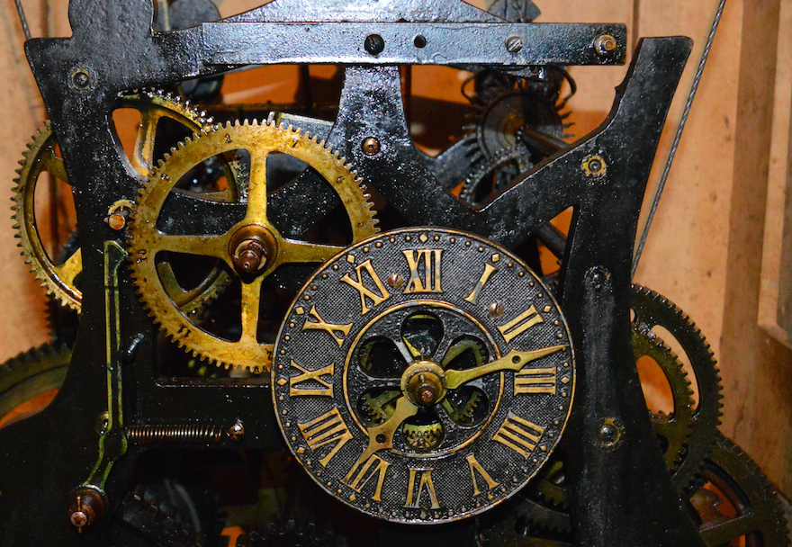

As you know, I decided to concentrate on the secondary dial, hoping to identify the clock makers from there. A person in this forum (to whom I am indebted, you know who you are!) suggested I contact the www.TheTimeWorkshop.uk (a centre for research and restoration into turret clocks and electric master clocks, housing one ff the largest collections of English, German, Swiss, French, Czech, Austrian, and Swedish turret clocks).
This is the very interesting piece of information I got back from Andy Burdon (slightly edited):

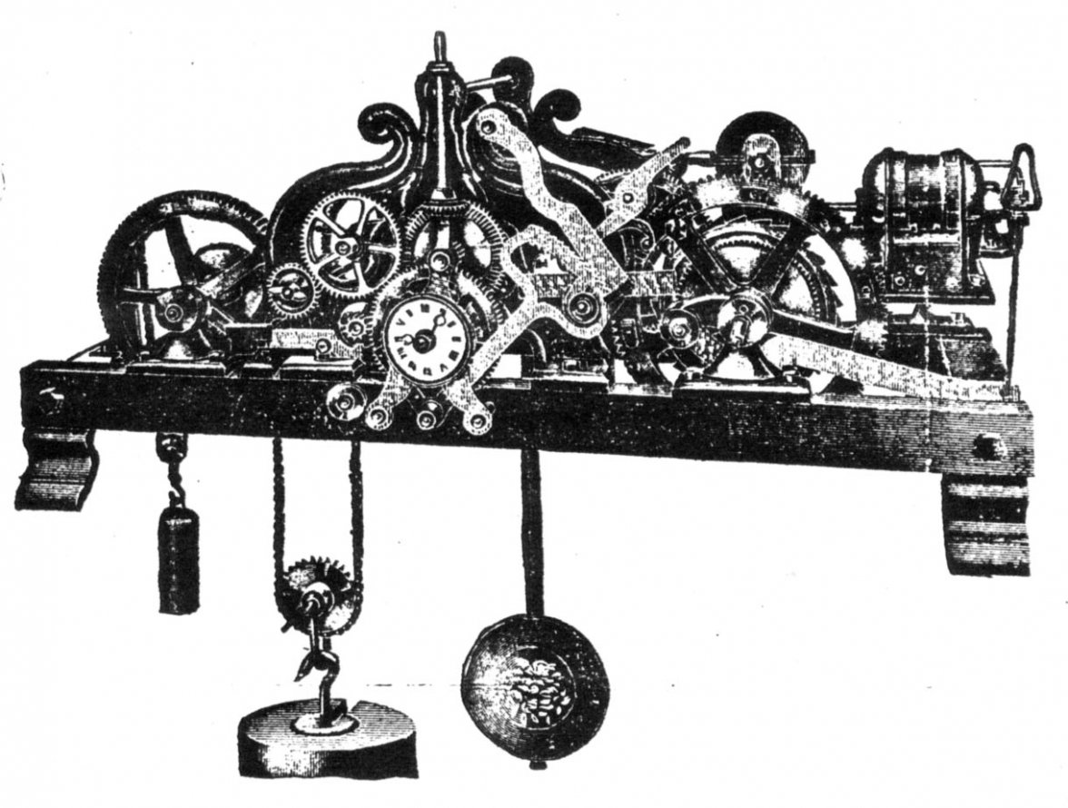

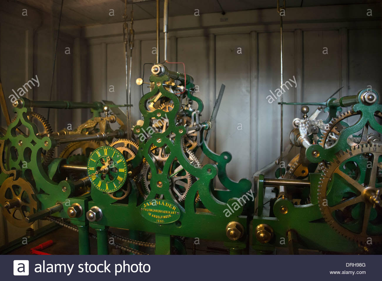

Looking at the time setting dial on the clock there were as far as I know only two companies that used this style of dial and hands. These two were both Swiss companies, Mäder of Andelfingen and A Bär, Gwatt Thun, Switzerland.
I have pasted pictures below of examples of these two. The Bär clock is my own one and the Mäder is a stock picture from the Internet.
If this clock was installed in 1928 it is possible that it was made to be released by a slave mechanism from a master clock and this would explain the presence of batteries. There are many examples of German clocks of this date without pendulum and with a slave clock release instead. It would be very easy for this part of be removed and a conventional pendulum and escapement inserted into the movement. [...] I have not as yet seen a clock from either of these two makers with this detail but that does not mean they did not do it. This feature would make the clock very accurate as the time is controlled by a accurate electric master clock pendulum instead of the turret clock mechanism itself. It is effectively a very detached escapement. Is there any evidence of a master clock? [...]
The wooden case for the clock is a very typical German / Swiss style one and the swivel lock handles you detailed in the Omega forum were used by all the Clock manufacturers on their cases.
He also had this to say about the master clock when I mentioned that the building (remember, the building was a school) had an electric clock installed in one of the offices and well as several clocks in one of each classrooms, again powered by batteries in series:
Your description of the clocks in the school are exactly how most were done. A master clock in the headmasters office, slave clocks throughout the school all wired in series with a set of batteries running the system. It would therefore make sense to make the turret clock controlled by the same master and the wiring in some of your pictures would seem to confirm this. In the largest systems ever installed one master clock could control 1000's of slave clocks.
The case for your clock is typical of all German/Swiss clocks and it is likely that it formed part of the packing crate for delivery hence the Fragile logo on the bottom of the case.
By the way as I was going through the pictures again this morning I also recognised the pendulum bob, it's a kitchen frying pan! ...It would be very easy to take a frying pan, fill it with melted lead and make it into a bob.
So, with all this amazing information I quickly (virtually) fly to Andelfingen, Switzerland and drop on their front webpage (not front door, but almost). Imagine my surprise when I see the dial and bell they have on their website. Yes, the same Jura-type face and the Ruetschi bell logo! Check it yourselves! http://www.turmuhren-schweiz.ch/
The company describes itself as so:
Johann Mäder & Son, Illhart 1798. The Turmuhrenfabrik Mäder AG in Andelfingen is today the leading manufacturer of tower clocks, electric Glockenläuteanlagen, chimes, special watches in Switzerland.
So all five pieces of the puzzle found in the same place. Outer dials/faces, secondary dial, bell, electric, Swiss.
I fired off an email to them and I'm now waiting to see if they will confirm that they were the clock makers, the 'intermediaries' the Ruetschi company referred to in their reply.
Fingers crossed! Attaching photos of the dials, kindly sent by Andy Burdon. He is independently investigating the A Bar connection, hoping to identify the clockmaker there. Anyone know if A Bär is still around?
I am also very much indebted to a Swiss expert who has received proof that the clock cannot possibly be French and that he very much doubts that the clock is German.
We are closer to solving the mystery and it might be a purely Swiss one too!

Reposting a photo of the Nymfaio clock secondary dial, so that you do not have to go back, searching for the photo 😀
For comparison purposes, obviously.

The pendulum marks may be those of a frying pan maker or other mundane origin, my guess is based on the very rudimentary cobbling together of the pendulum/escapement mechanism.
The weights (previously mentioned as maybe a shell casing) are probably standard clock weights salvaged from somewhere else.
If the were from shell casings, they would have had a soft copper driving band very close to the base.
