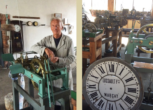

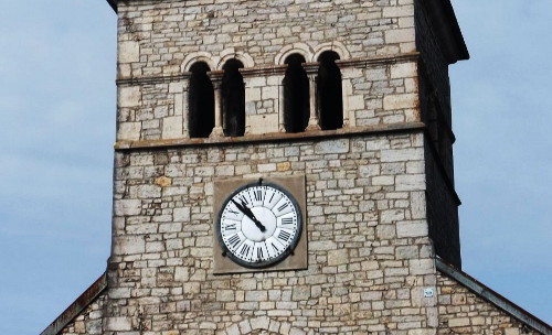

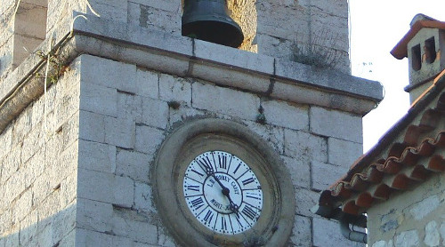

We are getting closer to identifying the faces. Typical of Jura, France. Most are made by Odobey L. D. (horloger) ; Cadet (horloger) or their successors Terraillon-Petitjean. And I am being told by Mr. M. Viredaz that: The faces (dials) on the tower are typically French. They are called Treize Pi猫ce (i.e. 13 pieces or 25 with minutes) also for home clocks (Morez/Morbier/Comtoise clocks) because it was difficult to make large enamel dials, they made 12 "cartouches" for the numbers + one for the center. Also easier to transport!
So, it's not improbable that the faces did come from France or Switzerland to the little mountain village!
Also the dates seem to fit.
"Le clocher de l鈥櫭ゞlise de Clairvaux-les-Lacs, dans le d茅partement du Jura, a 茅t茅 r茅habilit茅 en 2012. L鈥檋orloge fabriqu茅e en 1925 par l鈥檈ntreprise Terraillon-Petitjean (successeur de l'entreprise Paul Odobey Fils de Morez)", from http://www.horlogerie-comtoise.fr/
Now we need to identify the mechanism (I am reading it was NOT unusual not to have identifying marks or plaques). Can someone help with identifying the actual clock, hopefully from the front dial?

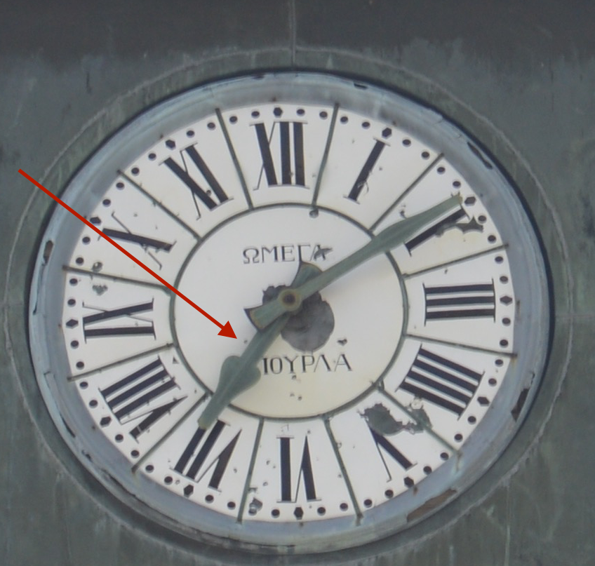

But why on earth did he also put 惟螠螘螕螒 on the dial if the clock was not an OMEGA? And why not write it as the company was actually called, i.e. OMEGA?
As he was the local Omega represantative it could have been for marketing reasons. Written in greek it would have been easier for the locals to read or maybe he asked Omega to put "OMEGA" on there, but they refused to use it this way, as it was no Omega clock.
Pure speculation from my side, of course.
68
82
As he was the local Omega represantative it could have been for marketing reasons. Written in greek it would have been easier to for the locals to read or maybe he asked Omega to put "OMEGA" on there, but they refused to use it this way, as it was no Omega clock.
All seem plausible. Thanks lando!

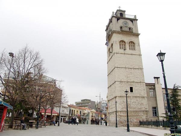

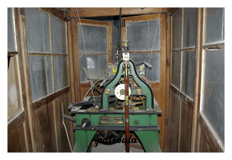

A little side story, a photo of the tower clock in the nearby town of Kozani, just 45 km from the village of Nymfaion, first set in operation on January 1, 1940. Photo from http://palsoula.blogspot.gr/2015/11/blog-post.html
It's a US-made Seth Thomas clock, a subsidiary of General Time Instruments Corporation http://www.clockguy.com/SiteRelated/SiteReferencePages/SethThomasHistory.html
As in the case of Nymfaion, the clock tower and clock were a gift from a native son of the town, this one having made his fortune in the US.
Why am I writing this? Because the Nymfaio clock was modified in 1968 and the town people remember some 'tower clock' guy from Kozani repairing it. Voila! The clock tower of Kozani (photo from wikimapia.org).

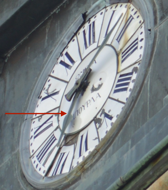

Following the very interesting lead and confirmation from an expert in Switzerland that the BOURLA (螠螤螣违巍螞螒 in Greek) name which appears on the four faces of the tower clock was in fact the name of the OMEGA representative in the nearby city of Thessaloniki at the time, I now have irrefutable proof that the S. Bourla company were in fact the exclusive OMEGA representatives in Greece (as stated in two separate ads which appeared in the local Press in March & April 1929). It seems that the company became S. Bourla et Fils (S. Bourla and Son) shortly thereafter.
The company identifies itself as "Jewelers" and "Diamond sellers". Sources tell me that they were also the Rosenthal (porcelain) representatives in Greece.
Notice the curious OMEGA font in the ad (also seen in other countries), as well as the brand name 惟螠螘螕螒 written in Greek by the representative.
Compare with this German ad (from www.delcampe.net).
Reposting the photos of the clock faces with the name 螠螤螣违巍螞螒.
68
82

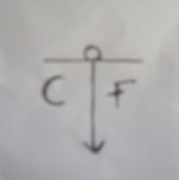

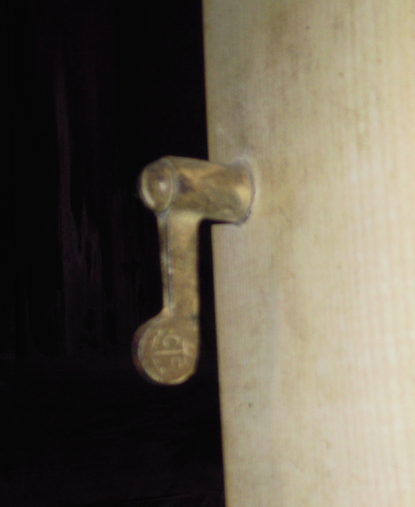

Just asked and got a rough sketch of the marking. Here it goes...
Could be a red herring...or not a good sketch or...
The marking is tiny. I hope the letters are what we think they are...
If it's an anchor, it's an encouraging sign. The mechanical clock of Nymfaio has an anchor escapement
Hopefully we'll have the photo, enlarge it and find out tomorrow!

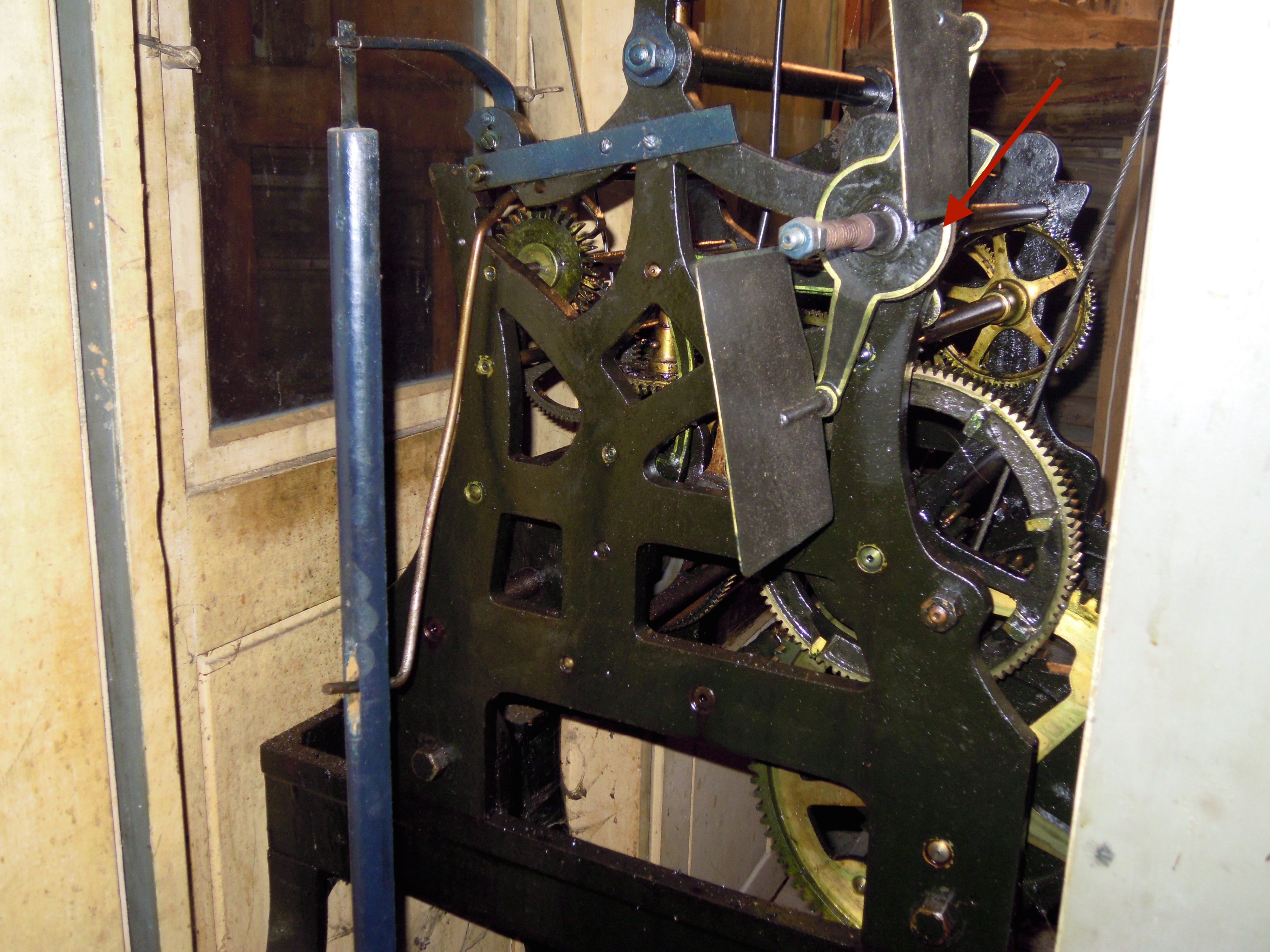

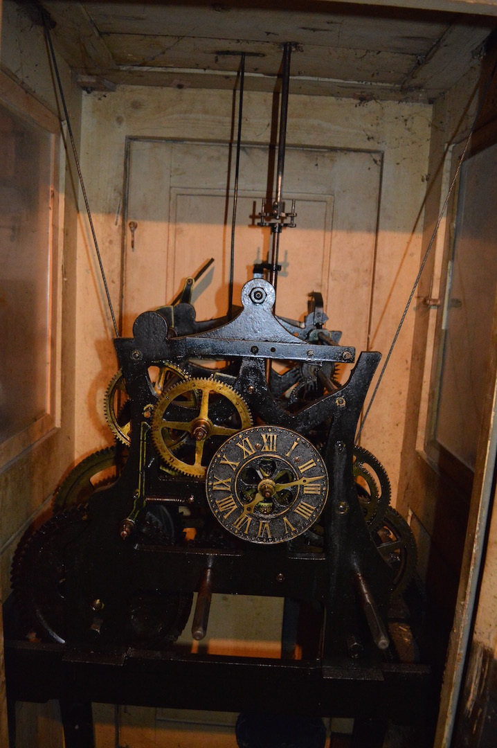

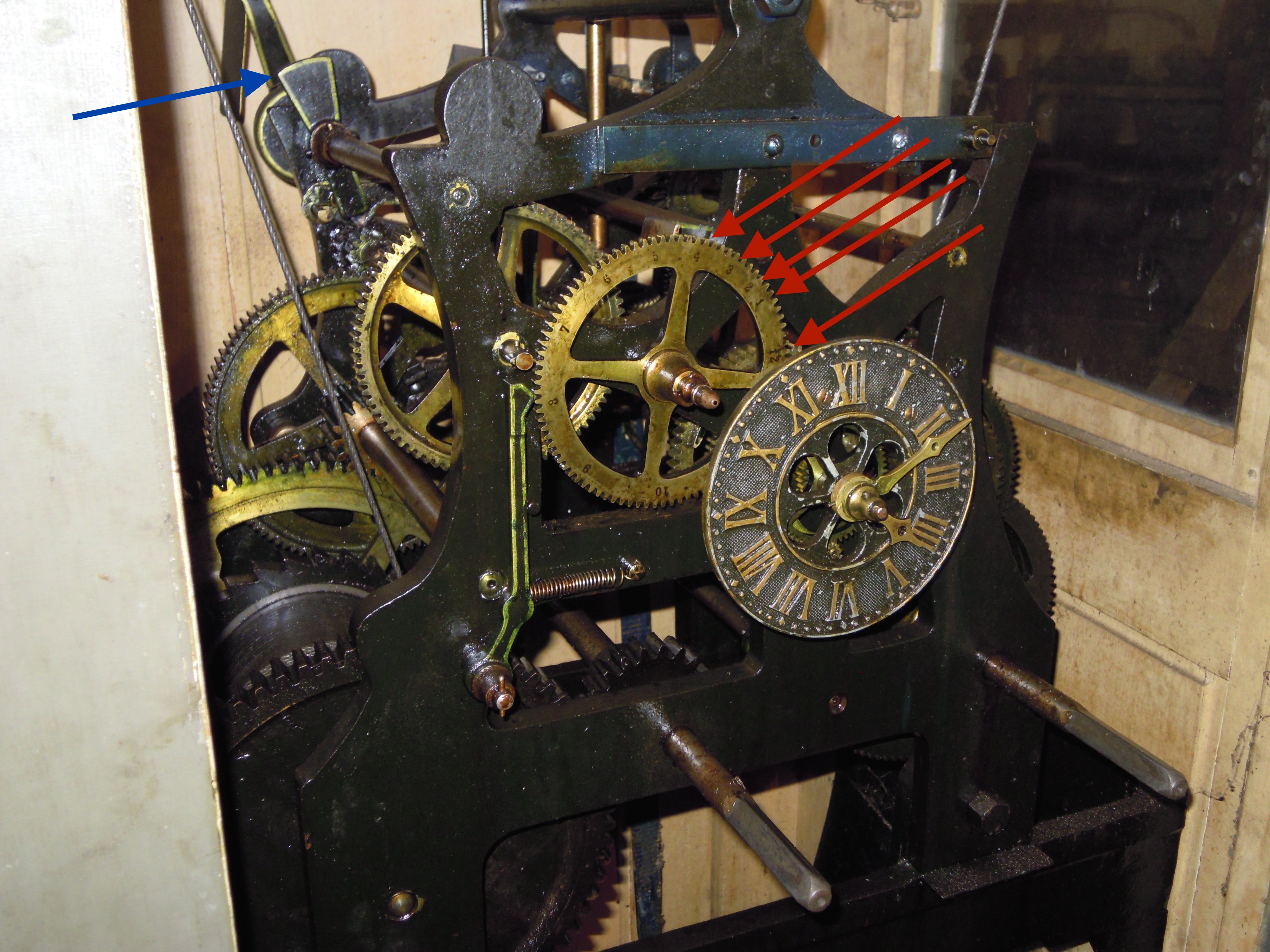

Ok...The photo was not was I was expecting. It's indeed an anchor with a little "O" at the top, pointy arrow-type sides and what appear to be the letters C and F on each side. But it's engraved on a swivel lock of the 'housing' of the clock. It's a long shot, I think, for identifying the clock. Unless the same company that did the brass for the swivel made the brass for the clock... I'm attaching photos.
So, I'm turning my attention back to the actual mechanism: the bluish pendulum rod and metal bars look suspiciously modern, probably installed in 1968 when the clock was modified to carry a pendulum. The actual pendulum has a FB 5.70 marking (see photo). But I think that this is a 'modern' rod, nothing to do with the original clock.
I also now have a photo of the back of the clock's mechanism. There m i g h t be some markings on one the wheels (red arrow showing the area) but I'll have to have a closer look.
I'm also posting a photo of the count wheel (used to strike the clock bell), the only part of the mechanism where markings are clearly visible. It's just behind the secondary dial (which I am surprised to say has not brought us closer to identifying the maker. I had hoped that someone will recognize the type of secondary dial to at least a country or period).
Also (same photo), I'm hoping that someone will identify the gold border on this part of the clock (blue arrow) and maybe say "hey! so and so used to make gold borders on this part of the mechanism!"...
That's all I have for tonight, have a great week everybody and thanks!

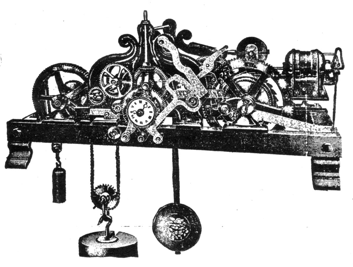

New day, new ideas!
I'm considering a different line of attack in order to identify the clock manufacturer of the Nymfaio tower clock. it seems that identifying the clock mechanism just by looking at it is not as straightforward as I was expecting and the photos have left very capable people scratching their heads...
So, I read the fascinating paper titled "The Evolution Of Tower Clock Movements And Their Design Over The Past 1000 Year" by Mark Frank (http://www.my-time-machines.net/speech_final_web.pdf) and realized that not many European companies made electrically wound tower clocks at the time the tower clock was built.
I'm quoting:
"For a brief period of time between the 1930's through the middle of the 1950's a few companies, particularly those in Germany, made tower clocks that were mechanical in every sense, but wound electrically through the use of complex epicyclical / worm gearing.
and
Electric - At first sporadically applied to tower clocks in the late 19th century. Mostly in cases where the movement was installed in an area that made regular winding by a person difficult. Began to appear as an O.E.M. feature in the 1920's.
So, let's ask the Question: Which European (non-French) clock manufacturer made electric tower clocks in 1928 compatible with the design seen in the Nymfaion tower clock (assuming that the Greek Omega representative, who we think is also the installer, did not buy the clock mechanism and glass batteries separately from various sources and then converted the original clock to electric, all before the first day of the clock's operation...)?
Remember, the town people insist that the clock originally operated on glass batteries, before it was converted to pendulum in 1968. One can still see the knob-and-tube wiring on the tower ceiling (photo), so something must have been electric in there...(I'm hoping not just the light fixtures...)
This mystery company would also have to be big enough to be 'discoverable' from an Omega representative in 1928 Greece where the order presumable came from (no phone, fax, internet, just good old fashioned very snail mail) and willing and able to export the tower clock to such representative.
Any takers?

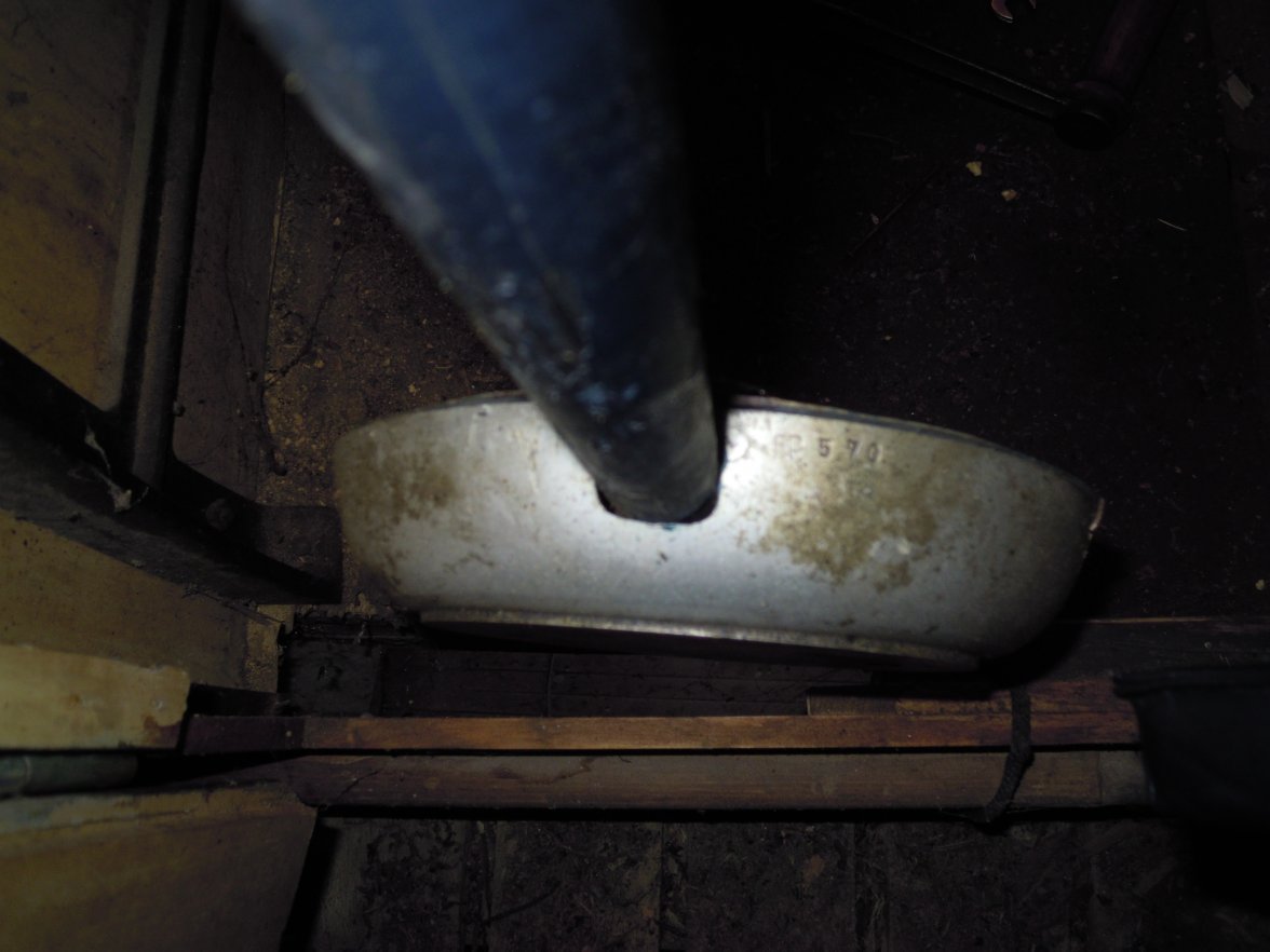

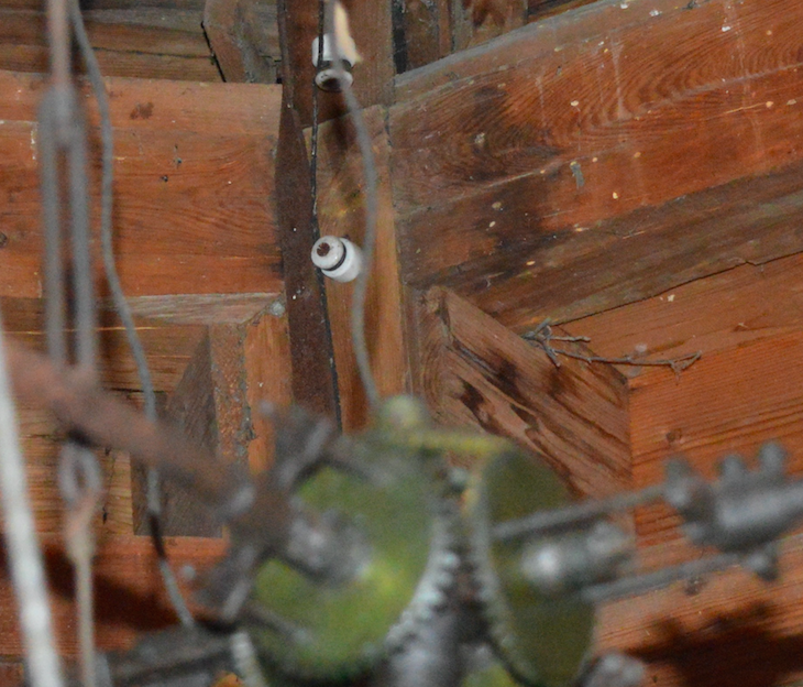

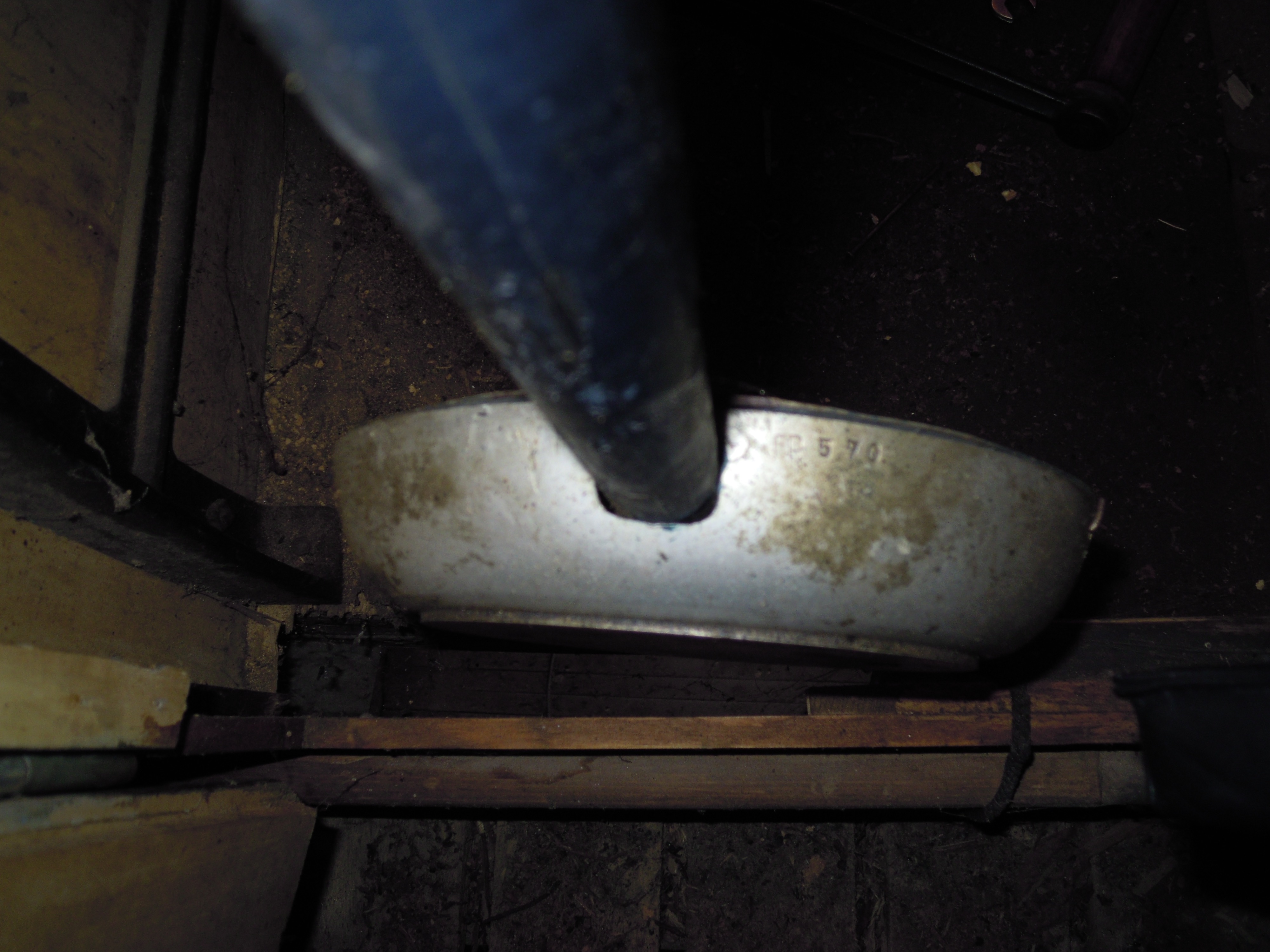

No tips to offer at the moment, but I do have a question.
The pendulum was obviously installed at a later date, seemingly by an "agricultural artisan" 馃榿
So what kept the clock in beat before the pendulum was installed, the "electric bits" (not meaning the winding motor)/
2,876
1,958
I think the electric motor was just replaced by a hand wound mechanism. The purpose of both of them is to wind up the weights that drive the movement. The pendulum that regulates the clock was there from the beginning and is still there now serving the same purpose. If it was ever replaced, it was for some other reason not related to the electric motor, and even then there would still be another pendulum regulating the clock now.
