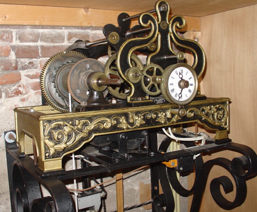

I spent an interesting few hours on the website of the Dutch Tower Clock Conservation Society (http://www.torenuurwerk.nl/) who keep a surprisingly comprehensive database of tower clocks in the Netherlands, in attempt to check the possibility you mentioned earlier that it might be Dutch. The clocks in the database can be sorted by location, period etc., and almost all have good pictures of the actual mechanisms.
Just to remind you, I know literally nothing about tower clocks. Nevertheless, I examined close to 500 tower clock mechanisms from the 20th (and, to be sure, also the 19th and 18th) century - the image of 'your' clock on one monitor and the database pictures on another for comparison - and came to a few conclusions.
1. There's a lot of people that care deeply about tower clocks.
2. 19th century tower clocks are by far the prettiest ones - often elaborately ornated and curvy, in sharp contrast to the boxy and relatively simple designs of the 18th century. 20th century tower clocks are obviously more complex than the 18th century ones, but very functional in appeareace and nowhere near as pretty as their 19th century counterparts (see images below).
3. Most of the clocks were made by Dutch clock makers, but there are imported ones as well.
4. I found the variety of designs and brands frankly staggering. There are a few well-known brands (e.g. Eijsbouts) with popular and recurring models, but I'd say at least half of the ones I saw (...and that's a conservative estimate) appeared to be unique pieces.
5. In spite of this great diversity, I found not one clock that even remotely resembled the one you're interested in. Well, maybe very remotely since they all operate in generally the same fashion, but not one time did I think 'hey, there may be a link here'. I kept an eye open especially for the secondary, time-setting dial and found zero instances that looked even remotely like yours.
Now I realise it's difficult to prove a negative, but given that the database is fairly comprehensive, I would say the odds of yours being a Dutch clock are low.

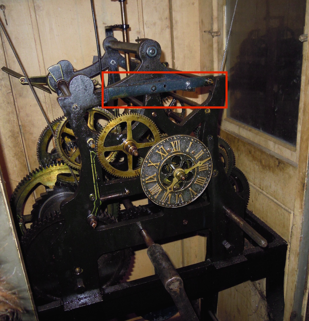

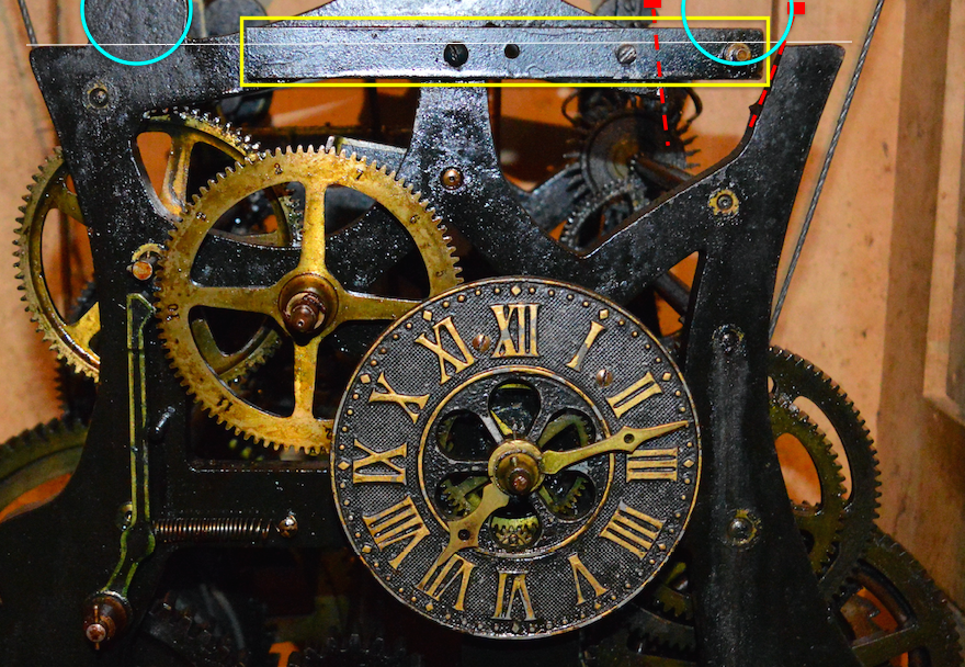

Reposting a photo of the Nymfaio clock secondary dial, so that you do not have to go back, searching for the photo 😀
For comparison purposes, obviously.

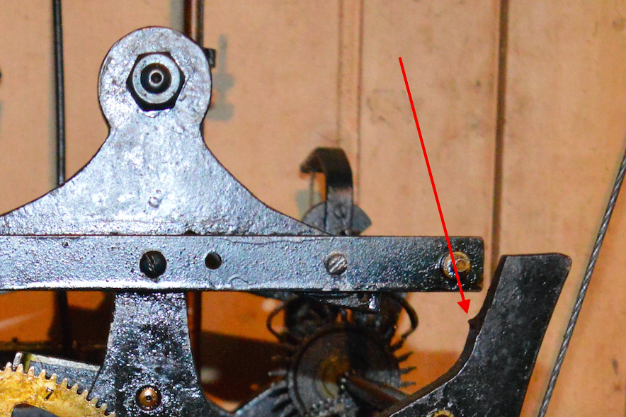

So from this one we can see the terrible work done to fit the pendulum escapement.
At the front we can see where the frame was chopped out (red dash cuts) and an additional bar of iron or steel was bolted to the front frame to support the end of the escapement axle (yellow outline).
So I would imagine the front frame would have had another lobe on the right side, equidistant from the centre pillar as shown by the blue circles.
The rear frame is much the same but as the photos are on an angle it's not as easy to replicate my limited photoshop work.

From the loving hands of 1928 Swiss master clockmakers to the local repairman who butchers the clock and adds a frying pan!
(In the villagers' defense, 1968 was a terrible time for Greece, just one year into a brutal Argentine-style military dictatorship and with rampant poverty in all mountain villages that were losing their young men and women to immigration).
But... how interesting. I had a feeling that the bluish colour on some areas indicated a later-date part. Now that I'm zooming in on the photos I can see how very right you are. Thank you for letting me see that.
I'm attaching a few photos where the cut job is clearly seen (an iron stub and saw markings on the original frame), as well as a photo from above that shows the added axle that I suppose supports the pendulum on the other side.
A photo from the back clearly shows the additions in the distinctly different colour.

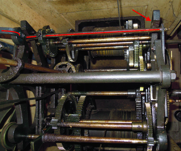

And now that I watched this easy for me to understand video
I also understand why the repairman had to cut off the original frame. He had to position the anchor escapement on top of the escape wheel, so he had to insert an escapement axle, which also held the pendulum. Ah...what a nice feeling, finally beginning to reconstruct the history of the clock!

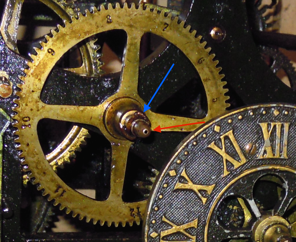

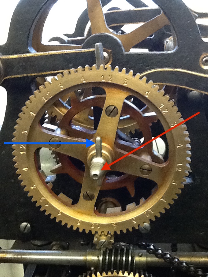

Acorns!
Let's talk about acorns. They are the latest rave!

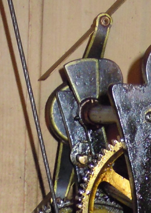

Andy Burdon from www.TheTimeWorkshop.uk has discovered something quite interesting on the count wheel of the Nymfaio clock which narrows the possible candidates (clock manufacturers). As he owns and has restored a A Bär clock he says that these clocks had one very particular feature, an acorn at the end of the shaft the count wheel is on. You can see the acorn in both clocks.
Another interesting detail is the taper pin on the count wheel, which in the Nymfaio clock is bent downwards. Here is what Andy Burdon has to say: The taper pin is there to stop the count wheel coming off the shaft and should be a tight fit in the hole in the shaft. Often they were removed during maintenance and lost. The engineer found he did not have one that fitted properly and so he used whatever he had and bent the end over to stop it falling out. I have even seen nails used to do this.
He is correct in saying that the Nymfaio clock has a similar acorn on the same position and also the taper pin on the same spot (photos attached, acorns marked by a red arrow, taper pins marked with a blue arrow).
Could this be the clincher? Is this a A Bär clock (or A Baer clock) manufactured by A Bär, Gwatt Thun, Switzerland?
So can we eliminate other clock manufacturers? Does anyone known of another manufacturer who used acorns in that way, for similar period pieces and clock mechanisms?

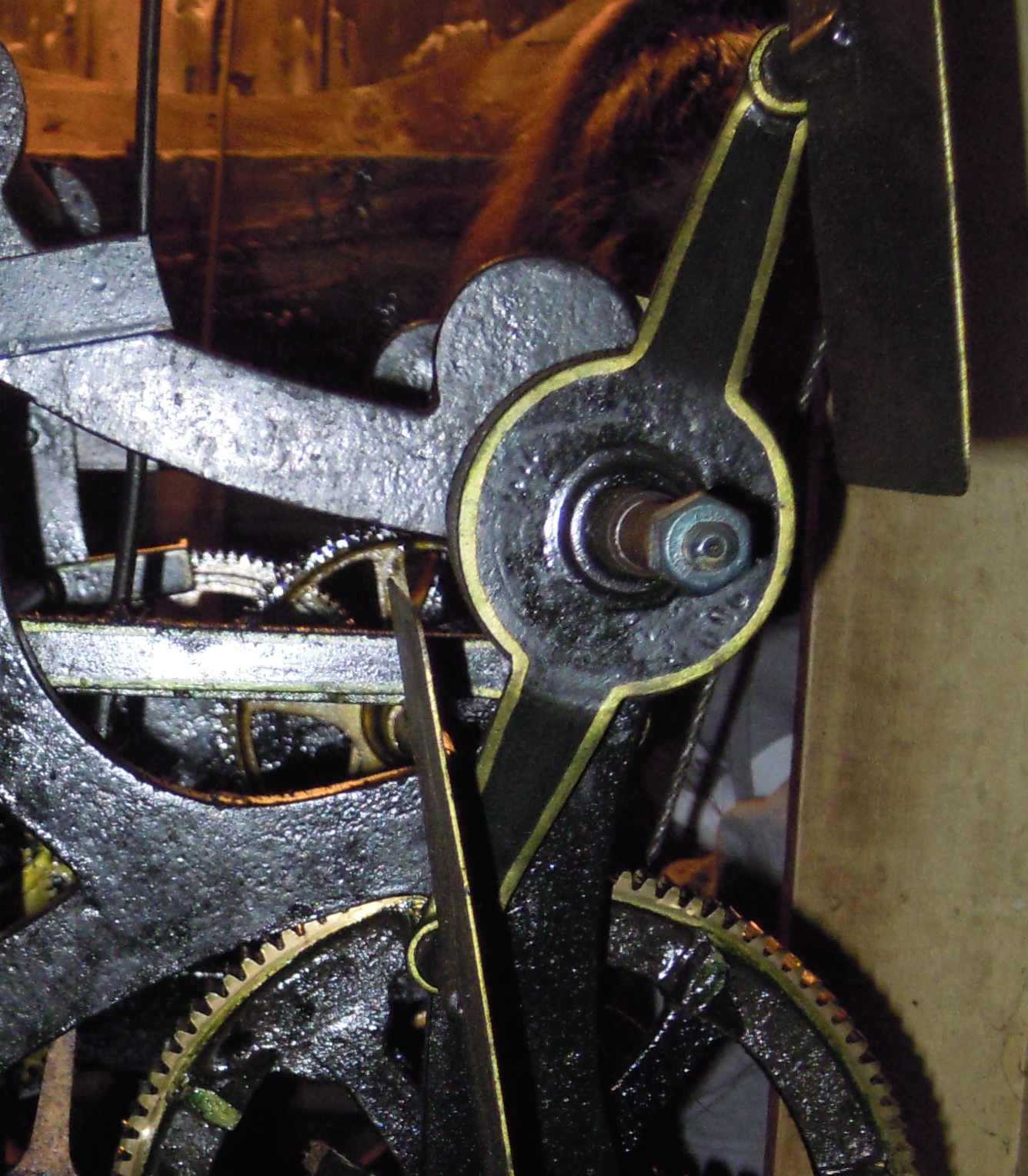

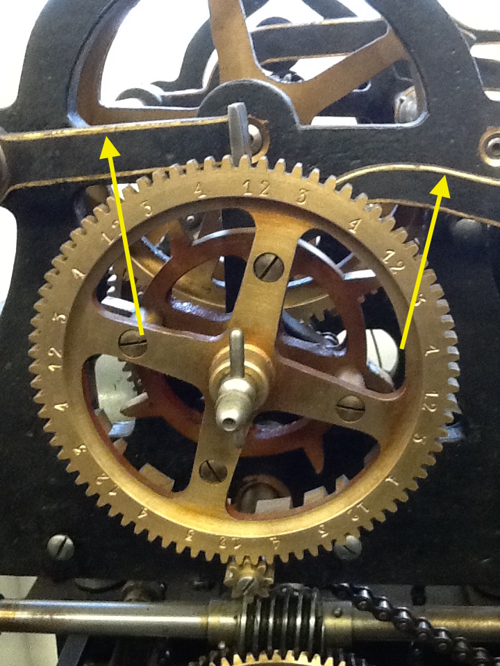

And for those of you who like the colour yellow, here is another thing the two clocks have in common. A yellow border on some parts.
Attaching a couple of photos of the Nymfaio clock mechanism and the A Bär clock.
Another point for A Bar.
