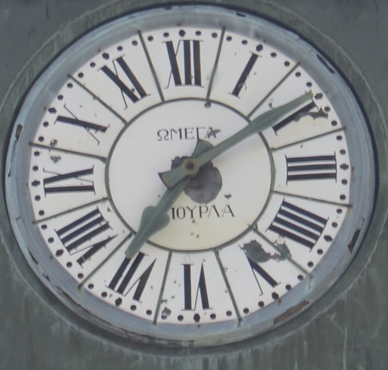

Did the same names/labels exist on the faces from the beginning? How many times and when was the last time the clock's faces were restored or repainted?

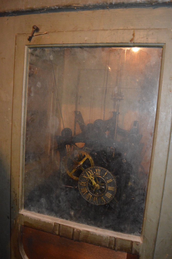

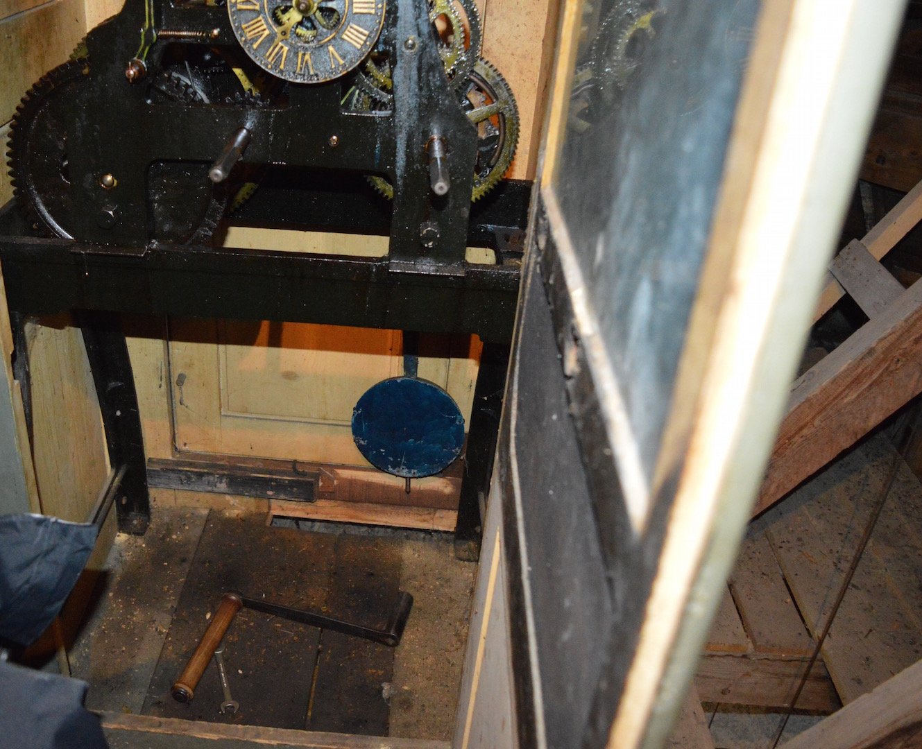

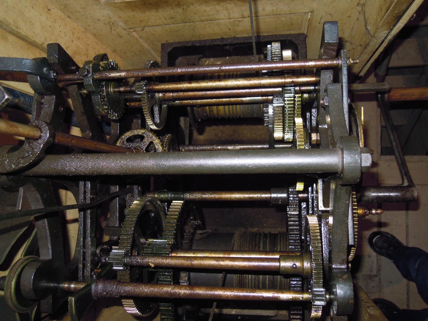

I have asked a local councilman for any photos of the tower clock mechanism prior to 1968, year on which the conversion was made from electric to pendulum (the town people insist that the clock always had two crankshafts, the left one facing the clock for the bell and the right one for the clock). I am afraid I am not at all knowledgeable on why crankshafts were needed if it run on batteries... The person who was charged with winding the clock, now too old to perform his duties, told me that the clock originally ran on 3-4 glass alkaline batteries, to which the older school children (!) added ammonia once a month. The batteries were recharged in a wind turbine nearby. They batteries produced a low voltage, maybe 2,5 V (unconfirmed). The weights took 6 days and 18 hours to reach the bottom (by a slight calculation error they were hanged a few feet too low), so instead of having a run time of 7 days the clock needed full rewinding 4 hours short of that.

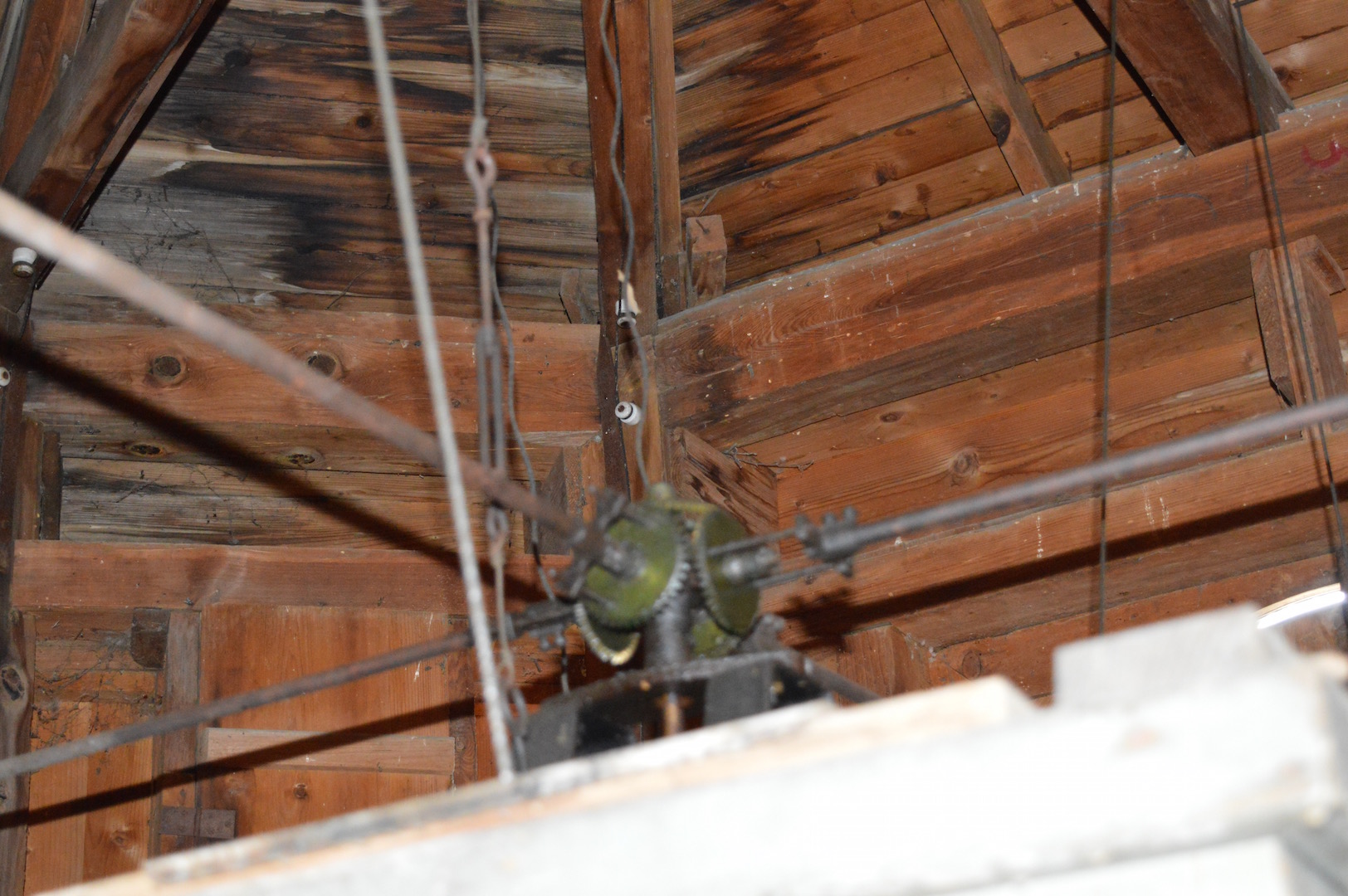

I am also told that in 1968 a clock maker from the nearby town of Kozani (incidentally also famous for its tower clock, built in 1939) removed the batteries and added a pendulum, effectively converting it. The old tube and knob wiring was no longer used. See photos with pendulum, from above the mechanism and traces of tube and knob wiring on the top right corner of the third photo (also showing the main shaft driving the hands on the four clock faces).
As for the names/labels, village elders tell me that these are the original faces, never restored or repainted.

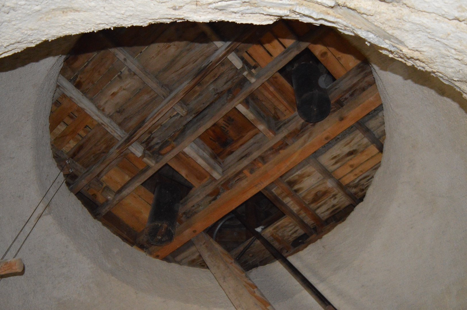

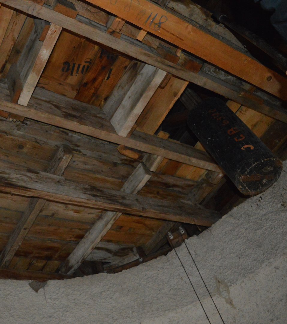

Thank you Canuck. I don't know what to make of that...It's true, the clock mechanism does seem quite crude to my eyes, but I confess I know next to nothing of clocks. Would it look better if it was taken care of, cleaned, polished and properly oiled? Possibly. However the building and clock tower was definitely completed in 1928 and the clock bell does have a Rueschi AG Aarau engraved stamp, dated 1928. The only other vague clue as to the clock's provenance or date is a piece of the original (I assume) crate it came from, now seen from the floor below and looking up, incorporated into the flooring that forms the base of the paneled compartment containing the clock. It reads "FRAGILE" in old french type (center of the photo, between the clock weights).

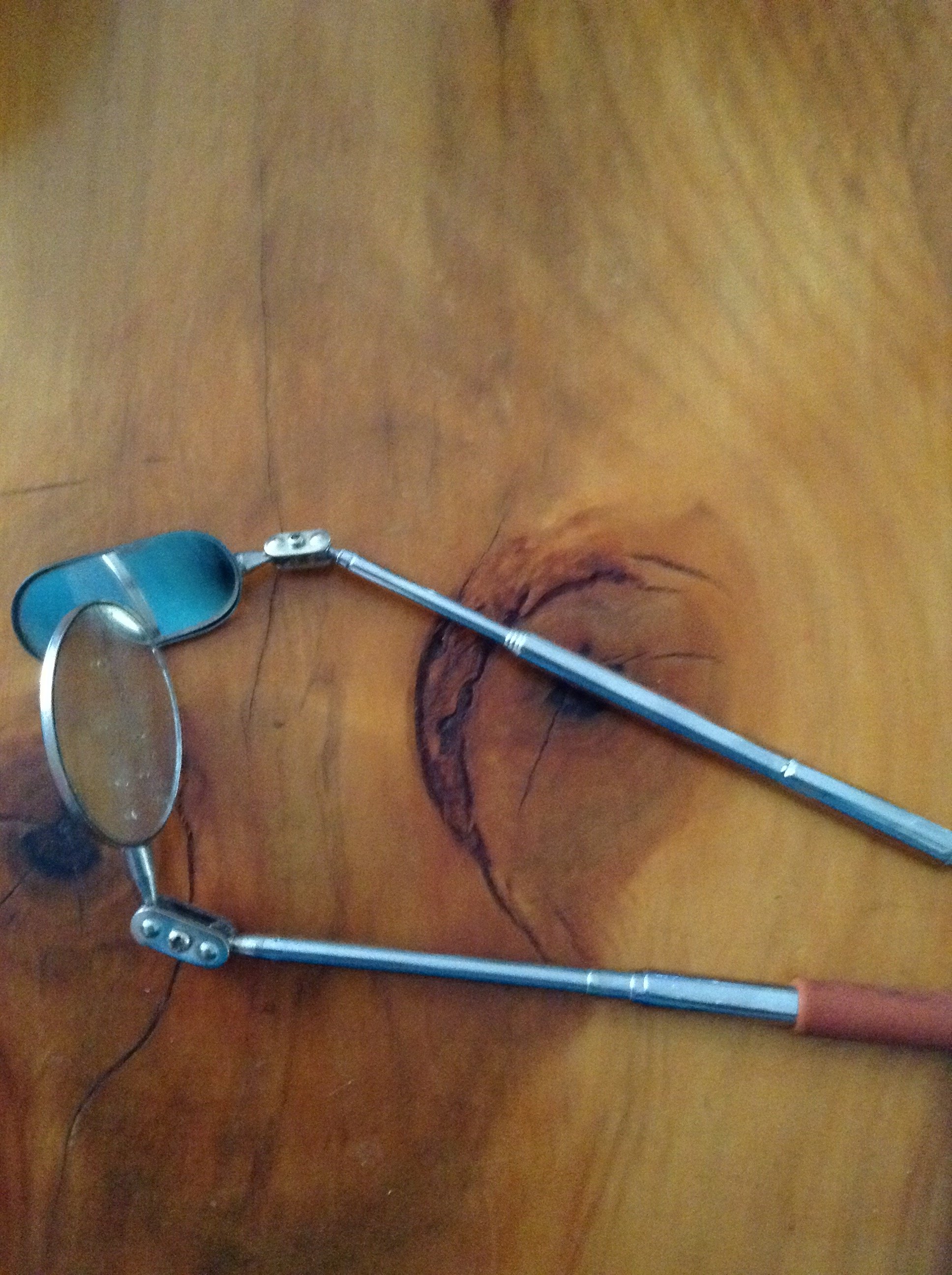

Having a closer inspection of the clock with a inspection mirror may uncover a makers plate as most mechanical parts will have one somewhere.

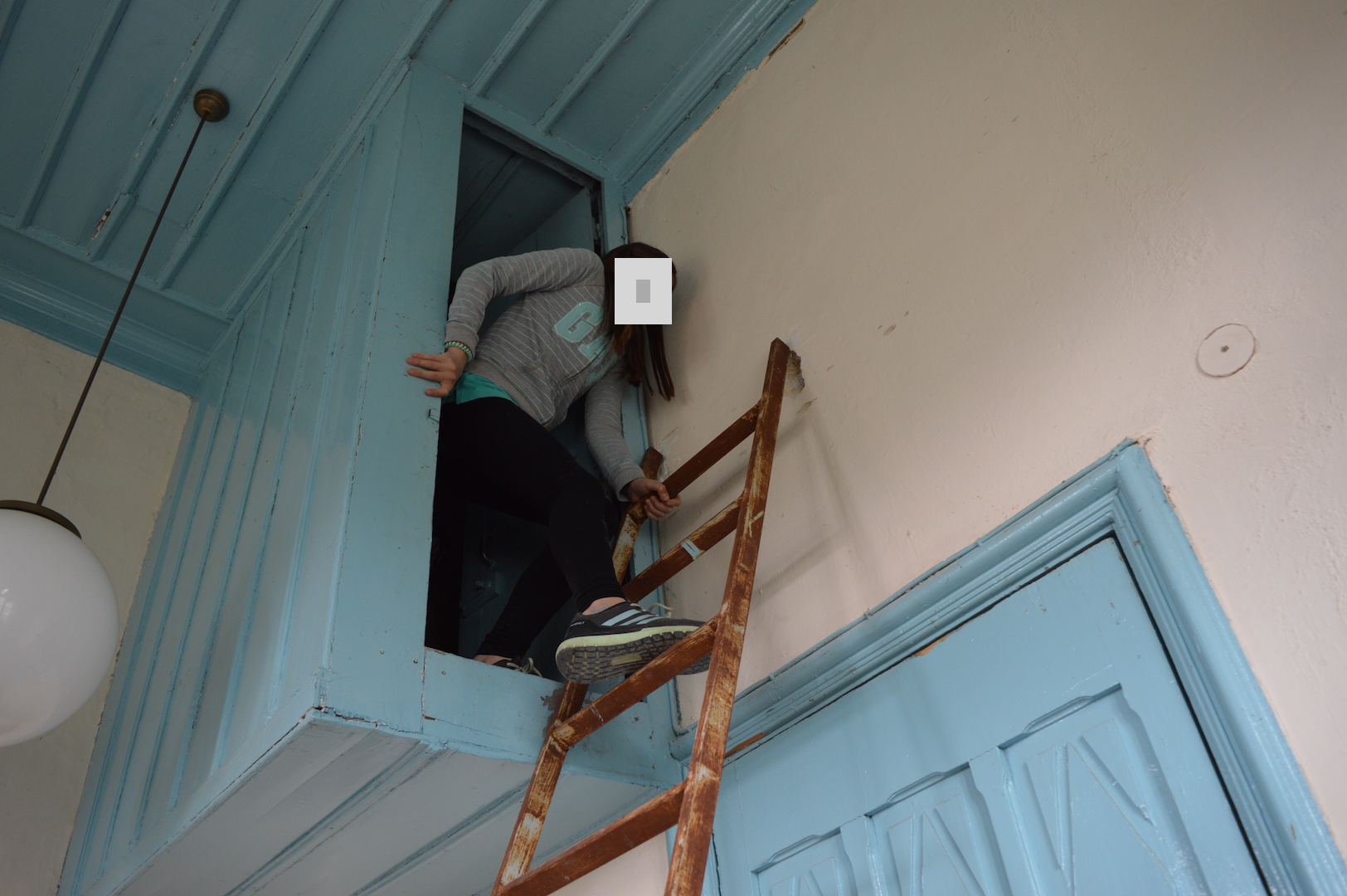

I had a hunch as much and did look for such markings, but didn't realize that it would take an inspection mirror. Thanks for the tip STANDY! I have to go back up the rickety ladders again...! (photos of my kids and their friends going up the ladders).

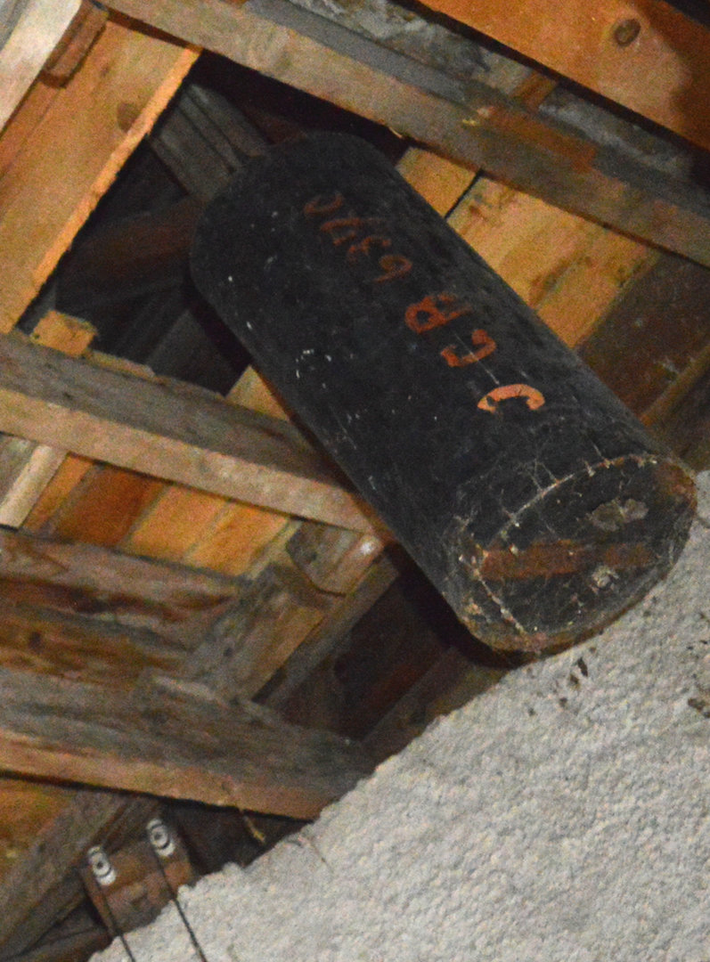

The only marking I could make on the structure were the "Fragile" sign on the bottom of the paneled compartment that houses the clock and a curious 'JCB 6370' marking on one of the weights. But the weight could be of a much later date, even discarded artillery shell or shell casing... http://cartridgecollectors.org/?page=introduction-to-artillery-shells-and-shell-casings
That part of Greece saw quite a lot of action in WWII.

If you shine a torch on the inspection mirror on a angle you will see in dark spots also. 😉 They can be picked up for $5 at any car spare parts type shop.

A very interesting development to the mystery today! On the advice of a very knowledgeable and friendly expert I was directed to the clocks of the French Jura (horloges Odobey). As I started researching the clocks I landed on this site http://sophie-mouton.info/tag/Jura and then found a nearly identical clock face to the one of our clock tower of Nymfaio. The face depicted below is the Horloge d'édifice, porte de Nozeroy, signed L.D. Odobey Cadet - Morez (Jura). Next to it is our clock. Similar material, similar design, same typeface, same number and size of dots marking the minutes, even similar wear around the edges. Different hands though...
How strange is that? So, were the faces of the clock now adorning the tower of a mountain village of Nymfaio made by the masters of Odobey (or by a design made by them)? Was Bourla an installer? A Jura company maybe?
Any leads? Anyone knows when the Horloge d'édifice, porte de Nozeroy, was made? Any chance around 1928?

The similarity is striking (pun intended). So much so that one can rule out coincidence, or even copying the style. Quite interesting development indeed.
